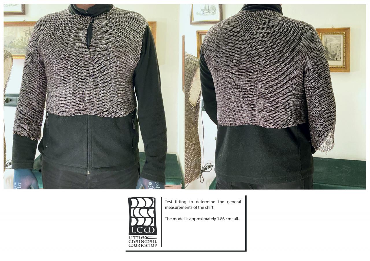

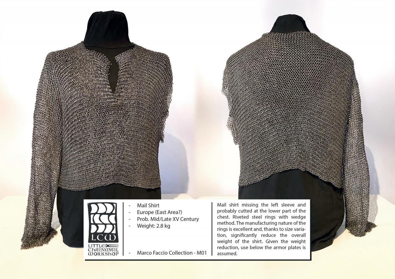

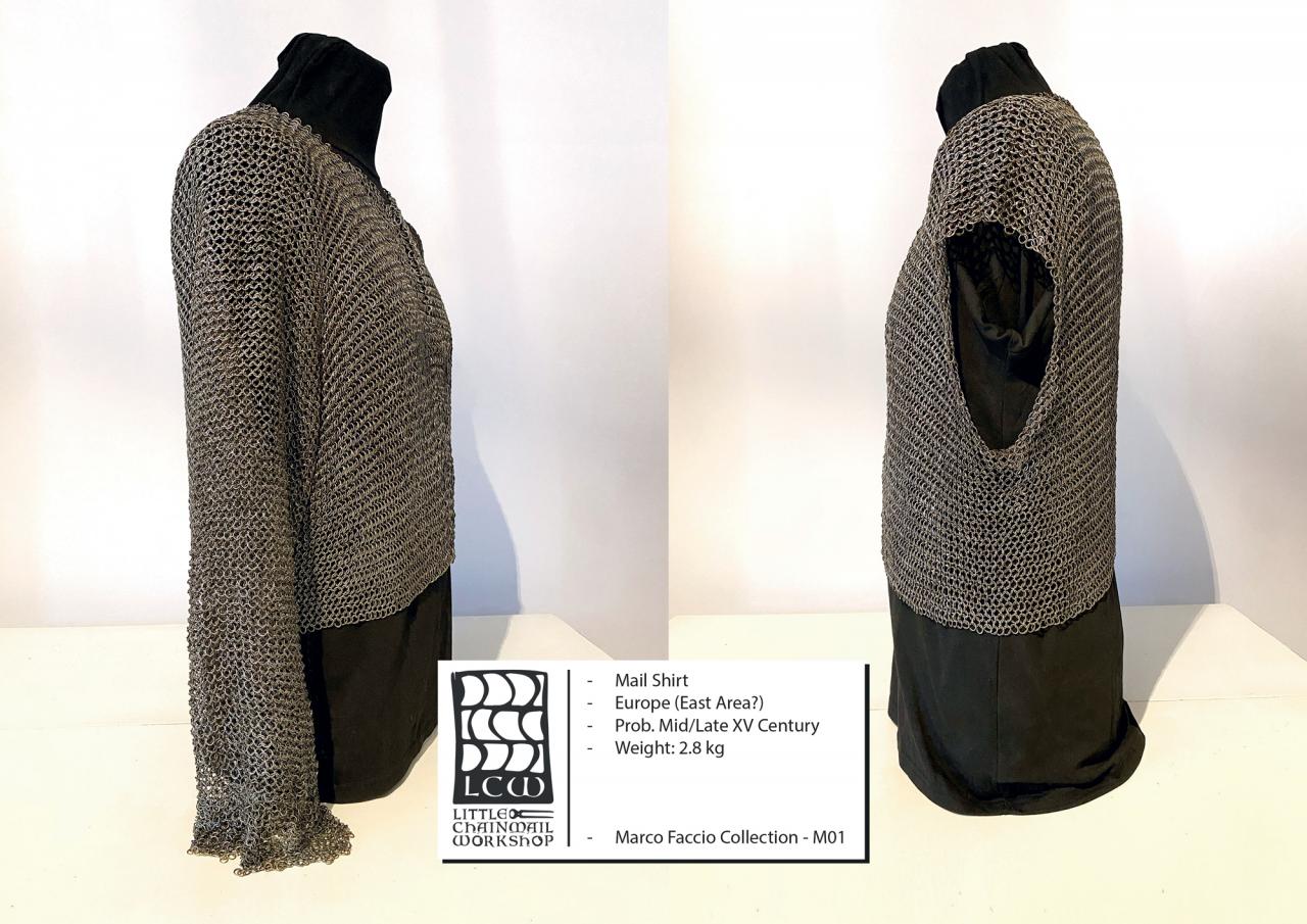

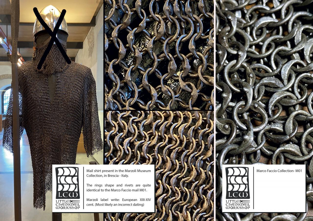

Here we are, talking about what i'm more comfortable
Little by little i will post some pieces from my personal collection, hoping they can be interesting to anyone who love mail armors and such topics.
This one is the first friend that basically started my own collection, some years ago.
As mail maker and lover, i always try to find out references that can helps to better understand and map as many mail pieces scattered all over the world, inside museum, personal collection, etc.
Dating and geographically point out precisely a mail piece is not a simple task. In some rare case we have maker marks that can help us better define the provenace, but most of the time we must look for visual and objective relationships with the various known pieces. Even the historical dating is not at all so obvious and easy. Whether it is European or Eastern mails.
The general design of the piece, the tailoring, the specific shape of the rings, the riveting method, the construction pattern, the presence or absence of posthumous alterations, and so on.
As if all this wasn't enough, we know for a fact that many mails underwent modifications, cuts and reassemblies during the 19th century, when many collections and museums began to be set up and opened to the public, using many of these pieces as aesthetic fillers for plates armors.

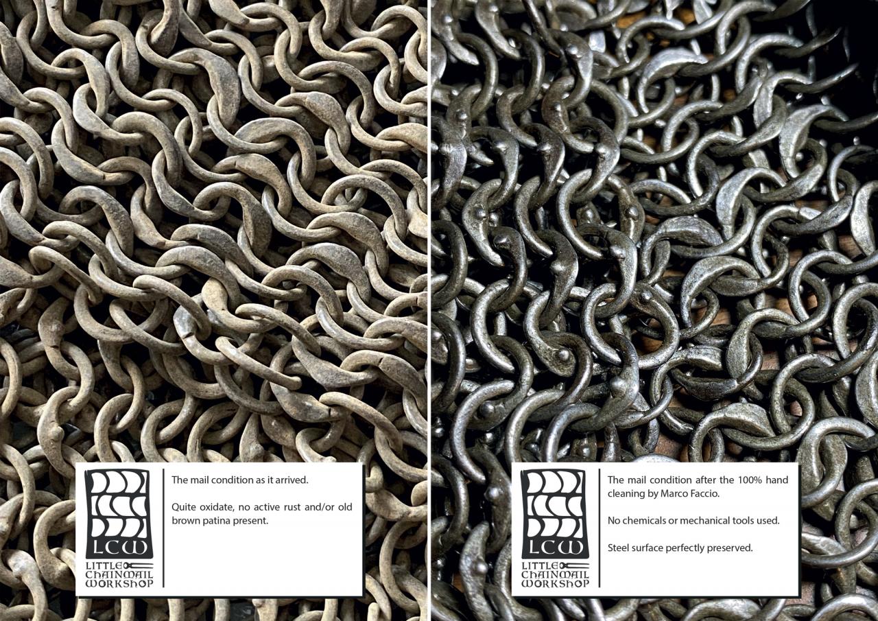

I do personally clean and restore my own pieces, with no chemicals and mechanical tools, just patience and handwork... so i can perfectly decide the level of intervention. Said that i will proceed presenting my first contribution to this forum.
Please feel free to comment, add info and ask anything you like... we are here to share and gain knowledge

That is true. Sand tumbling was (is) a good way to overall clean the mail pieces, but it works mostly just for superficial oxidation... less effective for deep rust patina and corrosion.

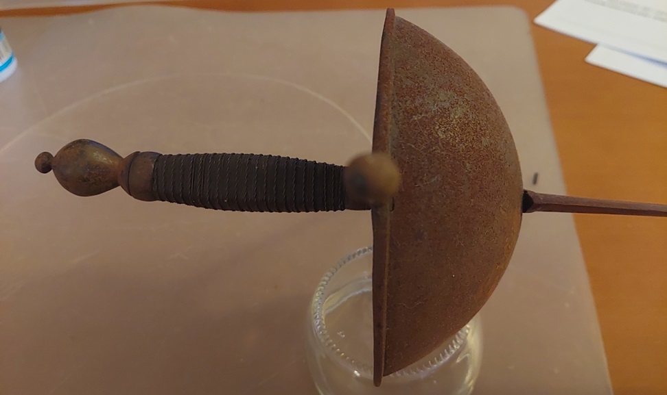

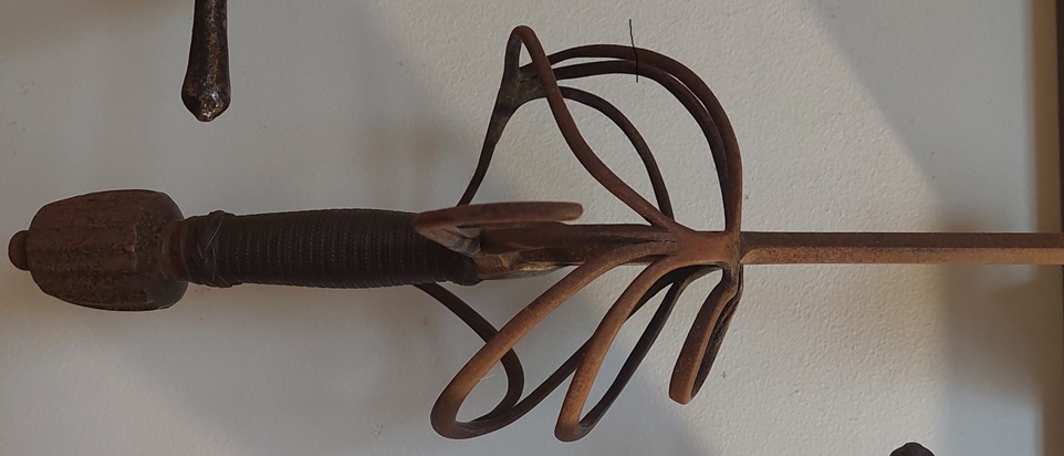

One thing about swords which are from old collections that have been displayed seem to have corroded more on the surface exposed due to dust accumulation absorbing moisture, while the reverse not getting as much dust was less exposed to dust and moisture. That was one suggestion I once heard...
Far from intending to go off topic, but this is indeed a subject rather tempting to raise.
I live less than a mile away from the salty Atlantic coast, and every time i pick up an old sword (or gun) from the walls for whatever reason, i am horrified with how fast topic rust invades the upper areas. Yes, only the upper areas. Whatever recipe of moister and dust creates in the air above and then falls down for assault on top of them.
