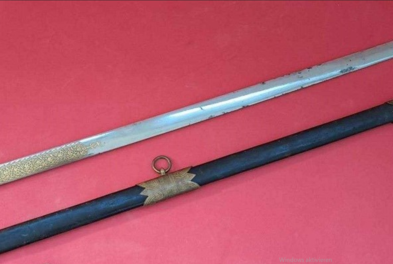

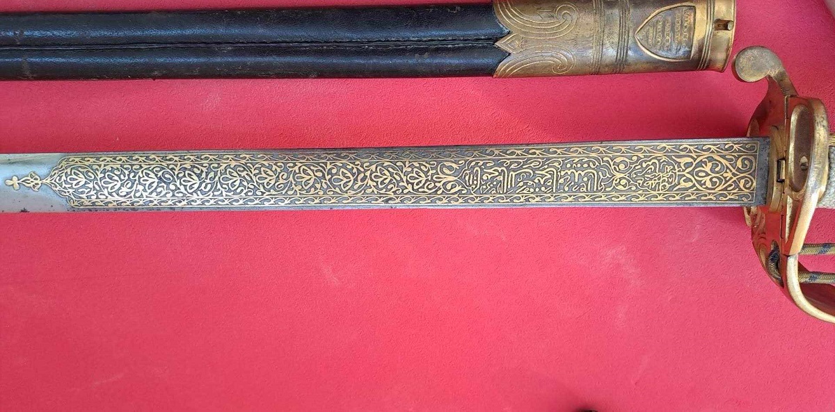

Hi guys.
I apologize in advance to the moderators for posting my topic in this section. I understand that the saber is European. However, the blade is maybe oriental. And undoubtedly the inscription on the blade is oriental.
My friend bought this saber for his collection. And he asks you to help him find out more about this saber.
Thanks in advance to everyone for your help.

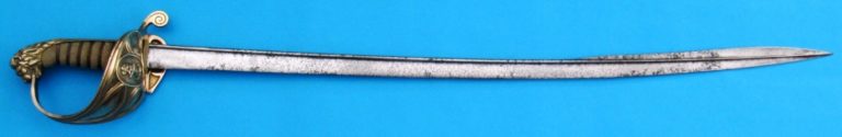

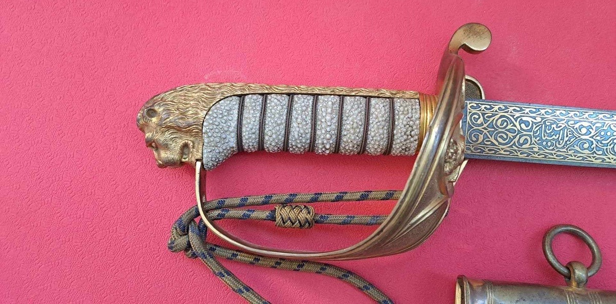

the hilt is a British Royal Navy sword hilt of the Victorian period as is the scabbard

Thanks for the info.

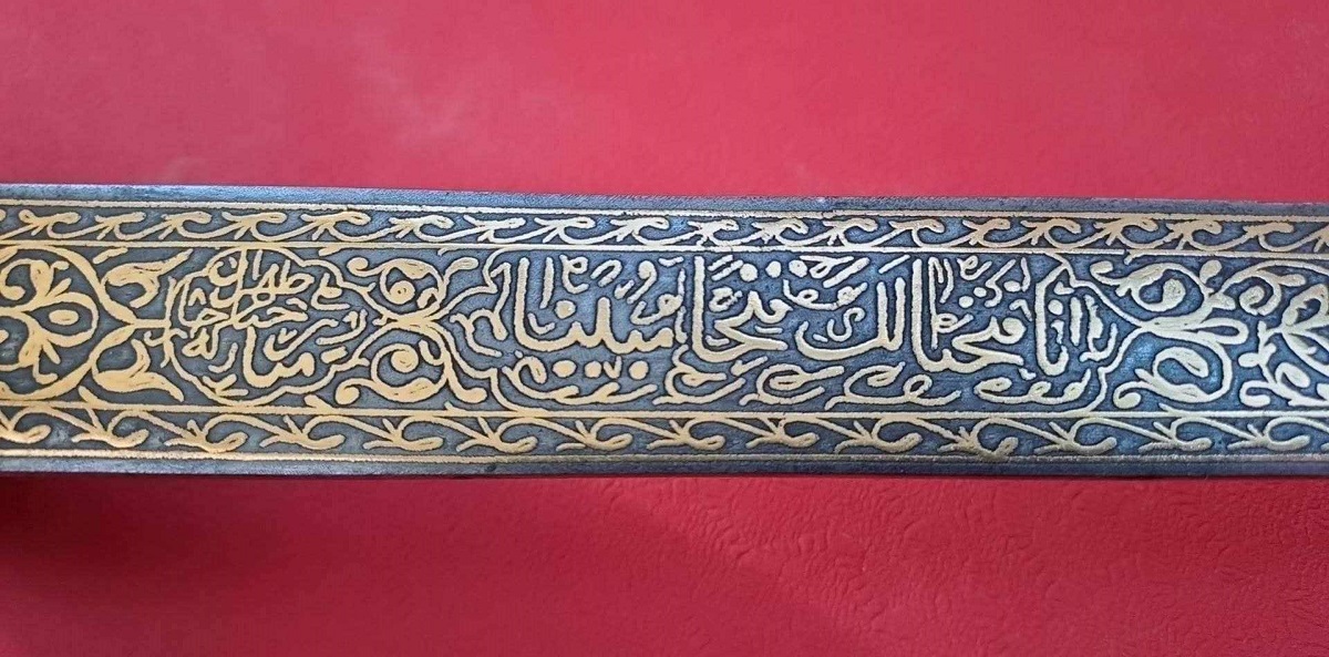

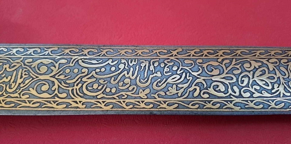

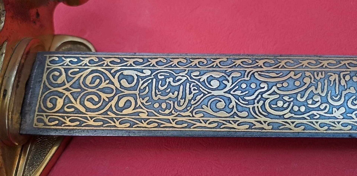

Perhaps someone can help with the translation of the inscription on the blade?

Probably Wilkinson's was commissioned a naval sword to an officer whom had received this as a gift. It may be Turkish blade ( I suppose someone with the right knowledge could tell from the cartouche the maker) since I've seen some similar swords ( I mean the pattern) being used by officers of the Turkish navy, for example, in WWI.

Is there a number anywhere? IIRC, Wilkinson did keep records which may still be available.

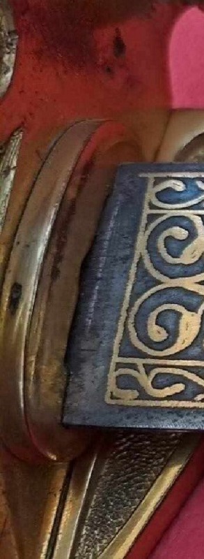

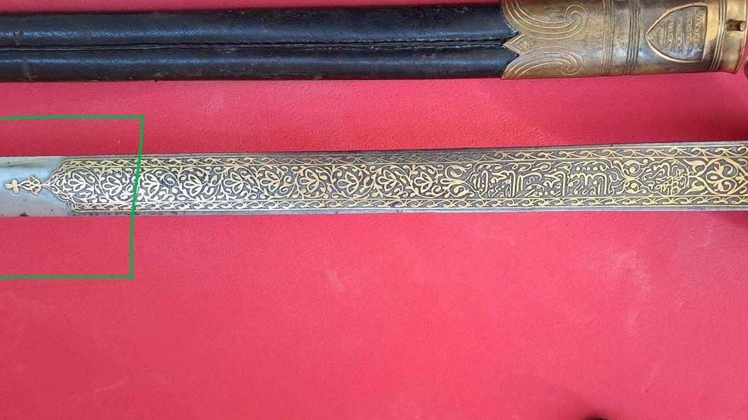

Is that a fuller running across the blade?
I have my doubts regarding the blade and age of koftgari(?) on it.

I don't see any fuller, it may be a trick of the eye due to reflection.
What makes you think that the blade is not contemporary to the sabre? Mounting a new blade onto this would have been a very tricky thing to do and would have certainly left noticeable marks
milandro is offline   Reply With Quote

I recognize a fuller at the blade section with koftgari through a reflection, and I see a similar reflection further down the blade.
More pics of the blade could help.

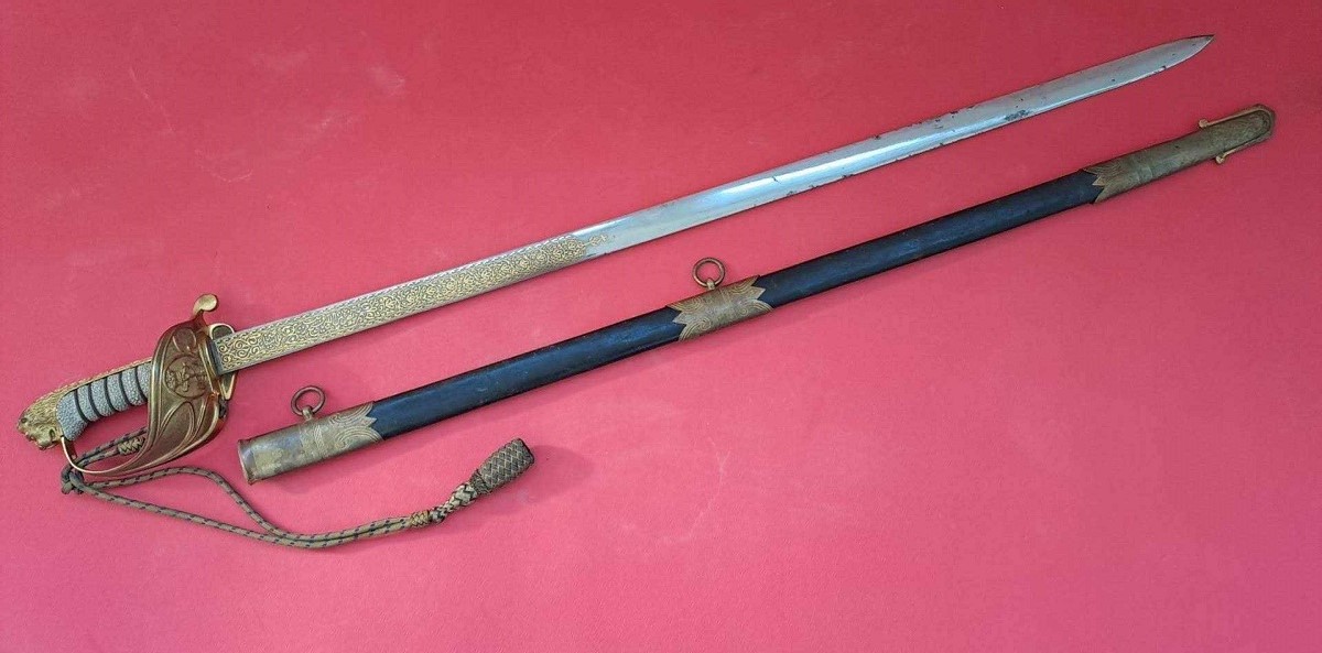

This is a nice example of the standard M1827 sword for Royal British naval officers, which remained in use through the 19th c. into the 20th. The more modern examples have much lighter blades as introduced in 1929.
It seems the blade likely is with Ottoman affectation and gilt with inscription probably for a naval officer perhaps affiliated with the Royal Naval base at Aden, in Arabia. This was an active naval port and entrepot charged with control of Aden to the Hadhramaut to the east in Yemen. This port and station became key after the opening of the Suez canal in 1869, and remained so until 1960s.
Wilkinson was of course a London maker specializing in officers swords which were indeed serial numbered, but also supplied these to military outfitters, which often existed in these colonial outposts. As Aden was officially part of the Bombay Presidency, such an outfitter may have been in Bombay, or indeed in Aden, whichever the case, the Ottoman presence and influence was at hand.
British officers in colonial regions often adopted influences of the local cultures in arms and fashion, so this kind of cross diffusion is not unusual.
In India there were Indian hilts on British blades, and sometimes vice versa.
There is also the possibility of this sword being intended as a diplomatic gift.
This blade is British and certainly not Ottoman nor Indian, and there is no reason to think it is not homogenous to this sword.

Well, the Koftgari(?) appears to claim, according to auction house, it is a work of Ustad Husayn from Tehran?

Well that complicates things doesnt it? In Arabia Persian blades were most highly regarded, but this blade is hardly Persian nor is the sword obviously. So the koftgari is the only 'work' pertaining to this individual. Not sure why a British naval sword would be in Tehran, unless the blade was of other than British manufacture, went through Tehran, then through the gulf into Arabia etc.
It seems Wilkinson produced the entire sword with officers swords, and perhaps they had blades decorated there? Then possibly the Aden idea leaves the equation.

Jim, what was given in the translation provided by auction house is
"The work of Ustada Husayn in the blessed armoury(?)... Tehran"
"amal-i ustad husayn / dar jaba-kha(na)-yi? mubaraka... Tahra"
Who knows how precise the reading and translation is.

Interesting, didnt makers in Persia/Iran put a date with their signature?
Also interesting to see a 19th c. straight blade made in Iran.
Remarkable koftgari work though and compelling translation.

Actually I have nothing more to say as I already did in #7 - I have my doubts regarding the blade and age of koftgari(?) on it. It is as far from my area of interest in edged weapons as NP from SP.
I asked a question if there is a fuller running across the blade. Now I also would ask, if it is common for Wilkinson swords, where the blade is homogenous to the sword, with no reasons against that fact, to have such an opening at blade/hilt joint. I would also ask, if such a flaw running across the blade is acceptable on a sword blade made by Wilkinson.
Is there a possibility this koftgari is recently refurbished or, let's say, repainted, or perhaps, even recently created? I think there is.
I do not have a nice story with geographical locations included for it - this sword raises only questions to me.
The auction house put it on auction twice, it was bought at the second time, it was sold under the estimate. The auction house did not post a picture of the entire blade, only hilt and the koftgari part. So I repeat - it would be interesting to have more pics of it, particularly of the part where koftgari ends till the point.

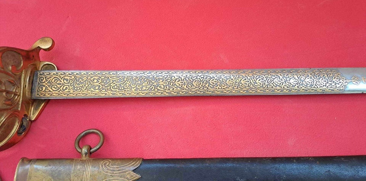

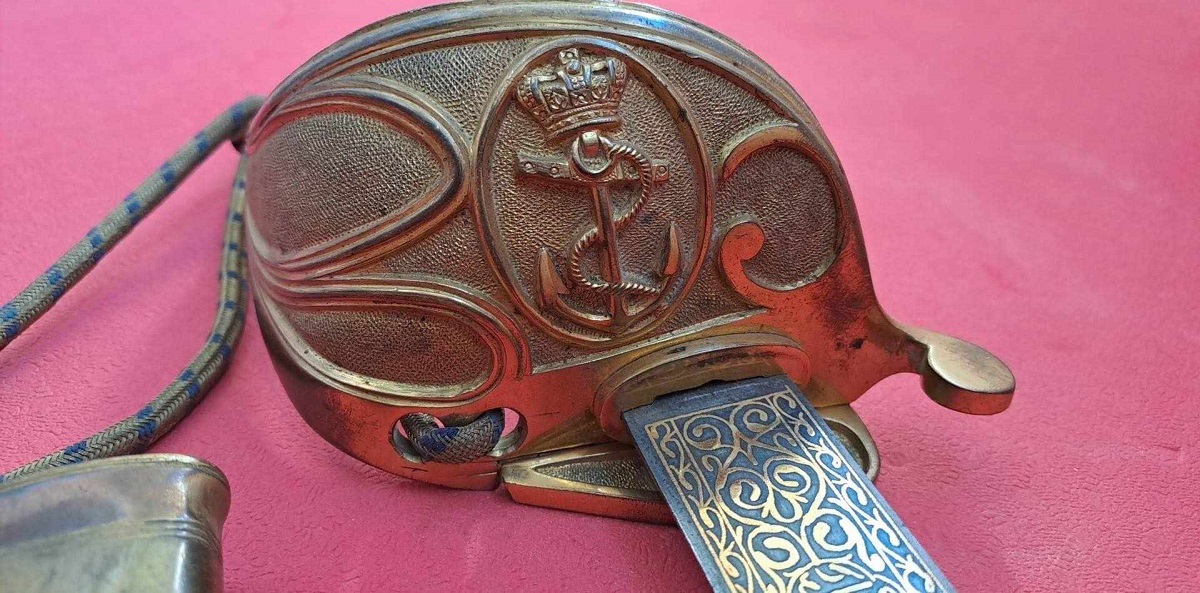

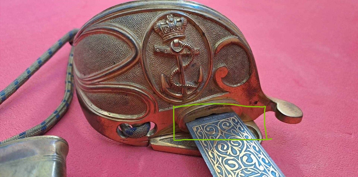

Not my area in anyway but interesting. I think mark where the sword goes into the guard is just worn gilding from the scabbard throat?
Old 19th October 2023, 03:12 PM   #19
Posts: 6,010
Ah I see what "milandro" is on about. The profile of opening for the blade is wrong for this decorated blade.

Ah I see what "milandro" is on about. The profile of opening for the blade is wrong for this decorated blade. The hole looks made for a heavier blade and I suspect it more of a heavier curved cavalry blade. A proper sabre.
I suspect you got me confused with Gustav whom, I think, has perplexities on the fitting of the blade (which I may share after seeing his highlighted pictures).
It would be most unusual, though, that this would have a cavalry blade since the guard is most positively one for navy ( very prominent anchor).
Something may be the matter.
There may have been legitimate reasons why this blade is there or fishy ones (you see the navy connection? )

Yes, Tim, I also thought a reforged pipeback could be the explanation of that strange diagonal fuller, if there is any at all.

I think you are spot on something fishy here. If it was a special Wilkinson's fit up or conversion, with such lavish decoration, clearly for a high ranking bod then I think they would have made the blade fit properly.

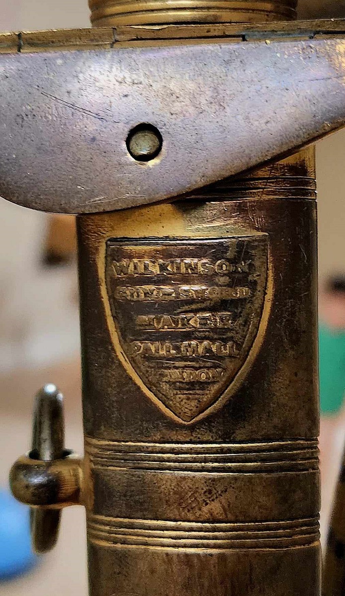

I am not familiar with the name being placed on the locket in this manner.
Having noted that, and the fact that Wilkinson always placed its name on the blade, along with the familiar 'Star of David' surround with brass proof plug at center. It is tempting to imagine this arrangement with the Wilkinson on the locket may have been due to the absence of the blade for appropriate placement of the attribution to that company.

This made me look more closely at the pictures. In Turkoman's eighth picture of the original post, and the final one of the koftgari, there does appear to be a grid of awl marks. So, there was encrustation work done on the blade at some point. Is it original, I would love to know! I made a thread enquiring about these and other floral motifs about six months ago in the Miscellaneous forum and did not get any takers. I am in the process of my own research and if I ever get satisfactory information I will revive it someday if another doesn't first.

The application of koftgari on an older blade seems to have been often a case, as with this form of Indian tulwar (of Persian form) which IMO is from the Deccan. It is mounted with a British M1788 light cavalry saber blade, and as can be seen, decorated with koftgari, but in limited field at the forte.
While it is tempting to think of this as from the early period after Seringapatam (1799) and affiliated with East India Company, there are any number of possibilities (many possible stories ) . The point pertains to the koftgari application associated with British swords and blades in the colonial sphere.
