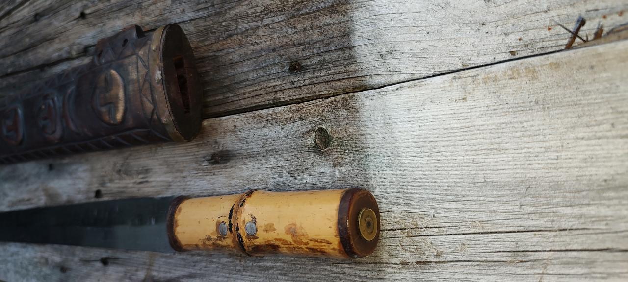

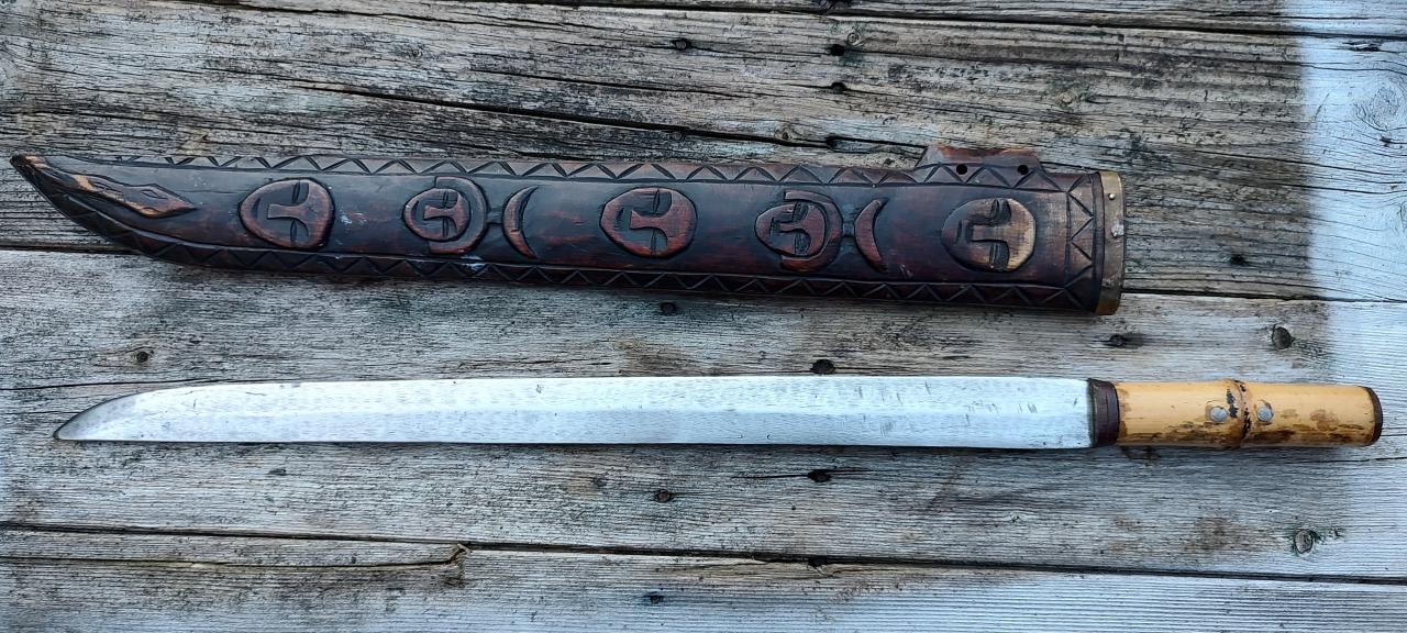

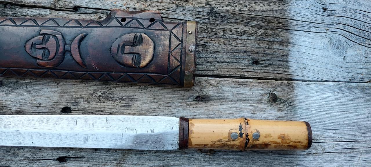

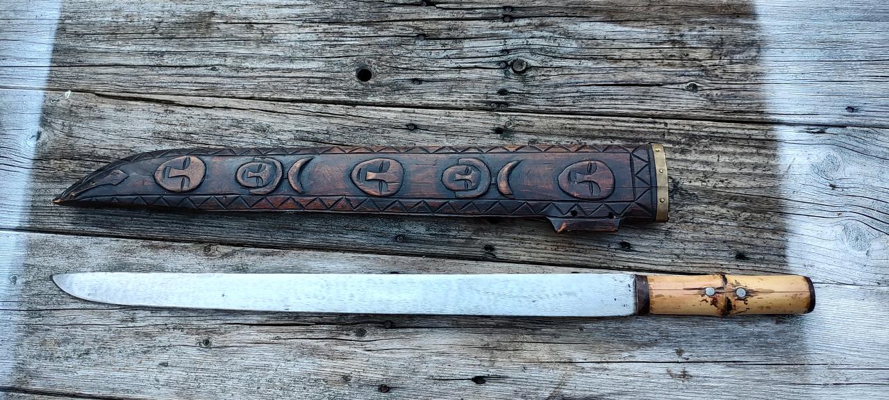

Hello All,
At first sight, the pictured sword looks like a typical tourist Paiwan sword.
After close inspection, the quality is quite decent. Too much effort for just a tourist piece.
- hilt is sturdy and looks peened with washers
- blade is hardened and even looks folded
- even the scabbard is sturdy and well made
Could any of you bring me back to reality and tell me this was made for tourists?
Thank you.

I might venture to comment that the blade may be older than the dress.

I agree with Rick. The blade is clearly laminated. Recent items are monosteel. The scabbard is not nearly as old. The knife is not a tourist piece.
Old 27th April 2023, 11:07 AM   #5

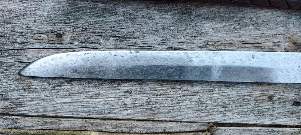

Yes, the blade is laminated and therefore old, unfortunately cleaned very roughly, probably by machine. Worth polishing. She also seems to have the usual cross cut.
Very interesting catch!

I don't recall seeing an example of that blade profile on an old Formosa knife/sword. Presumably of Southern or lowland origin with the straight blade, but without the angular tip seen on most Rukai and Paiwan examples.
Good points Jeff. Perhaps this is not so much a traditional weapon as a knife for domestic chores. I like it, and I think Detlef's suggestion about polishing it is a good idea. A light etch might bring out an interesting pattern also.
It's also possible the blade profile has been modified. The pinned bamboo hilt is atypical for Taiwan native production. It reminds me of a couple of Japanese WWII-era modified knives and swords I have from Indonesia. The Japanese occupiers adapted local blades to their own purpose and in the process sometimes modified the blades as well.

Polishing or/and very light etching are good ideas.

Looks very suspect to my wandering eye, the leather washers and aluminium rivets look very wrong for the region considering other more native ethno pieces I have seen are set with resin and no hilt rivets or pins, I suspect it is one of the tourists types that lost its hilt and got a replacement at some stage by a non Asian restorer but one with some skills in knife making maybe ?, it certainly looks a better job than the original tourist type hilts, for me whoever did it did the blade a favor.
A friend has one in its original form, if I remember correctly the hilt was dark wood with a small ring ferrule in thin sheet type brass, possibly had lizards carved on it to. Snody

I believe the consensus is the blade is legit, the hilt a replacement. and the scabbard a modern Paiwan item. The present hilt looks like it might have been done in the original culture with the bamboo scales, but the rivets and washers are not traditional of course.

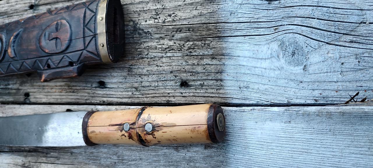

Sorry Iain but I see no scales here just a simple through tang with washer and peened end, the spacer washers on the top and bottom of the hilt could be coconut shell, or leather as i suspect, the 2 hilt pins - rivets are certainly not looking like an Asian fix as you noted, personally I see a tourist blade and scabbard with a new western made hilt, I say this because a friend has one just like it with a wooden hilt that has carved men either side which I handled recently.
Much the same as the one here shown in a previous post by Wayne. Snody.
Maj-Biffy Snodgrass is offline   Reply With Quote

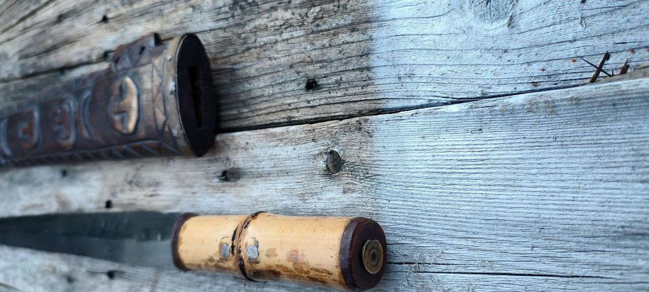

- hilt is bamboo (Asian product)
- peening of the tang is also used in (antique) asia
- hilt pins are also not exclusive western techniques

I simply meant to point out that there are no scales on the re hilt as suggested by Ian, it is done in Asian style round sectional Bamboo with rat tail tang and peened over a washer at its end sure, which is more Asian in style.
But, I have seen this on some of the tourist ones of 1960s and 70s age to, some have a washer and peened tang end, there are many of these floating the markets of the uk that were bring backs from the 60s and 70s, some very well made and can be taken for older ones, others not so well made and are obvious tourist market pieces, they often can be seen at auctions here to, even as African tribal swords as I have seen recently in one auction.
Other than the rivets, the peened tang with washer is certainly how the hilts are finished originally having had a couple of the originals myself over the years.
But it can not speak so it can not tell its origin storey or age, so all is speculation and guesswork as I see it including my own ideas on it just as it is with many other Asian ethnographic weapons that are quirky pieces that do not conform to traditional patterns, or re hilts like this one, it is what makes collecting interesting for me meeting new and unusual pieces that are not boring old run of the mill.
Also, and no offence meant at all here, Bamboo may be an Asian plant but it can be bought in most western countries very easily and in many types today, garden centres have even got Tonkin cane and solid iron bamboo these days as well as rattan in natural dried raw state, split rattan to for chair seat restoration etc.
As far as the lamination that can be seen in the blade my friends tourist one has the same, they were likely made by traditional methods even in the 60s and 70s so for me that says nothing about it being an old blade with re hilt done and then put into a tourist scabbard, which would make it a marriage of different parts perhaps possibly made to deceive.
What I personally think you have here which is only my own observation obviously is a well done re hilt on a 1960s 70s early tourist sword from the region that is one of the better ones with better blade, likely earlier than many of the lesser ones from later 70s, where it was done who knows ?? but it is not a marriage of parts, the hilt being the only newer part, the scabbard and blade being original, tourist or not.

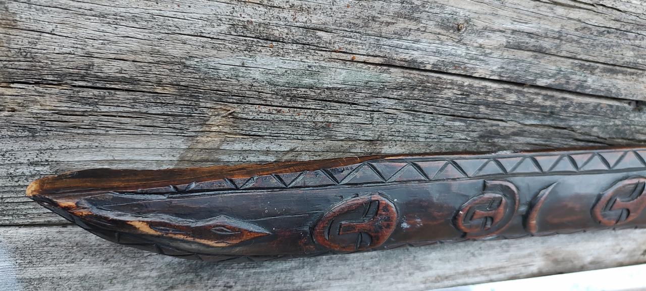

Yes, the scabbard is what we usually see by these tourist swords, no doubt.
The simple bamboo handle could have been attached elsewhere. The tang is complete through the handle and peened and extra secured two times! For what so much work when not for use?
The blade seems certainly laminated and has a different profile as the blades from the tourist ones, they are flat and from lower quality and the handle is just put-on, I never would try to swing such a piece!
I for my part guess that it's an antique blade which has lost it's handle and scabbard and gets reused as a working tool with a self-made handle and a replacement scabbard. Just my two cents.

I personally would polish the blade and give it an etch.

One more little and valid observation, the hilt of your knife is shorter than the original early tourist ones that I showed here in attached the pic with identical blade and scabbard, although your scabbard is minus its top curving carved section, so any re hilt with slightly shorter hilt would allow for a washer and peening over of the end of the tang, just an observation but a valid one for sure.
And one question, what are the spacer washers on the top and bottom ends of the hilt made from ??, can you tell which material has been used. regards Snody.

The hilt looks shorter indeed. However, no conclusion can be made if we were to compare length of the hilt alone.
-the tang length of the tourist sword is not visible. It's not surprising if it's really short. It could be too short to peen on a usable hilt.
-the hilts of authentic swords were also short.
The brown spacers are leather. Below are 2 more perfectly fitting brass spacers.

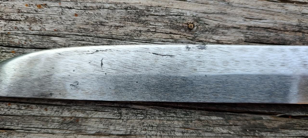

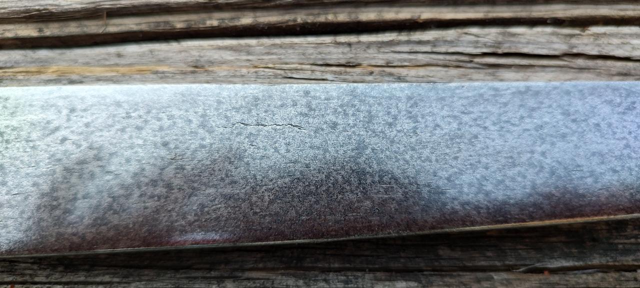

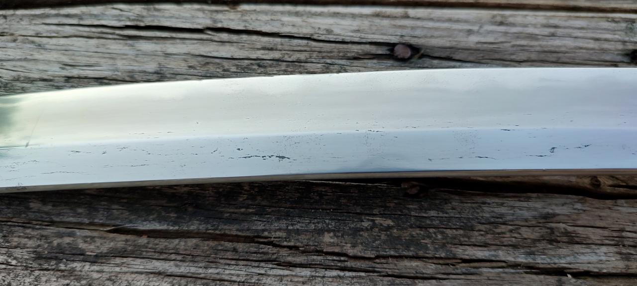

It doesn't look like cast steel. Only cast steel can have cold shut.
It still really looks like forging errors as a result of laminating a blade.
I will post close ups and similar examples later.
Copycat is offline   Reply With Quote
Old 26th May 2023, 07:27 PM   #26
Copycat
Join Date: Apr 2023
Posts: 42
First one is the close up of the Taiwan blade. All others are close ups of antiques.

Apologies. I thought I posted a reply.
The tang of the tourist knife is not visible. It is also possible that this tang is too short to peen on a usable hilt. It's not surprising for tourist quality. You only need to glue the tang on the hilt.
The brown spacers are leather. Below are 2 more brass spacers.
Also, cold shuts look different if I were to compare with online examples.
