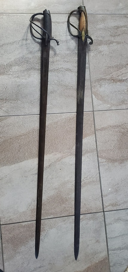

In recent browsing through another forum, I found this curious heading and opened the thread hoping to find what this title meant. The author was inquiring if someone might direct him to references which might tell him about these notable Spanish colonial short swords as he could find nothing in Mexican or Spanish sources. Perhaps he was situated in Mexico as his surname was Mexican.
Naturally there was little response, but the only brief reply suggested "Spanish Military Weapons in Colonial America 1700-1821" (Brinckerhoff & Chamberlain, 1972) which is virtually the only reference ever written describing these (aside from several brief papers in subsequent years). The so called 'espada ancha' evolved primarily in the frontier regions of New Spain (now Mexico) in the mid to latter 18th century, and appears to have evolved in hilt style from hangers/hunting swords probably from vessels which traveled between Spain and its colonies. In the frontier regions of New Spain in the north, the Spanish southwest which included Texas, New Mexico, Arizona and Alta California and the northern parts of New Spain from Baja California to Sinaloa,Sonora, Chihuahua, these areas were rugged desert with thick vegetation. Horsemen found their military broadswords (termed espada ancha =Sp. broad sword) were not adequate for brushing trails and the blades often broke. The local blacksmiths began forging heavy blades which were stout, cutlass like types which were mounted on various interpretations of the European hanger, hunting swords types often used on ships. In those times, these were deemed 'machete' by Spaniards although some narratives use the term cutlass. In later years, perhaps because some of these were indeed mounted with the Spanish dragoon blades (often with the 'Spanish motto) of the 18th century, somehow the term 'espada ancha' became colloquially applied to these machetes by collectors (again, espada ancha = broadsword in Spanish). As has been noted, information on these is sparse, so it is not surprising that this individual could find nothing, as outside the US there virtually is no reference to them I am aware of. I would like to initiate this thread to effectively open a study of these long overlooked and under researched edged weapons. Here I would like to note that Lee Jones in his now venerable paper on this site, is probably the last author to write on these. I would like to advance our collective knowledge on these from that bench mark. I hope those in our community will post examples, add information and please ask questions. While no regional distinctions as yet have been confirmed, there are some plausible speculations. These were locally produced with blacksmith forged blades, and the hilts, while of a basic style, often used certain embellishments such as shells from crossguard, varying grips etc. In the attachments: First is a bone gripped example, probably 1790s and at this point presumed of a form known in Sinaloa but later Alta Calif. and Santa Fe. Here the hilt is of the familiar hanger style but mounted with 18th c. Spanish dragoon blade (broadsword). Next is the 'regulation' military form used by Spanish through the 18th century into 19th known colloquially as the 'bilbo' in European and American parlance. As the blades were DE, broadsword, the Spaniards regarded them as ESPADA ANCHA. Next is a grouping of these colonial 'machete' (espada ancha) showing wide variation of forms, most of these from c. 1790-1850. Last edited by Jim McDougall; 26th June 2022 at 10:40 PM. |

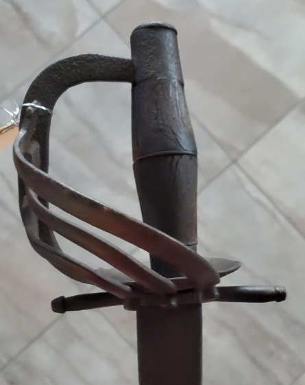

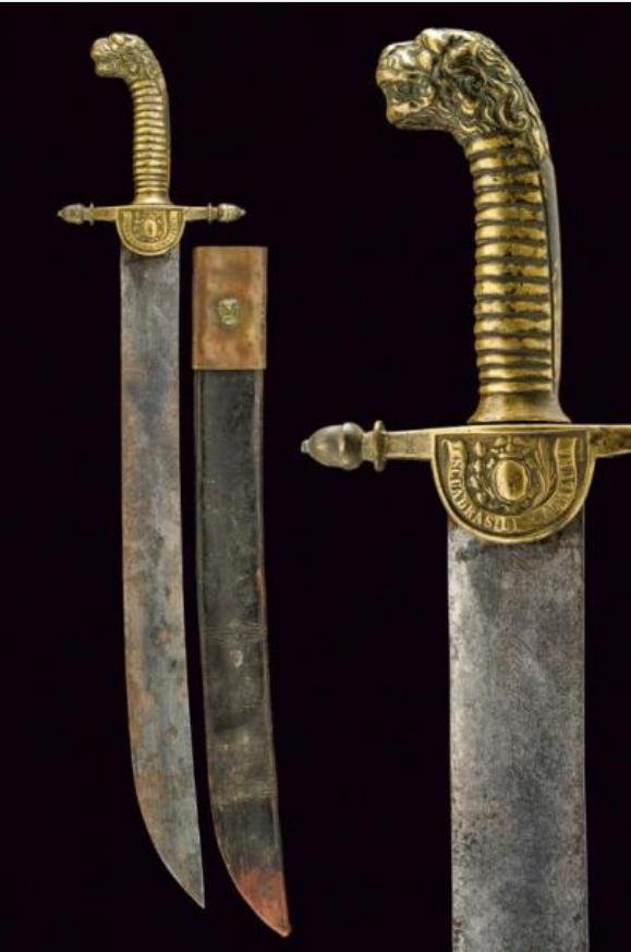

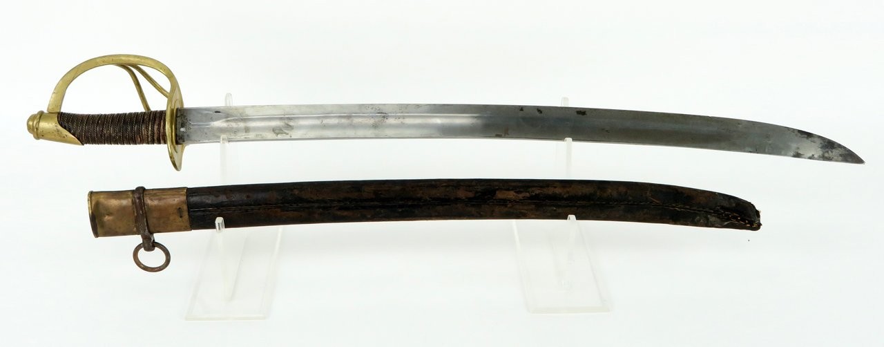

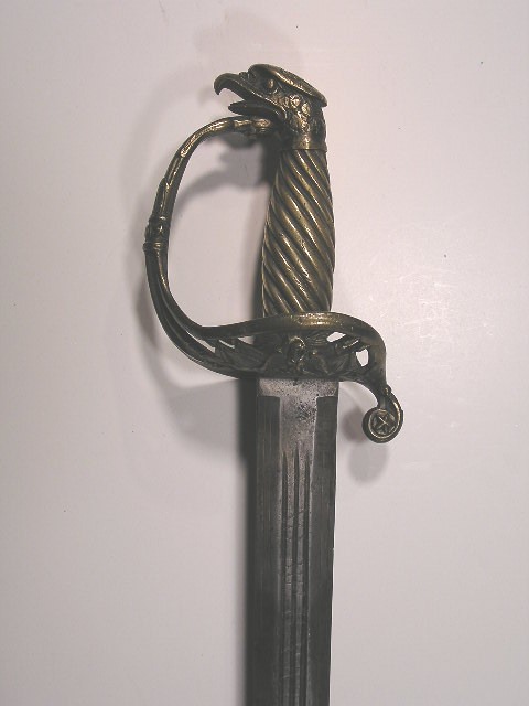

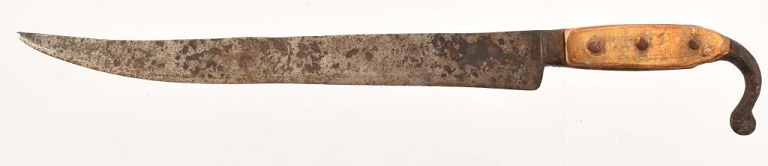

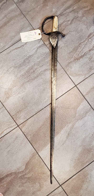

Jim, that is a known Mexican army cutlass model 1870ish
'Blade is marked “A.C. Mexico” for A. Colubuzier, a supplier of military items to the army. The reverse is marked “R.M.” with liberty cap, which stands for “Republica Mexico” ' There is an earlier rendition with a rather distinctive scabbard. Photo (and text) from Collectors Firearms. I don't recall any of them referenced as Espada Ancha or bowies. Cheers GC |
#5 |

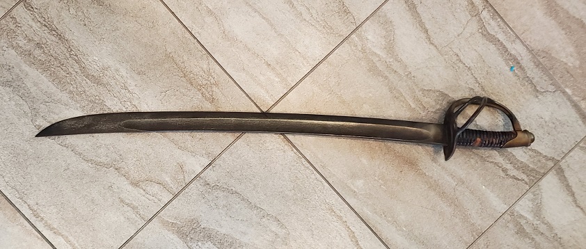

Posts: 10,833
Thanks very much ! the 1870s sounds right as well as these '1840' style hilts were around for some time. I know they were referred to as cutlass, but am not aware if they had a naval connection despite the term.
I was suggesting that the character of these heavy bladed swords in degree recalled that of the espada ancha form in discussion, not that the term was ever applied. ..just my own observation. Clearly these sabers had nothing to do with Bowie's. Thank you for the notes on Colubuzier....I couldnt recall the name but thought it was something like that. |

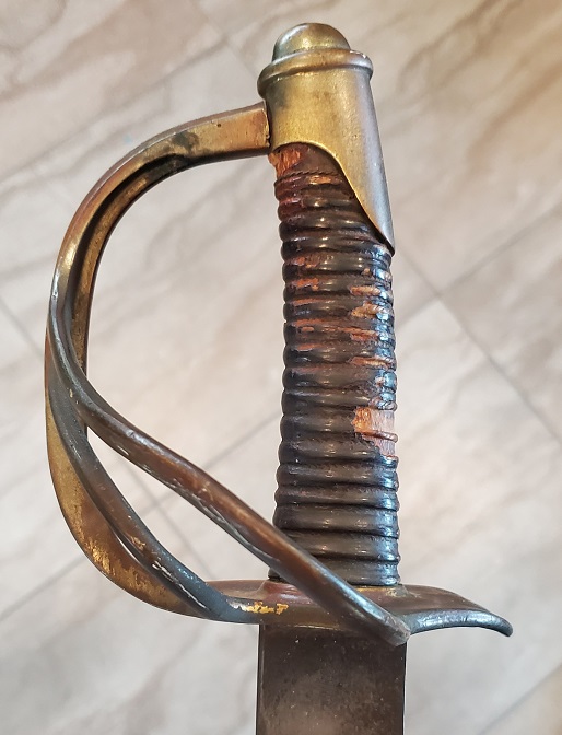

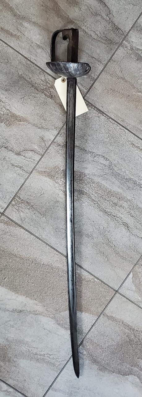

#6 |
Posts: 10,833

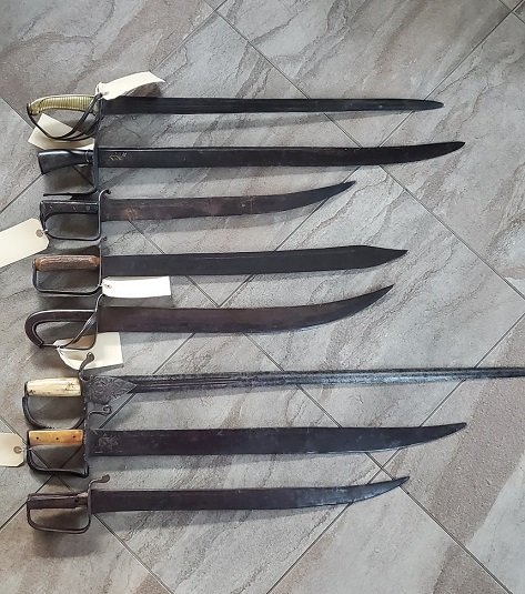

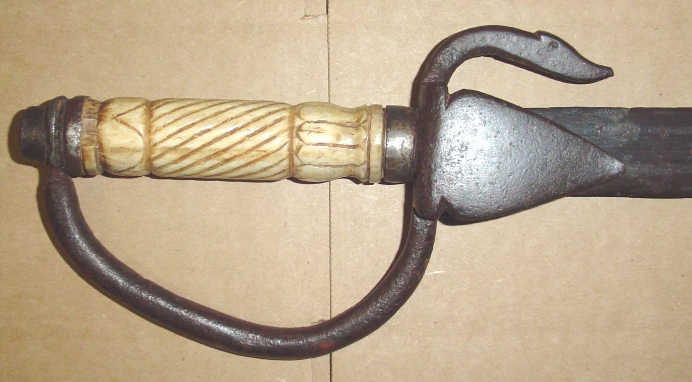

The espada ancha 'type' of hilts with full length blades were found in the southern sectors of New Spain as well as Caribbean and into South America. These regions were part of the "Spanish Main" still quite active in 19th c.
With that being the case, note the Arab influence with the 'hand nock' in the hilt near pommel, as seen on Moroccan sa'if (nimcha). This may derive from trade activity from Spanish colonial areas in Morocco of course. The striated shell guards much favored in Spanish colonial hilts also are part of the hilt character. The second one with larger bowl type striated shell guard is of a form seen in Brazilian regions in first half 19th c. Many Spanish colonial swords in these groups have English blades from c. 1800-10. Other Spanish colonial swords such as the Caribbean cup hilt and bilbo prevailed in these regions as well in these periods. The first pics are the version with smaller shell guard. second the larger bowl type guard Note the similar character of star type motif, striations. I have seen examples of the bowl guard type with inside langet similar to the first example shown here. The Moroccan 'nimcha' is shown to illustrate the 'hand nock'. |
#7 |

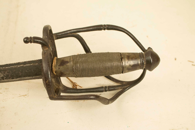

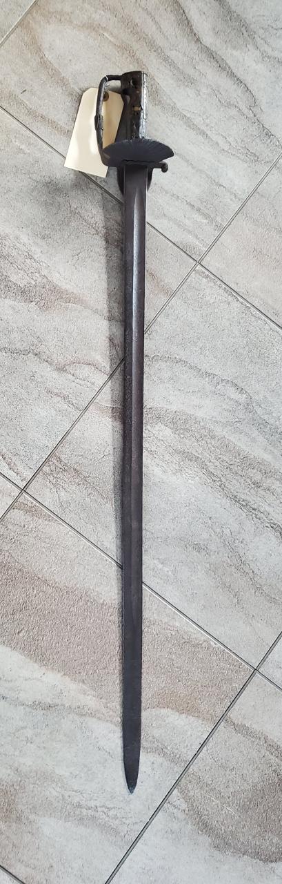

Posts: 10,833

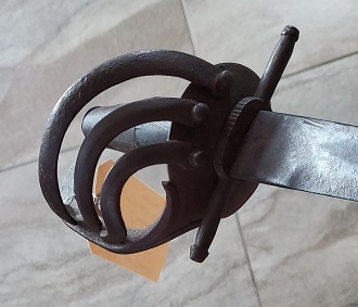

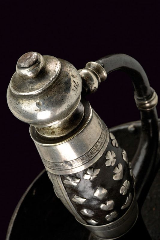

In around 1810-20s the European style hilts with branched guards became popular in New Spain northern frontier regions it seems. According to Adams (1985), he called these multi quillon branched guards the 'round tang' espada ancha, to carry even further from the distortion on the form.
It is curious that these have the branched guard, often with cup type base and under that a cross guard, all a bit redundant. Also, and unclear how related (if at all) is this 'espada ancha' termed in one reference a 'cutlass' and with hooked type pommel, as well as notably a branched guard. Unsubstantiated suggestions are the Potosi region, but no sound evidence as yet known. |

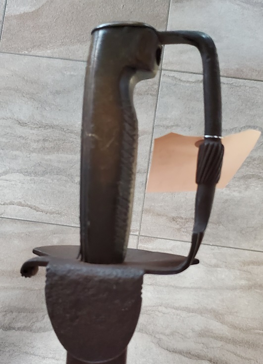

#8 |

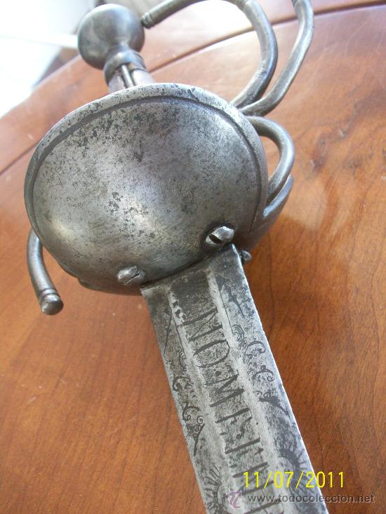

Posts: 10,833

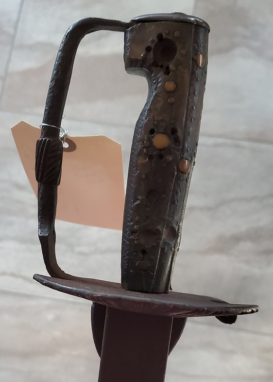

In post #5, the bowl type shell guard, note the serpent creeping near one edge. As we know from examples with provenance from South America on these, and we can presume they were among 'Spanish Main' examples, this example of 'espada ancha' with the serpent on the quillon perhaps is from southern regions as well?
Clearly this is presumption, but at this point it is what is at hand as far as clues. |

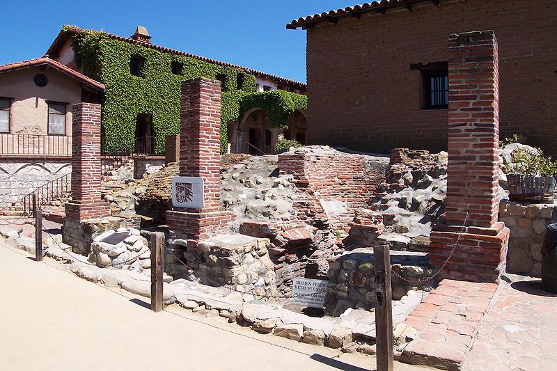

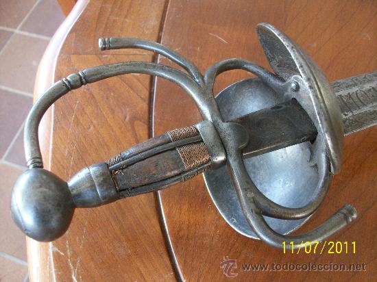

Jim, maybe you remember my reference to Catalan swords and Catalan forges in Alta Calif. The attached images included an auctioneer's (Czerny) description indicating it was made in Toledo but named it Catalan.
Catalan design forges were established in the colonies and presumably local blacksmiths were supplying troops with these machete blade like swords. |

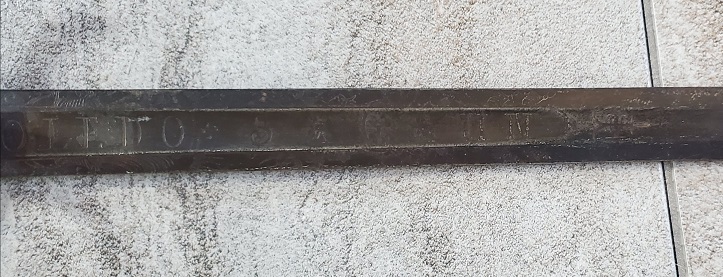

Posts: 10,833
On the blade on the branched hilt saber I just posted, after TOLEDO is the word Sagaun (I believe) which seems to possibly be a corruption of the famed Sahagum, an often spuriously applied name from that Toledo smith. |

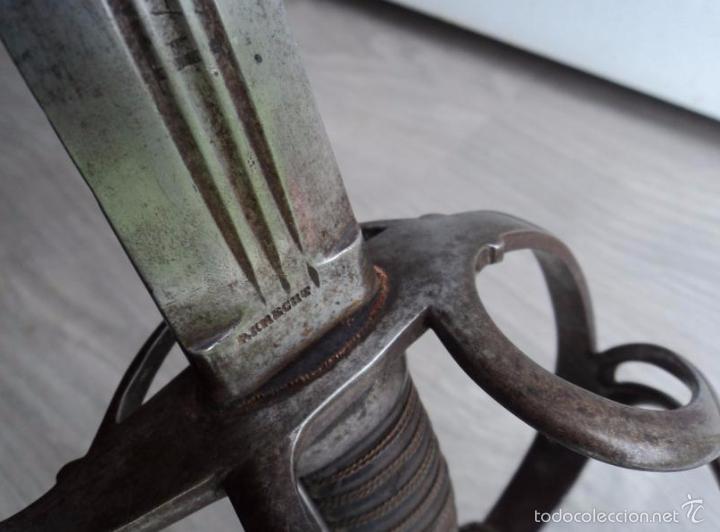

I believe there are many things mixed in this subject.
First we have the origin of the blades. Until c1808, there was no lack of regular crown blades for the army, made in Barcelona or in Toledo. We can imagine there was even an overflow of them after Galvez campaigns in Louisiana and Florida. Brinckerhoff (plate 166) shows blades from a discovery, without mountings, both cavalry and dragoons, ready to be remounted possibly after 1820. These could be cut down to be infantry weapons. Brinkerhoff has plenty of those because he travelled to Madrid Army museum to complete his research. Shorter weapons could be had from the navy as well. As in Spain, we find also Solingen blades, with the motto "no me saques sin razon" or others "Por el rey Carlos III". This were private purchases, by officers and by civilians. There is a very interesting article. GODOY, J. A. (1988): «Modelos de espadas y sables para el ejército y armada de Carlos III». Reales Sitios, nº 98. Here the author has described real size, blades cardboard samples, sent to the court by a Solingen cutler c1775, and nowadays at the Simancas archives. I have seen most of those models in real swords from the period. In Brinckerhoff, plates 168 to 172 are of this type. There are curved and straight, infantry and cavalry. We have also a lot of blade exports of the Carynthia type (plates 127, 131, 134, 135, etc). Straight, three channeled, these blades are found from Scotland to the Caspian sea and India. They were also later made in Solingen for a century and a half (kaskaras). A variety of these are blades made after the Mexican Independance in Solingen, combining the three channels with Spanish mottoes and false claims to Toledo with fake dating, but quite often with the real Solingen mark as well (P.KNECHT is a common one). Made in 1830 to 1860 but with a much antique look, and used in the non-government side of the sucesive Mexican revolutions. Example below. The writing can be found in script as in cursive, and are easily mistaken with XVIIIth century blades. If weathered and no Solingen mark is present, the main difference is in the existence of a squarish ricasso, and the regularity of the channels, thinner and closer. Then we have the blades made locally, usually shorter types, and the types above disfigured beyond recognition, of what little systematics can be done. About the hilts, they could be done locally, but specially after 1808 when no more supplies from Spain could be had. The more fantastic ones (those with the quillions under the shell) I believe are from later times, about 1850, as the revolutionary commanders mixed their wishes of connection with their people with a (fake or real) Toledo blade. It is possible to find typical Solingen hilts (three barred, iron) but I believe most blades were sent without mountings and they were provided in Mexico. So, under Espadas anchas we have many different things, product of a 100 yers of tumultuous warfare in Greater Mexico. The description I make of the picture above is: 1st one is a cheaper copy of a Brescian hilt, made probably in Europe, 2nd is a 1728 cavalry model from a still unknown factory (I suspect now Trubia, in Northern Spain c1790). A Cuban machete after 1880 (3rd from the left, Guanabacoa type). 4th, much older hilt than the blade, I can no say sure if is or is not a Espada Ancha. Closely related to number 6th, that I believe is a Brazilian c1840-1860 sword, for long thought to be "moorish" by many antiquarians. There could be an interesting evolutionary relation there. The 5th is very interesting because those grip cylinder types with caps were often used in 1760-1800 by Spanish private officers in infantry and navy, often in silver, but what we have here I believe is a Mexican revolutionary sword from c1850-1860, so a grip making tradition was kept for a century. Last edited by midelburgo; 1st July 2022 at 11:09 AM. |
#20 |
Join Date: Jun 2005
Posts: 294

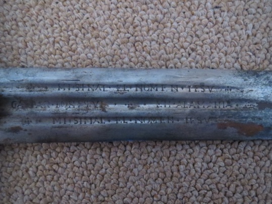

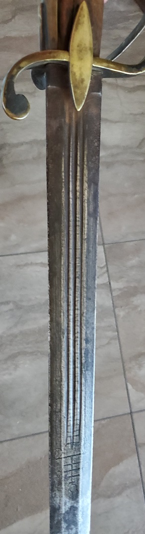

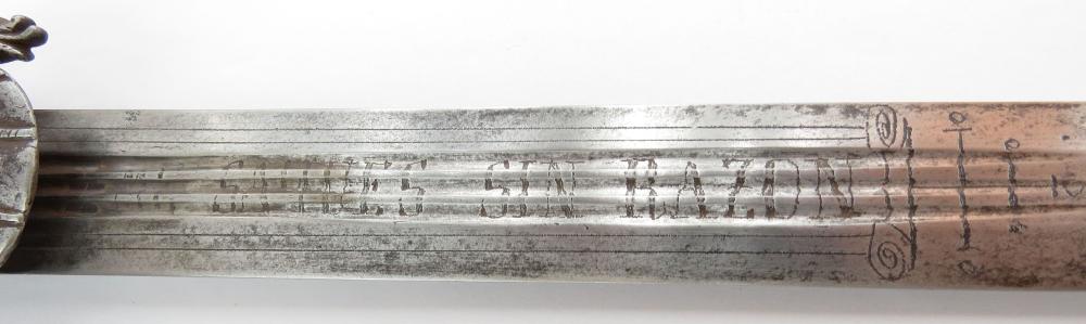

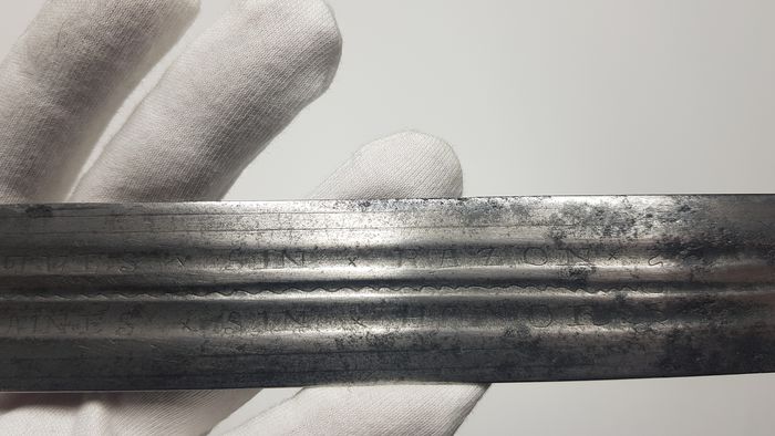

Lets give a look to the subject of three fullered blades.
I believe this 3 are from Solingen around 1840, made for Mexican market. All marked with the "No me saques" motto, but only the first one marked P.KNECHT (Lunechloss is another common one). Last edited by midelburgo; 1st July 2022 at 03:23 PM. |
#21 |
Join Date: Jun 2005
Posts: 294
These 2 are real XVIIIth century three fullered blades from Spanish 1728 models. Three fullered blades although they exist, are a minority of 1728 blades. Most are non fullered or single fullered.
#22 |
Join Date: Jun 2005
Posts: 294
So.
What is this? A)Colonial period using remounted Spanish cavalry blade. B)Republican period using Solingen exported 1830-1850 blades imitating the above. C) Older hilt with a Solingen newer blade. |

Posts: 10,833
Thank you so much!!These are excellent observations and insights, and all very well placed. With the 'Spanish motto' blades, there has long been a 'back and forth' on whether these were Solingen or indeed Toledo blades as it seems most people in the colonies assumed.
In one narrative, one caballero of Alta California suggested, 'every man had a Toledo bladed sword'. As most of the 'bilbo' swords and dragoon blades in three bar hilts had the motto, of course it implied these were made in Toledo. However, I had forgotten about the Knecht purveyor, who, as noted in Wallace Collection (Mann. 1962) indeed handled blades with the Spanish motto. There does seem to be some variation in these, both in fuller pattern and lettering etc. so perhaps there may have been some production in Spain. The Toledo manufactory opened in late 1760s and this may have accounted for some of these. There were large quantities of these dragoon blades in New Spain which had been stockpiled long before the 'supply chain' termination after the 1810 insurrections. It is indeed pretty hard to attach the Spanish colonial designation on many of these kinds of swords, there were rather rugged in character as made in rural areas in Spain on occasion. It would seem that ersatz examples were made in many cases outside the 'regulation' specification, and using components and materials available. That to me is one of the most fascinating aspects in this field of collecting. |

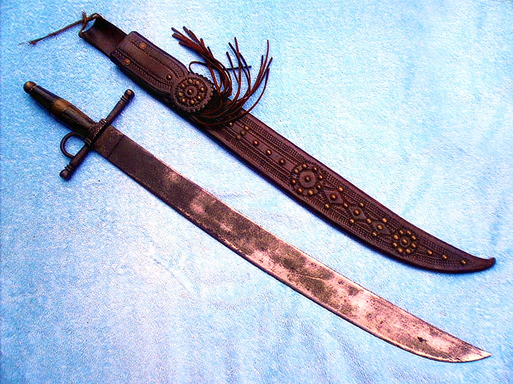

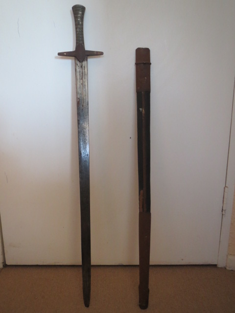

Posts: 4,281
I've always thought of this one as my espada ancha:

Posts: 10,833
Hey Wayne, thank you for responding!

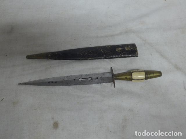

Thats a nice example, and in that configuration it could well be considered one, after all these utility oriented swords (machete) were found in countless variations. In Levine (1985) these kinds of ring over the cross quillon and similar type grip are noted as 'Central American dirks'. Here that type hilt is mounted with a machete type blade, and these were well known throughout the Spanish Main through the 19th c. Great scabbard, and of the excellent leather work typically found in Mexico through the 19th c. as well. |
