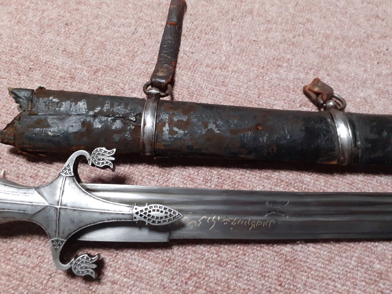

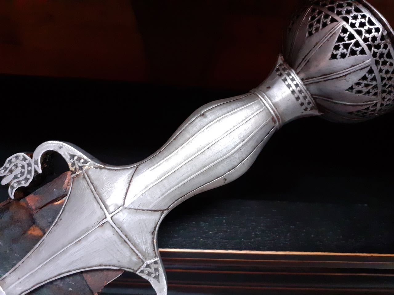

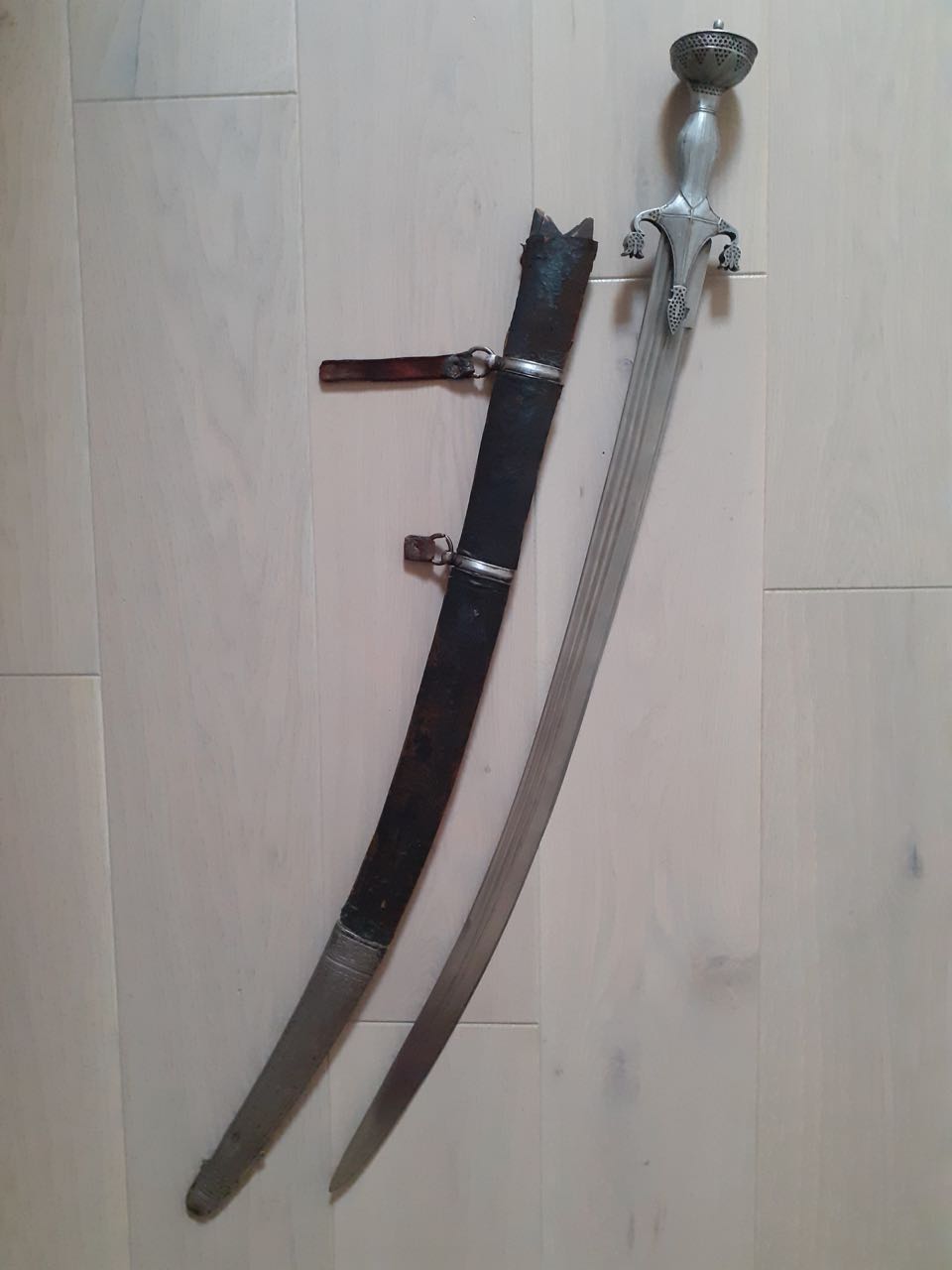

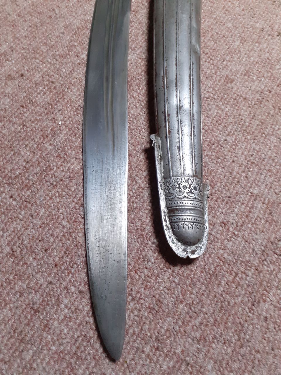

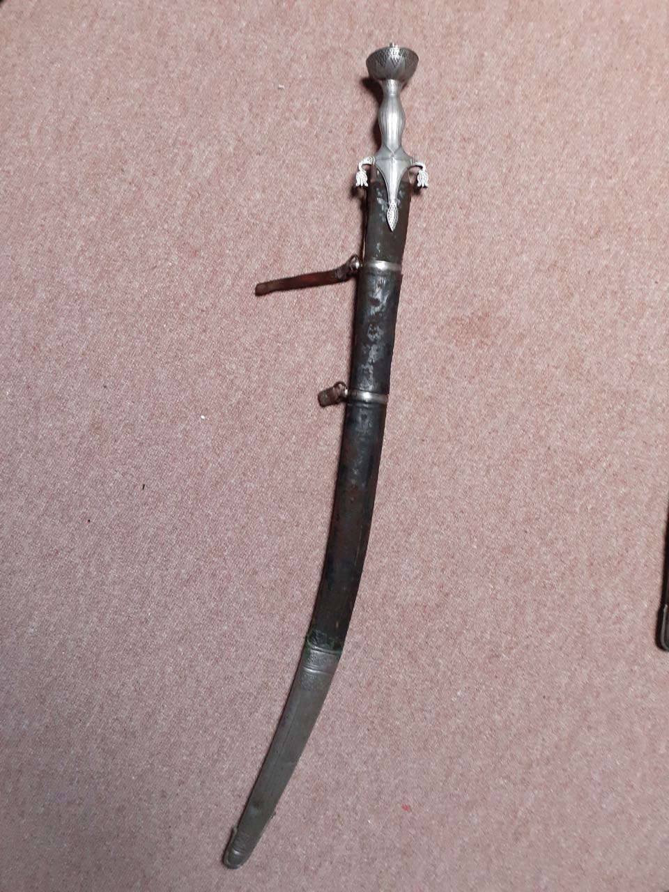

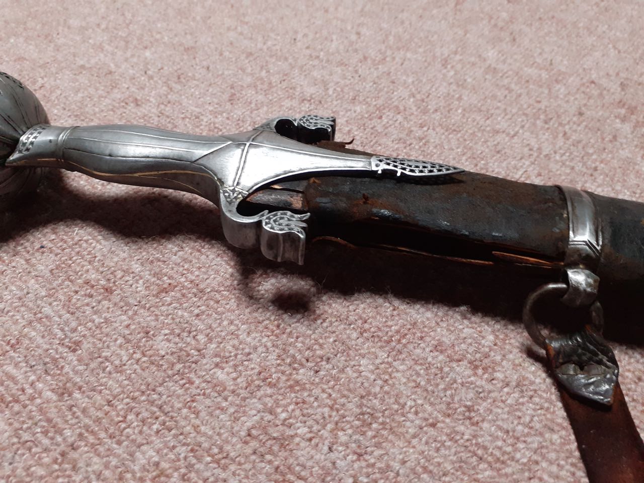

Hello gentlemen,
I received this large pulwar sword,
I trade this sword with other stuff,
it wasn't inexpensive but I think it's a good piece.
The hilt is finely crafted and
the blade seems made of good quality

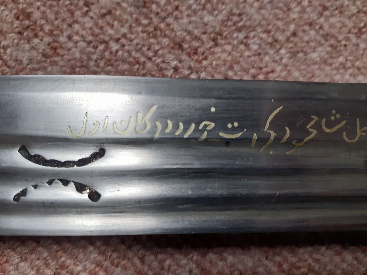

there is on one side an interesting
arabic script inlay ( gold )( maybe it's afghan not classical Arabic ).

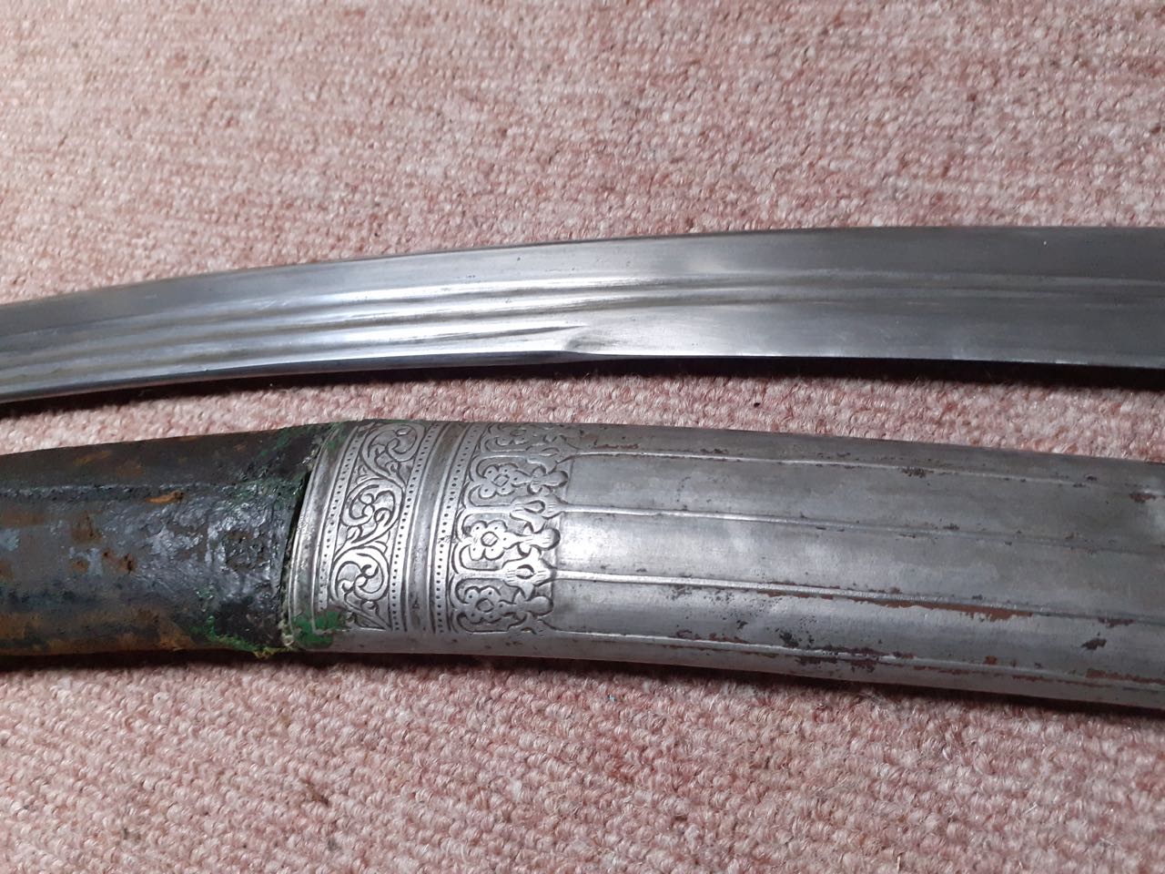

sadly the wooden parts of the scabbard are worser than I thought,
the large tip mount is interesting too ( really rusty,
I clean it a little... )

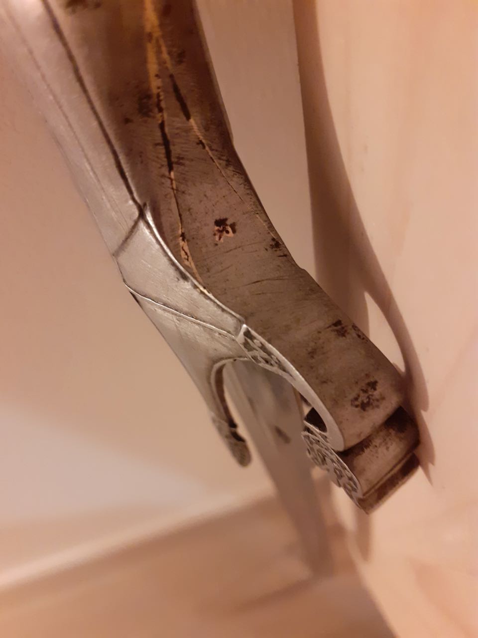

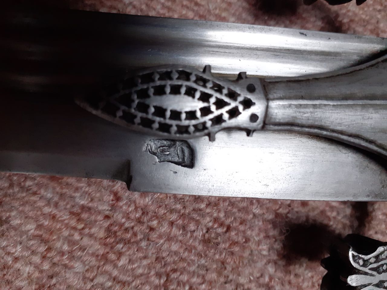

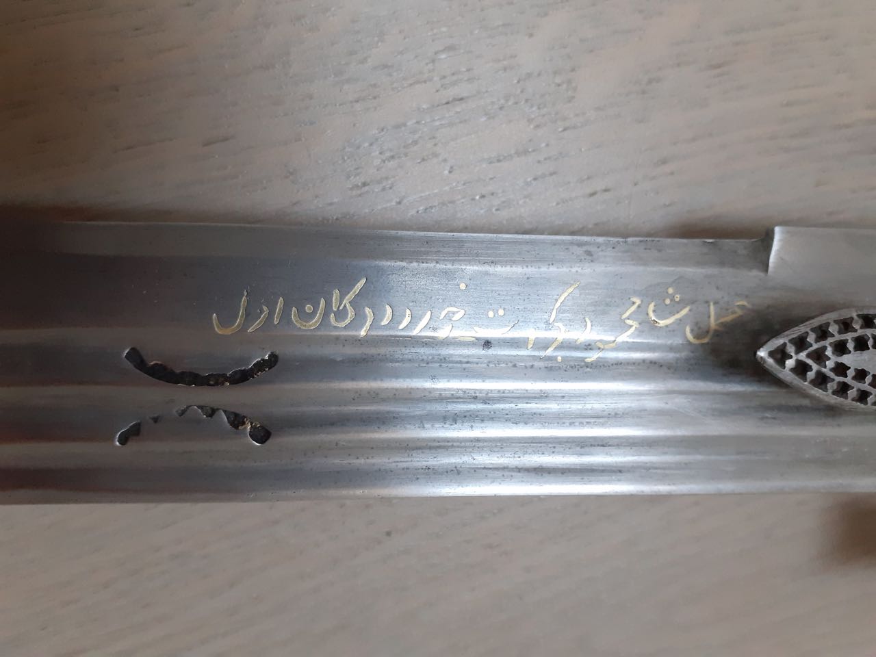

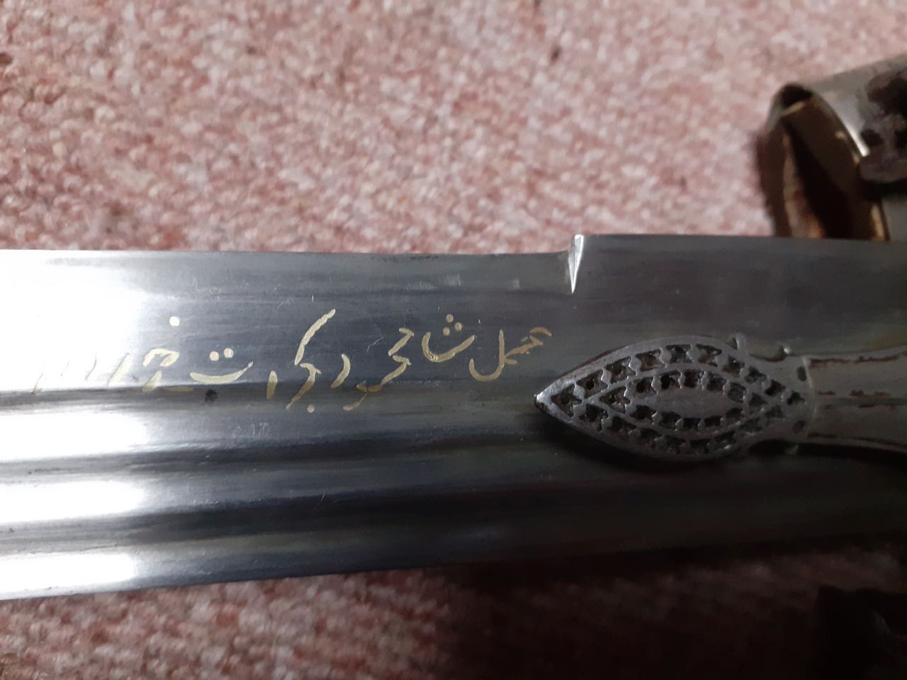

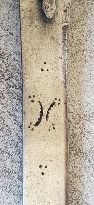

There are two eye lash marks
and on the other side an interesting stamp at the basis of the blade
( cf picture )
For me it's an indian blade with this mark
but for the seller it comes from Persia...
Does anybody know were this arsenal (?) ''stamps'' mark come from ?
Any Idea about age ??
Difficult to me to give a date, ( so maybe the translation will help )...
The blade seems ''recent'' because it's really in nice conditions
but the scabbard was on the opposite, poor conditions ( maybe just stored in a wet place for a long time...)
and the well crafted hilt seems older...
Maybe beginning of 20th century ?
What do you think ?

Old 6th June 2021, 09:02 PM   #3
Posts: 10,281
Nicely crafted but quite modern version of the well known Afghan sword mostly of late 18th into 19th c. termed 'paluoar' a term which is indeed of Persian etymology.
The 'eyelash' or 'sickle' marks (twin dentated arcs) are a well known mark which apparently began centuries ago in North Italy (mostly Genoa) but were copied in Styria (Austria) and the Caucusus later.
They were regarded as 'quality' or 'magic' imbuements on trade blades used in many native contexts, but in these northern regions of India, it seems they were consistently used on these Afghan swords.
Actually these interpretations on this example are not near the original form typically seen, but are faithfully applied in this interpretation of the sword type.
The deeply stamped cartouche at the forte near the langet is placed also faithfully in the manner of many North Indian tulwar blades in which there are often inscriptions or symbols usually in Urdu, but as far as known, are not arsenal or makers marks.
I cannot help with the translation, but look forward to what it says.

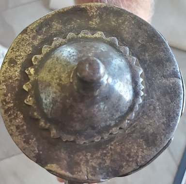

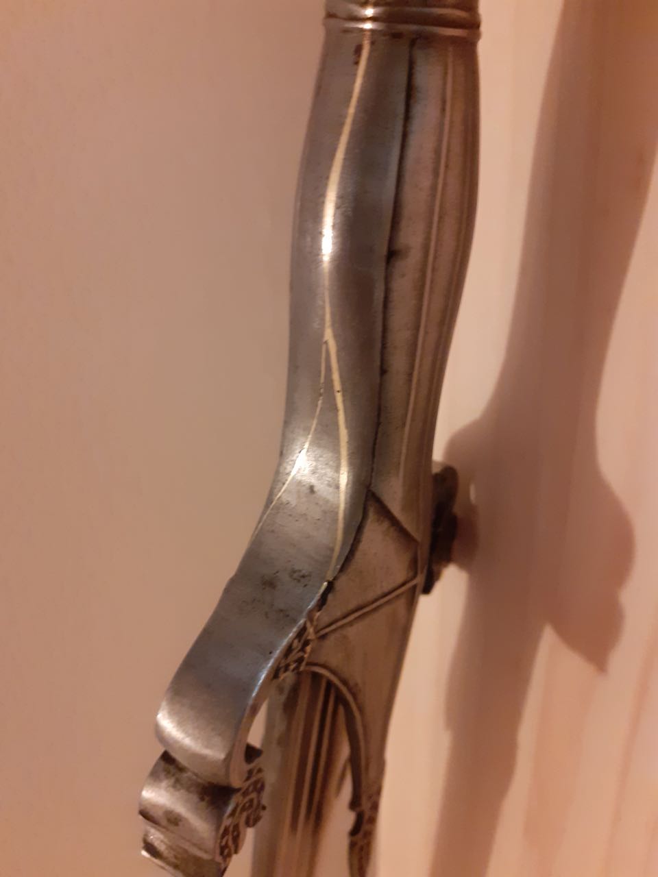

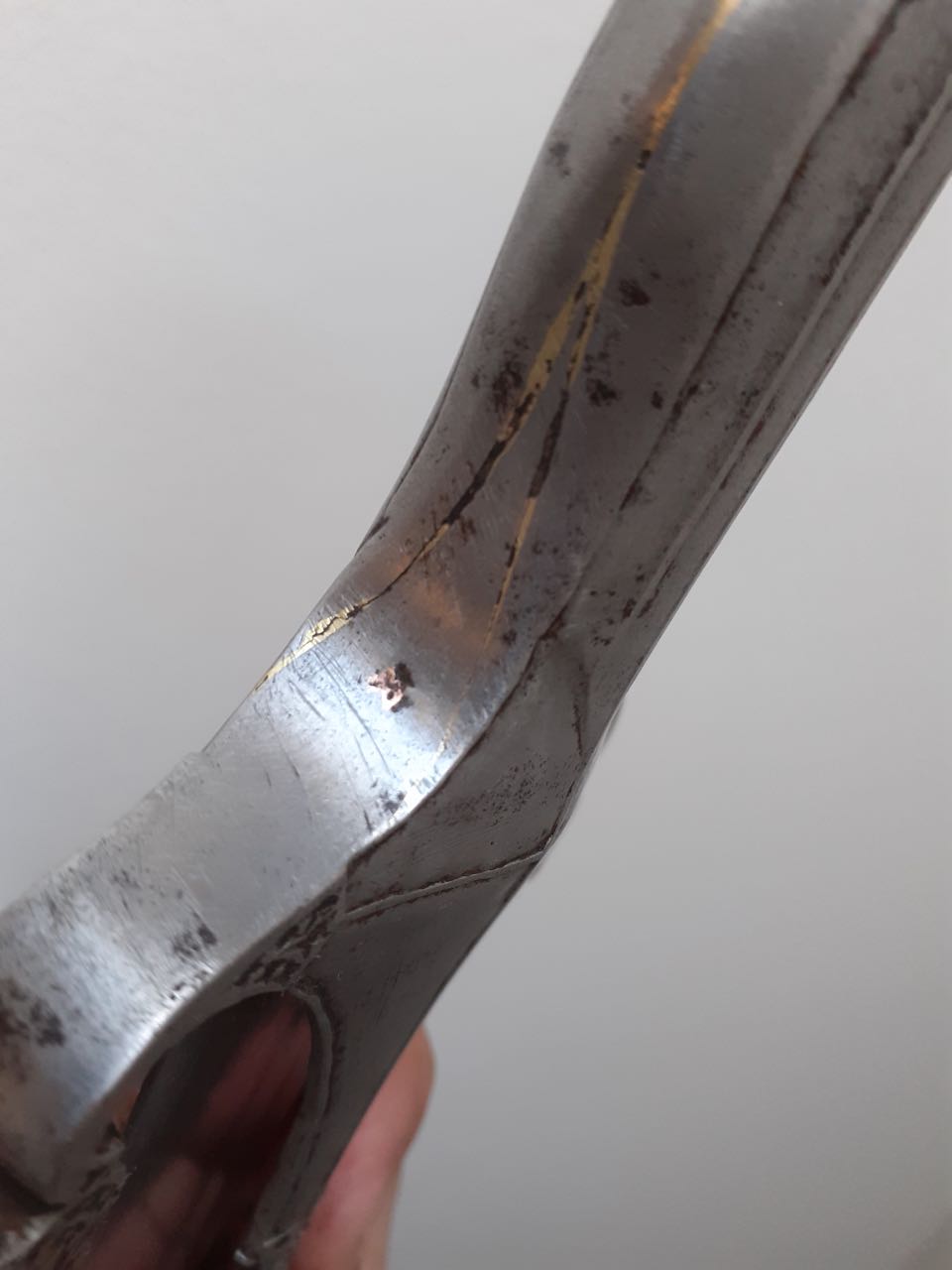

I'll try with a few more pics:
the engraving and rests of gold in the eyelash
and a gold or copper mark on the hilt ( under the rust )
( only one side...) : something like an X or a double greek epsilon in capital letters...

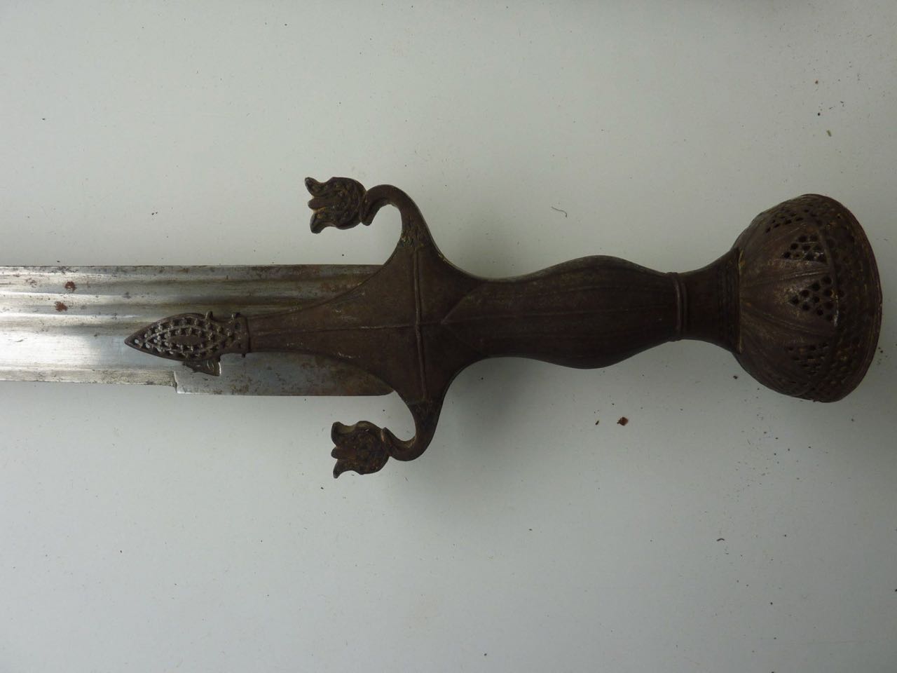

I have a pulwar with the same kind of blade, but without the inscription... damnit!
One forum member is an expert and wrote a book about Afghan weapons, I have to find the book...

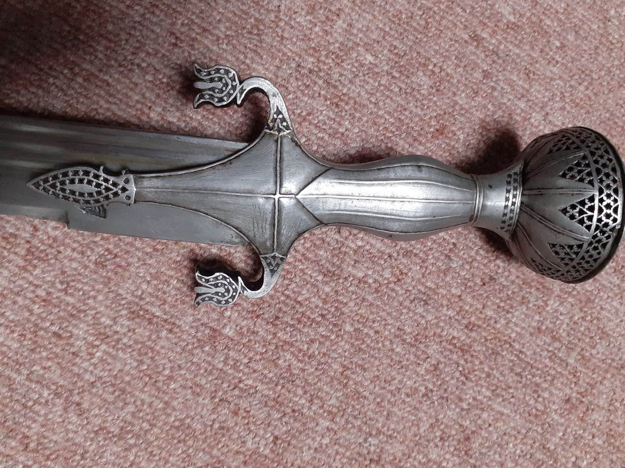

I mostly agree with Jim about the relative " newness", and I think we need to look at the separate parts.
The chape: it has a drag, which is a purely European feature, acquired by the Afghanis from the British military, late 19-early 20 century and continued later.
The blade is Indian, which is no brainer: there are scores of Afghani pulwars with imported blades. It carries Indian stamp, but no Afghani ones. It looks either pristine or grossly overcleaned. I am surprised that there is no rust/patination under the langets: these areas are the most difficult to clean. No pitting, the edge is intact. No signs of repeat sharpening. Brass inlay is very clumsy, with no losses whatsoever. The blade does not seem to go down into the scabbard all the way. Am I correct?Dry wood? But with all of the above I have a nasty feeling that the scabbard was not made for this specific blade, on the contrary the blade was chosen as best as they could for a particular scabbard. There is a stark contrast between the condition of the scabbars'd metal parts ( bumps, patination, discoloration, some losses, rotten dry wood etc) and the pristine condition of the blade.
The handles are easily available and present no difficulty to combine with a blade. Again, no patination or pitting at all. I would be most interested in the condition of the filler: full, smooth or dry, crumbly, with areas of losses? BTW, what is the material of the filler? The old way to prepare the filler was to mix lac, a little bit of wax and crudely powdered bricks or such, and those are easily made locally, and the filler doesn't hold intact forever.
Overall, I have an uncomfortable feeling that this sword is an assembly of a relatively old scabbard ( end of 19-beginning of 20 century) with much newer blade and with overcleaned (?) handle of uncertain age. Manufacture of "antique" swords is perhaps one of the main sources of foreign currency in modern Afghanistan, with the exception of opium. That part of the world is awash in spare parts for whatever weapons one's heart desires, and Indian/Pakistani/Afghani armorers are also in great supply.
My 5 cents. A disclaimer: I could be able to express a more accurate opinion had I been able to hold this sword in my hands. Dating antiques by examining pictures is a dicey proposition.

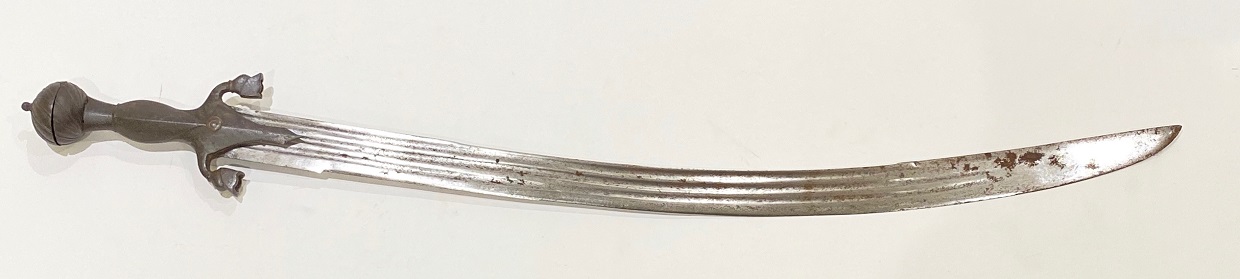

The only forum member who could answer with precision to your question is Mahratt.

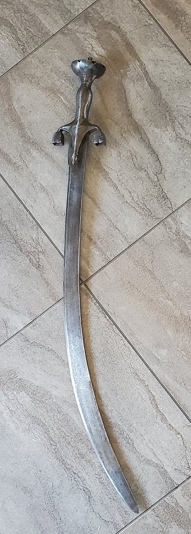

Here is the pulwar that I mentionned: you should post your sword the same manner to compare the blades.

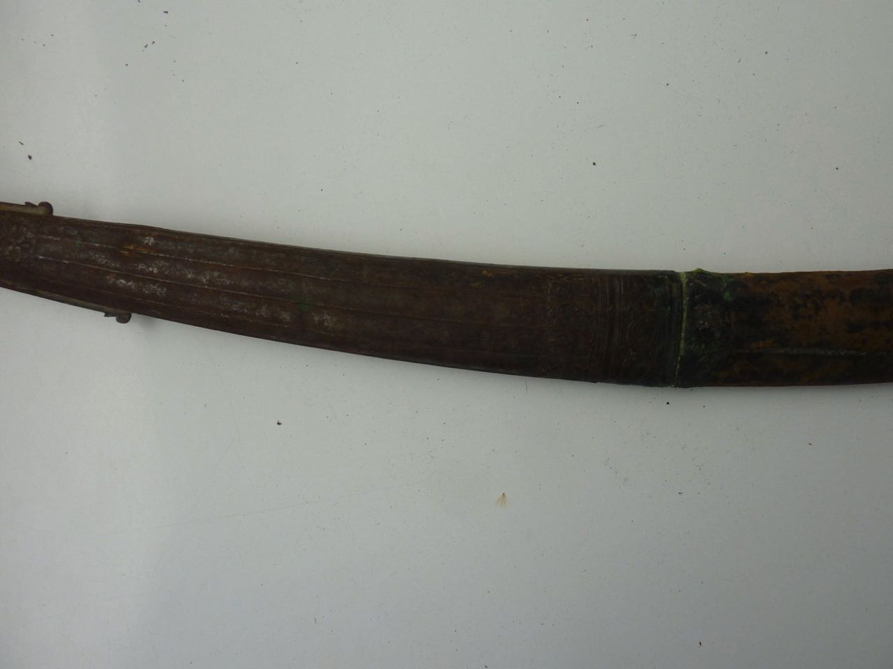

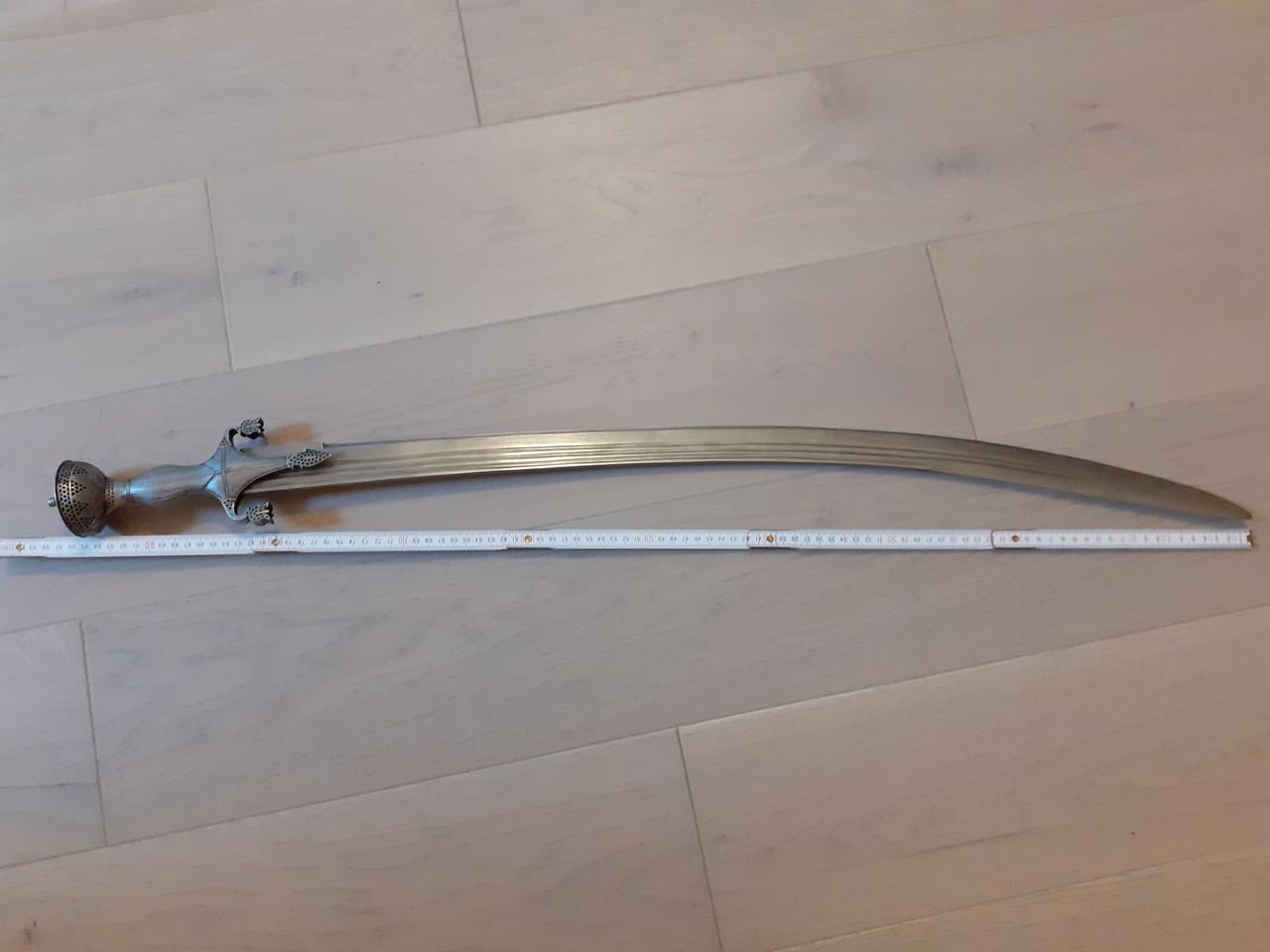

Thank you for the comments,
It needed more informations about the sword:
an heavy sword weight 1080 grams
length 98cm, 103cm with scabbard
The blade fits good entirely in the scabbard ,
just the end of the the scabbard was really bad preserved as I wrote ( humidity...) I think there was a metal chape before...
the blade maybe was polished later when they did the engravings for the afghan sentence ?
I think end of 19th century for this sword is right,
the indian blade, don't really know ...
Thank you Jim about the Indian Urdu cartouche

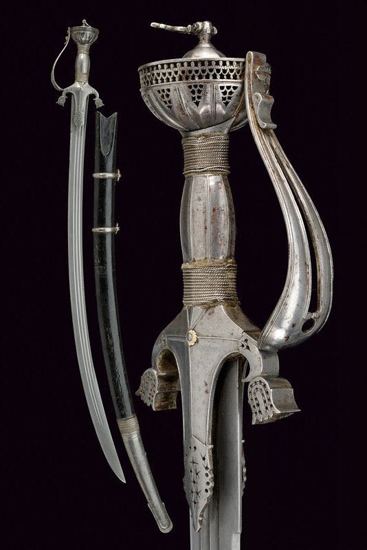

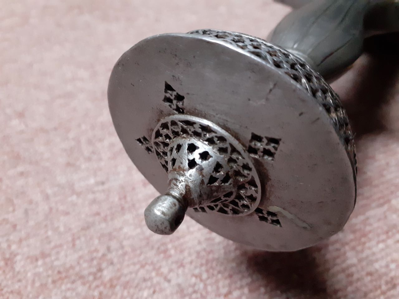

About the hilt, maybe not too old but it is really finely crafted and of higher quality than average pulwar hilts I think,
I saw a few sword with all these delicate holes/perforations, One similar sold by Czern'ys, another from Mandarin Mansion, ( thank you for the pictures !)
( Inside there are too 'small 'stones'' inside who makes rattle sound,
I read it could be Mecca stones...)
I am the overcleaner and remove rust from everypart ( too under the langets ),
some might say I wouldn't to and perhaps it has less value like that,
but I couldn't leave it like that: cf pictures ...
we can see that the blade was already in better conditions than the rest of the sword before my ''wash'' ,
that's what surprise me first too the blade was maybe polished later
( when they did the engravings for the afghan sentence ? If it's afghan... )

As Ariel has noted, the 'industry' of creating representations of traditional weapons is well known in Afghanistan, particularly in Khyber and Northwest province regions, and has been since mid 19th c.
I had not noticed the 'drag' on the chape, a distinctly western affectation reflecting the move to western influences post 2nd Afghan War (1879-80).
By this time Afghanistan had become controlled by Great Britain much as in the Indian Raj, and the military was augmented by native units as well as the use of British uniform elements and weaponry.
The Khyber knife was vestigially replaced by European style hilted short sabers, though these hilts were also placed on the heirloom blades of the Khyber knives in many cases.
The inscription on this blade is likely in either Dari Persian or in Naskh if in Pashto. Unfortunately I cannot translate.
The 'mecca stones' are an unusual affectation in these (I think Ashoka had one) and these are known in pommels of late 19th c Sudanese swords, so possibly a Sufi feature?
On a personal note, my preference is to avoid overcleaning swords, primarily because I am a historian, and removing patination is to essentially remove history itself in a sense. Naturally it is important to stabilize a weapon from any active corrosion or rust, and add any minor repair to maintain the integrity of the weapon. However over cleaning and alteration typically remove the elements of the 'adventures' the weapon has gone through over time and its working life. Just my thoughts each collector has own preferences.

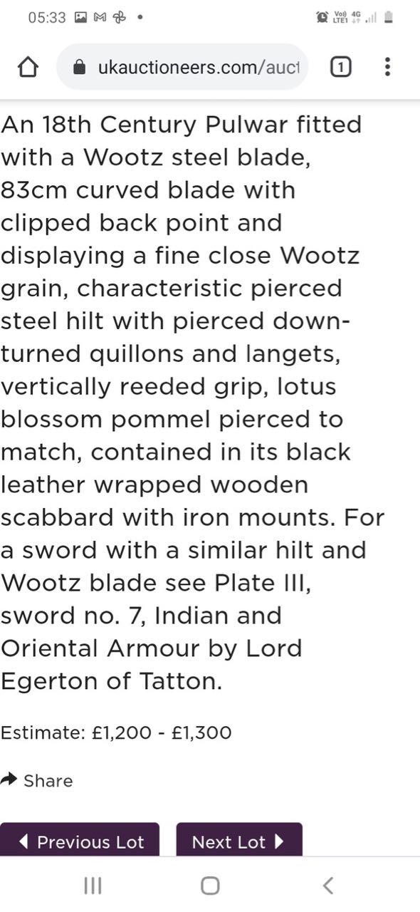

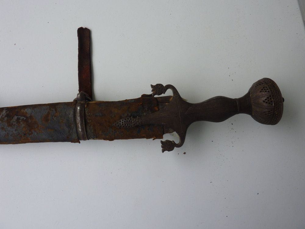

Hello all,
Glad if Kwiatek can help !!

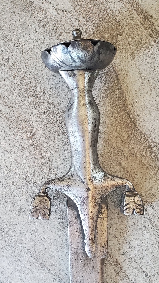

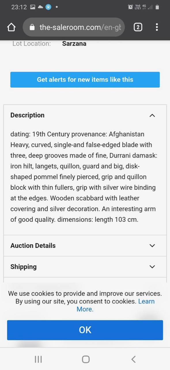

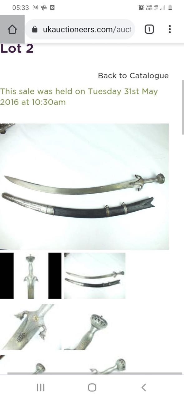

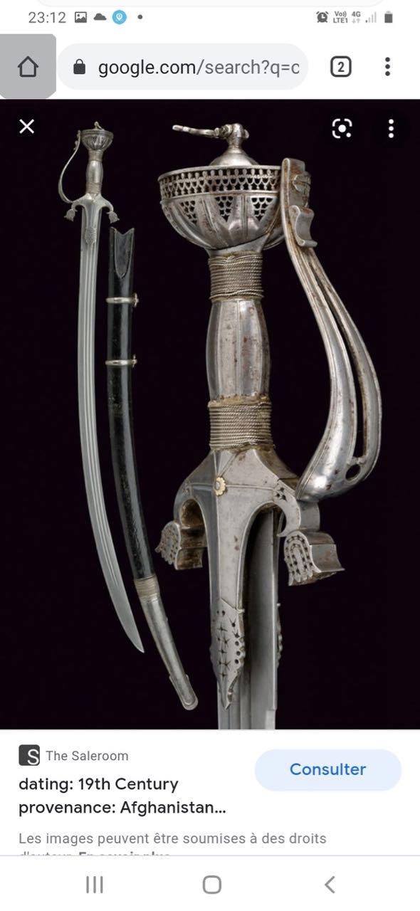

I post other picture about what I found in my internet ''hunt'' for pulwars with similar hilt and scabbard,
found two,
I think, 18th century is exagerated by the auction house

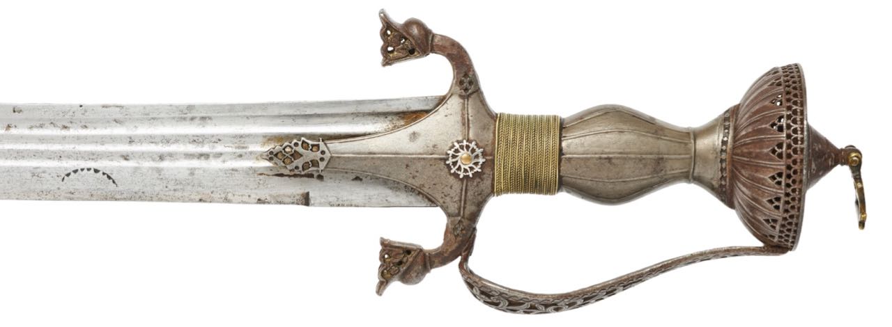

( and the blade is different and made of wootz )
but I put the picture because they wrote to compare the almost similar hilt, to have a look on this book:
Indian and Oriental Armour by Lord Egerton of Tatton,
Plate III, sword no 7
Somebody has got this book perhaps ??
Kind Regards
Old 17th June 2021, 11:32 PM   #23
kwiatek
Join Date: May 2019
Posts: 156
I cannot make sense of this as Arabic or Persian, though there are Arabic/Persian words in it. The first words look like
عمل شاه محمود
'amal-i shah mahmud
'Work of Shah Mahmud'
and the last word is اول
awwal
'first'
What comes in between I can't help you with I'm afraid!

Hello Kwiatek,
Thank you for time and help !!
