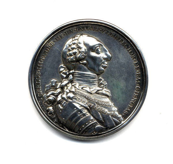

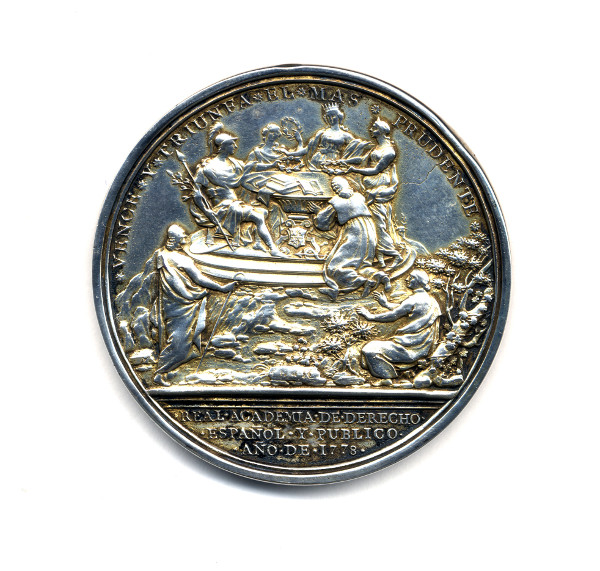

Here in Florida it is probably more humid. Some of my silver items tarnish quickly, while other don't seem to tarnish at all. Renaissance Wax does seem to help.
Without any care this Carlos III Silver Medallion 1778 never seems to get more tarnished.
https://plus.google.com/+DanaWilliams/posts/LVBivww5SbQ
