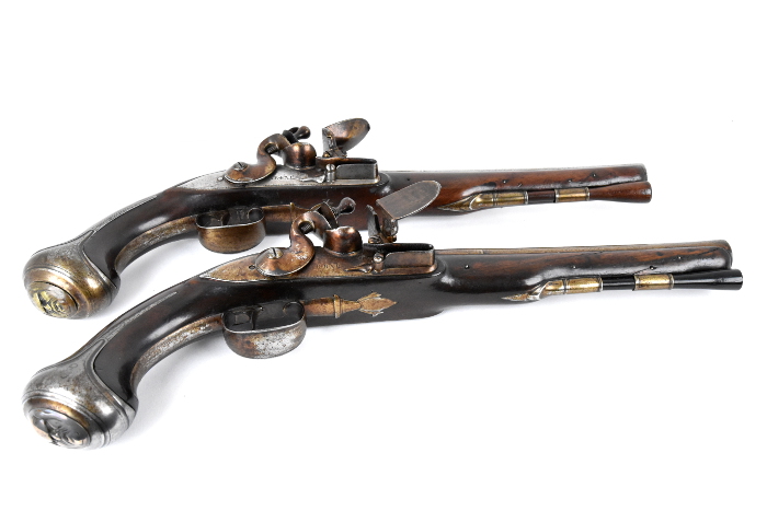

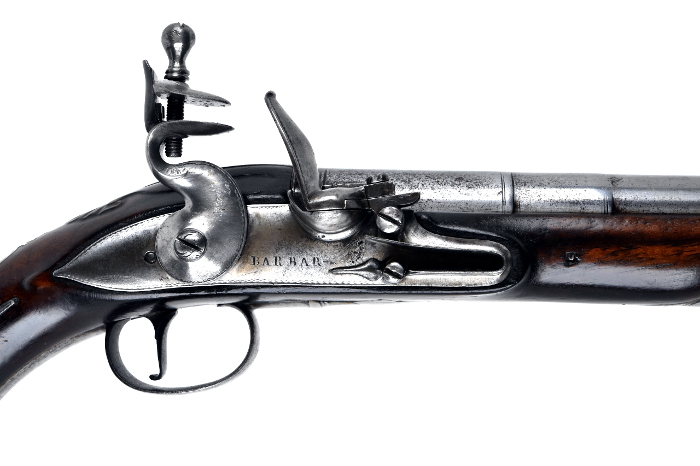

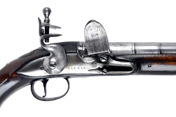

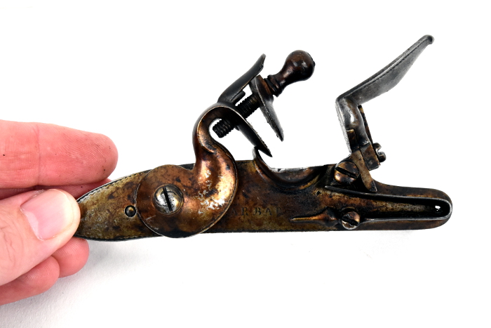

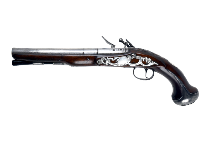

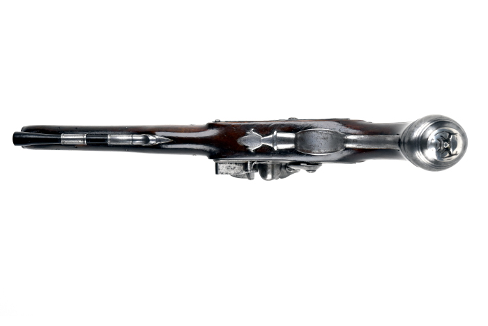

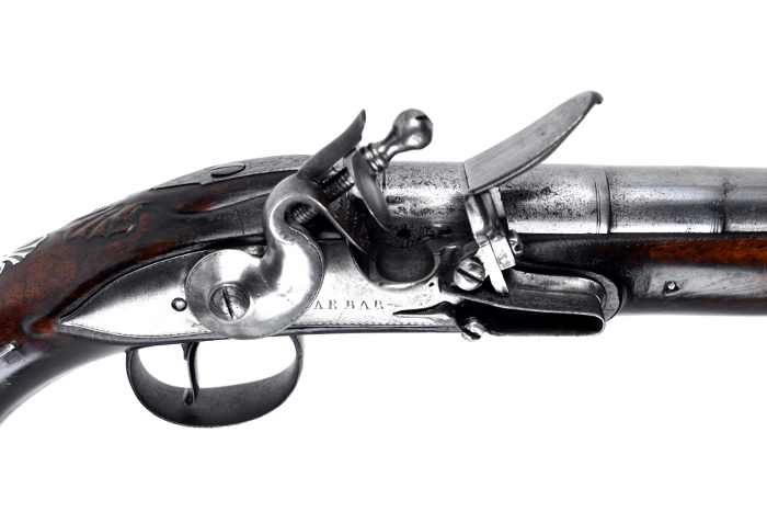

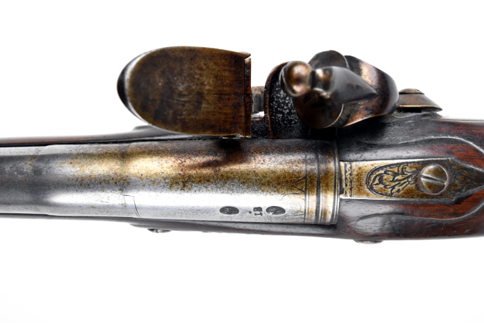

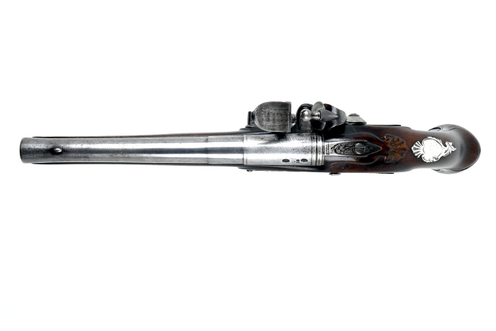

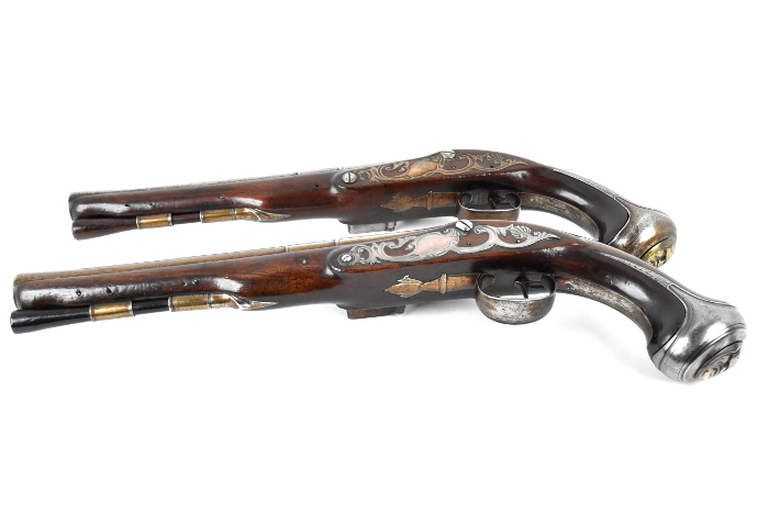

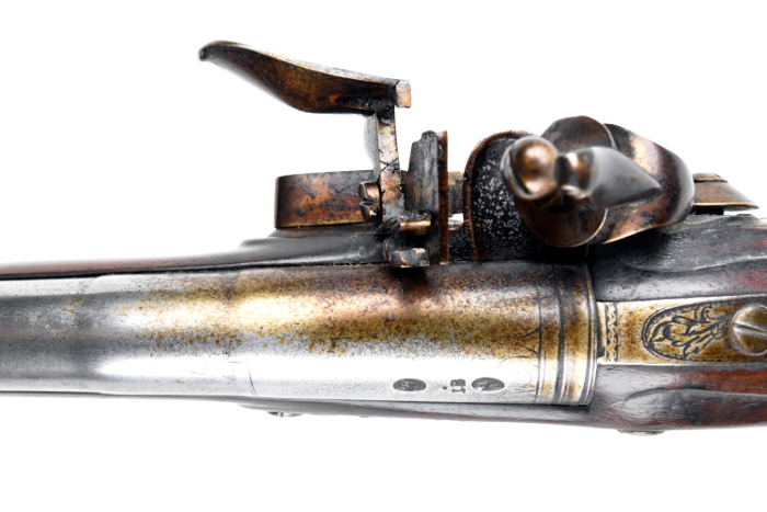

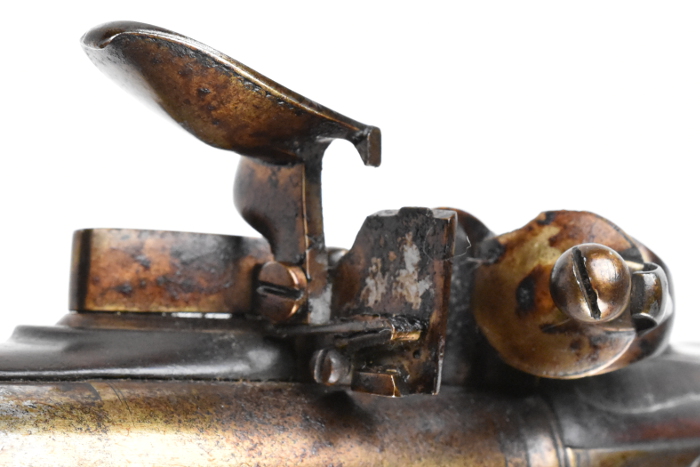

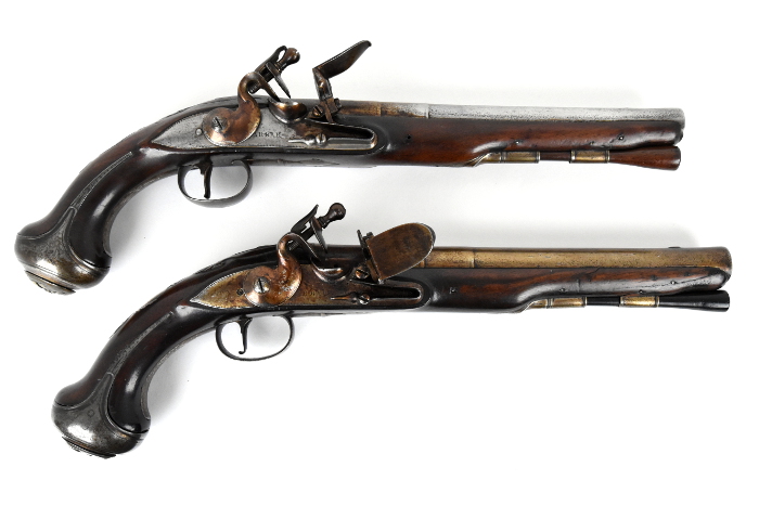

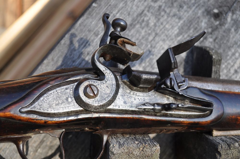

This pair of silver mounted flintlock pistols have a very unusual safety mechanism. The Frizzens can be swiveled out of the path of the hammer. Along with British view and proof marks, the barrels are marked with a star over "IB". This is the maker's mark of the highly regarded James Barbar.
http://weaponscollector.com/j_barbar_c1740.php
Unfortunately these pistols are covered with a dark brown substance which is believed to be dried linseed oil. A few years ago Cheaper Than Dirt republished an article on firearm preservation by Springfield National Historic Site and National Park Service. To quote that article “When linseed oil oxidizes, its molecules cross-link with one another, making it increasingly more difficult to remove as time passes.”
http://blog.cheaperthandirt.com/cari...toric-firearm/
I would like to clean these pistols. So far I have tried using fresh boiled linseed oil, WD-40, turpentine, and (God forbid) lighter fluid, all without any notable success.
Has anyone seen an antique weapon preserved in this way? Does anyone have an informed suggestion on how to safely remove the ancient dried linseed oil?

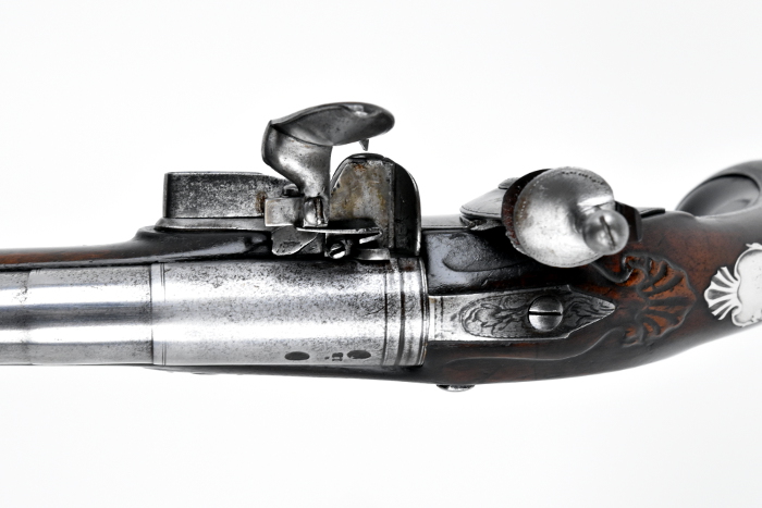

Thanks for sharing these very interesting pistols. Did you know that swiveling frizzens were pretty much the norm on many early flintlock mechanisms from the Baltic countries, especially Sweden, from the mid- to late 17th cent.? There are several examples showing various stages of development and refinement in H. L. Blackmore, GUNS AND RIFLES OF THE WORLD (1965), figs 137, 139, 141-45. On all of these, the pan-cover and the steel were attached to each other via the swivel-screw. The design allowed the gun to be carried safely with the pan primed and closed, and the cock lowered with the steel pivoted out of the way, with no need for a half-cock detent. I would imagine that the locks on your pistols also have a half-cock safety notch on the tumbler as well.

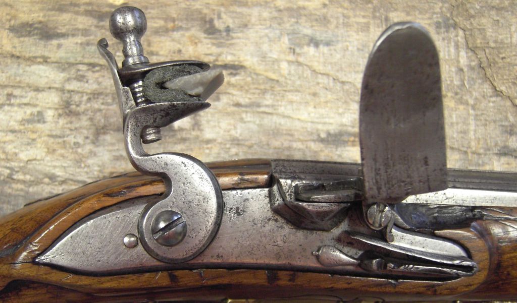

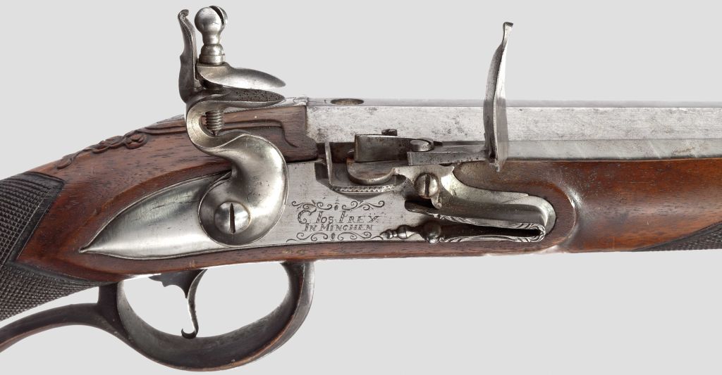

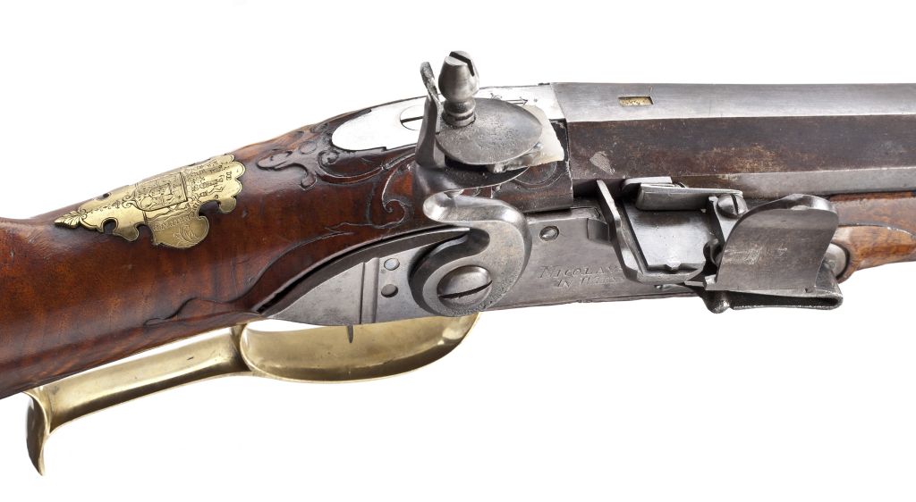

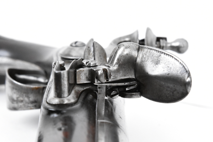

This safety system is rather often to be found on German and Austrian flintlocks as show the fotos of a gun by Christoph Frey, Munic, a pistol by Wenzlau in Koblenz, a carbine by Niklaus Koch of Vienna and an unsigned military officer's carbine of Saxony.
corrado26
corrado26
Thanks for the great photos corrado26. It is helpful to see some other examples.

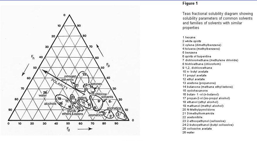

I've been musing on your problem for a while and was wondering if I might be able to lend a hand.
One of the tools conservators use (I hasten here to add that I'm a mere assistant curator, not a conservator, mind you) is the Teas fractional solubility chart. This is a handy diagram that (although it has flaws and limitations) gives a roughly accurate idea of the relationships between properties of different solvents. There's a pretty good Teas chart here.
Anyway, looking at what you've used to far, it seems likely that your solvents have all tended towards the bottom right of the chart; while I'm no chemist by any stretch of the imagination, my understanding is that these solvents all work in the same way, and in this case that's primarily by London dispersion forces acting to force the molecules of the solute apart from each other. On the diagram you can see turpentine and benzene (which I'm using as a rough approximation for lighter fluid in this post).
I'm wondering if you might get better results from a solvent which has higher polarization (Dipole) or hydrogen bonding (I believe aka Keesom) interactions. Unfortunately, the solvents with high hydrogen bonding forces are also alcohols, probably not very good for the wood of the stock as they will displace water and then evaporate, leaving it excessively dry. As a suggestion, you could try to find some of this "Cellosolve" stuff mentioned on the chart.
For the metal parts, I'd try acetone as a starter if they can be detached from the stock. Again, acetone can be bad for wood (it's used as a water displacer during wood conservation, for instance - not a quality that recommends it unless you're planning to replace that water with something, since the acetone will evaporate and be lost quite rapidly) and I would suspect that its fellow ketones are no better, so detachment is highly recommended.

Meredydd, thanks SO MUCH for contributing the Teas Chart. I will re-post it here just in case the link moves in the future.
The locks are not too difficult, but I have a lot of concerns about attempting to remove the barrels and furniture from these 275 year old pistols. Of course I am also concerned about using harsh chemicals near the wooden stock.

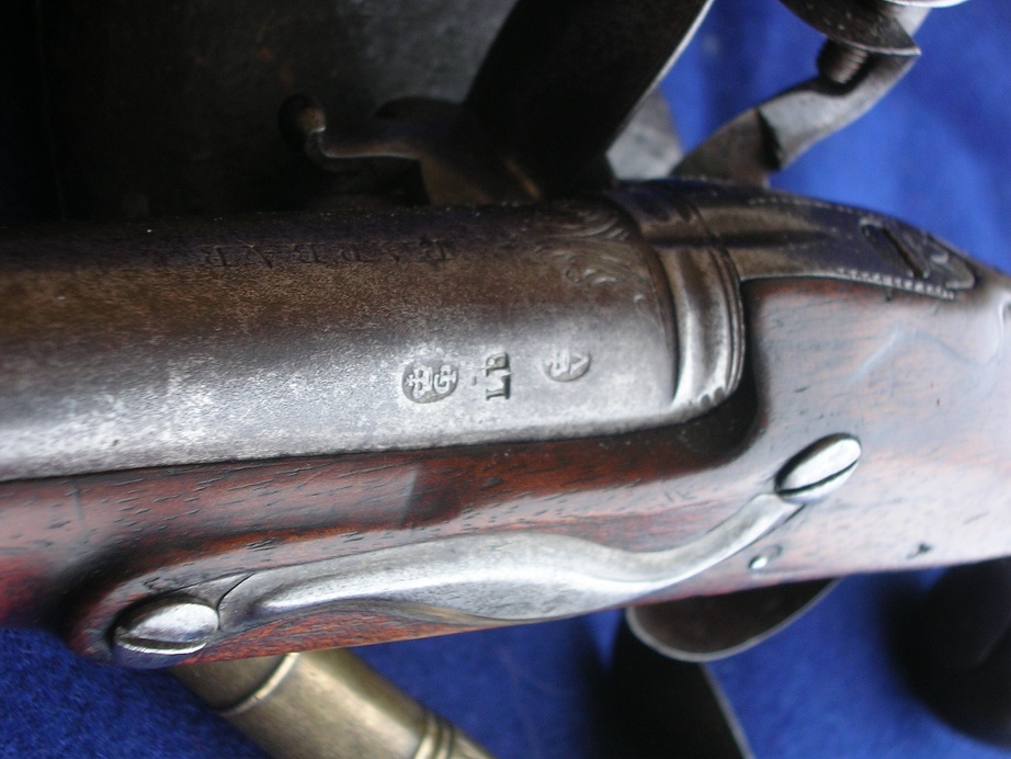

Very nice pistols Dana.
Beautiful and elegant, and I am pretty sure Lewis Barbar, as the "dot" abobe the initials would be a star for James. The L is likely just poorly struck.
Sideplates of this type are beyond all the others in my opinion!
For cleaning the metal;
There is a substance called Circa 1850 furniture stripper.
(Please bear with me!.........furniture stripper sounds horrific I know!)
If a little is dabbed on the Metal, not the wood, it will lift the dried oil more or less straight away.
It does not touch patina, bluing or browning, and does not require rinsing or anything afterwards.
Even on wood it will not hurt it, but will possibly remove old wax finish and you will not likely want to do that.
I'd suggest trying a spot or two in more hidden areas, and see what you think.
Again, beautiful pistols, as nice as they come.
Attached is a picture of Lewis Barbar's mark, and am sure this is the same mark on your pistols.
Thank you for showing them here Dana.
Richard.
Trust me on this Richard, it is a Star over "IB". When I have a chance I'll upload a closeup.

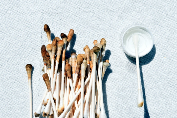

The hard thick brown substance proved very difficult to remove, until my friend Bob Calder recommended a product used to remove linseed oil from old paintings. That product's active ingredient was ammonia, and ammonia proved to be the answer to my dilemma. A day and several hundred q-tips later the first of the two pistols is ready to be rephotographed.
All photos are copyright (c) 2016 Dana K. Williams. All rights are reserved.

Old 20th April 2016, 07:21 PM   #25
dana_w
dana_w's Avatar
Join Date: Nov 2012
Location: Southeast Florida, USA
Posts: 437
I talked to a lot of well known collector's before deciding to remove the nasty linseed oil, and I am happy with the results. Anyone else think that they should have been left the way they were?

Dana: Those are a great looking pair of pistols. And I'm glad you found a solution to the cleaning issue. They sure turned out nice. So much better without that old, hardened oil. Your decision to clean the metal parts in the fashion you did sure gets my vote. And thanks to all for the knowledge on the saftey frizzens. Most interesting.
Here is the stainless scrubber that Philip mentioned. It does in fact work better and faster than steel wool. Terrific item.
