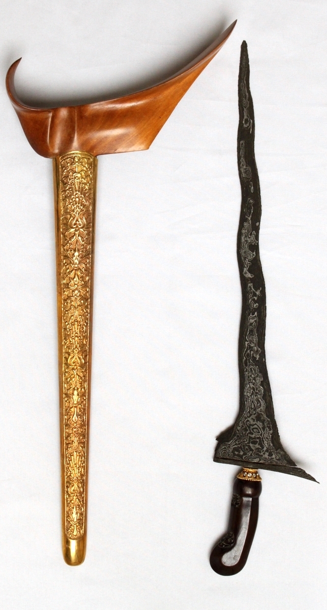

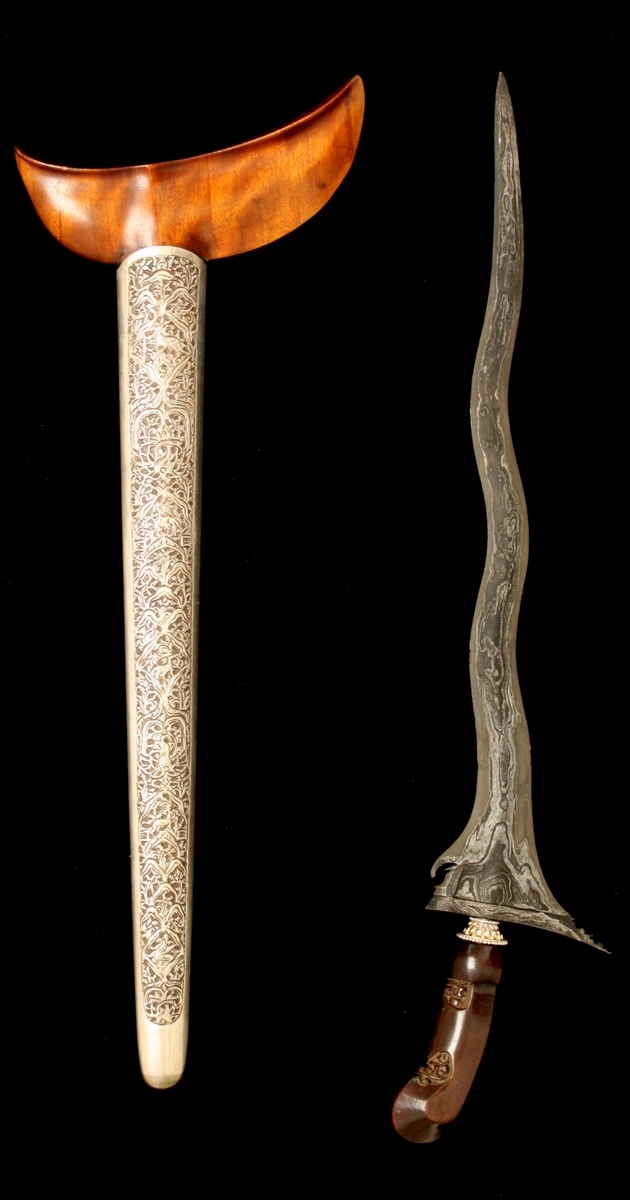

Originally Posted by tunggulametung
I'm not specifically speaking about the keris under discussion, or Detlef's example, but Javanese tanggalan sheath is often made from repurposed ladrang sheath, just as nguku bimo on telale gajah. In fact, I personally think this is the origin of the design. The Sumatran/Malay example is another.
Hello Chandra,
This is an interesting opinion, however looking at my specimen and one typical warangka branggah from Yogya, I find it difficult that the tanggalan warangka could be reshaped from a branggah one for several reasons:
. The front part of the tanggalan warangka is more protruding and rounded than the branggah
. The tanggalan warangka is more curved on the top than the branggah
. The groove on the front side is different
. The rear part of the branggah is slimmer and flat at the bottom and it looks difficult to re-sape it to a tanggalan.
What do you mean by Sumatra/ Malay example?
Thanks and regards
Jean

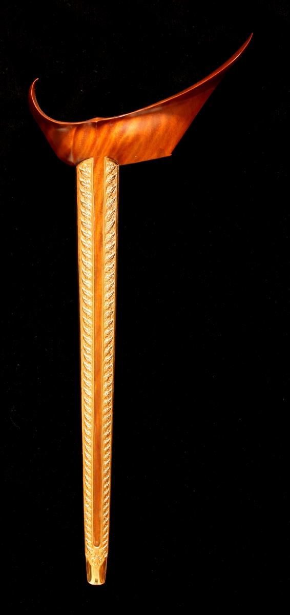

Jean, forgive me, but TA said that in his opinion the origin of the design was from reshaping a ladrang, not that all tanggalan were from ladrang.
In fact damaged ladrangs were the origin of a second type of wrongko also, the Madura/East Jawa kacir, but as with the tanggalan the kacir became a form in its own right.
Actually, I have a bit of a problem with this name:- "tanggalan".
I'd never heard this name used until I saw people on this Forum using it, then I found it in Ensiklopedi,published in 2004. It was not in the first edition (Ensiklopedi Budaya Nasional) published in 1988.
Through the 1970's, 1980's and 1990's everybody I knew in Solo called this wrongko form "wulan tumanggal", and they probably still do today, although its been a while since I've used or heard the name there.
The word "tanggalan" means "calendar". So this is a "calendar wrongko" ??
On the other hand, "wulan tumanggal" means "new moon", a name which to me seems very appropriate and perfectly understandable.
"Calendar wrongko" ?????
