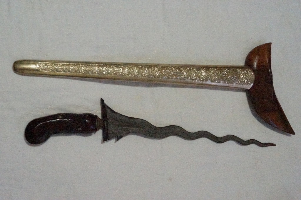

This is Peter, I've just recently found an interest in Keris not too long ago, back in last September while visiting Bali and upon searching for local antiquities.
I have a couple of Kerises that I want to share with you: the Carito Keprabon Luk 11 of Pajang era (1568-1586 CE) and 1800s Singa Barong Luk 5 with Kanjeng Kyai Pamor (Prambanan Meteorite).
But for introduction, I will share you the Carita Keprabon in this thread while creating a new thread later on for Singa Barong
The Carito (or Carita) dapur models (there are several different kinds of keris Carito) is a typical dapur of the keraton of Yogyakarta. It was a very popular dapur in the early Mataram era, and the model has influenced the later dapur Sabuk Inten.
Both the Carito and Sabuk Inten kerises are similar in meaning, for they are mainly aimed at wealth increase and prosperity. I purchased this Keris (Carita Keprabon) from an abdi dalam (an ordained member, or royal servant) in the keraton (royal palace) of Yogyakarta through a seller.
To this day, Kerises are regularly cleansed in various rituals performed at the Keraton. Upon receiving the Keris, it did and still does have a mild flowery scent to it. It is possible to confirm that this Keris have been used for similar purposes, and thus is considered sacred pusaka (heirloom) item.
This keris has Pedaringan Kebak pamor. The meaning of this type of pamor (pedaringan kebak) is basically surplus of wealth. It can be roughly translated as 'a shed stuffed with rice'. This pamor is very similar to Wos Wutah, but Pedaringan Kebak is of a much higher quality and thus is more difficult to forge, for the motif is more refined than that of Wos Wutah.
Pedaringan Kebak is made using the 'mlumah' forging technique, which is more time consuming than the more commonly used 'miring' forging technique. For the rest it is classed as pamor tiban, which means that this pattern is not intentionally created by the empu, but merely is a 'by-product' of the extensive forging process.
The keris comes with a traditional hand-carved Timåhå wooden sheath, also known as warangka Branggah Yogyakarta.

I will wait for others to comment on some of your details here. I will pass on a saying we use around here often though. Buy the keris, not the story.
I would not get too attached to the idea that this is somehow a keris connected to the keraton, for instance. The use of scented oil on keris is quite common and does not necessarily indicate such any such connection. Keris salesman in Indonesia will attach many different tales to their wares to boost their sales. What you do certainly have here is an authentically old keris. I sincerely doubt, however, that anyone can pinpoint the date of such an old keris to an 18 year period of time.

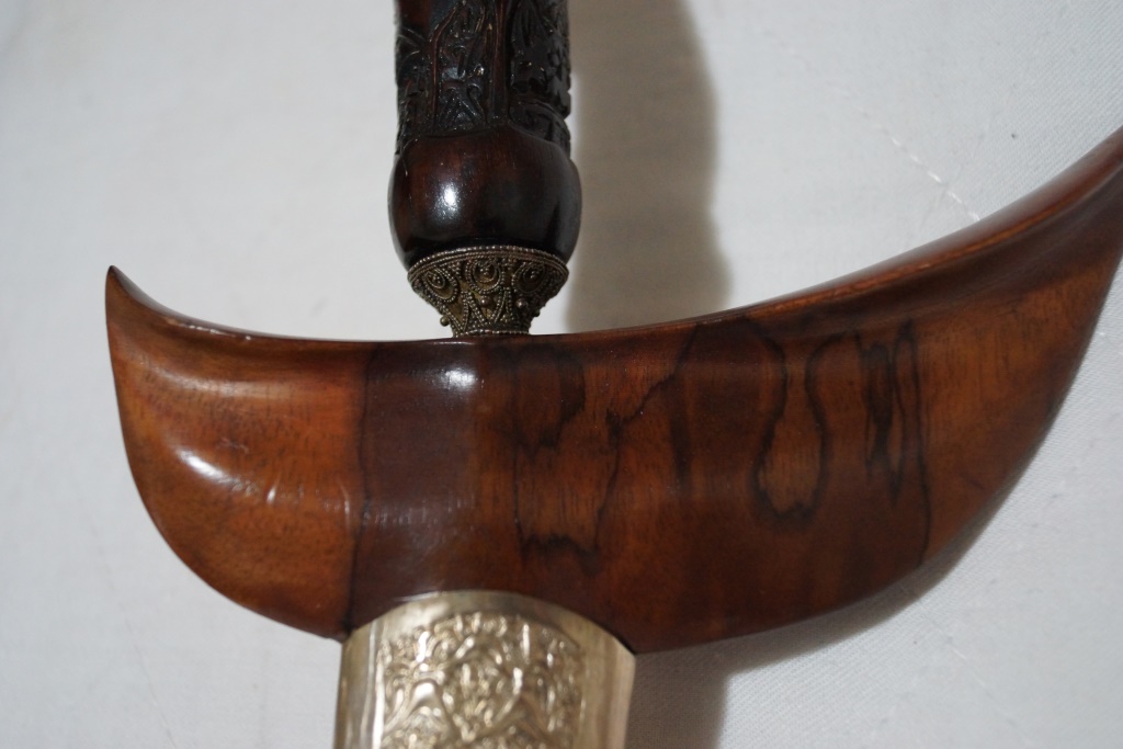

Better photos would be nice for better identification. It appears to me that your wrongko was once a ladrang style that has been greatly reshaped, probably due to damage to the original form.
I look forward to seeing your keris singo, but would not hold on to the hope that it has used pamor from the Prambanan meteorite. Such material was reserved for truly high level court pieces. If indeed you have one of those you are a lucky man.

Would like to see better pictures of your keris. But you are wrong in matters of the sheath. This sheath form is called tanggalan and attributed to the sultanate of Demak. And I also don't think that the sheath is a reshaped ladrang sheath like David assumed.

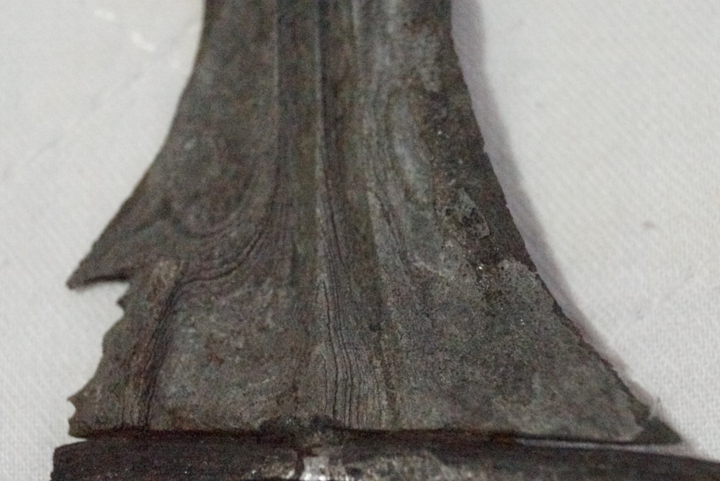

Interesting, aside from my obvious puny of a talent in photography, I'm afraid I'm also a terrible sucker at Javanese history. The philosophy in the Keris itself, how it's made and the intricate meanings of its shapes and pamors, etc that make me fall in love.
This pamor (Pedaringan Kebak) indeed has a subtle/soft tone to it. The Keris itself has thin blade and is also very light in my opinion.
Please point me where exactly do you want me to take a better close-ups at and I will give all my might to comply.

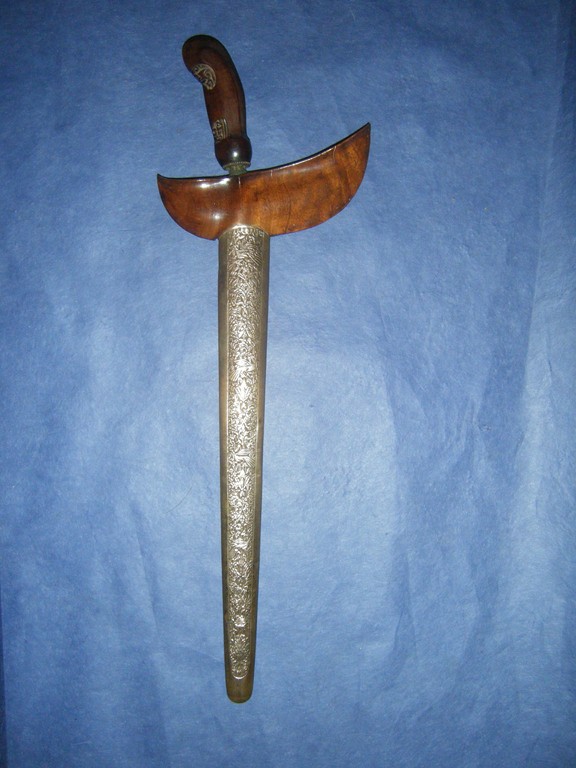

Here my example with a tanggalan wrongko.

To tell you the truth, I care less about the sheath but not to say that the choice of warangka doesn't have any importance to the overall Keris itself.

In Jawa specifically there are sheaths for formal dress wear (Ladrang) as well as everyday use (Gayaman) and some folks also have certain sheaths just for storage. Traditionally i am not sure if a reshaped wrongko like the one this keris is in would be culturally acceptable for public wear, but perhaps someone here would know the answer to that.

like written before, I don't think that the wrongko in question is a reshaped one but a taggalan wrongko but to be certain we will really need better pictures.
For wrongko or warangka tanggalan see "Ensiklopedi Keris", page 458/459.

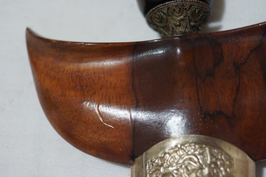

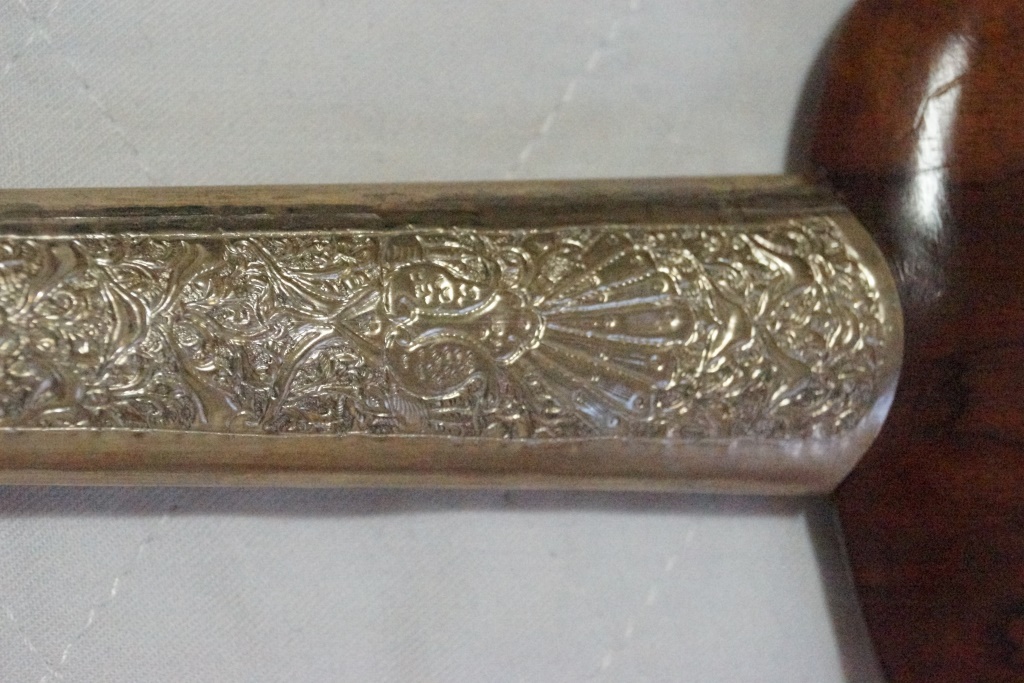

Originally Posted by David
You might be correct on that Detlef. From the provided image i just can't tell.

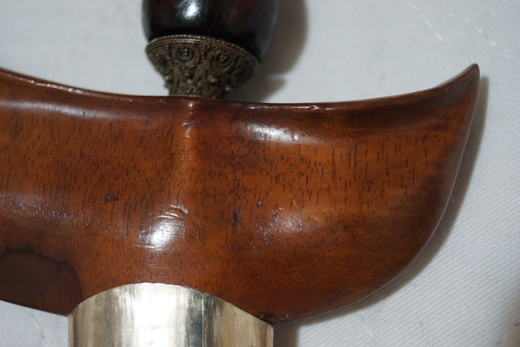

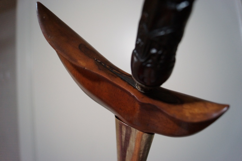

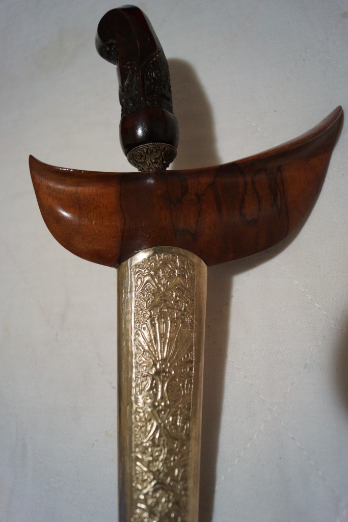

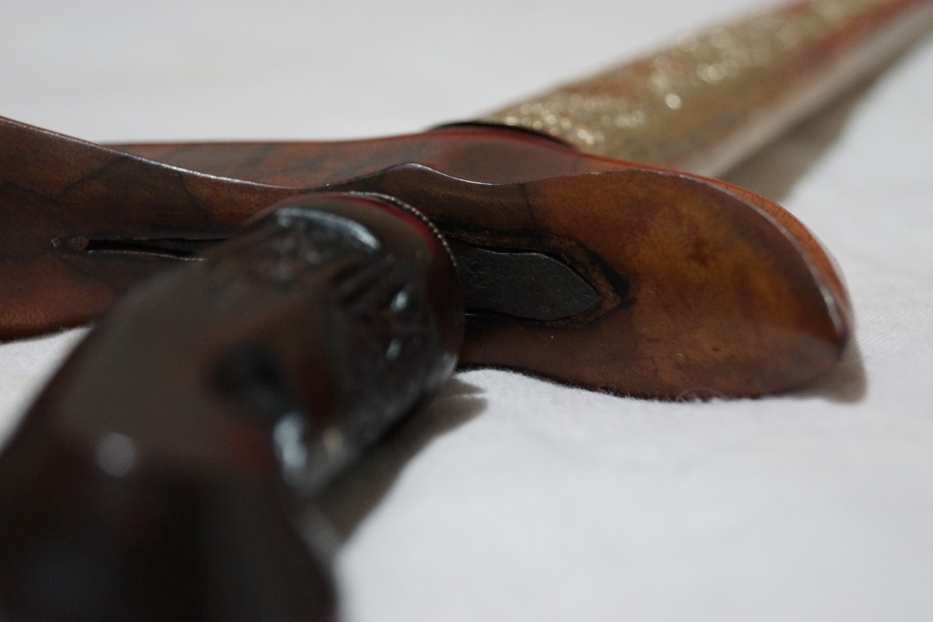

Noted, here are (I hope..) the better pics of the sheath.
I also can't tell as I am truly clueless whether the Wrangka had been reworked or not. But the wrangka is definitely similar to Detlefs.
And lastly, the wrangka has a peculiar wood grain pattern. I think it's what people call as 'Pelet'. The many shapes and figures of Pelets are supposed to signify something, if I'm not mistaken.
~Peter

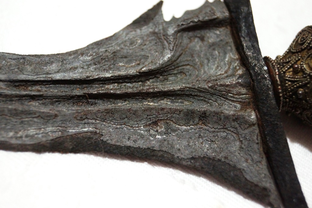

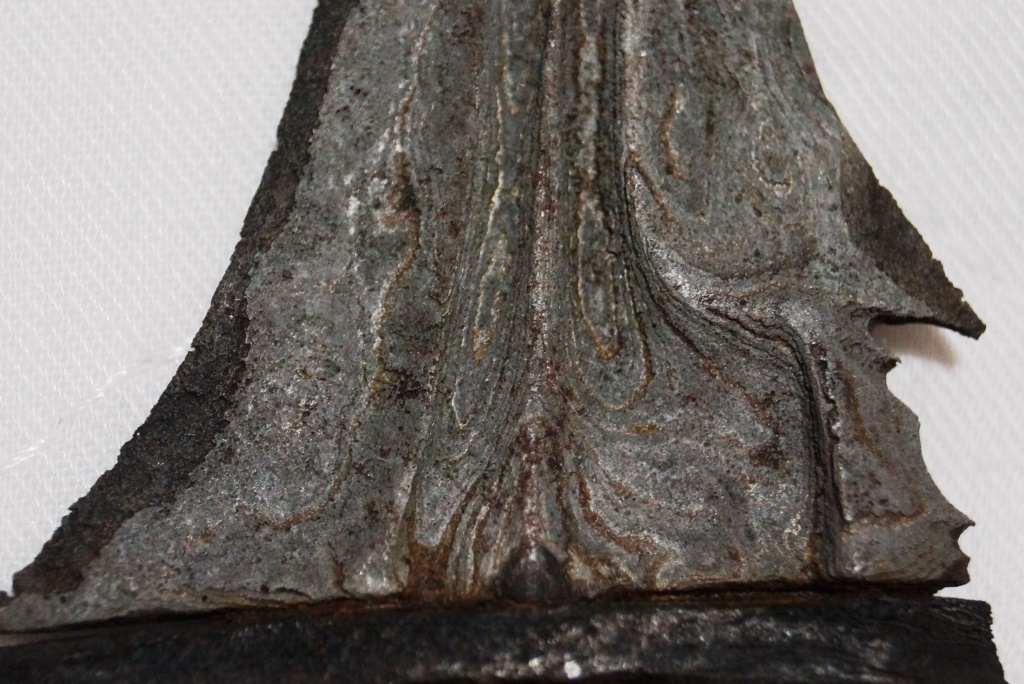

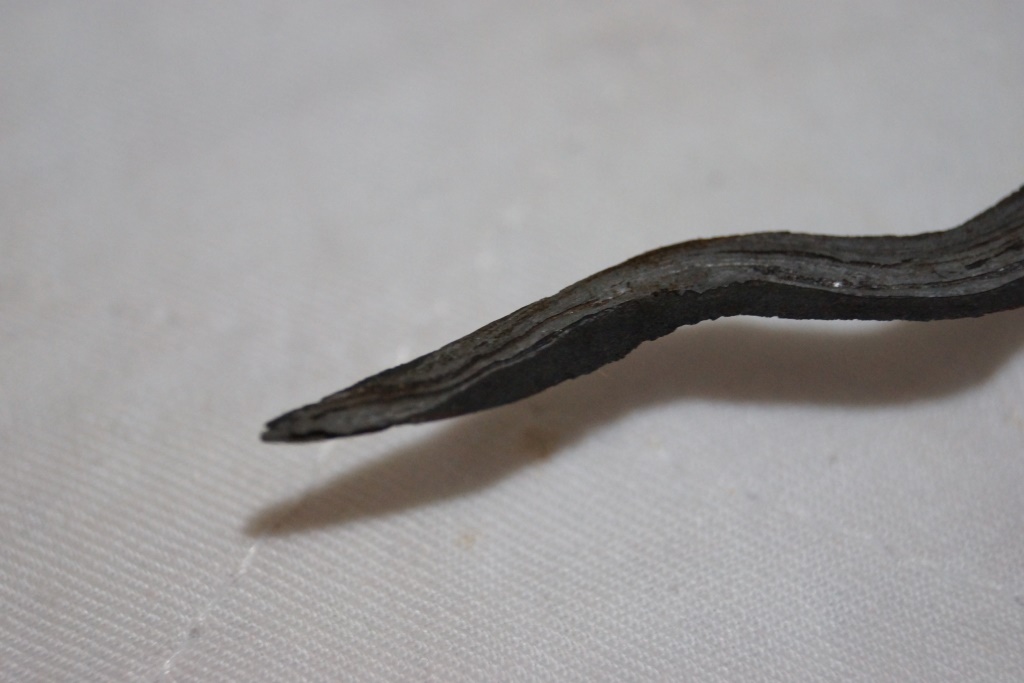

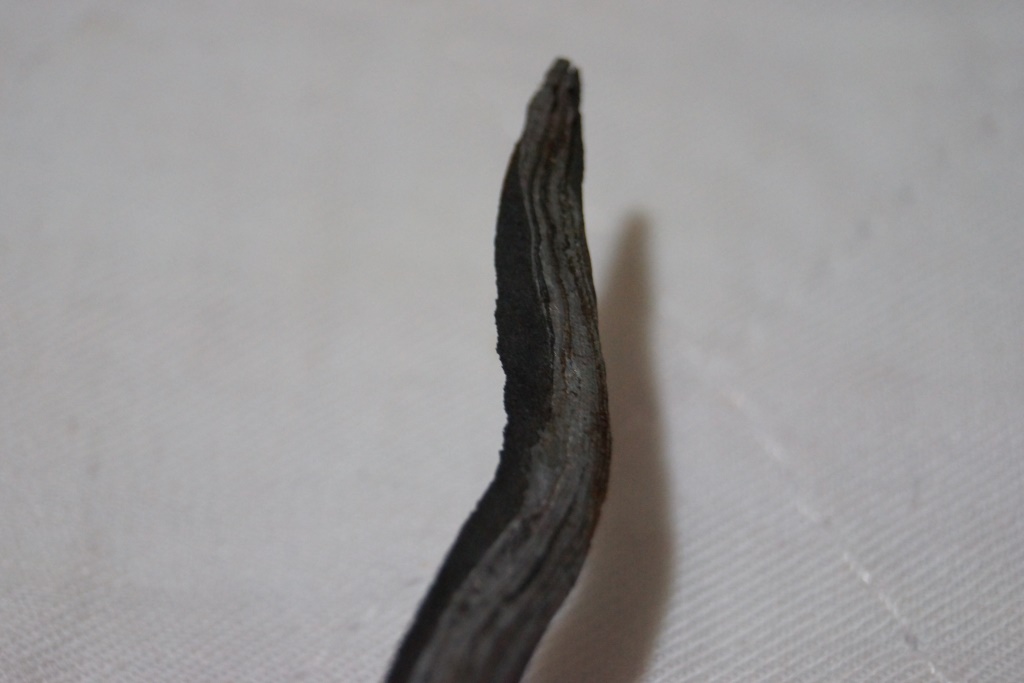

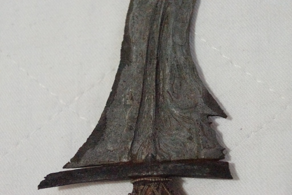

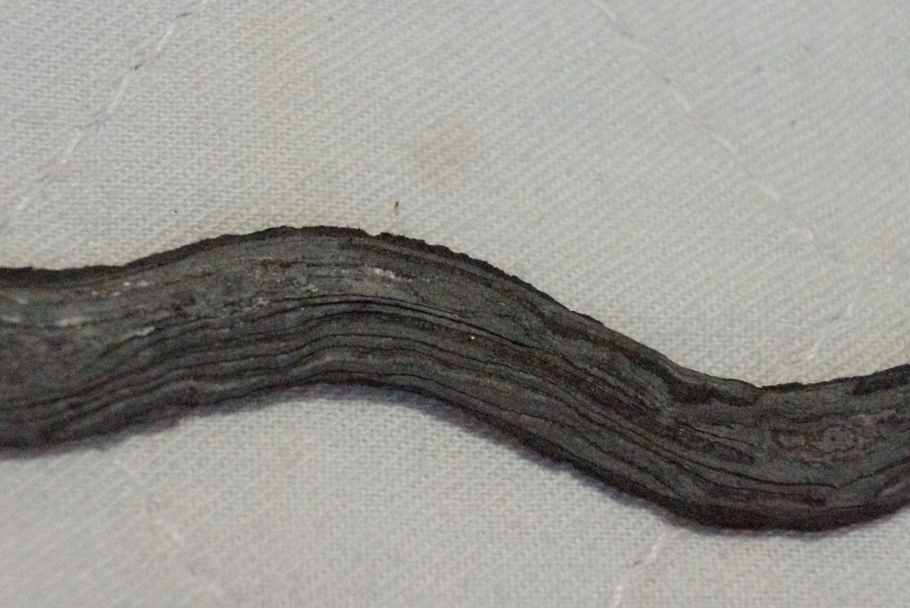

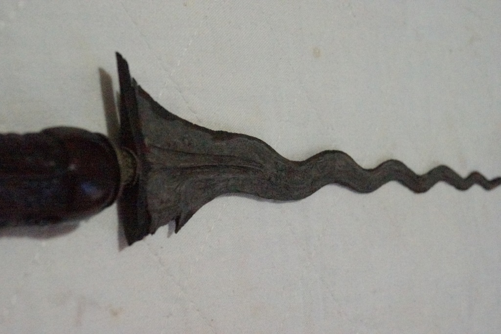

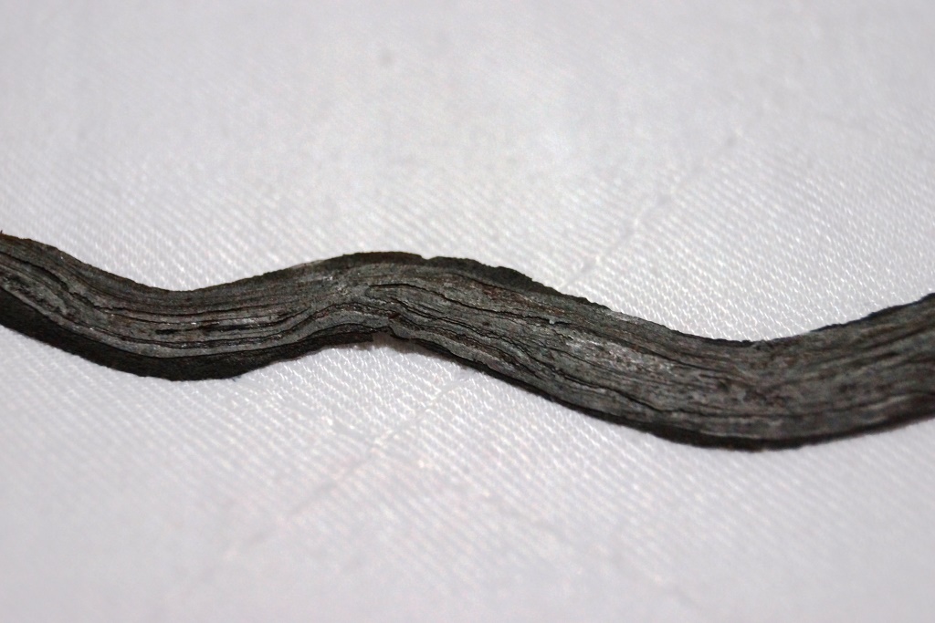

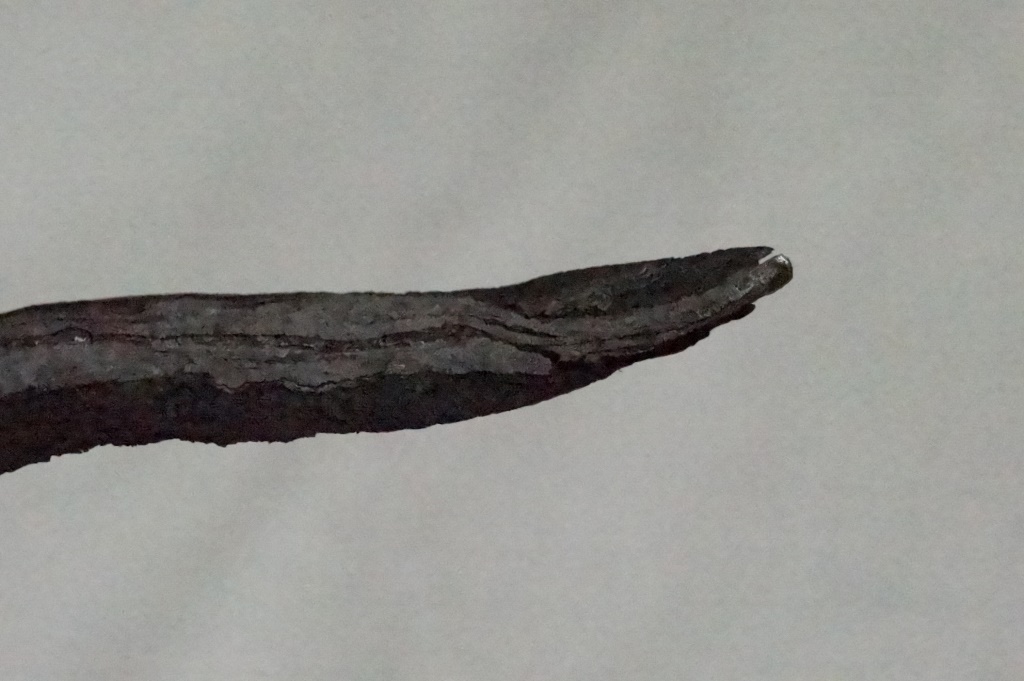

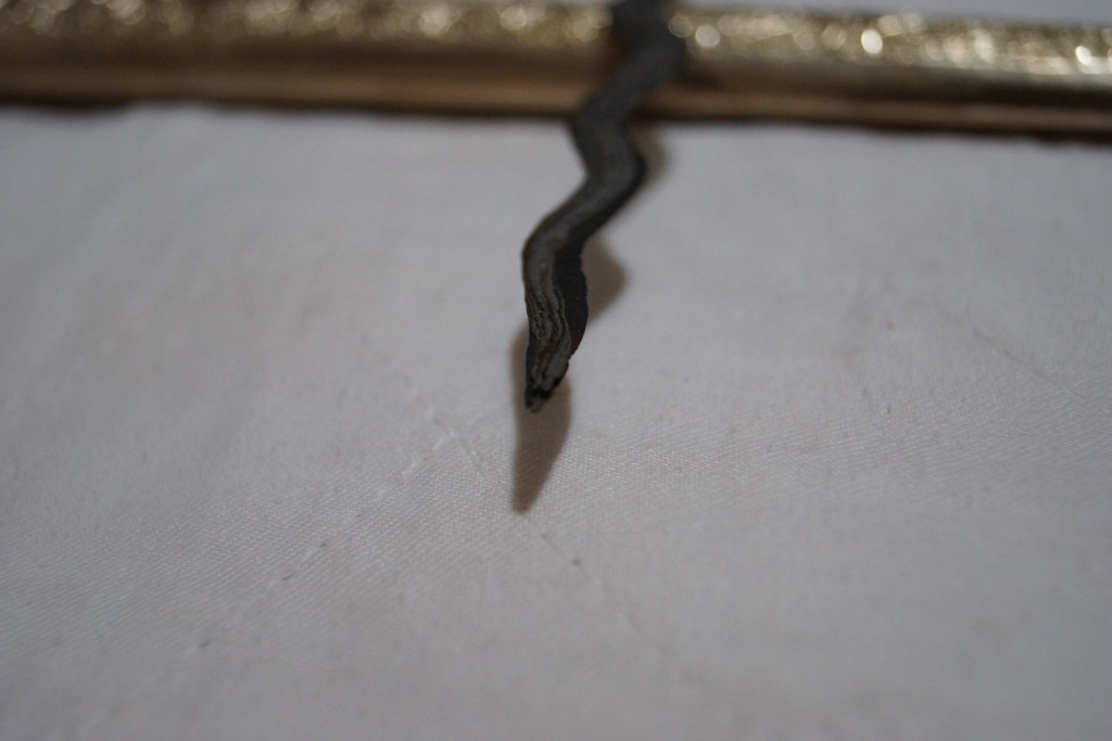

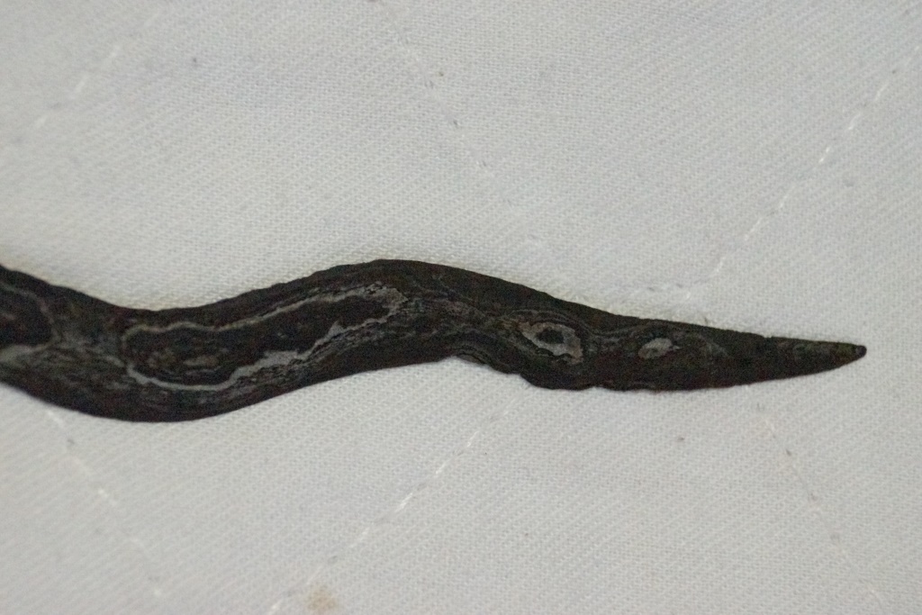

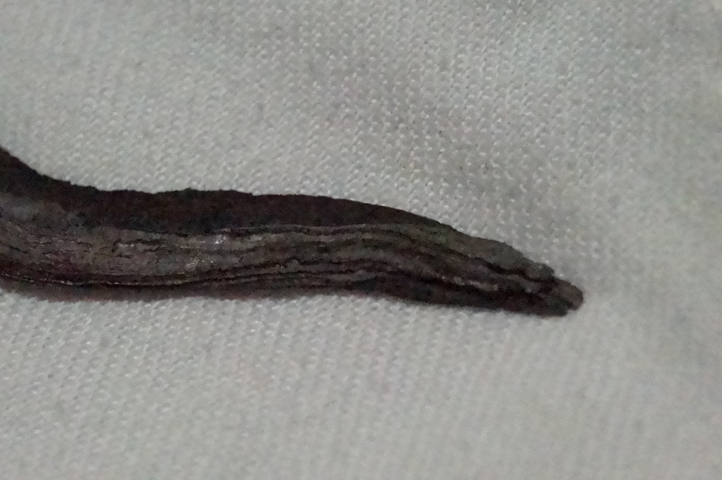

Absolutely, but I must ask you to please excuse the quality of the pictures. Amateurish is an overstatement of my photographic skills.
The Wilah and the pamor seem to split at the edge of the Keris. I wonder if it's due to frequent acid exposure.

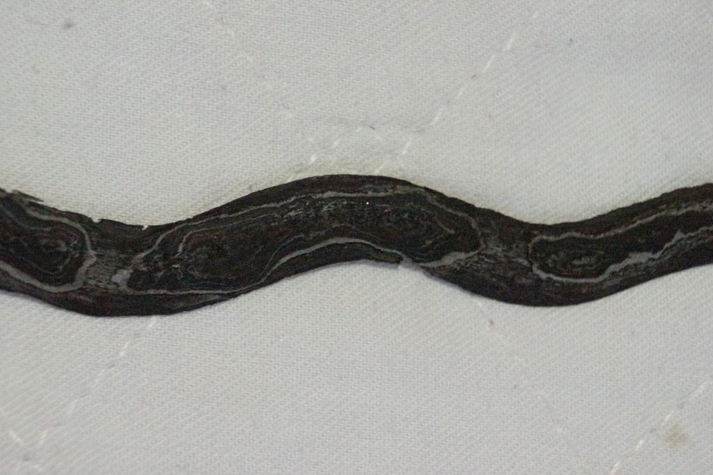

It is similar to wos wutah, but the pamor on this Keris doesn't disperse in several groups and it covers almost the entire surface of the blade. The hue or contrast between the pamor and wilah is a lot less forceful than wos wutah, it really has a very soft tone. I'm sorry my friend, but I have to insist that this one is definitely Pedaringan Kebak.
Attached is the picture of another Keris that I have which Wos Wutah pamor.
However, I would really like to know whether this Keris is indeed a Carita Keprabon. What would be the things to look at?

This keris may have been a carita keprabon once, but regrettably the degree of erosion is now too great to permit anybody to say with certainty what the dhapur may have been before it lost so much detail.
The classification of Pajang I cannot confirm from these photographs,the pawakan does resemble Pajang in some respects, but in my opinion insufficiently so to permit agreement with this classification. Additionally, I cannot see any pamor akhodiyat in the blade, which is one of the gold-seal tells for Pajang.
Possibly not a bad start to a collection but I'd be inclined to take the description provided in Indonesia with a large grain of salt.
Oh yes, the pamor.
Mlumah means "laying down" and is the usual type of pamor that is made, examples of mlumah pamor are wos wutah, ngulit semangko, udan mas. Its an easy type of pamor to make. Miring pamor means "sideways", and to make this you start with the mlumah pamor billet and then forge the grain so it is at 90 degrees to the core of the blade when put in place. Miring pamor is difficult and expensive to make, and is the type of pamor used in all the great motifs, such ron duru, adeg, ganggeng kanyut etc.

Yes, thought they both take pretty much the same form there are proportional difference which become quite obvious after you compare examples.
Old 18th November 2013, 05:17 PM   #19
Posts: 7,218
Thanks for the new photos of the sheath. I can now withdraw my thought that the sheath is a reshaped Ladrang wrongko. I concur with others that this is a tanggalan wrongko.

my understanding of pamor P.K. is a very fine pamor wos wutah which covers nearly the entire surface of the blade, look for example the in post # 1 shown example from Marco in this thread: http://www.vikingsword.com/vb/showth...ght=pedaringan
Frankly said is the blade of your keris so worn that it is IMHO not possible to say if we have here a Pedaringan Kebak pamor, could be or could not be.

You're right Detlef, we can't call this pamor pedaringan kebak, but it might have been once, as with the dhapur, I simply cannot tell, because the blade is too worn. I believe that more than a few of us have experienced the extravagant descriptions of Indonesian purveyors of keris. Its just part of the process of education. All education costs money, and education in the keris is no different.

two other observations. First, by your later and much better pictures you can see that the blade isn't original to this scabbard. The "mouth" was made smaller with help from some sort of filler.
Second, the mendak isn't a Yogya one.
I really doubt that a keris like this coming from an abdi dalam. He will fit his keris with an adequate mendak and when the scabbard of his keris is broken he will let made a new one for the blade and don't let refit an old one.

Thank you Alan.
Hello Peter,
Like Alan I know that purveyors in Indonesia are very imaginative by creating storys when they want to sell something (and not only in Indonesia).
Sorry to speak open words to you and I hope you haven't pay to much for this keris. You have a nice and somewhat rare sheath form, a very nice mendak and so far I can see a nice hilt. The weakest part of this ensemble is indeed the blade.
Don't worry, we all have learned the hard way.
No no, you have all of my gratitude.
The Keris is without a doubt very old, as I mentioned earlier, to me the blade is real thin and fragile. The only way to make certain of things is really by getting your hand on it. I spent about $300 on this Keris and to tell you the truth, I'm not that upset. This Keris is one of the first set of collections that I have. As Alan said, education does not come cheap And I try to be grateful of what I have.
My contact has very good relationship to a couple of Surakartan Abdi Dalems and a Yogyakartan ..or so he claimed. And he seems to be pretty vocal in the Keris world. He mentioned that he'd receive an honorary title (KRT) from the Sultan sometime next year.
Alan, that is some intricate way of doing business But I can imagine that in the third world country.
