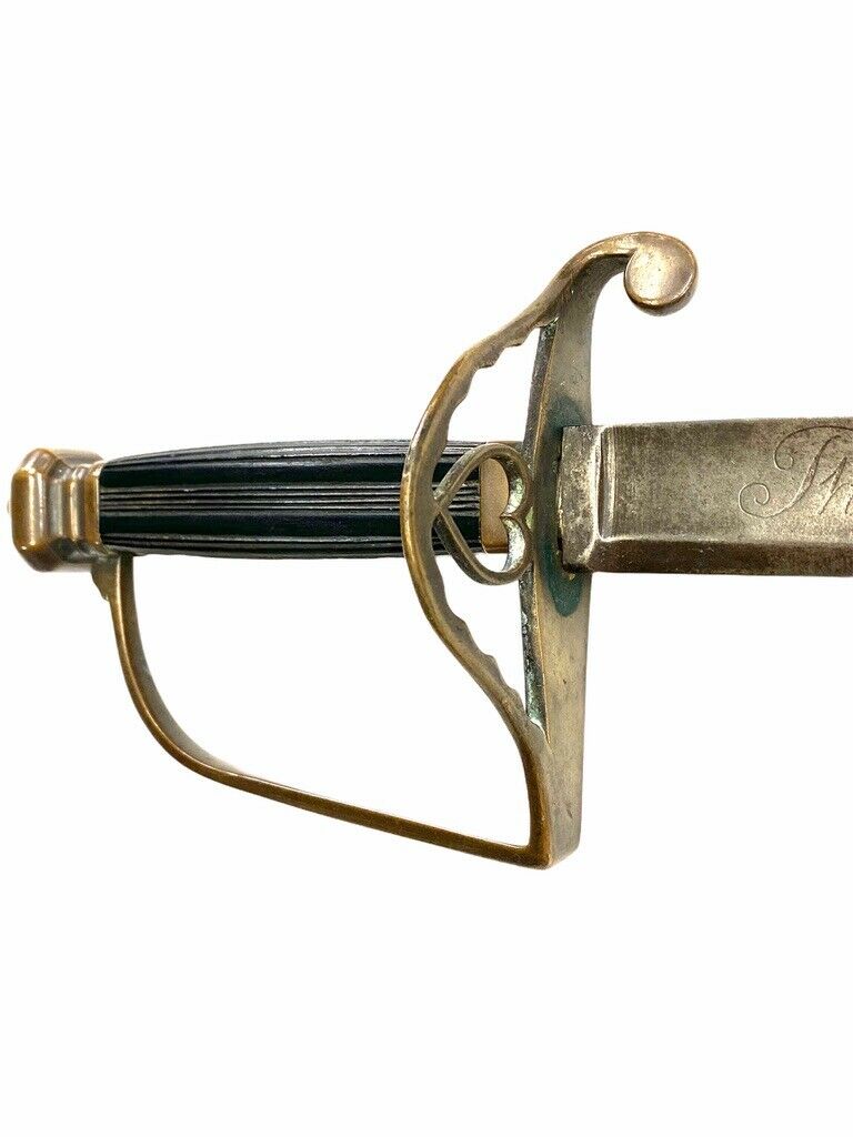

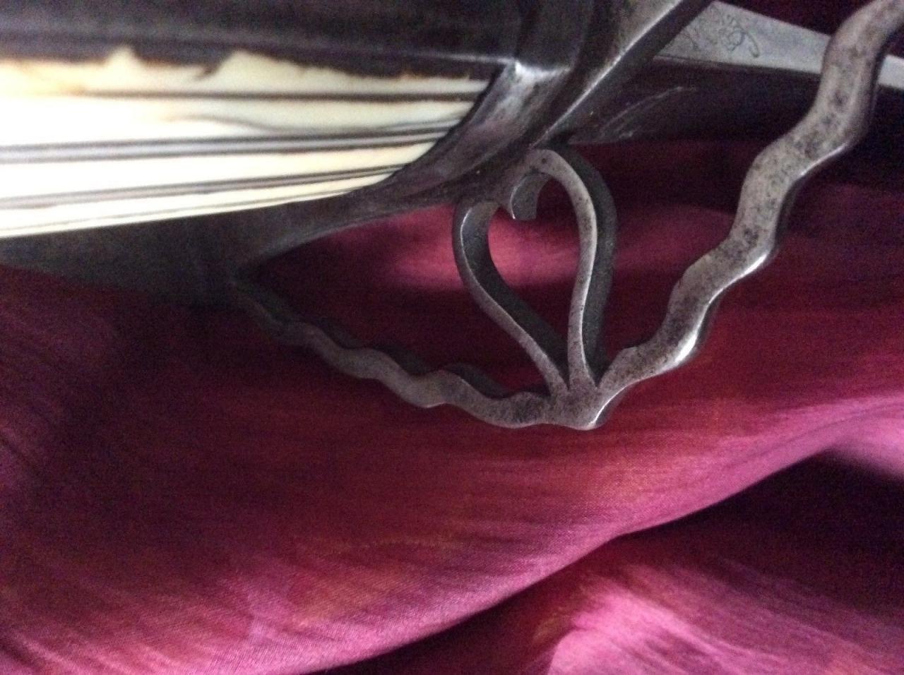

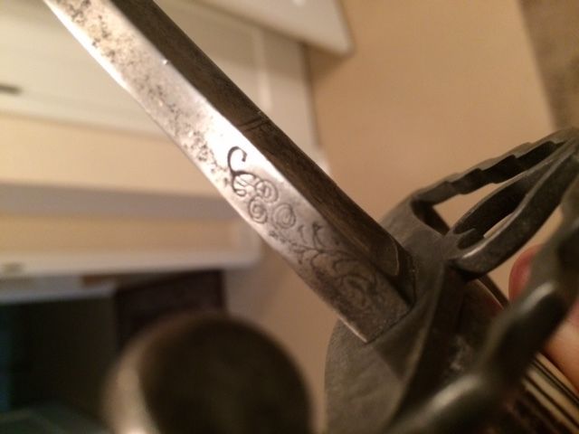

Hi Guys
I need serious help.
I have zero knowledge in small swords.
Could you help to identify this one, from where and when?
Thanks
Old 5th June 2021, 09:25 PM   #2
Posts: 10,862

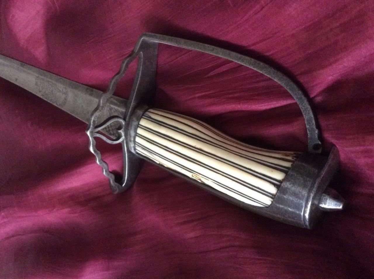

This appears to be a really sturdy, attractive example of an officers 'spadroon', probably British and these were popular from about 1780s into 19th c. While the blade seems pretty rusty, and cant see the whole thing, it seems probably straight, which is characteristic on these spadroons.
I like the heart on the grip. These were not of course 'small swords', but military versions of them for officers wear at special events and official proceedings. This one seems likely to be a 'fighting' example.
Small swords are pretty esoteric and as such have typically not been a highly populated field of collecting, but it seems have been catching on in recent years.
While I would deem this British, it could very well be Continental as well as these fashions were often shared broadly, in fact the British 'five ball' hilt form was actually adopted in France as the 'English' form saber.

In addition to what Jim wrote:
I think this hilt is more of a Continental form than British. For instance, the English 1796 Pattern infantry officers examples tend to have more hilt decorations, fire gilding, a rounded wooden grip, wire or wire-like foil wrapped. Perhaps gently cleaning off the blade rust will reveal a monarch's cypher or other clues. I like the heart-shaped escutcheon on the grip. To me it also speaks of the European continent.
Thank you Jim, very useful to narrow down the origin, a spadroon, maybe military; and period late 18th late 19th c.

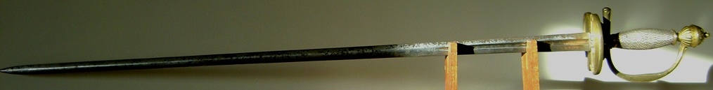

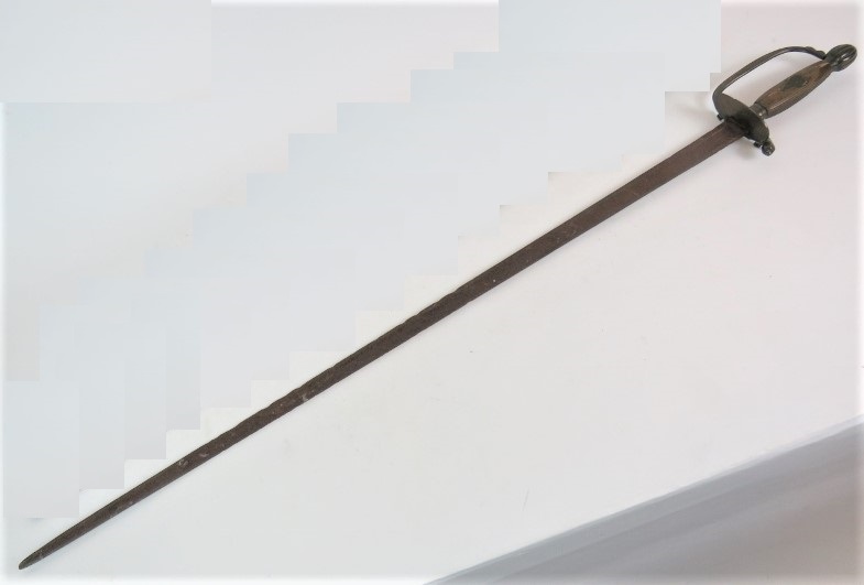

here the whole thing
Old 6th June 2021, 05:55 PM   #8
Will M
Will M's Avatar
Join Date: Mar 2012
Posts: 432
The sword closely follows the 1796p British infantry officers sword except for the grip and pommel. I would call it Continental, a way of saying European but not sure which country.

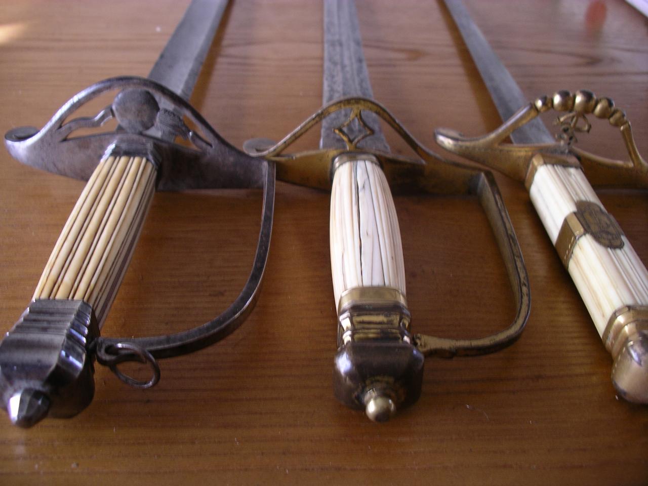

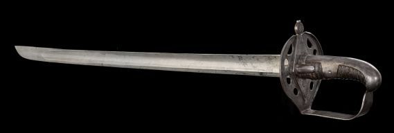

IDed by the curator/director of the Higgins Armoury as mid century 18th and the sword came from Dominic Grant during a Scandic adventure. A late Wundes looking blade mark.
As to the sword of the thread and the 1796, David Critchley had written of Prussian patterns influencing the development of the British pattern.https://web.archive.org/web/20061231...shinfantry.php
Cheers

For scale Jim. The sabre is a hussar type, picked up with smaller hilts in the 1780s.

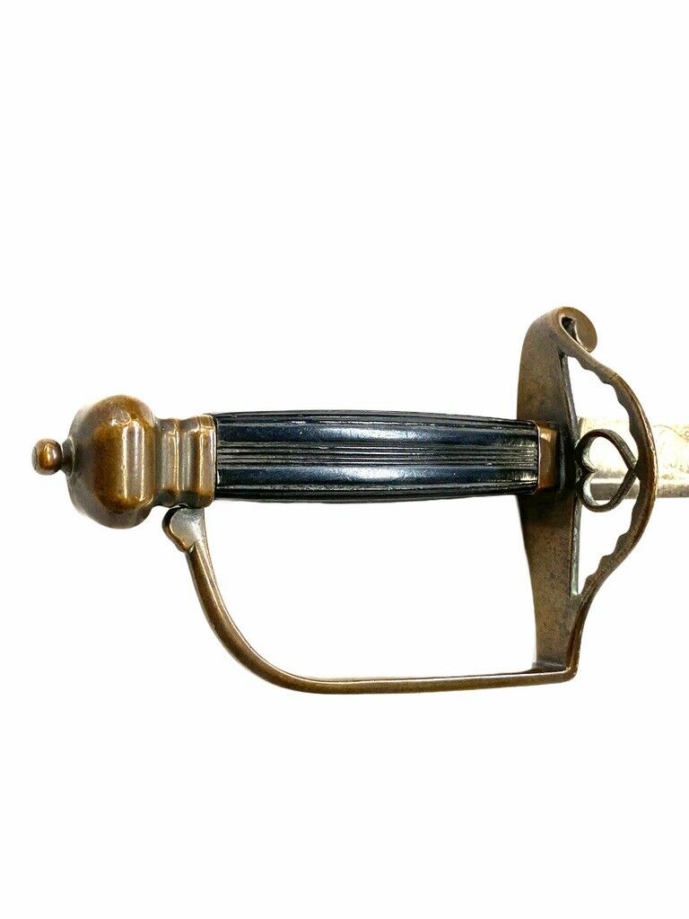

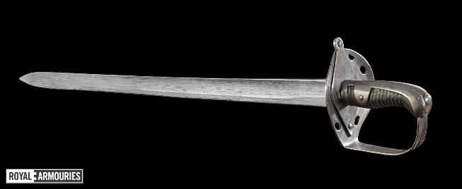

In general this says to me P1796 Infantry Officers sword apart from the pommel which would normally be the urn type and the grip which was normally round and wire wrapped. The blade shape, folding guard and the stirrup guard all look typical for a P1796. There are quite a few variations on these P1796 officers swords but I haven't seen the aforementioned variations to date. Volunteer militia? An interesting piece.

I think you are onto an important observation Norman, the absence of the urn pommel as noted did not suggest the M1796 pattern infantry officers sword. Also, as Mark astutely noted, these 'fixtures' are for a folding guard shell.
The folding apparatus was an innovative feature becoming popular at this time of fledgling sword patterns, which became better known just before mid 19th c.
As these officers swords were by commission, to the cutlers of London as a rule, such innovative devices would have been notable for the variations noted.
The use of horn and the heart device as also previously noted, may well be toward a Scottish preference (heart=Catholic; Catholic= Jacobite; Jacobite=Stuarts, and other British supporters for them).
The horn would have been used in the sense of stag horn, popular on hinting hangers, favored by the gentry and upper echelons from which officers came and their sense of fashion prevailed.
These kinds of variations are almost maddening for those who focus on regulation patterns, as officers swords, while loosely following standard conventions, had almost carte blanche in private purchase. The keen sense of fashion among officers, the innovations and styles of varied makers led to these kinds of anomalies.

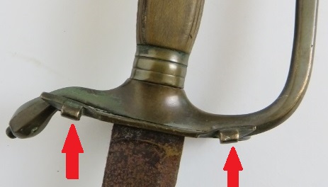

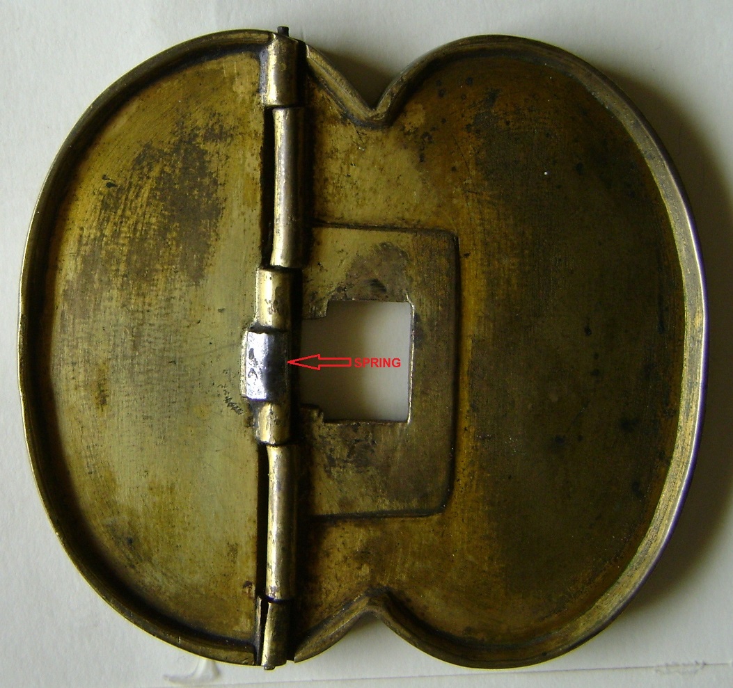

How could i be so blind that didn't figure out that those 'studs' are the hinges for a folding guard. To my defence, i was betrayed by the angle of the picture . Actually, i have even discussed these features a few years ago over my (ex) pattern 1806 Portuguese Cavalry officers sword.
OTOH, for what i knew of Spadroons (Espadões) from a local fellow collector, i would never realize Kubur's sword is also one of the kind.
Old 8th June 2021, 06:07 PM   #27
Posts: 10,862
Well, that makes two of us Fernando! I didnt notice them at all, and I only knew of the 'spadroon's' from the 1786 pattern (which I had forgotten as well, good thing the Capn is aboard!) which I know only as c. 1790s in studying the five ball hilt aboout a zillion years ago.
Old 8th June 2021, 06:21 PM   #28
Please, forgive my ignorance
But what is the advantage to have a folding guard???
Old 8th June 2021, 06:45 PM   #29
The folded guard becoming a more 'flat' surface, it leans more smoothly against your hip.
I recall one solution with the 1796 British heavy cavalry sword. As the guard was born unfoldable and harassed troops, the Ordnance decided to cut off (trim) part of it; this before the battle of Waterloo; after which the 'new version' was named.
Also their blade points were reviewed, as may be seen, but is another story.

As Fernando has noted, the full guard was often seen as a problem with chafing (of the uniform) so these were cut down, or as noted, the folding guard was created.
After Waterloo, the M1796 hilts were cut down for 'presumably' this reason, which is often notable in identifying post Waterloo use of these.
It seems odd though, as in these times swords were worn low slung ,the reason for the large drag on the chape of the scabbard), so whether hanging over the saddle mounted, or dragging when on foot, how it would chafe uniform is puzzling.
