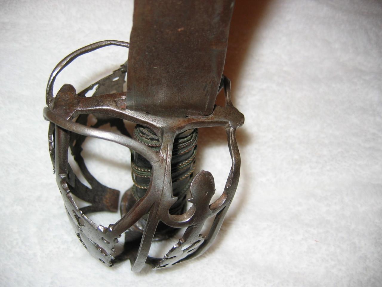

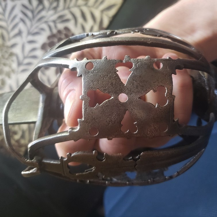

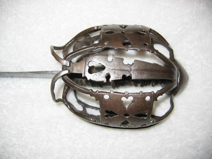

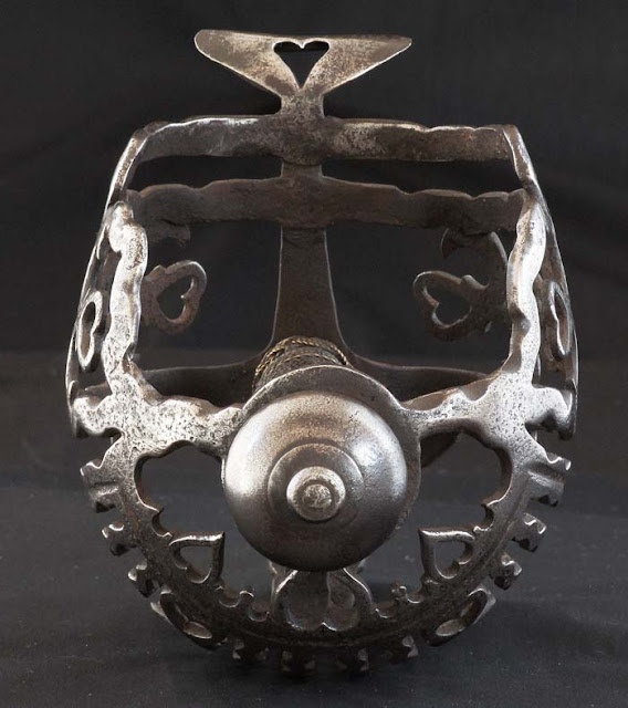

Hello folks! Here's the newest member of my collection (straying a little from the naval/pirate, but there were many Scots who were privateers!)
Here we have a nice early 18th century basket hilt, probably made during the first quarter of the century (1700-25). The piece measures 35" overall with a 29" blade. The blade is classic German import, with a lenticular profile, unmarked, rounded tip and broad flat ricasso. Note the pommel is an early form of squat muchroom form. I have heard many speak of 'munitions-grade pieces' made in direct response to the Rebellion (used on both sides, BTW. Not all clans embraced the Bonny Prince!), but I think mine is nicer than some of those rougher examples.
You will note the nice piercings of hearts and dots to the side plates, as well as the merlons/fish tails, ridged decorations to the plates and bars. Interestingly, this example is missing two items, the so-called wrist guard to stop the slashing blow used by Scottish fencers (mine appears to have never had one. These wrist finials started popping up around 1700, with some earlier baskets actually braising them on later) and also the 'additional rear guard'. I attribute this to the early pattern and also this provincial weapon's no-nonsense creation as rebellions loomed. You will note that, as with the missing wrist guard, there doesn't appear to be any indication with this basket ever had the 'additional guard', no evidence of damage/removal, etc. I've seen several other types missing the additional rear guards, including the 'S' bar types which seem to never have them, on several British baskets and on at least two classic Scot examples.
The basket is tight and probably made for a smaller hand than mine (I've 5' 11''). My hand fits, but you can see there isn't any extra room! I'll post a pic of my other basket hilt for comparison soon. Note the original leather grip with double strand twist wire. The overall pattern of the basket would be the 'Glasgow style', meaning flat noodle-like bars nicely braised and the flaoting bars resting uder the grooved slot just under the pommel (another early feature). The overall impression is one of a basket created by garrison smiths imitating the 'masters' in Glasgow. The nice patina and some damage (cracked main knucle guard with inner basket reinforcement, minor damage to blade, chips, etc) are a testamony to it's use and history!

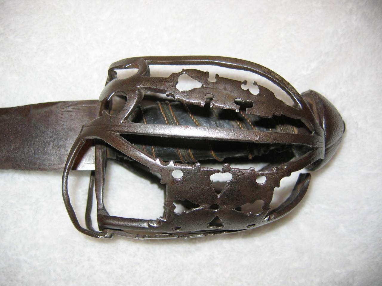

Some more pics...

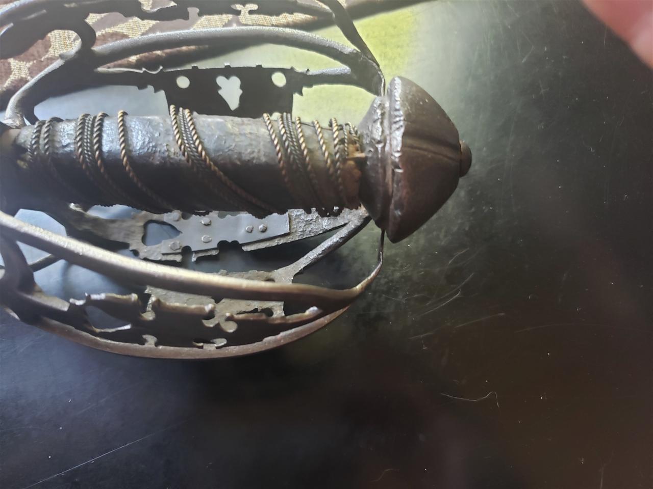

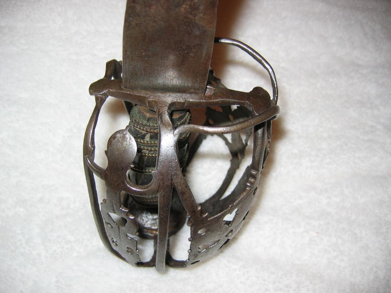

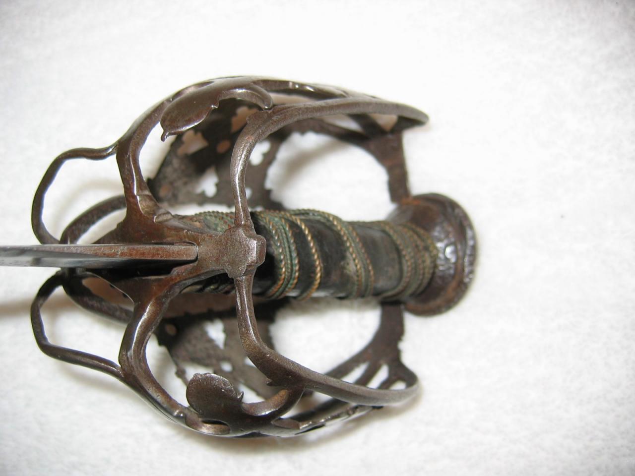

More basket hilt pics!
Old 13th September 2021, 04:40 AM   #4
Posts: 7,407
What a nice piece. You are right - some of these did not have that wrist guard. What is also nice is that the original patina and japanation is on the surface of the basket, and it hasn't been re-peened. The repair on the inside seems later but not recent, and keeps that part together.
Would you post pics of the whole piece please?

Thanks so much for commenting, Battara. I will snap a few more shots of the whole piece and also of my other basket just for comparison. I truly love this sword and I love the stories of how many of these old baskets were hidden after the '45 Rebellion when they were basically made illegal to own. What stories it might tell!

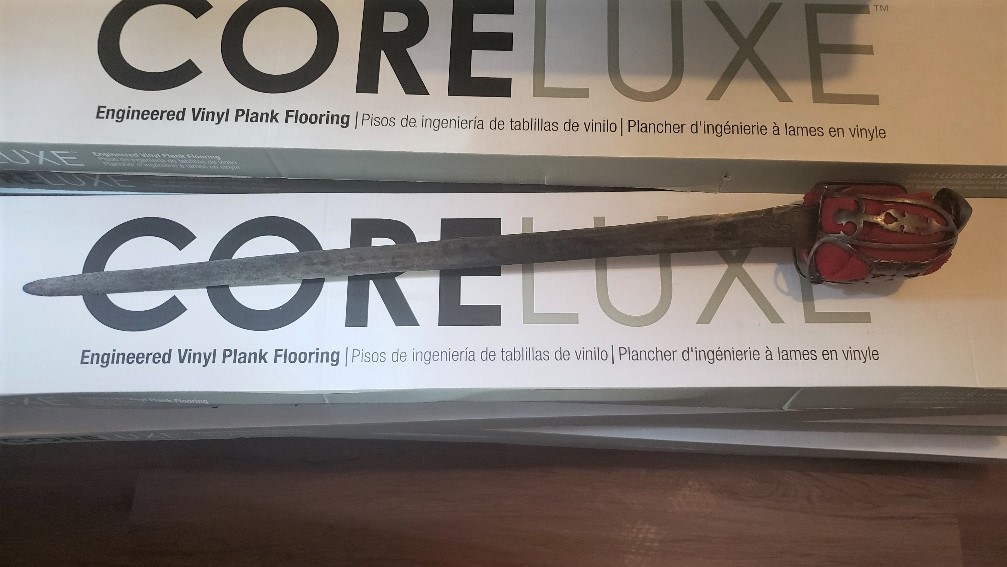

Default More pics Jacobite era baskets

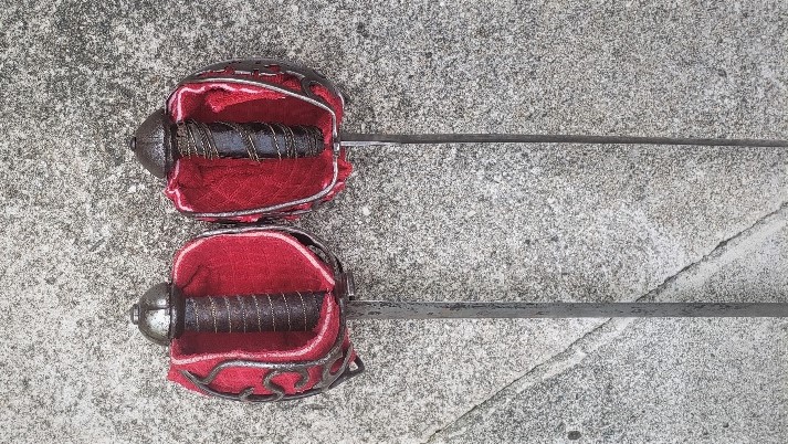

Here's the whole sword plus my 'S' guard basket for comparison of size, grip wrap, etc. Note this other basket also lacks the 'additional rear guard' bars.
I hadn't noticed until I was looking at the pics that my new broadsword blade is set at a slight angle to the hilt, as evident in the second pic below. This is again an early feature and I begin to wonder if this might place the dating closer to c.1700!!

Still more. What really speaks to me about these pieces was the turbulent time in which they were created. The old ribbon-hilt style of basket was transitioning into these forms and after the '45 Rebellion, baskets would rapidly become plainer, more functional. Gone would be the heart piercings, merlons and square cuts found on these types. Compare a Drury basket of the Blackwatch ca. 1770 for comparison (no less magnificent, just not the same decor).
Just as intriging are the sheer numer of baskets absent from the field of Culloden after the battle. In other words, despite the massive numbers of fallen Scots, others retrieved their baskets and hid them away. Those that were recovered, perhaps 150 or so, were taken as war trophies or chopped up/destroyed. A large grouping of them were made into an iron fence surrounding some aristocrat's estate, the ultimate insult! I'm glad this survivor came into my collection!

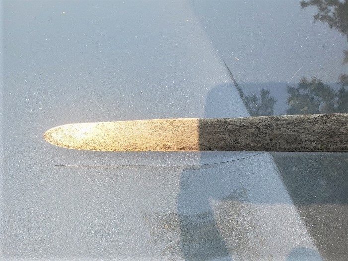

The rounded tip on 'arming' sword blades was as Mark notes well known on German blades on these times, and designed primarily for more surface in slashing cuts, key in Scottish swordsmanship.

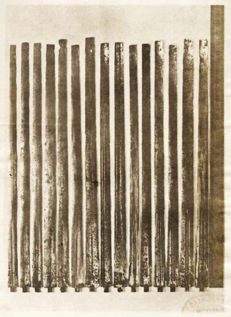

In reading through resources trying to get 'up to speed' here, I wanted to address some of the comments thus far.

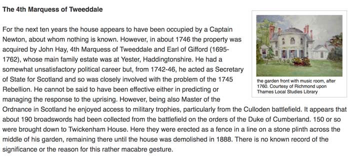

It is known that only some 190 swords were recovered from the field at Culloden, but over 1800 men were killed, of over 6000 troops. In the aftermath, there were paltry numbers of swords surrendered, 25 here, 50 there. Scholars insist the numbers of swords recorded were relatively few compared to muskets.

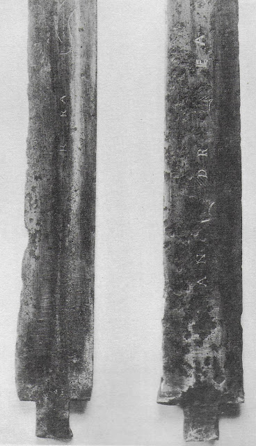

In an earlier post, it was asked whether any Scots produced blades. In the writing of Charles Whitelaw (1934), the venerable sage of the study of Scottish arms, I found two cases which he thought were NOT imported blades.
These were (p.309, plate IV#4; plate V, #2,#3)
Both were basket hilts by W. Allen (Walter Allen of Glasgow, later Stirling).
He suggested these blades were by Allen, and not imported.
Both blades were with the favored ANDREA FERARA name, which was of course typically on the German imports, so it is curious how he arrived at this conclusion, but is noted here regarding the possibility of Scottish blade production.

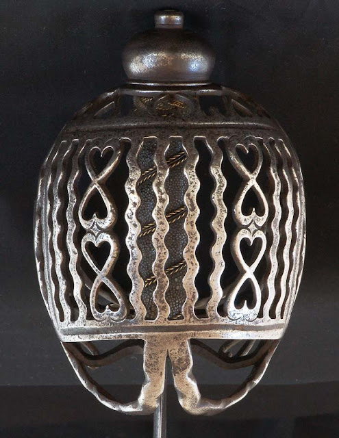

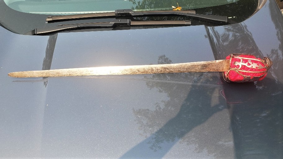

Some years ago while researching Rob Roy, I found that the swords actually used in the fight between Rob Roy and an opponent much younger , Charles Stuart of Ardshiel, had been restored by an Edinburgh master of arms. I have yet to find notes but what I can find so far,
While Rob Roy was born in Stirling regions, he was primarily in Highland regions in Argyll, where his now legendary 'cattle' enterprises took place. He was born in 1671, and was very distinctly Jacobite, participating in the early uprisings in 1689, and years later in 1715 and 19.
His sword was of 'Glasgow' form, and from what I have seen of pictures of it (pending) the styling, and more importantly, the piercings, are remarkably similar to those on Mark's example.
I had thought the rough apertures on the right guard were holes drilled too close to the edge, but as seen on the MacGregor sword, were intentional designs. The curious pierced device with two holes and triangular figure below are interestingly similar to the MacGregor sword also.
The Jacobites apparently had numerous 'secret symbols', oak leaves, thistles, etc. and it has been my opinion that in many cases, these were cryptically stylized for covert recognition. This may account for the difficulty in accurately describing these devices. In some cases authors will 'suggest' what these are for the sake of a working term in discussion, but more history of them are wanting.
It has been suggested that the Rob Roy sword (owned by a West Highland family in Moidart) dates from late 1680s-90s).
The Stuart sword is from a Borders family and is a later backsword.
The duel concerned the mens' activity in the Battle of Sheriffmuir 1715, and while it concluded with no fatality, Roy was wounded, and that wound eventually caused his death in 1734.
Therefore I suggest this is a Highland basket hilt, in the Glasgow manner, dating from 1690-1710. It is unlikely this was a 'garrison' make, and probably by a regional 'sword slipper' imitating the well known makers in Glasgow. Walter Allen (later Stirling) was a Glasgow maker who used these kinds of pierced devices, so clearly these were around before the '15 as his family were active there since 1680s.
The absence of the wrist guard seems to fit as well, as these period of 1680s-90s precedes the addition of the wrist guards (called a 'backward').
While the Allen hilts were signed, this one unsigned was probably by perhaps a journeyman working toward 'hammerman' status. The blade being unmarked may suggest it could be local if the Whitelaw theory of Walter Allen producing his own blades is correct, as it shows some blade activity in these regions probably existed.

Next is of course, Mark's fantastic example of a Glasgow type hilt with early type pommel latter 17th c. and resemblances to the Rob Roy sword of that period. Notice how the stylized 'thistle' (?) in his example is completely pierced as one aperture (as per Mazansky, family A example) while the later Glasgow form is two holes above a triangle.

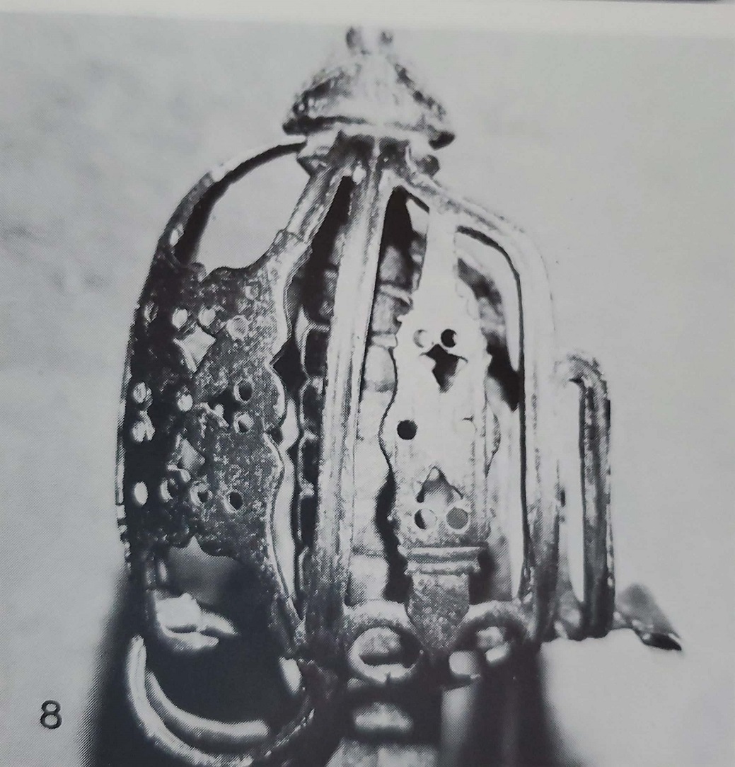

Just as intriging are the sheer numer of baskets absent from the field of Culloden after the battle. In other words, despite the massive numbers of fallen Scots, others retrieved their baskets and hid them away. Those that were recovered, perhaps 150 or so, were taken as war trophies or chopped up/destroyed. A large grouping of them were made into an iron fence surrounding some aristocrat's estate, the ultimate insult! I'm glad this survivor came into my collection![/QUOTE]
"...frequently a family heirloom-often in its second or third hilting-the Highlanders 'sword was far more than just a weapon. The great symbolic value of these arms was not lost upon the Duke of Cumberland. A bounty was paid from the royal purse of one shilling for every broadsword picked up from the battlefield".
"Scottish Swords from the Battlefield
of Culloden"
E. Andrew Mowbray, 1971
Text and photos from records
of Lord Archibald Campbell, 1894
This is EXACTLY what the clans dreaded, and why I believe the precious heirlooms were carried away by clansmen. Of the 190 swords recovered from the field, 150 of them were given to the master of ordnance, John Hay, 4th Marquis of Tweeddale...........who then had points broken off and hilts removed, taking these amazing blades made into a travesty of poor taste of a fence at his estate at Twickenham House.
The house was later demolished (1888) and the blades sold to a scrap dealer, then later acquired by Lord Archibald Campbell, who wrote this in 1894.
Images of some of the blades from the terrible fence, and in an article about a Stirling hilt believed of Walter Allen, found alone and with damage to the pommel ring believed from said removal.
