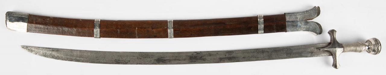

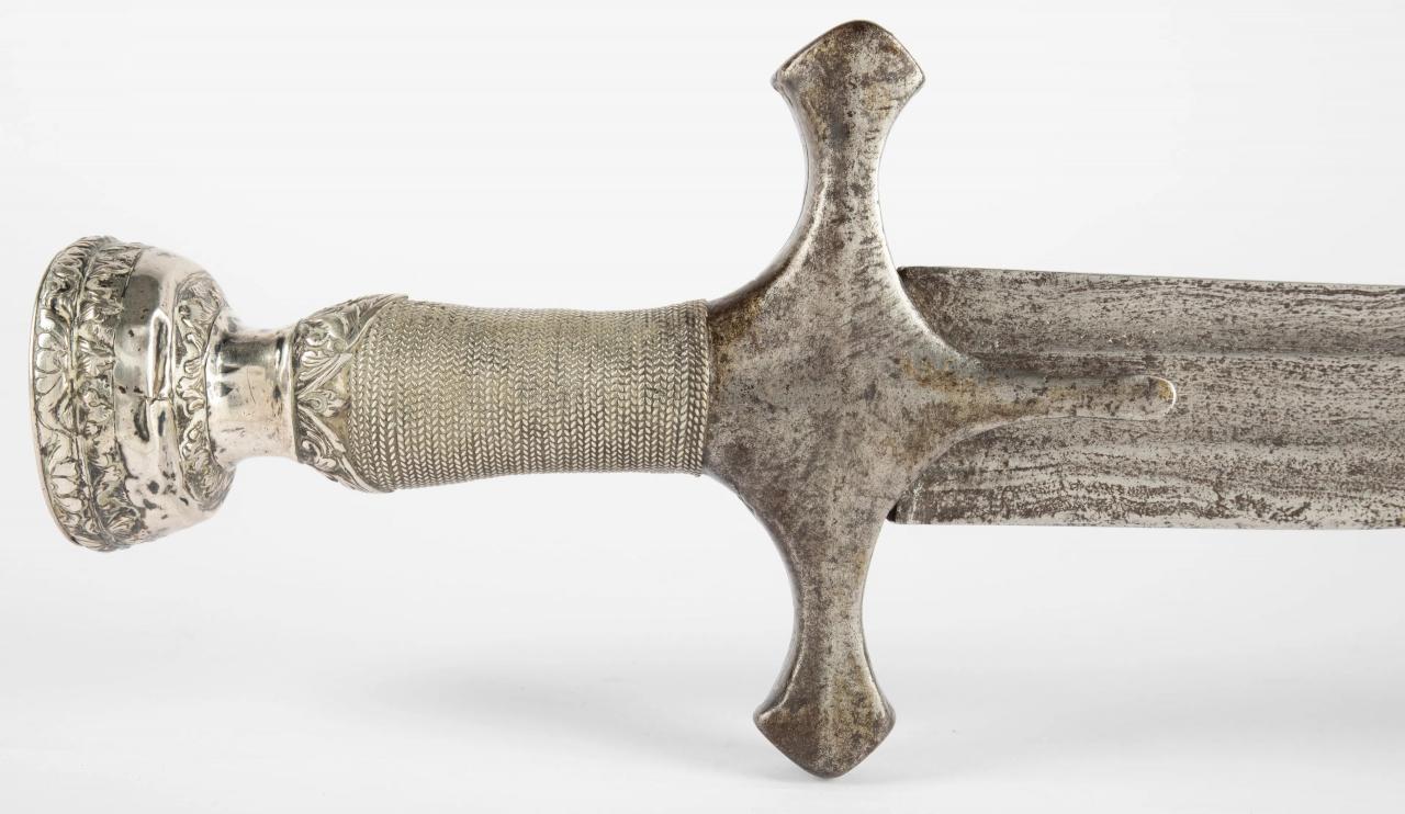

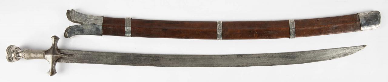

This seems like a gray area. I (seem/hope) to have won this silver hilted piso podang this week:
Were it not for the laminated Sumatran blade (which is what drew me in), the scabbard style, and the provenance I might have guessed Indian. But given those factors, clearly a piso podang.
Attachment 244033
Attachment 244034
Attachment 244035
A one of a kind as far as I know.
Congrats! I've seen it in the auction.
I guess it is Sumatran, but I don't know to nail down the exact area. I guess somewhere Central Sumatran?
It doesn't look Batak to me....
What was the provenance by the way?
