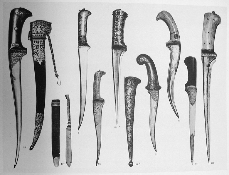

A discussion on another thread, gave me the impression that there was some confusion as to what a Peshkabz was/is.
In P.Holsteins book Contribution A L’Etude des Armes Orientales, 1931. Vol. II, plate XX, the author shows a few types, both when it comes to different grips but also with different types of blades.
From left to right:
#94 Peshkabz, Afghan or Peshawer.
#107 small Kard Indo-Afghan.
#6 Peshkabz, Indo-Afghan, Lahore, Punjab.
#25 Peshkabz, Indo-Afghan or maybe Afghan, Peshawer.
#141 Peshkabz, Indo-Afghan, Lahore.
#32 Peshkabz, Indo-Afghan, Punjab or maybe Afghan.
#12 Peshkabz, Indo-Afghan, Bhawalpur, Sind. See Egerton, plate XIV, #717. On page 138 Egerton writes, “Presented by H.H. the Nawab of Bhawalpur.”
#15 Peshkabz, Indo-Afghan, Delhi the Mongol period.
#235 Peshkabz, Afghan.

BTW, what do you call the example in the bottom of the photo (#197)?

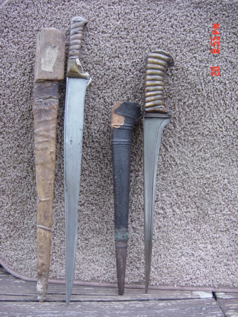

I'm trying to get a pic of what I thought was a peshcubz,
but I find it is a choora. Horn handle with nice pique
work and sheath.
Also, seems to me that there is little difference between
a Khayber sword/knife and a Kard other than the T blade
back???
Rich S

Here's a pic of my choora (ex: pesh :-).
Blade 9 inches with very faint remnants of
etching. All steel mounts with silver picque
work in handle.
Leather covered wooden sheath with brass mounts.
It is unusual to have the sheath mounts different
from the knife? I do think they are an original
set given the perfect fit.
Any idea what period or location this might be
from? Definitely not my strong point. Picked it
up a couple years ago just because it was a neat
knife.
http://home.earthlink.net/~steinpic/choora.jpg
Thanks
Rich

Hi Rich,
Yes you have a Choora - you may even have both .
I agree that the Pesh-Kabz is a tricky one, as it seems like Holstein has chosen to call all daggers from NNW India and Afghanistan shown, for Pesh-Kabz.
Now, if we take our old trusty Stone, and read out aloud, here is what he says.
CHOORA. The knife of the Mahsud, a tribe of the Khyber. It is like the Persian peshkabz; but made in the Khyber.
KARUD. Persian, a straight-bladed peshkabz (Moser XII).
KHYPER-KNIFE. I will drop that, as it is irrelevant due to the size.
PESH-KABZ, PESHCUBZ, PESHQABZ. A form of dagger used in Persia and Northern India. The name is Persian and means “foregrip”. The blade is of T section and is quite wide at the hilt, narrowing suddenly just below it, and then tapering regularly to a very slender point. As a rule the blade is straight, but not infrequently has a pronounced reverse curve. The hilt is often of walrus ivory (Persian, shirmani), and is heavy and has neither guard nor pommel. This knife is obviously intended for forcing an opening in a mail; and as a piece of engineering design could hardly be improved uponfor the purpose.
I think the conclusion must be, that all the knives Holstein shows fit to Stone’s description, number three from right less than the others when it comes to the ‘suddenly narrowing’ of the blade, but still. To the Persian name Peshkabz can be added, that many of the knifes had local names, like Karud and Choora, but they are all Peshkabz’s, and what make them this, is the big hilt and the T spine on the blade. But if this is so, why does he call a Choora a Peshkabz, as the Choora’ hilt looks different, besides not having a ‘fat’ hilt?
Funny that Stone writes ‘A form of dagger used in Persia and Northern India’. He must have, as they did in the early days, regarded Afghanistan as being part of India, since he does not mention Afghanistan in particular.
Old 21st July 2005, 12:09 AM   #14
Here is an illustration:a small Khyber (blade 15 inch) and a large Karud (blade 12 inch). Both are pretty simple, but Karud is of much better quality. Both have T-spines and bone handles. The blade of Khyber was sharpened so often that is narrowed down a lot. Khyber has an old label attached: beautiful Victorian handwriting, and the ink became brown due to age "Mada Khel" (a place and a tribe in NE Afghanistan. Also, the scabbard has bits and pieces of Arabic, no more than 2-3 letters at a string, the rest faded.
The main difference between the two is in the handles: karud's is 2-3 times thicker. I can barely hold it well. Also, karud has a swivel attached to the handle. It has no hole in it, so it is not for a lanyard. Any ideas? Somehow, I have a gut feeling that Karud is of Uzbeki origin. Just a feeling....

Excellent post and great illustration from the very rare Holstein book!
