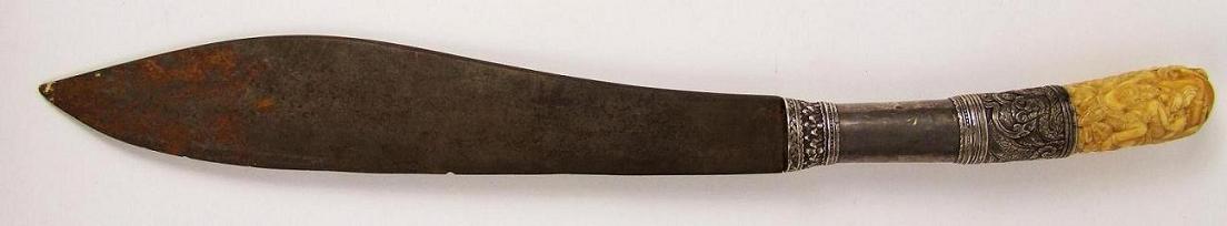

Default I stand corrected Gene
I stand corrected Gene,
Thanks to James, a reader of the forum, I have received more exact detailing via email.
Some extact from the mail.
It is a meed or mead, it is the Thai - siam form of a kukri and it is from the lao thai people of the north of Siam
Some say they are related to the Tibetans and lower foothill tribal peoples from the himalaya and this is a slightly modified form of the kukri or at least thats where they originated from, some are shaped slightly different and have an upswept point and some are flat cutting edge but have a curved spine with a weighty mid to tip that is thicker and curved at the spine.
He notes many of them are very old as that yours is and probably early 19th century and northern Thai by the decoration.
He has also heard them called e nep and has seen them up to 2 feet long in the blade, the tribal guys in the north use them in everyday use..and the hilt is straight or slightly downcurving and usualy of hardwood and turned with a steel ferrule.
He also notes the tang is bent up the wrong way on yours, it should be curving very slightly downward and adds he has never yet seen one from Burma so I stand corrected.
Below is the image from the auction house some time back, quite a high end one from my perspective, great silver work and great ivory.
Gav

Here is a good reference of SEA utility blades shapes
http://www.vikingsword.com/vb/showth...ht=thai+blades
Meed is the general Thai word for knife. It doesn't mean any specific type of knife....for instance you can kitchen knife a meed.
I would say the type of handle that would fit this type of blade would be a wooden or bone/ horn...kind of a rounded point short handle..simple silver ferrule....have to see if I can find a picture....
Old 6th April 2010, 01:33 AM   #17
Nathaniel
Nathaniel's Avatar
Posts: 865
Here is an example of what I think the handle should look like....sorry it's not a more clear picture...I can't remember where I pulled the image from.

You did a great job...beautiful blade! Look at the brass inlaid along the spine...and now we can see the pattern on the back of the blade...what struck me is how it reminded me of my village Kukri...definitely supports what Gavin & James where saying above about the Kukri influence...you see in Burmese martial art, Bando, they use the Kukri...Burmese language is related to Tibetan and also influenced by Chinese....
As far as where or not to mount the blade...why not? As Gavin said, I would make sure you consult on how to do it and undo it. As far as a handle type...well, can't go too wrong...looking at knives in SEA, there is such a variety in handle type.
Spiral...thanks for the links...now I see I pulled that one photo from Puff's post!

For this type of tang (push tang), you may use a piece of wood as hilt with a pipe clamp as a secure ferrule.
Some of makers here use this temporary hilt for checking their blade performance and balance.
The hilt were later replaced with the real one.
The recurved knives in Nathaniel's comment are Siamese, C17-C18. They were called Dao Ngum (recurved Dao sword). This might give you a hint of their Chinese origin . By the way, Dao and Dahb are interchangeable Siamese terms for backsword.

Very pretty blade Atlantia. I'm so glad you polished and etched it. The "soul" of the blade is now visible.

You've done very nicely for this blade. If you make it a handle and sheath it will be happy; ready to live.
Thats a really nice Kuk!!
Whats the overall length?
Are you tempted to etch the blade? I'd have thought that was a prime candidate for some hidden treasures!
I love the decoration on it, reminds me of Xmas tinsel and garlands
In a nice way of course!
And thanks for the kind comments
As for the handle on the 'Mead'... Thats the beauty isn't it I'm kind of leaning towards a stag-horn carving like Chegru has (the 'What a Dha' thread).

lovely historic blade Atlantia with a clearly tempered edge & some lamination near the edge as well, I expect the patterns could be brought out further to show whether its an inserted laminated edge with softer backning envelope or not. That would be my guess based on the current photos.

Thank you very much. The blade seems to have more obvious laminations towards the edge, but there are laminations visible (fainter) across the entire surface.
The edge looks almost like a Hamon line, is it produced in a similar way?
Thats an interesting link!!, I wasn't familiar with that knife. I'd rather like one muyself!!
