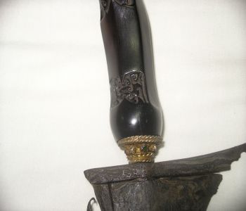

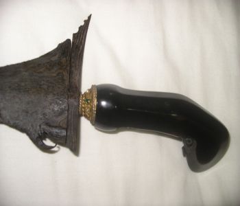

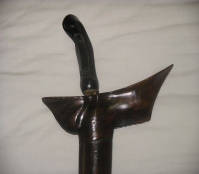

bought this 3 years ago but lost info about this keris but can remember that it`s a javanese origin i think.Any info or feedback appreiciate.......

I think so, that your keris is Javanese origin. The scabbard like a very old style from East Java. Discontinued product for now. This keris seems like from Pajang period (about 16-17th century).
You can comparing the characteristic with this one : http://kerisbudi.fotopic.net/c580201.html
Congratulation that you bought an old Javanese keris !!

Keris Jawa, luk 9.
Ukiran : wanda Surakarta.
Wrangka : Ladrang Branggah Persisiran.
Picture of the wood is too blur to determine wood/type of the warangka.

Can you pls help identify the dapur for this keris? Is it a sempana as in your website?
Discontinued model? Very interesting...

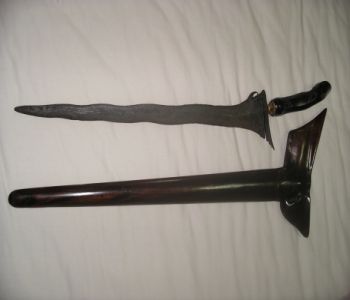

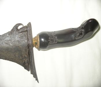

Ass.Kum pak Rachman,
Yes you right. The dapur of this keris is Sempana;
(http://keris.fotopic.net/c584030.html)
(http://keris.fotopic.net/c491687.html)
Often the keris from Palembang and Pajajaran (not Pajang as I said before) can make me confused. Keris from Pajajaran and Palembang has same characteristic (Jawa = Pasikutan). Perhaps it can be happen because the places of Pajajaran Kingdom is near with Palembang (just separated with Sunda Straits), so that the keris from those places looks same.
But, the blade of Palembang keris are stronger and thicker (Jawa = Ngelimpa) than Pajajaran keris.

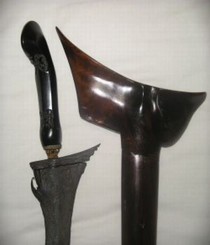

About the wrangka, I shaw the old wrangka with no pendok like this near with East Java style. But, sometimes we found it in Palembang keris. But if the Palembang style, each tip of wrangka bender that Javanese style. So that why I said this wrangka is old (antique) east Java style.
I do not know about the WANDA of this wrangka as Alam Shah wrote
WANDA is mean the specific carving style (not just style). If I'm not forget, the Wrangka Surakarta style has 8-9 Wanda and the Jogjakarta style has 8 Wanda like Ngabehan, Bancihan, Pakualaman, Mangkubumen, etc....

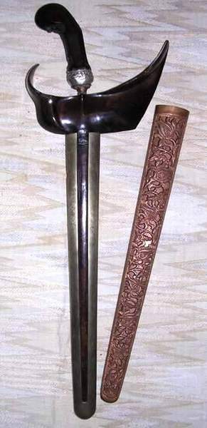

Default Ladrang sheath comparison.
The wrangka can also be from Old Sulawesi.
click here for comparison of ladrang sheath.

It's interesting that you say this model has been "discontinued". Any reason why? Maybe the empu emigrated to Palembang?
I can't say for sure just how old this keris is, but I have a couple of Palembang blades with similar features -- and I don't think they are that old.

Originally Posted by rahman
Pak Hidayat
Pak Rahman,
The men whose make the Wrangka not Empu, but called Mranggi. The Empu not making the Wrangka
Discontinued, I mean not made again by Mranggi worker. Perhaps the market not too interesting with wrangka like this. I don't know too much about the reason.
But, it's too hard to find the Wrangka like this in "New Made" except we ordering to Mranggi worker.

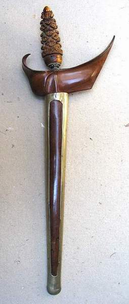

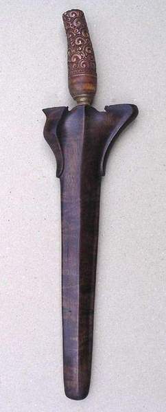

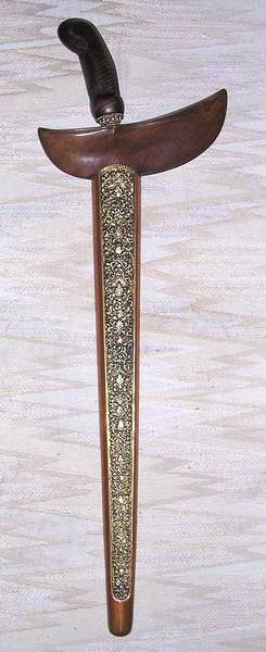

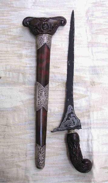

Here I posted some old wrangka which hard to find at keris market in New Made.
Perhaps you right that the wrangka and the blade are Palembang piece. I just don't know how thin this blade ? If this keris is thick, it is Palembang keris.

Ah! You meant the mranggi... But the wrangka shown could note have been from the 16-17th Century, so someone must still be making it. Perhaps not in East Java but in the northern pesisiran states. Semarang perhaps?
Thanks for the photos. I'm attracted to the Sari Bulan wrangka. Is that from Java? It does look like the Sumatran ones but a lot broader.

I feel it is rather difficult to be able to attach any certainty to the tangguh or classification of any keris blade based upon what can be seen in a photograph.
All one can see in a photo is an outline, and sometimes, if it is a good photograph, an indication of the blade features.
When we attempt to determine the tangguh of a blade we need a lot more information than is available to us from a photograph.
It may be a legitimate exercise to propose a tangguh from a photo in the case of some blades, as for instance a Sigaluh blade which is unique in its proportions and was very seldom a subject for later copies, but to affix a Pajajaran tangguh from a photo is something that is quite impossible to do , as even with the blade in the hand, Pajajaran and Mataram Senopaten are often confused, even by people experienced in the application of the parameters which can indicate a tangguh.
Pajajaran blades were subject to copy by Gresik, and it is difficult to tell a Gresik copy from an original Pajajaran unless you feel the texture of the blade surface:- Gresik pamor has a greasy feel to it, Pajajaran does not. Also, Pajajaran blades tend to have a tiny gap between the blade core and the pamor, this can often only be seen under magnification.
Then we have Tuban-Pajajaran blades, and Pajajaran itself is split into two distinct classifications, one having a blumbangan that is boto adeg (brick standing), one having a blumbangan that is boto rubuh (fallen brick ). Again , some ahli keris maintain that there are in fact three distinct categories of Pajajaran keris, not just two.
There are about a dozen indicators that must be considered before we can confidently give a tangguh for a blade, and be able to defend our decision that the blade in question could be of that particular tangguh. An outline from a photograph is simply not enough to go on, especially when there are so many possibilities, as is the case with blades of tangguh Pajajaran.
Also, it is wise to bear this in mind:- the word "tangguh" means "estimate". Even if you have twenty ahli keris in agreement that a blade carries the features of a particular tangguh, it is still just an opinion. It can never be graven in stone, unless the provenance of the particular blade is known.
Additionally there is no evidence that the tangguh classification that attaches to extremely old blades, such as Sigaluh, Pajajaran, or Jengala is representative of that blade having a point of origin in time that equates to the historic period from which it takes its name.
As many ahli keris in Central Jawa will say:- "tangguh ngak sungguh". Roughly, "tangguh is not real". The tangguh system is a good and a necessary system to allow us to classify keris, but it should be used within the context for which it was developed.
As for Palembang, there are several styles of blade that can be associated with Palembang, but the one style that we can be certain of as Palembang in origin, and not a blade that has come into Palembang by trade, is the Palembang blade style having the features of a Central Javanese blade, but with variations in material and execution. The Palembang court had an association with Central Javanese courts from the time of Sultan Agung.
When we wish to give a tangguh, or a classification to a keris blade, it is always best to very cautious. In the case of the blade in this thread, perhaps the best we can say is that it has shallow waves similar to the waves of a Pajajaran blade. But it also has the steeply angled gonjo that we associate with old Madura blades. Personally, I would not be prepared to attempt to give a classification for this blade unless I held it in my hand, and it was freshly stained.
The picture is Warangka Tanggalan model known since Kesultanan Demak but faded towards the end of Mataram Kartasura era. Even then, it managed to spread to Sumatra and Peninsula Malaya.
An attack led by Adipati Yunus with the armada from the Demak kingdom, at Singapura in the year 1511, to repel the Portugese from the island, might brought the influence and development of the sheath form into the Peninsula Melayu including Riau.

In the olden days, the warangka tanggalan which started during the Demak Kingdom started to decline after the fall on the kingdom.
This sheath form started the warangka gayaman and ladrang.
The practice of making the tanggalan form ceased near the end of the Mataram Kartasura era. Although it ceased in Java, the evolved sheath form are still made outside Java. It is known as sarung keris sampir bahari, or sarung keris Bangkinang, or Dua Hari Bulan. The form is still being made in the Riau Islands and Kelantan Malaysia, also in Surathani Thailand.
Other evolved sheath form includes Sarung Keris Buah Mancang and Sarung Keris Sari Bulan.
