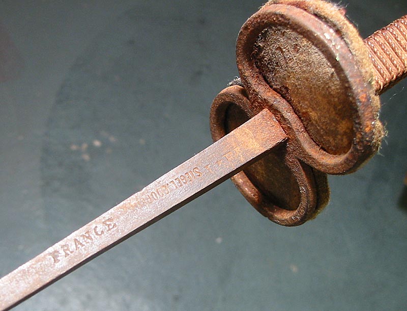

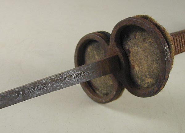

Hello everybody.
Does anyone know which forge marked it's blades
"L * Fres" ?
As far as I found out "Fres" is an abbreviation for "Freres" (french for: Brothers). But the other part of the marking is a mystery.
The pictures attached are taken of an actual ebay auction, but due to the fact that I have a similar weapon, I'm personally interested
Any ideas?
P.S.: The weapon offered has a figure-of-eigth guard, mine has a normal disc.

When I fenced all the foils (and Sabres and Epees) were By the French maker Leon Paul, with an occasional Wilkinson. And they were some of them early 20thC
I've seen these figure 8 types and they do seem to be right back to the first half 19thC which is nice.
Can you post some pics of yours?
Does it have the exact same stamps on the blade?

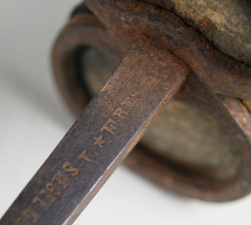

Hi William
Are you sure its not L*F ... and then seperately ...RES.. the type face and size is different.
Could L*F mean the hilt is Left handed French
Regards David

It's nice to see that there are still some enthusiasts out there
@Atlantia:
The figure-of-eight guard was used well into the 20. century (AFAIK they were tournament legal in the US until 1956, even though nobody used them at that time any more).
I'm unable to post pictures of my weapon, sorry. But the markings are generally the same. Mine is missing the Siegel-Cooper marking. But this is self-explanatory, because my weapon was not imported into the US, therefore needed no retailer. The "L" is missing on my weapon, because the marking is not very clear.
@ katana
Nice to "see" you again
I don't think so, because:
a) the weapon is right handed
b) look at the picture
c) I've never heard about markings which indicate for what type weapon the blade should be used. Generally the french blade can be used in a pistol grip whitout much conversion. The italian blade only fits italian handles and the french blade could be used under special circumstances on an italian weapon as well. There would be no need to mark it this way.
But I must admit: Clever guess. I've never thought about that.

But you are right, there is little written on this topic. Unfortunately I just have Lhoste/Buigne to get information from. They have "Talabot freres" listed, where the freres is also written with a capital "F" and smaller "res". Does anyone have a chance to check the other "big books" on markings?
Perhaps there is a solution to this riddle after all.
