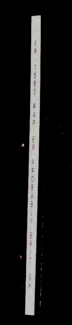

Old 9th December 2008, 08:09 PM   #15
Ed
Ed's Avatar
Posts: 315
Victorian re-hilted German 16th c. blade?
Old 9th December 2008, 08:15 PM   #16
katana
katana's Avatar
Location: Kent
Posts: 2,658
....possibly a 1580 Rapier....British
Old 9th December 2008, 08:33 PM   #17
Ed
Ed's Avatar
Posts: 315
Cheater
Old 9th December 2008, 10:08 PM   #18
celtan
celtan's Avatar
Join Date: Sep 2008
Location: PR, USA
Posts: 679
The Taurag Trap has been avenged!
No, seriously, you guys think it truly can be late 16th C.? It's gorgeous, I salivate everytime I hold it....
celtan is offline   Reply With Quote
Old 9th December 2008, 10:32 PM   #19
katana
katana's Avatar
Location: Kent
Posts: 2,658
Originally Posted by Ed
Cheater

Old 10th December 2008, 12:03 AM   #21
kisak
kisak's Avatar
Join Date: Jul 2008
Location: Stockholm
Posts: 182
To continue with my rampant guesswork and speculation, I guess the blade could be the real deal, but that hilt looks fishy. Maybe not the oddest I've seen, but nothing I'd dare stamp as authentic on my own.
And while manufacturing dates aren't contagious, the fact that it seems to be in the same batch as the Executioner's Sword and the Bastard isn't exactly a good sign.
kisak is offline   Reply With Quote
Old 10th December 2008, 12:15 AM   #22
Ed
Ed's Avatar
Posts: 315
Frankly, and I mean this in a constructive way, the hilt looks like it belonged to a bouncer in a bordello. An old bordello perhaps, but a bordello nonetheless.
Really.
Old 10th December 2008, 12:24 AM   #23
katana
katana's Avatar
Location: Kent
Posts: 2,658
Cheater
Or as Mr Sherlock Holmes has said..."“There is nothing more deceptive than an obvious fact..." Who's to say the label on the sword is correct though....
Kind Regards David

The blade *could* be genuine 16th - 17th c., but better pictures (short of direct inspection) would be needed. For the hilt, my bets go to "modern" (19th-early 20th c.) on stylistic, decorative and construction grounds (I agree with Ed in that there's a certain degree of... "pimp-ness"... in it )
Old 10th December 2008, 01:54 PM   #26
celtan
celtan's Avatar
Join Date: Sep 2008
Location: PR, USA
Posts: 679
Well, I guess I may have been an English Pimp in a past life, cuz I like the darn thingie...
I'll try to take more pics and weight the items next time I visit.
BTW:
Does anyone know of a mid 19th C. European armourer/s by the initials ISB?
Best
M
Old 10th December 2008, 04:18 PM   #27
Ed
Ed's Avatar
Posts: 315
The blade looks ok to me but, my dear, that hilt.
You know, if it were cheap enough, I'd think about buying it, loosing the hilt and displaying the blade.
