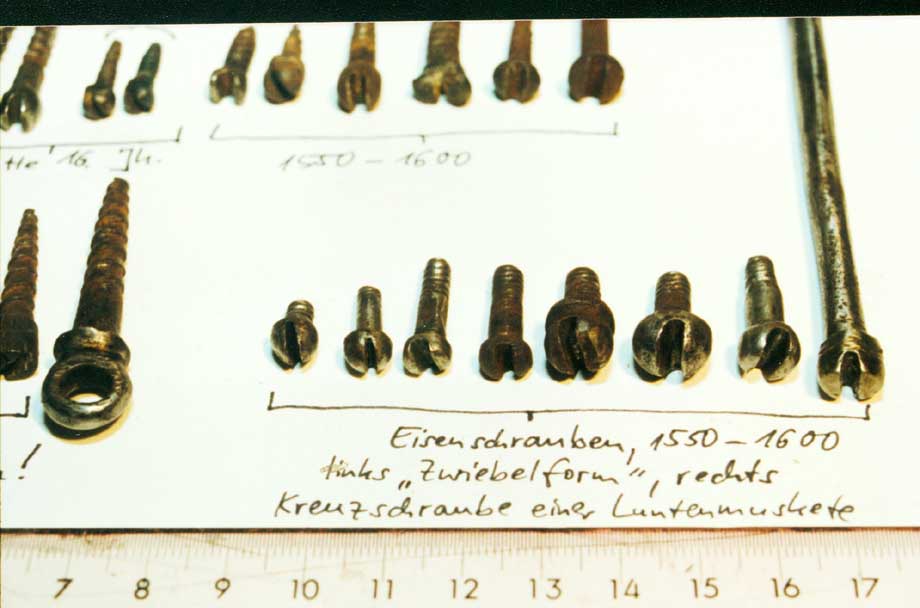

Default 16th and 17th century gun screws

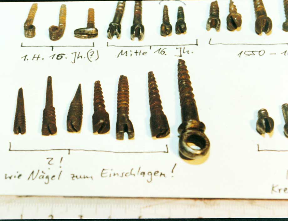

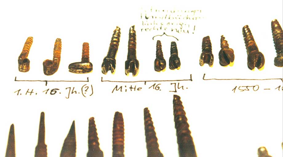

I don't think anybody - besides you, Richard, of course - has ever paid attention to such little things and tried to achieve a comparison and dating scheme like this.
Old 3rd December 2008, 09:12 PM   #2
Posts: 10,281
I confess Michael I too have noticed such minutiae, which was what prompted my thread earlier on the use of threaded screws in sword hilts.
In weapons forensics, such details can often be key in determining correct period in components in the piece being examined.
I always think of one of my favorite analogies....who but Sherlock Holmes would fathom the importance of burnt tobacco ash in investigation of crime scenes, and compile an entire treatise on it !

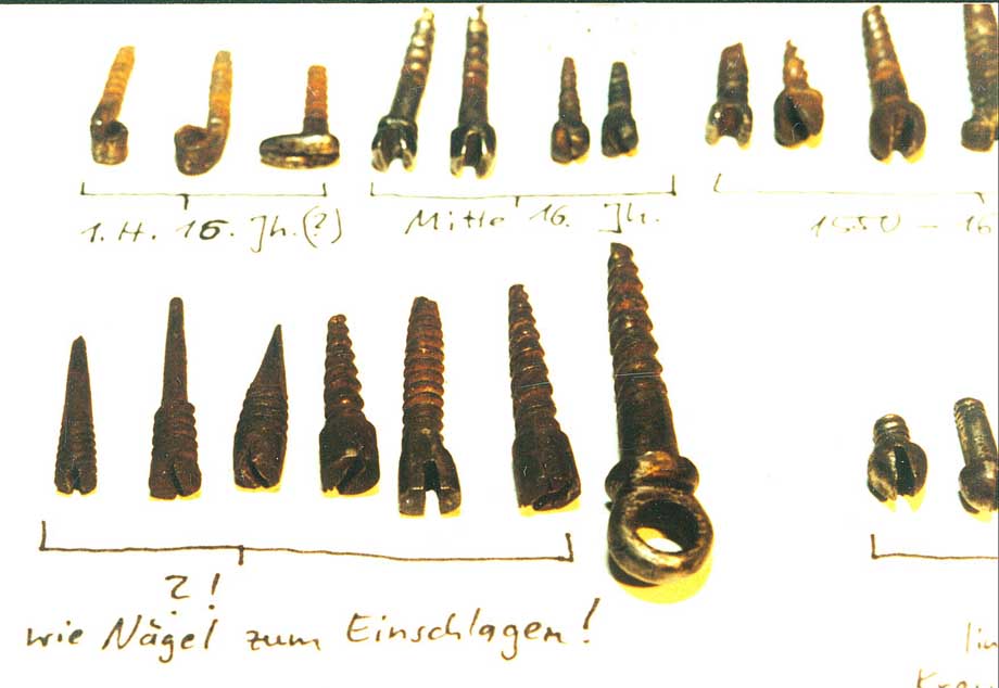

Old 4th December 2008, 06:46 AM   #4
Pukka Bundook
Join Date: Jan 2007
Posts: 803
Some of these look nearly as 'bad' as the ones I make, Michael!!
In the mid 16th century section, Do I see one with a left-hand thread?
What really surprises me, is that right-hand thread became so standard so soon.
It is interesting how different shaped files were used to cut the threads on the wood screws...some fine and others a much coarser thread,
Mine turn out very similar, depending on what file is at hand at the time!
I should print this page of to keep as a reference.
Thank you for taking the time to compile this chronology!
Richard.

Richard,
I took these photos some 20 years ago. Were they new I would have considered the forum community and given the description in English.
These screws are now back in their guns and I cannot tell whether one of them is left hand threaded. Sorry about that.

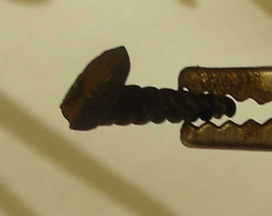

Thanks Fernando! It really did not show up yesterday evening, but since then you have given me the "all clear" and I can make progress.
Now I can finally complete the post.

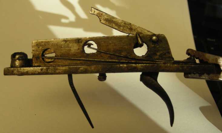

The two photos show a screw taken out of a target rifle by Franz Xaver Zellner, who is well recorded in Stöckel (with several others of his family).
He was an Austrian gunsmith who died in 1768.
So we may deduce that such screws were in use long after the 16th century (as hypothesised in the photo by "matchlock"). That is the problem with technological changes - the forces of "we've always done it like that" are very strong in such specialist areas.
This oddly shaped "hand-carved" screw is (still!) used to hold the back end of the set trigger block in position, the front end being clamped by the trigger guard (a popular method). The bent head enables it to serve as a fixing lug for this purpose. Presumably that was considered to be simpler than making the trigger baseplate longer, with a fixing hole drilled through it and a conventional screw inserted, as would be the modern method.
At present, the rifle is undergoing its 250-year service in my cellar. Like most of my rifles, it's no museum piece, but the bore is great for its age. "Pure" collectors will cringe, but my point of view is that guns are tools, and non-functional tools are of no use to me. And I thus consider it proper to do what anyone of the period would have done to keep them functional.
I would have posted a couple more photos, but they are over the 1Mb limit and I now have to puzzle out how to reduce the resolution so that I can upload them.
And a great New Year to you all from Patrick.

This is the hair-trigger (D: Nadelstecher) which is held by the lug-head screw in the previous posts. The front end is clamped beneath the trigger guard, and the lug-head screw clamps the back end (where the modern clamp is shown).
It is unusual in having an extra intermediate lever, which makes it extraordinarily sensitive, in spite of the strong sear spring. And all edges are sharp. After all, it's only about 250 years old!
SchildaBrit is offline   Reply With Quote
Old 3rd January 2020, 03:23 PM   #19
Perfect !

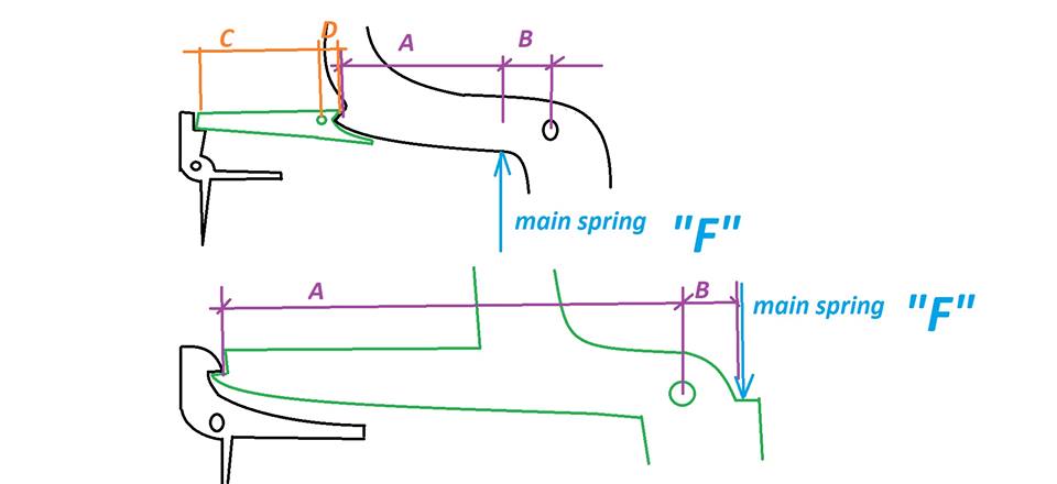

Hi
To who wants to know how the "hair trigger" works here is a design of the two variants
Affectionately

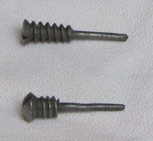

Default Another pair of curious screws

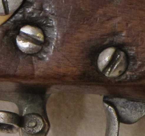

The lug-head screw I presented previously is functionally the same as the 3rd screw in the top row of Michael's fascinating collection.
The 2 hand-made screws shown here correspond to the 2nd screw in the second line of that collection.
They are from a Bern Cantonal Ordnance musket of 1804. Rather towards the end of the period of interest for this forum, but illustrating how traditional methods were still in use at a time when screw-cutting lathes were becoming available.
Functionally, they are much superior to the plain pins often used to hold the front end of the trigger guard or to provide a trigger axis, as these tend to rust to the point of becoming fragile over the centuries, and are a right PITA to remove, like barrel pins.[IMG][/IMG][IMG][/IMG][IMG]
