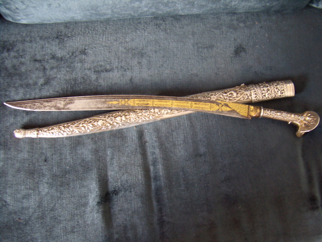

Hi, this is a great yataghan with a very good calligraphy.
Looking forward for a translation. Its a lot of work for our islamic script experts, but even a general comment about what are the inscriptions about whould be fine! Thanks!

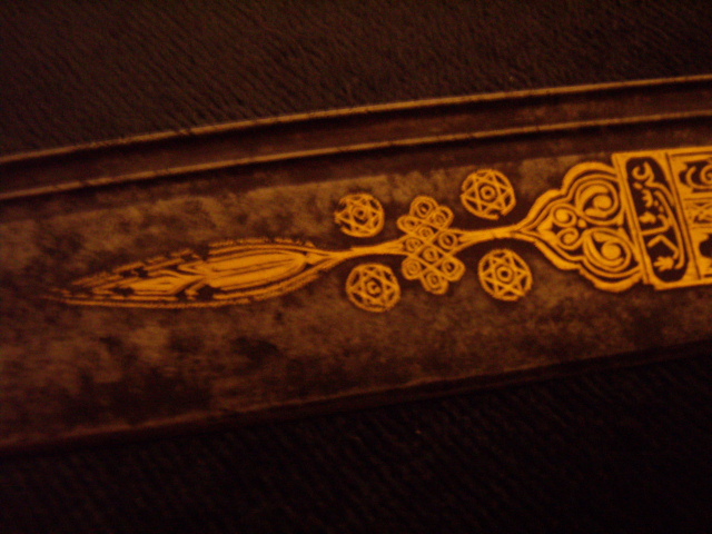

Looks a very good koftgar. The third photo seems upwards. I don´t recall in this moment seeing the blade grooves going so far to the point on a yataghan. Thank you for the photos.

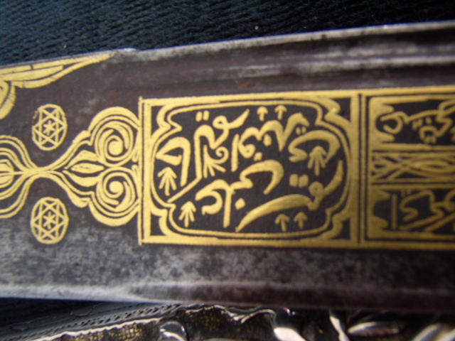

Hakim Ali Besim Efendi (this is the name of the owner, the title "Hakim" has two meanings, 1) judge, magistrate 2) ruler, governor)

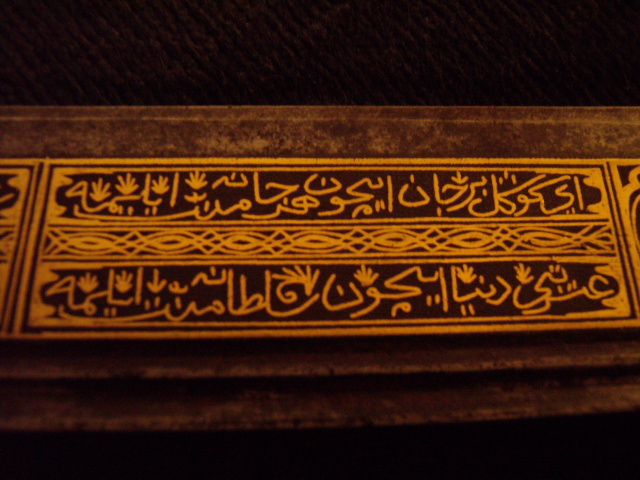

Ey gönül bir can içün her cana zillet eyleme
İşret-i dünya içün sultana minnet eyleme
Do not hold oh heart all the lives in contempt just for a life
Do not bow to the sultan for the pleasures of mundane life

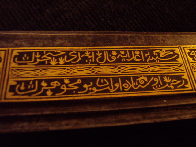

Sine-i 'adaya fal açtı hançerin
Rahmet üstada olsun bu mücevherin
Your dagger opened the bossom of enemy for soothsaying
May God Bless the master of this jewel (meaning the yatağan, I believe)
This is a very interesting part but there is also possibility that I'm not interpreting it correctly. Soothsaying by looking at the entrails of animals was a pagan practice, it is interesting if the inscription refers to such knowledge.

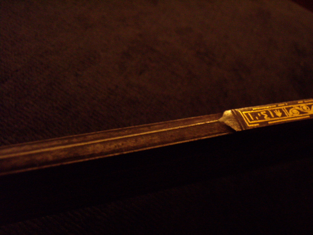

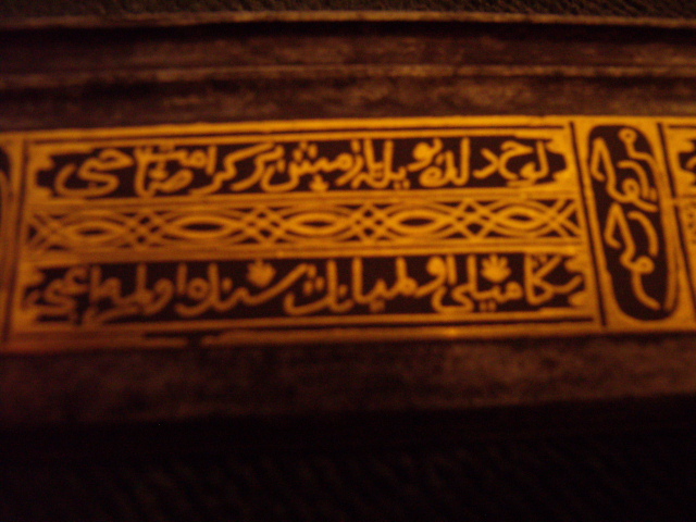

1241 (1826)

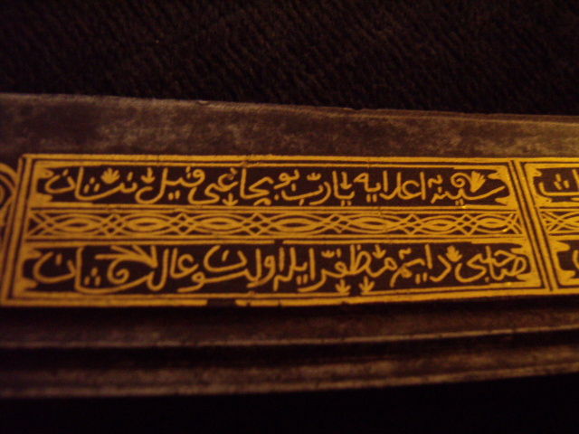

sine-i 'adaya yarub bu bıçağı kıl nişan
sahibi daim muzaffer eyle olsun alişan
Let this knife be a sign on the bossom of the enemy
Let its owner be glorious and high in fame

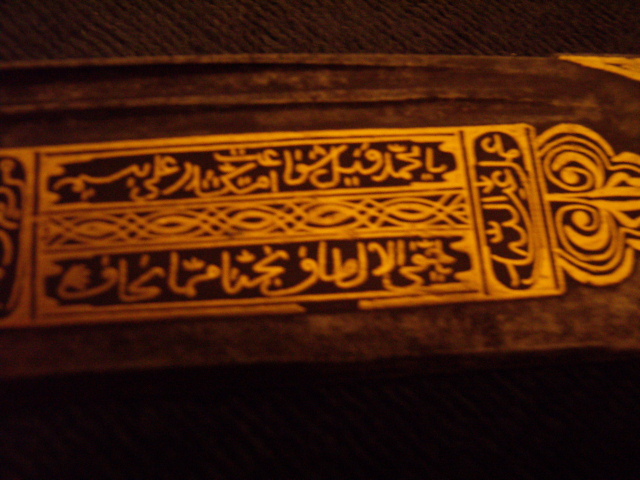

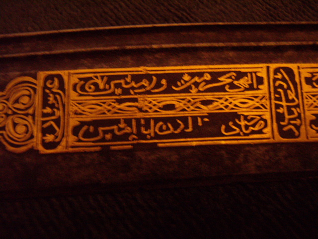

1)Ya Muhammed kıl şefaat ümmetindendir Ali Besim
2)Ya Hafiyyü'l-eltaf ................................... (need help from Dom here)
1)O Muhammed! Intercede on the day of Judgement on the behalf of Ali Besim who is one of your Ummah (community of believers)
2)???

Originally Posted by Zifir
1241 (1826)
The koftgari looks to be in very good condition if it's nearly 200 years old.
Is it possible this sword was made to memorialize the massacre of the Janissary corps in 1826 by Mahmud II?

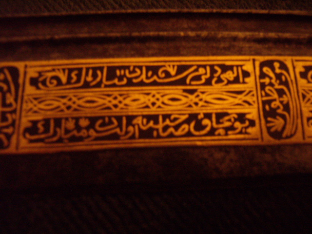

İlahi dilerim sahibine tebarek
Olsun bu bıçak sahibine mübarek
O Allah we ask blessings for the owner of this knife
Let this knife be auspicious for its owner
Excuse my poor translation, but the overall meaning is understandable I think
In fact the number (2) is partly erased, I am just guessing It's (2). Other option is to read it as 1341 (1922) but I don't know really.
That date makes sense: 1922 essentially saw the end of the war of independence and abolition of the Sultanate. 1923 was the year independence was ratified, however.

Originally Posted by TVV
To me this looks like an early 19th century piece. I do not find it that unusual for inlay to be preserved well, especially if it was well done, which appears to be the case with this quality yataghan.
Teodor
Is it an inlay? It called my attention the lack of visible crisscross to be koftgari, it seemed too perfect, but I thought the lines were too wide to be an inlay. Altough, photograps can be tricky in relation with proportions and sizes. Yes, the apearance is more like an inlay, but I need to confirm it with you. Thank you.
Gonzalo
Gonzalo G is offline   Reply With Quote
Gonzalo
Gonzalo,
Just like you I am going by the pictures. Eftihis is the owner of this beautiful piece and maybe he can shed more light on the technoque used for the inscriptions.
Teodor

If this yataghan was not used and it was in the scabbard for 200 years it is normal that koftgari is like new.
You can notice that it is some gold missing on the back side of the blade. Exactly were it is more like to be missing, because from the contact with the throat of the scabbard anytime you push it in or you pull it out.
2)???
2) Ya Hafiyyü'l-elaltaf nagina mema nakhaf
2) save us from what we are afraid
thanks for the translation,
because .... was in turkish
great job
