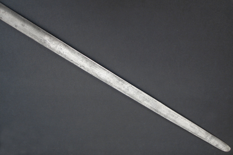

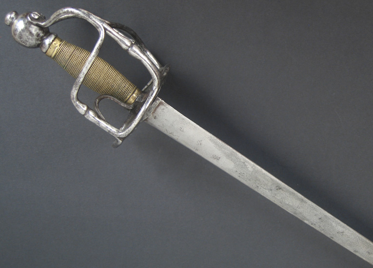

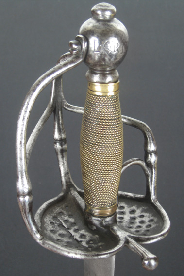

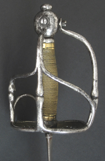

This piece is on its way to my little collection.
Said to be German, dated around 1700.
Blade length 91, 5 cms
Width 38 mm

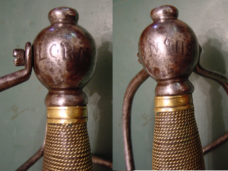

There are some numbers and letters marked on the pommel - LCR N118 - said to be regimental markings.
I would like to know your opinnion on this sword, namely on its age, country of origin and, if possible, an idea of the markings provenance.
Thanks a lot in advance.
Fernando
Old 4th November 2008, 12:33 AM   #2
Posts: 10,867
Very, very nice Fernando!!
These very businesslike military swords have always been most appealing to me, and I was always intrigued by the curious term for them. According to Neumann, "Swords and Blades of the American Revolution", pp.156,157) these bilobate counterguard horsemans swords seem to have originated in the Low Countries around the first part of the 17th century, and gained popularity across Europe. The term 'walloon' refers to the people of Wallonia (fr.=wall), which is a region in Belgium, and it seems likely became colloquially used , probably by the French, for this type of sword.
In Wagner ("Cut and Thrust Weapons", 1967, p.372) there is an Austrian cavalry example nearly identical to yours, shown as the beginning of the 18th century. I cannot recall offhand the case with the prominant screws holding the elements of the guard to the pommel, but this seems also a very early feature, and the rebated, rounded point of the blade is most interesting. It seems these type blades are seen on German swords of this period.
I am not sure on the markings, and they same inscribed later, on the pommel seems unusual.
All best regards,

Awesome sword, Fernando! (green with envy, green with envy! _Did I think that aloud!). The rounded tip is just like that found on one of my swords (the Spanish bilbo). I had assumed the tip had broke & been reshaped or that it had lost its point from over-sharpening.
Jim, did I understand you correctly that some of the older swords with slightly rounded points were a common pattern in German swords? As said above, I've seen this in some Spanish pieces as well (probably imported blades, I imagine?). thanks,

I wouldnt say it was particularly common, but I have seen this rounded tip feature on a number of German 17th century blades, one with Spanish markings mounted on a Scottish baskethilt mounted c.1680. I have seen the same tip on German blades with Spanish markings found on Hungarian sword of same period. To me it has always seem interesting that the blades on Omani kattara are invariably with rounded point, as are Tuareg takoubas, both known for receiving German trade broadsword blades.
It would be interesting to check on resources to see how many instances do reveal this rounded tip, and how often they occur on German trade blades.

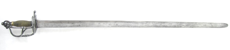

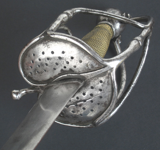

I recently purchased this:

Very nice sword, Carl! I particularly like the grotesque staring face on the guard. Is this reminescent of the so-called mourning swords portraying the "death's Head" of King Louis? These types date to the English Civil War period, contemporary with your walloon. Great find!!

Posts: 4,310
Hi 'Nando,

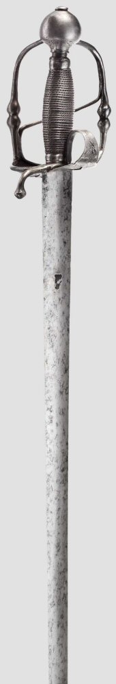

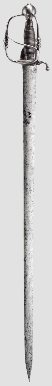

I too have to join in the multifold praise of your sword though strictly speaking it is not of Walloon type but a normal field sword for cuirassiers and dragoons.
From what I have learned, a date of ca. 1700 would seem exactly correct as the use of screws on the hilt denotes, as well as the rather small knots. These do not occur on earlier types of swords.
It possibly is of German (Solingen) manufacture, and the numbering and initials relate to the bearer und regimental number. This type was in use almost over Europe, including Spain.
The other nice Walloons illustrated here I would assign to the 1640s to 1660s.
Michl

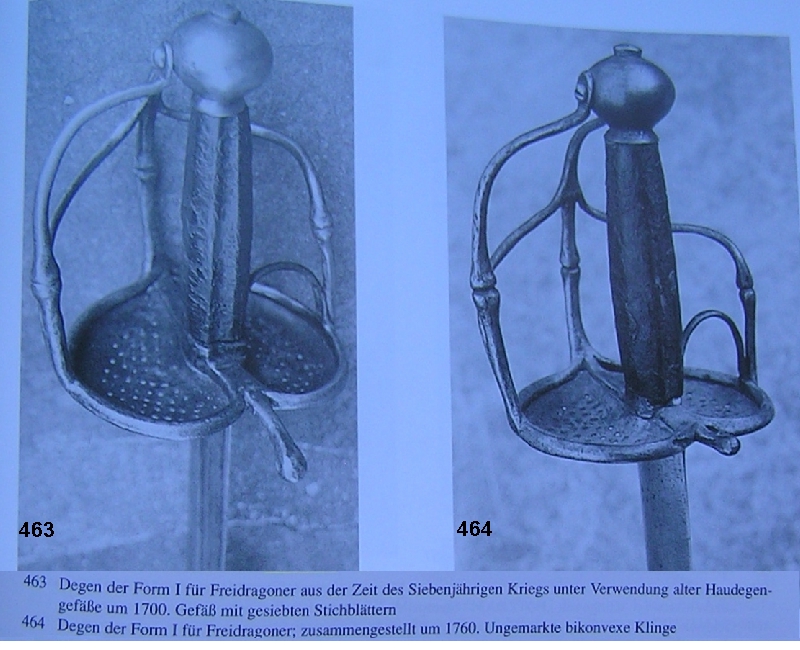

You will notice that, it has been almost two years since i posted this sword. In the meantime i have learned a bit more about it, namely on the typology side. It seems as the Walloon term has been used (and abused) to define the swords within a detemined area of characteristics. Such is the case of my example; having bought it as being a Wallon sword, i later learned that it is in fact, as you well alert, a Dragoon sword ... although, i repeat, it falls within the Walloon range in several sources.
As for its country of origin, that is indeed my actual concern. Certainly the (regimental) marks in the pommel would bring some light to it but, so far, no one has yet identified them.

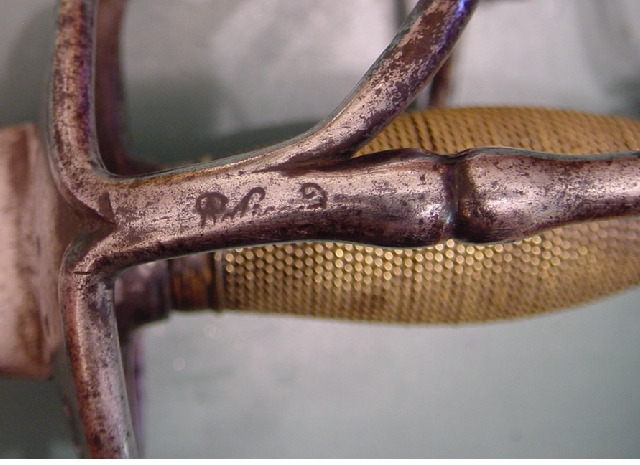

Worthy of note is what seems to be the signature of its ownner/user in one of its guard branches.

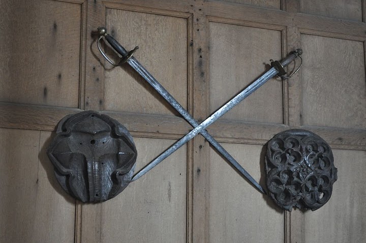

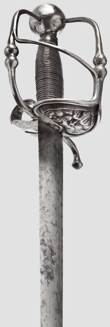

Green plus three here to see these in other hands. I am wondering about this pair attached below. Obviously later than the Walloons but seem in kind to some other early 18th century pallasch. The swords were espied in the Haddon Hall in Derbyshire. A bit of looking about shows Haddon Hall pretty much redone and any association might be pretty vague but one thought was that they were late 18th century heavy cavalry dress swords. While the 1796 dress might somewhat resemble these, I couldn't agree and was figuring they must be a good bit earlier.
I am afraid I am probably and terminally stuck pursuing early Americana but the Walloons and later pallasch somehow seem to be part of the natural progressions of straight cavalry swords.

The markings on the pommel are as noted likely regimental, and German and Dutch units were usually designated by colonels name, the LC perhaps initials from a name with C for cavalry, the R of course regiment. No. 118 of course likely rack number, but may be other.
It would be interesting to see other examples of such unit markings on other pommels.....anybody have any they might post?
