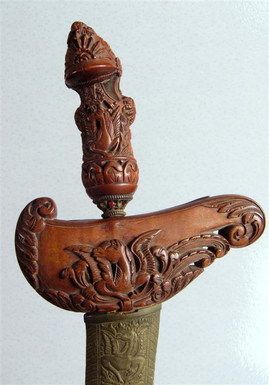

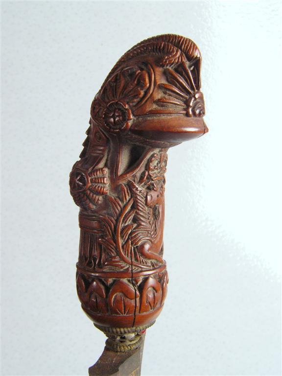

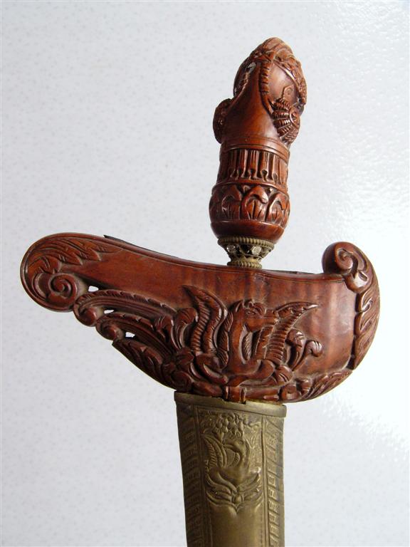

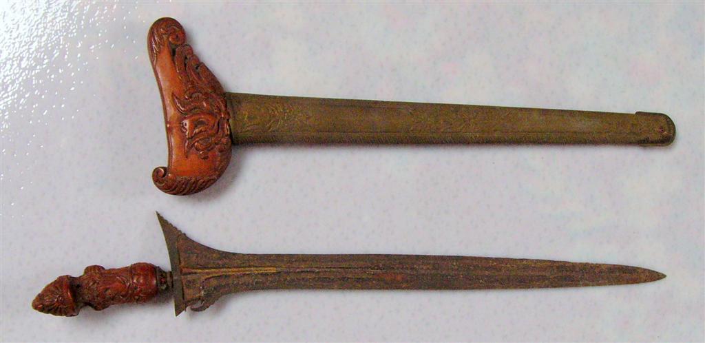

My first post in this forum. I have a few keris, mostly Java and Bali with a few others. My focus has been on Moro, but am re-developing an interest in the Indonesian varieties, particularly the Javanese and Balinese.
I have this keris on loan from a friend. She mainly collects African artifacts, but came across this keris. I am guessing Madura. Would appreciate frank comments.

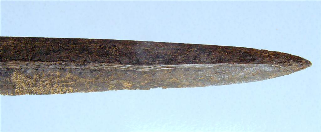

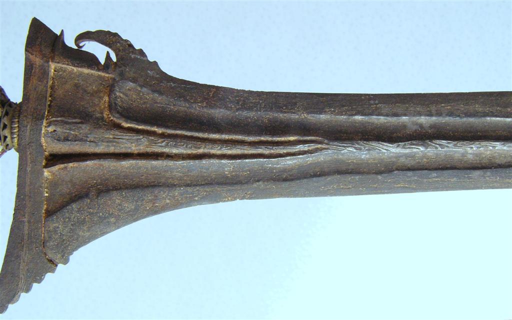

The blade is in serious need of cleaning and staining. I have her permsiion to do this and may give it a try if it would be worth it.
Comments?

That's a pretty nice Gabilan style piece Bill .
If it's a souvenir it's a very nice one .
The blade is lovely from what I can see but as you say it needs cleaning .
A soak in pineapple juice might be called for as a starter .

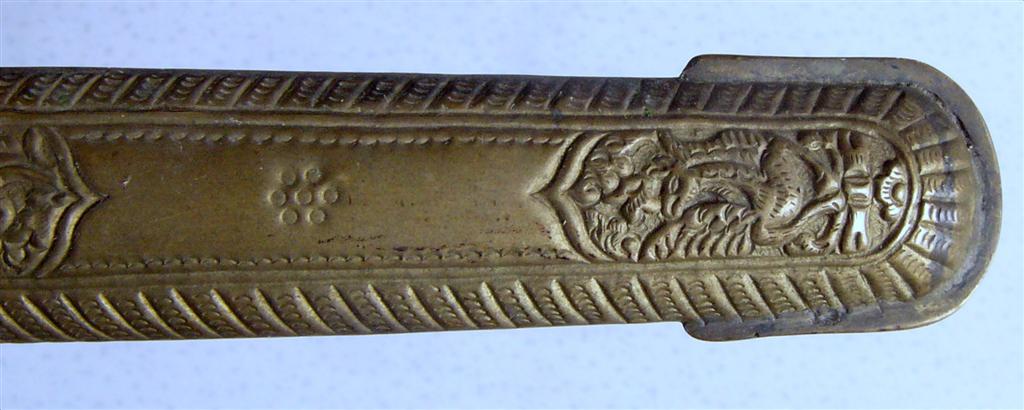

The horse motif is nicely carried over to the pendok .

Yup, a madura keris it is. As Rick mentioned, you need to clean it to remove all the rust, using citrus or pineapple juice to start. The blade may not be the best workmanship but interestingly, the pamor is not common. Here you have pamor dhadung muntir (in javanese term for twisting rope?). Overall, its a nice keris. You may want to change the hilt. I prefer the hilt to be something like below.

warangka : maduranese
dhapur : sinom
pamor : dadung muntir ( twisted rope)
the graneng and the other ricikan like sogokan and tikel alis was not well executed. it's a new keris from madura.
how ever, recent keris from madura are also made in a traditional way.

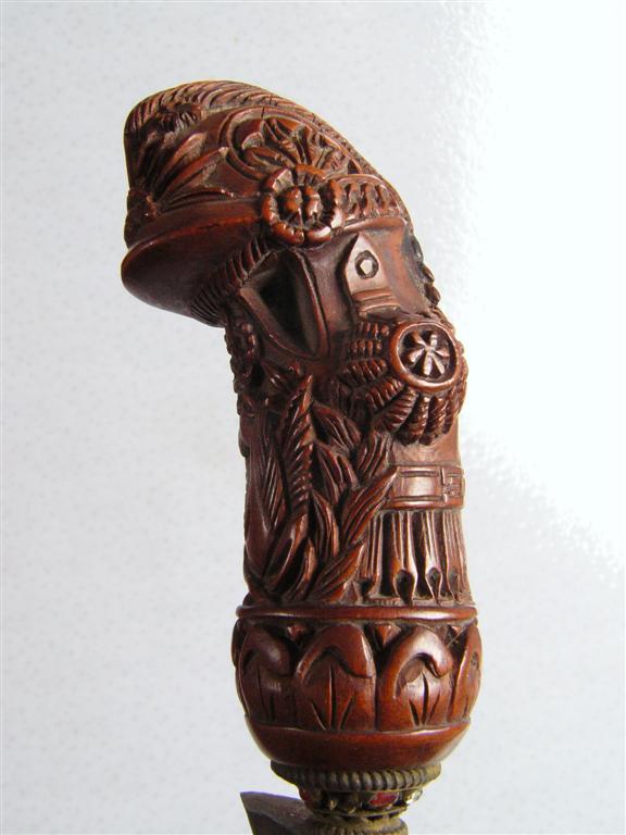

the mendak(ring) is a low quality one, the handle shows a crack in the midle,
couse it made from sawo wood ( not a hard one). the carvings are very fine.
regards

Bill,
That's a lovely maduran keris. Worth cleaning and staining.

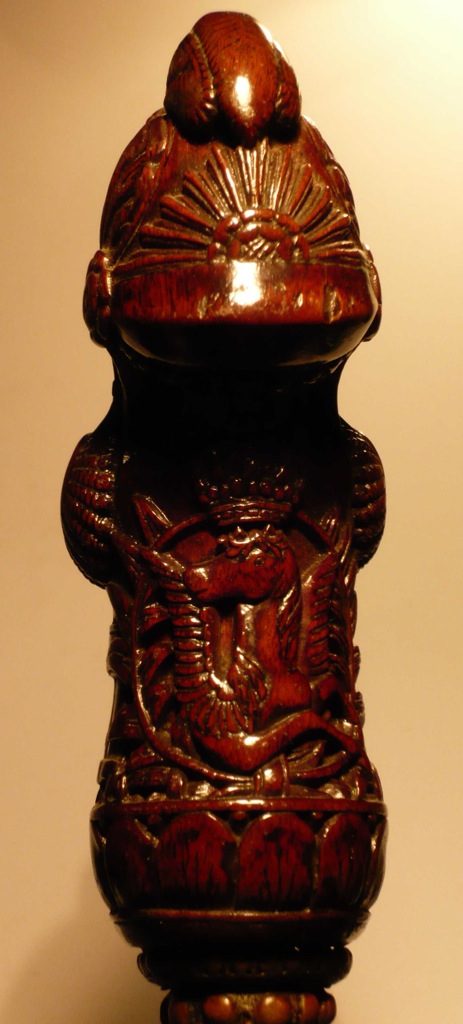

The ukiran is the cuirassier type. Very well carved. The crack is a pitty.
http://blade.japet.com/KRISS/K-Ukiran/U-madura.htm
The wrangka is very nice carved as well. The pendok has the typical maduran european influence like the lower piece of the scabbard of a sabre.
Maybe a newer keris but in my opinion a very nice one.
Wouldn´t think about changing the ukiran.

I agree with Henk about not change ukiran. IMO the hit is right with sarong pattern and with pendok too.

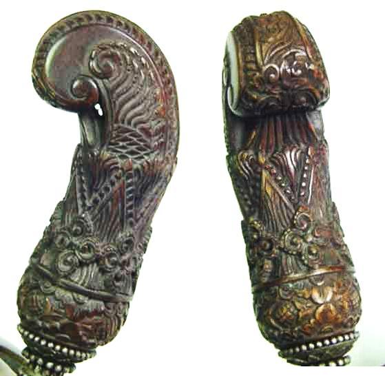

Nice keris and I think it’s in original shape, no need to change the hilt.
The warangka is in Urang Urangan/Deng Udengan style, The hilt in Ukir Topi style (hat/cap)
The flying horse carved on the warangka called Mega Remeng, this is a legend about a flying horse owned by Jokotole, a king of Sumenep.
Now, it is not easy to find original keris like this even in Madura, Well…accept going door to door to collector houses. So…nice keris and just keep it, it is worth.

I love the hilt!
And the overall ensemble is good. I'm still waiting for a good old all-original Madurese keris to come my way...

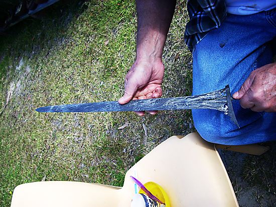

There are many ways to stain a keris blade.
All will produce some sort of result.
However, there is only one way to produce a quality result, and that involves massaging into the blade the lime juice into which the arsenic or warangan has been stirred.
The suspension is brushed onto the blade, and then it is massaged with a pinching action until the blade becomes very sticky; more suspension is applied and the procedure is repeated time and time again until the desired colour is achieved. The blade is then rinsed with water, dried with a lint free cloth, and then dried in direct sunlight. Then the complete procedure is repeated again however many times required, until the blade is the correct colour.
If this procedure is carried out on a dull, cloudy day, the resulting stain will lack life; it will be a fair stain, but it will not lift and sparkle. The same, but more so applies if it is done inside.
If the suspension dries too quickly the result will take too long to achieve, and because of this length of time involved, the result will be dull. It is best not to carry out the procedure on a very hot day, and neither the blade, nor the suspension should be heated. When I have done this job in Solo, I have found that the best time is about 8am to 11am during the dry season. That means low relative humidity and a temperature of around 25 to 30 degrees celsius.
If the suspension dries too slowly it will generate yellowish green spots under the black.
The two factors that principally affect drying speed are temperature and humidity.
Excellence of the final result also depends very strongly upon the blade being absolutely white and free of any rust prior to commencement.
Here is a photo of me staining a blade, this shows clearly the way in which the suspension is massaged into the metal.
