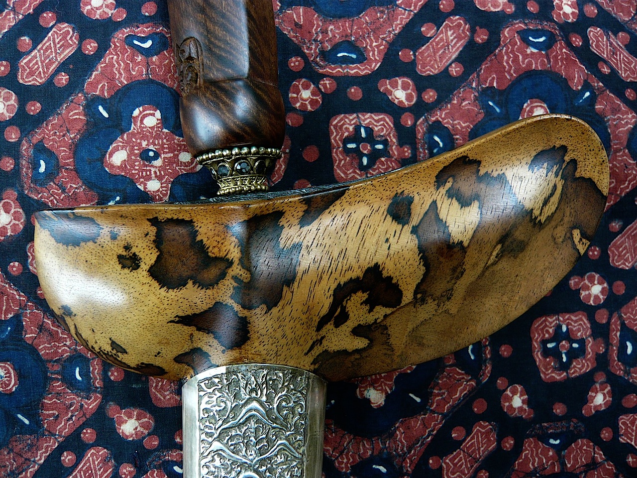

Hi...
According javanese people that believe about good timoho wood for keris sheath is that wood has pelet. What is pelet actually? Is it those black spots on the wood?
bre

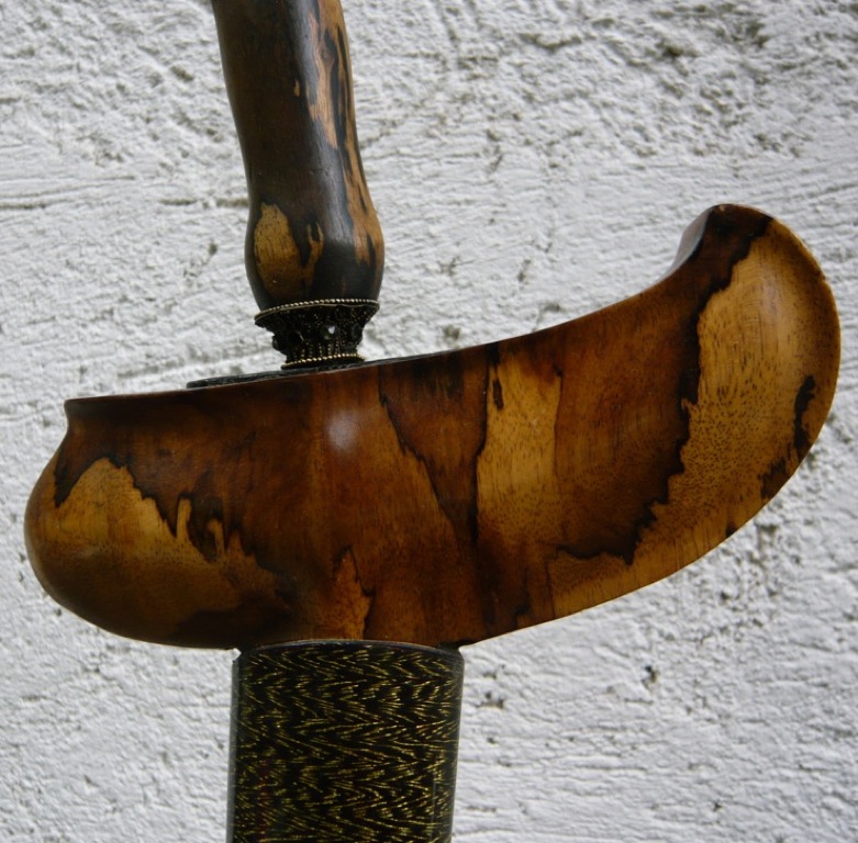

Old 20th September 2008, 02:36 PM   #5
Posts: 7,134
Yes, and there are other names as well---some invented on the spot because they will either A)--help to raise the price, or B)-- help to raise somebody's prestige.
In my notes I do not have an example precisely the same as the wrongko you show, but if we look at this wrongko, essentially it has dark in the center of the body, and light on either side. Perhaps this conformation could be classified as timoho slempang---a slempang is a strap that is worn over the shoulder.
Or maybe the dark area is too wide for timoho slempang, maybe we should call it timoho sidi---but really, that would be stretching it because the white is in the wrong place. Pity it has those two light spots on either end, without those we could give it as bosokan.
This name of the timoho thing is like a lot of names in the field of the keris---cross the street and somebody will give you a different name.Especially today when we have so many newly born, self-created experts around. It tends to become a little less confused when you talk to old men who have been in the keris trade for most of their lives---but these people don't publish books or join keris discussion societies.
Centini should be required reading for all who wish to learn the keris. Not for the information to be found there, but for the advice and the wisdom.

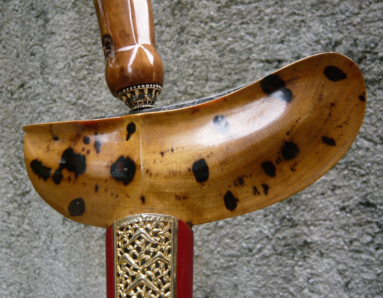

OeS
Some timoho sarongs with different patterns....

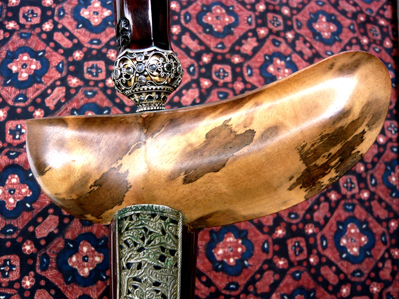

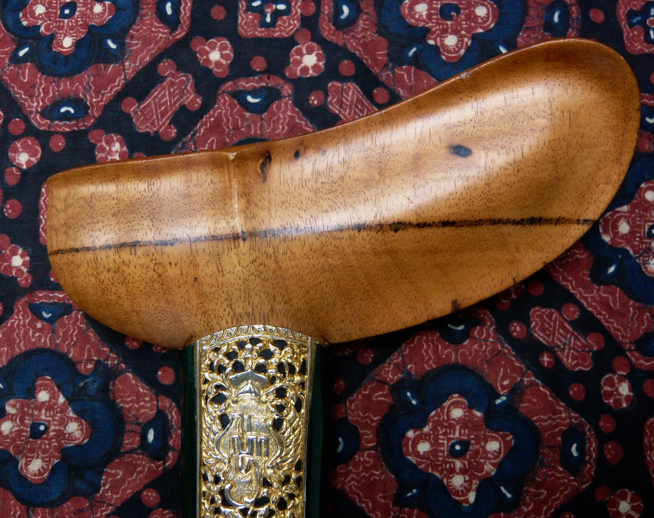

Old 21st September 2008, 02:57 PM   #11
Marcokeris
Marcokeris's Avatar
Location: Italy
Posts: 928
....others

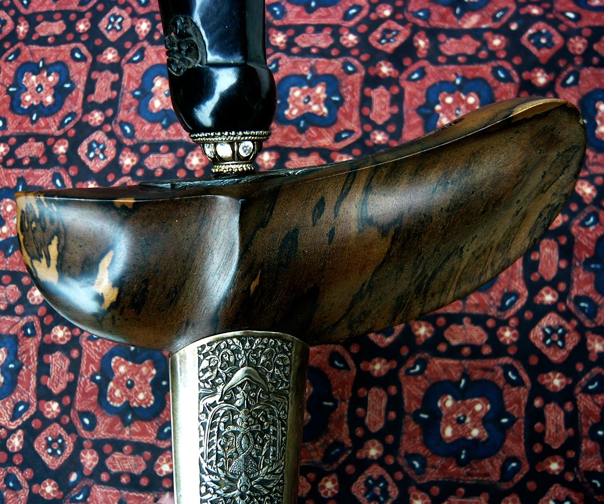

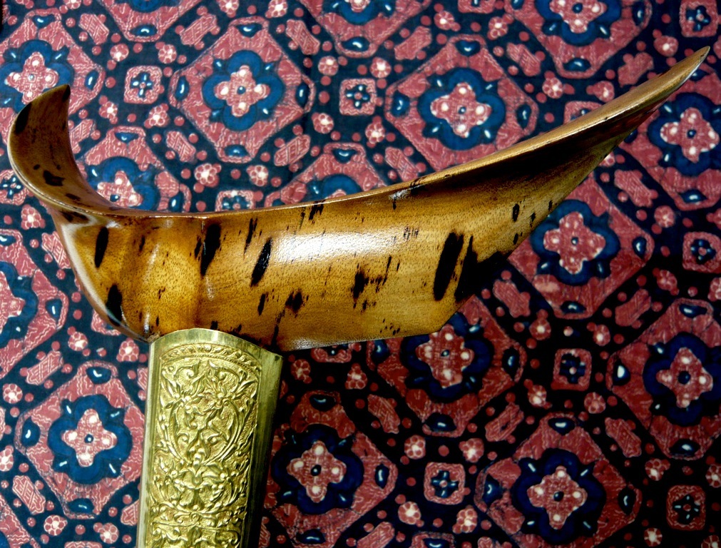

Old 21st September 2008, 04:18 PM   #12
Marcokeris
Marcokeris's Avatar
Location: Italy
Posts: 928
one more
