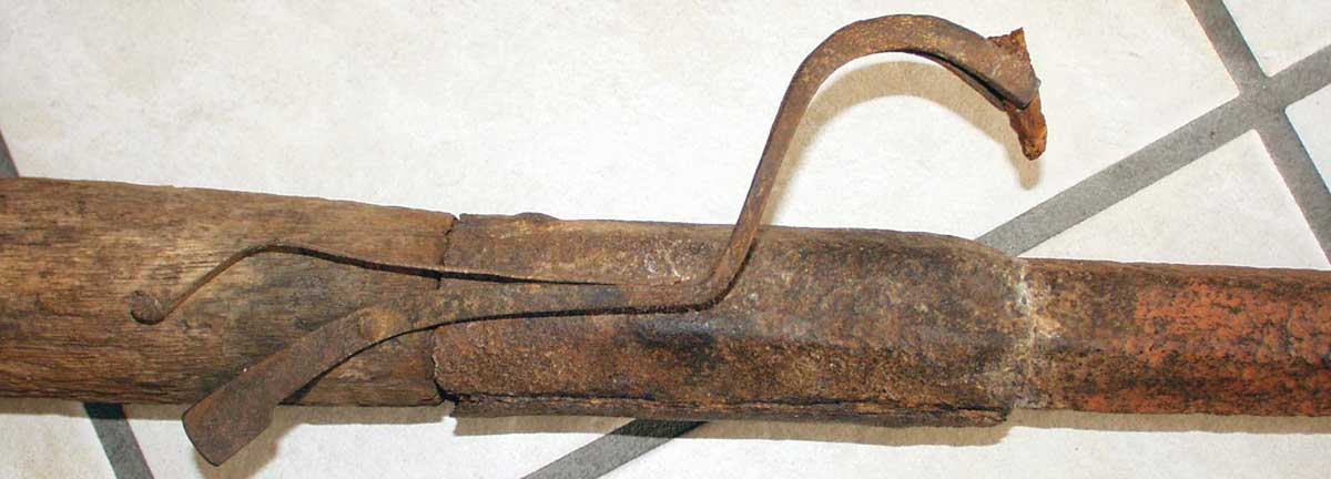

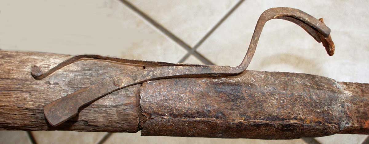

I should mention that the hook, like the firing mechanism, seems to be a working amendment as it is not wrought to the barrel but split in half, drawn over the muzzle and riveted on the underside.
The comparison with the attached illustrations of 1405, 1410 and 1411, with no support hooks present, indicates that the hook which actually defines a haquebut (German: Hakenbüchse) was an invention of the first half of the 15th century.
For having patience with me you are credited with additional images.

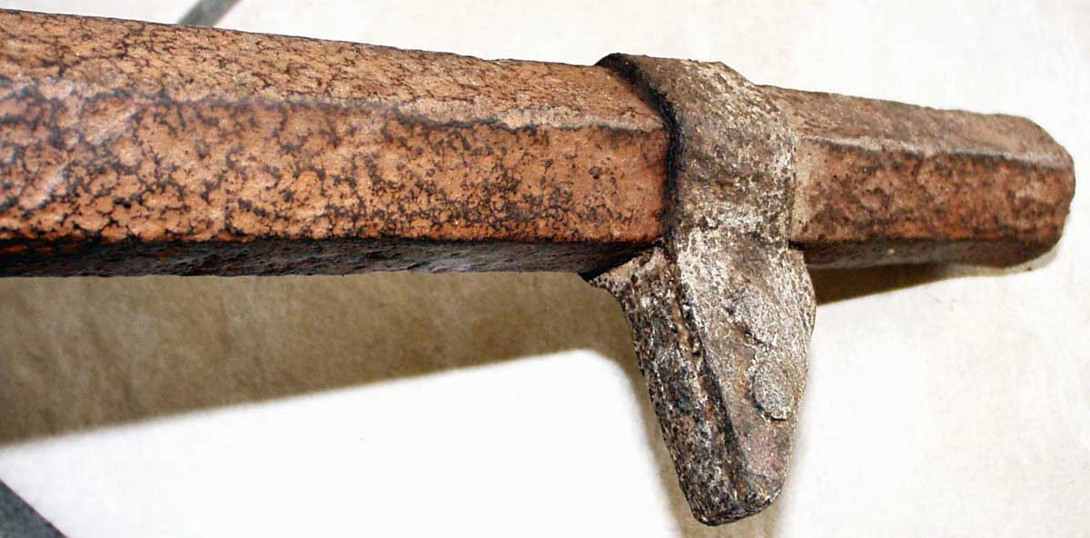

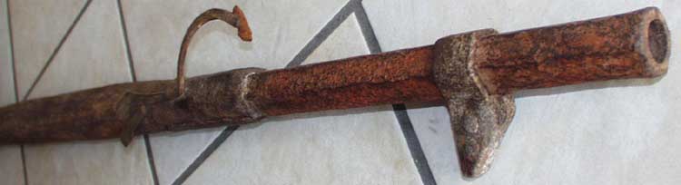

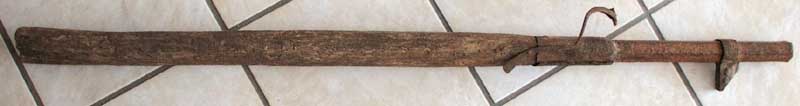

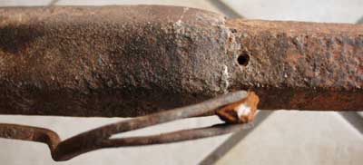

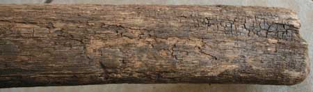

A few more details of this 600 year-old handgun.

Very interesting to see the spring-loaded serpentine,
This must be an extremely rare hand gun!
Lovely pictures, Michael.

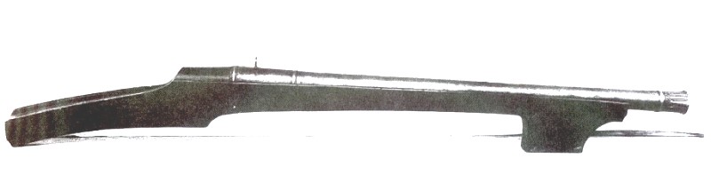

... which actually defines a haquebut (German: Hakenbüchse) was an invention of the first half of the 15th century ...
I wonder about paralel situations, like the picture i am posting here, of a large Malabar 'Esmerilhão' (Merlin); considered an early stage exemplar ( XV-XVI century transition), due to still being equiped with a wooden hook. Having been found that this type of hooks broke easily with the kick of the gun against bulwarks and battlements, they started making them in iron, still in the beginning of the XVI century.
Text and gun from the great collection of Rainer Daehnhardt, as illustrated in his work 'Homens Espadas e Tomates' (1997).
Fernando
Old 2nd October 2008, 06:34 PM   #5
Also amazing is that this Malabar example doesn't have a firing mechanism, having to be ignited manualy.
What can you tell us about this, Michael ?
Any correction to its dating ?
Fernando
Fernando
Hi Fernando,
Sorry to have to destroy a possible myth but Rainer Daehnhardt's gun is far from being European and/or early 16th century.
The barrel is clearly Indian, 18th/19th centuries, the stock is a crude modern reproduction missing only the tiniest touch of original German style...
Mind: hooks were never parts of the stocks but only of the iron barrels! Otherwise they would have made no sense at all.

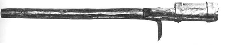

Default Berne handgonne, inv.# 2193, 1st half 15th century
Originally Posted by fernando
According to Bernhard Rietsche, the specimen in Pilsen is illustrated in ZHWK 1900-1912 p. 118); i wonder if you have such publication.
The Berne specimen seems to be quite popular, as largely divulged in the Internet. It is also, for example, in Clephan's work 'An outline of the History and Development of Hand Firearms' (page 47). I also happen to have a picture of it, myself.
But again, i may obviously be labouring in error, and confusing the whole thing.
Fernando
O.k.
Now this is Berne inv.# 2193. See Rudof Wegeli: Inventar der Waffensammlung des Bernischen Historischen Museums in Bern, vol.4, Feuerwaffen, 1948, p.153f.
As the text mentions, the hook is of iron and hammered through the stock as an addition in the gun's working time. As this must have proofed less stable, hooks were fire welded to the barrels from ca. 1440-50.
My library of more than 3,000 books and catalogs contains the complete original edition of the Zeitschrift fuer Historische Waffenkunde from its origins in 1897 until today. I have been a member of this society for more than 25 years.

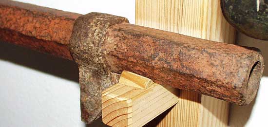

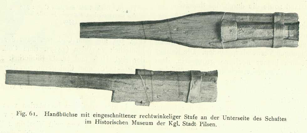

Now here is the Pilsen handgonne that you mean, Fernando.
I was in the Pilsen Armory in 2000, being kindly allowed by Dr. Hus to handle and photograph all the items I liked to.
The stock of this piece with the staged wall support may be original and may have worked against the recoil with this small and short barrel as the "hooked" stage is both very long and thick! It would never work with a long barrel and slender stock as in Daehnhardt's gun, though.
I enclose another early 15th century Pilsen handgonne with an iron hook drawn over the barrel (!) and put through the stock - the last stage before welding the hook directly to the barrel for optimum stability.
I have tried to do my best and sure hope to have made things as clear as possible. I spent 30 years of my life studying to be able and tell wrong from right.

As you can see in the first Pilsen gun, what actually works as the real wall support is a small rudimentary rectangular iron piece extending down through the stock, and being a vertical prolongation of the rear underside of the barrel! It may have been shortened later.
So there is a wooden stage, true, but this was not the wall support because it would have been too weak!
Allright?

Fernando, have you seen the pictures of the Pilsen gun mentioned by Bernhard Rietsche that I posted? It was the short rectangular iron lug protruding from the underside that would soften the recoil, not the lug of wood; the last was only for support to rest the gun comfortably.
It looks as if the short iron lug was originally a hook and broken off or shortened later.
In any case it had the function of a wall hook.
I am afraid that Herr Riestche had overlooked that detail.
With my respect and best wishes,
Duly noted Michael,
I must say that the part of this topic that has mainly raised my curiosity was whether indeed the first generation of harquebus recoil hooks was made of wood ... even soon to be assumed they were doomed to failure.
Fernando
