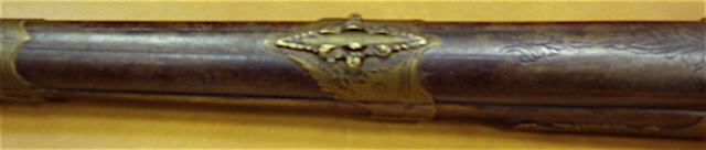

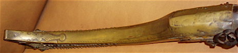

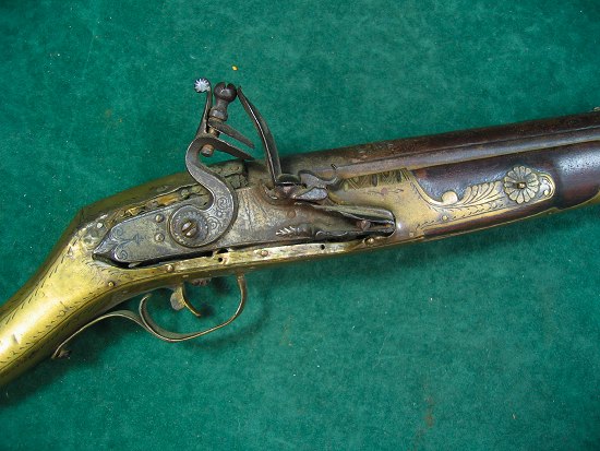

Hi Guys,
This item is available locally. It is advertised as an 19thC Afghan Jezail rifle. I would like to know your thoughts, as far as you are able from the photos, as to the validity of the claim and possibly whether it looks of reasonable quality or not. I DO NOT wish anybody to reply with regard to a monetary value. I know I'm asking a lot as you are not able to handle the piece but any help would be appreciated.
Norman.

Its a greek/ albanian rifle. It looks as medium quality and also looks that it has been shortened and modified from the middle of it untill the end of the barell

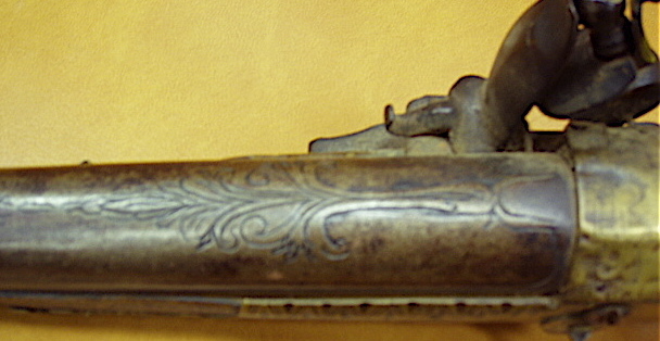

Albanian looks right that lock does not look original but could have been replaced in period. would need better pics of brass and wood on forearm to tell if it had been monkeyed with. Look at the barrell especially markings. Generally rifles are not faked from scratch to much work. But additions and embelshments are done to add value. the quality does not look bad, but I would look very carefuly at the fit of some of the pieces and the consistency of the work overall. These pieces were still being made and used thruout 19th century

A rare form of Ottoman rifle produced in manufactures in Albania. It is called RASAK. The lock has been replaced, but that happened very often on thoose. It seems that there are also some brass decoration missing along the barrel. They rarely left bare wood, uncovered by decorated brass.
Let me know if you want a divorce from that piece.
this is why I am saying look at the overall workmanship because it is odd that much wood is showing brass and wood on forearm may be replaced. Untill you look at patina of wood and workmanship of those brass pieces will not know

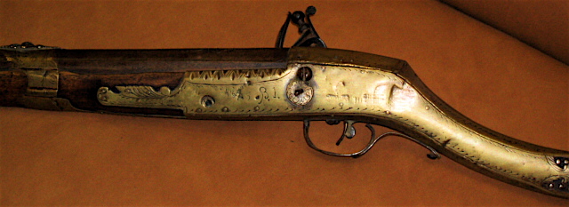

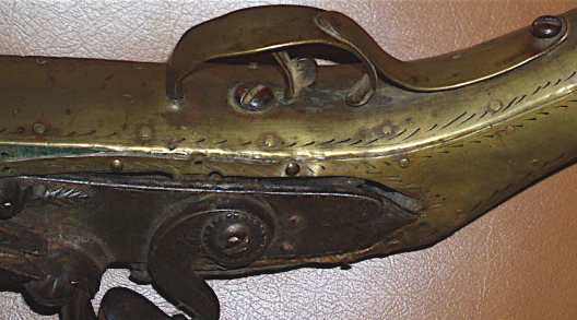

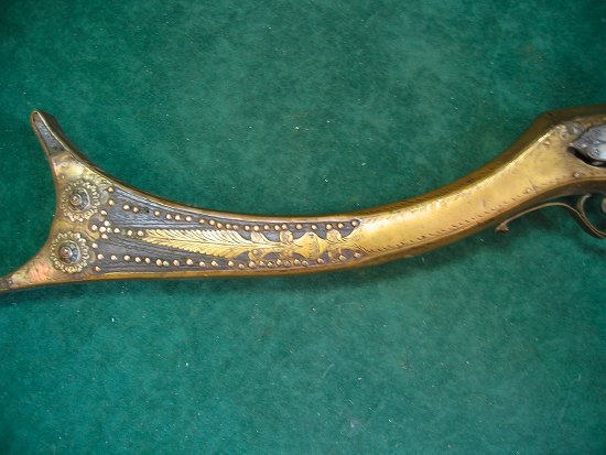

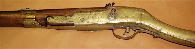

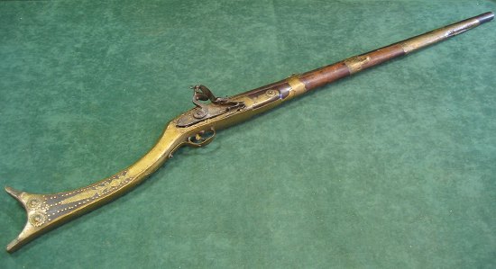

Hi Guys,

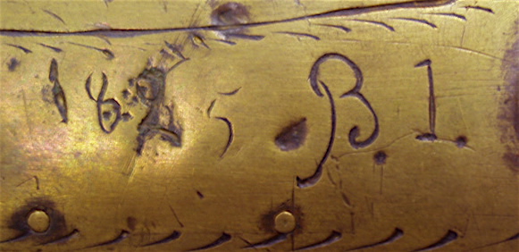

Here are some more photos. The lock does not work although it would appear that the rifle may have been dropped at some time and the lock knocked out of its seating. The brass sheet is missing in some places as pointed out. There is a date marked on the brass whether this is original or not? There is no makers mark or proof marks on either the barrel or the lock. The barrel does not look like it has been shortened as the decoration comes to an end naturally about 2 inches short of the muzzle, seems meant.
Norman.
Old 12th September 2008, 06:18 PM   #15
ward
Join Date: Feb 2006
Posts: 637
yes I would say lock has been replaced especially with the new screw added thru the other side. date seems about right. The piece is ok not what I call museum quality but ok
