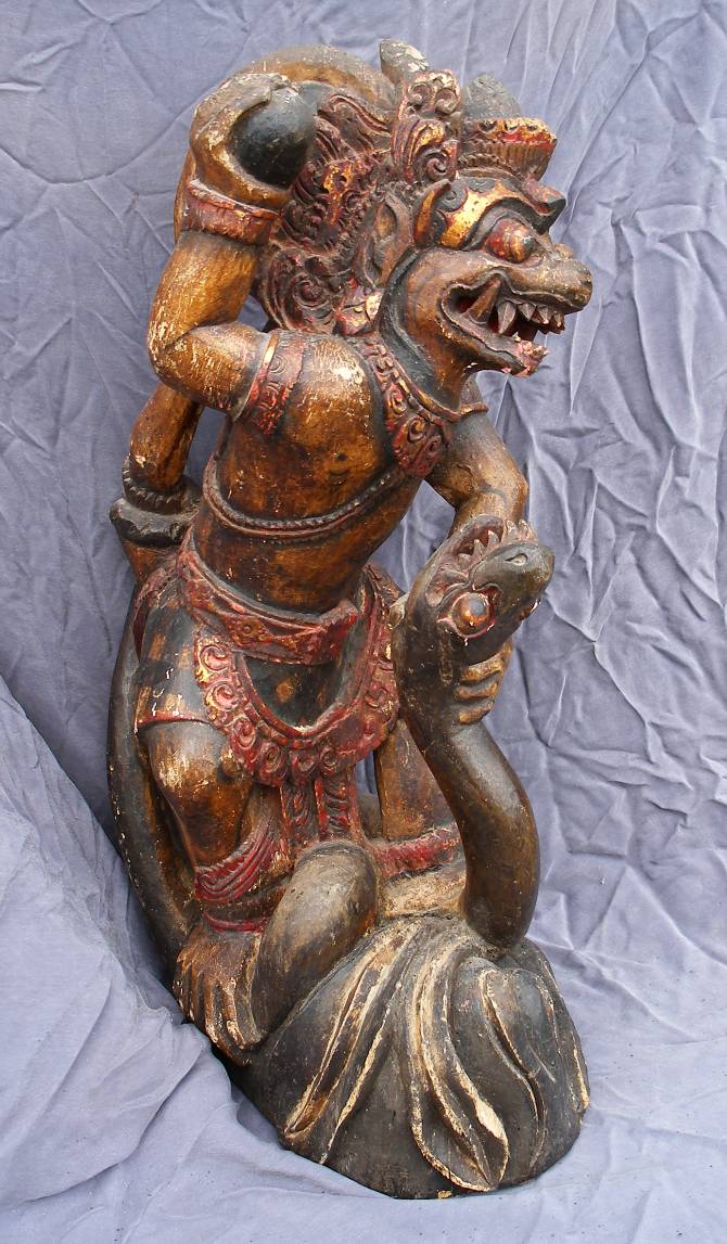

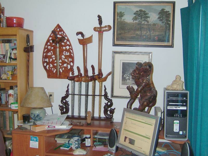

Here is a picture of two Javanese keris holders and a glimpse of a balinese carving of Hanuman wrestling a Naga .

Overseas except for Hanuman who came from an eBay Seller in the U.S. .

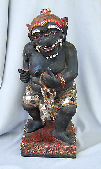

Posts: 7,230

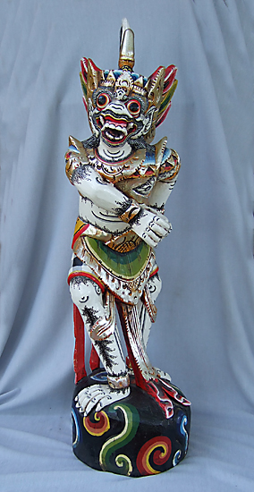

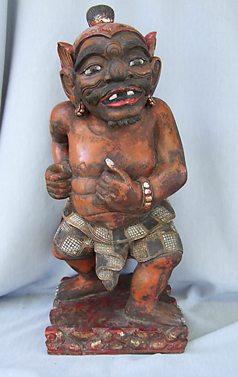

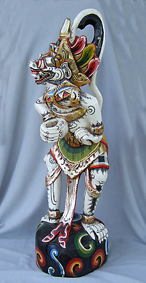

Hanuman

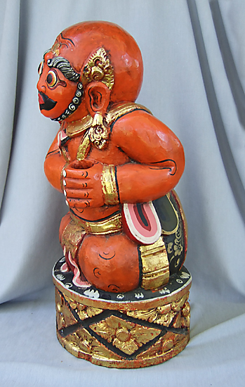

Old 22nd May 2008, 02:41 AM   #7
Posts: 7,230

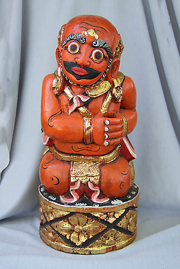

A bhuta

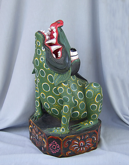

Old 22nd May 2008, 02:42 AM   #8
Posts: 7,230

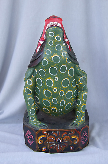

The Demon Frog.
Representing?
Your guess is as good as mine.

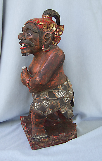

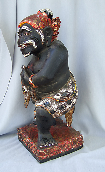

Old 22nd May 2008, 02:54 AM   #9
Posts: 7,230
Twalen and Mwerdah.

In response to "The Demon Frog", I have discovered in many cases the frog is a substitute for the tuber of the lotus flower. Then when a kris is placed in the stand, the shaft is to represent the lotus stalk. From there I have read that the meaning is purely symbolic with references to the male and female principles, magically united and thus forming the origin of all creation.

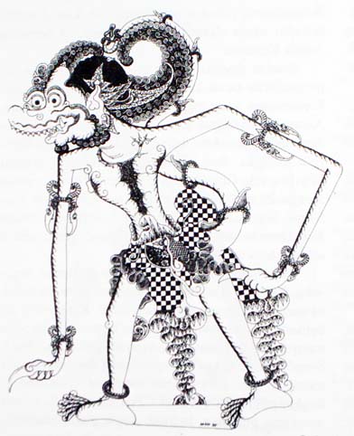

I am not sure whether this keris holder was dating further back than 1920 or not. This figure is probably Anggada -- ape-human in Ramayana story, the only son of Resi Subali and Dewi Tara -- and not the figure of Anoman...
About Anggada. When Anggada was still infant, his father Resi Subali was dead by the arrow of Ramawijaya -- during Subali and his brother Sugriwa were quarelling to get Dewi Tara (mother of Anggada). Anggada then grew up with Sugriwa, who later married to Dewi Tara.
This (ape-human) quarrels between two brothers (Subali vs Sugriwa) in Ramayana story, were also a "power struggle" to seize the reign in Guakiskenda -- Kingdom of the apes...

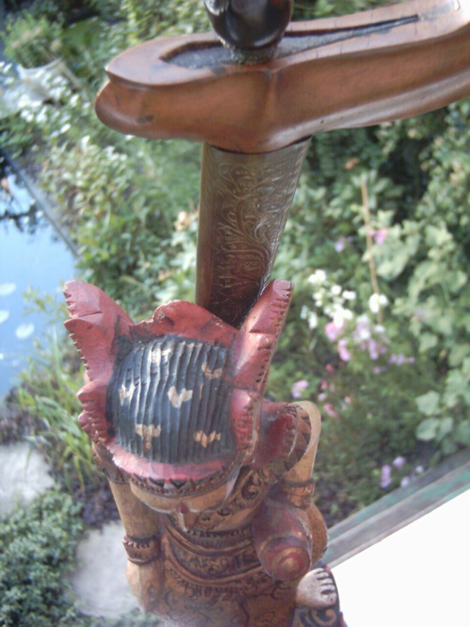

Willem, over the years I have had many Bali keris holders, and most of these had quite small holes to accept the keris. I used to have the same opinion that you hold, that is, that these holders were made for foreign consumption. However during the last perhaps 5 years I have obtained six Bali keris holders that were definitely old and that were obtained in circumstances that were not conducive to the theory of manufacture for foreign consumption.
These holders also had small holes, in fact the oldest holder, age judged on known history and physical appearance, had a hole that would not have accepted any keris.
I strongly suspect that most Bali keris holders have always been made with a small hole, the final size being left to the buyer to carve out, according to his own requirements.
If this is so, it would be in line with many Balinese objects made for local consumption, where the final finishing is left to the buyer, and not done by the specialist craftsman.
Dear Cecas,
Why not Anoman? Based on Ramayana story (wayang performance is still living in villages in Central and East Jawa Indonesia until nowadays), Anoman is an ape-human which has all white fur. While Anggada, reddish fur. And the characteristic differrence you may look at the "nail". Anoman -- like Bima too -- has a very specific "weapon-nail" named "kuku pancanaka". Only Anoman and Bima (in Jawa also called as Werkudara, or Bimasena) which have such "kuku pancanaka" in Wayang. (Pls regard the graphic picture below, Anoman with long-pointed nail and the other is Anggada)
Anoman is the son of Bathara Guru (the highest god in wayang) and Dewi Anjani... Actually Dewi Anjani is a goddess. But transformed in ape-form, when Bathara Guru fell in love with her. After bearing Anoman, the ape-woman Anjani transformed again as a goddess...

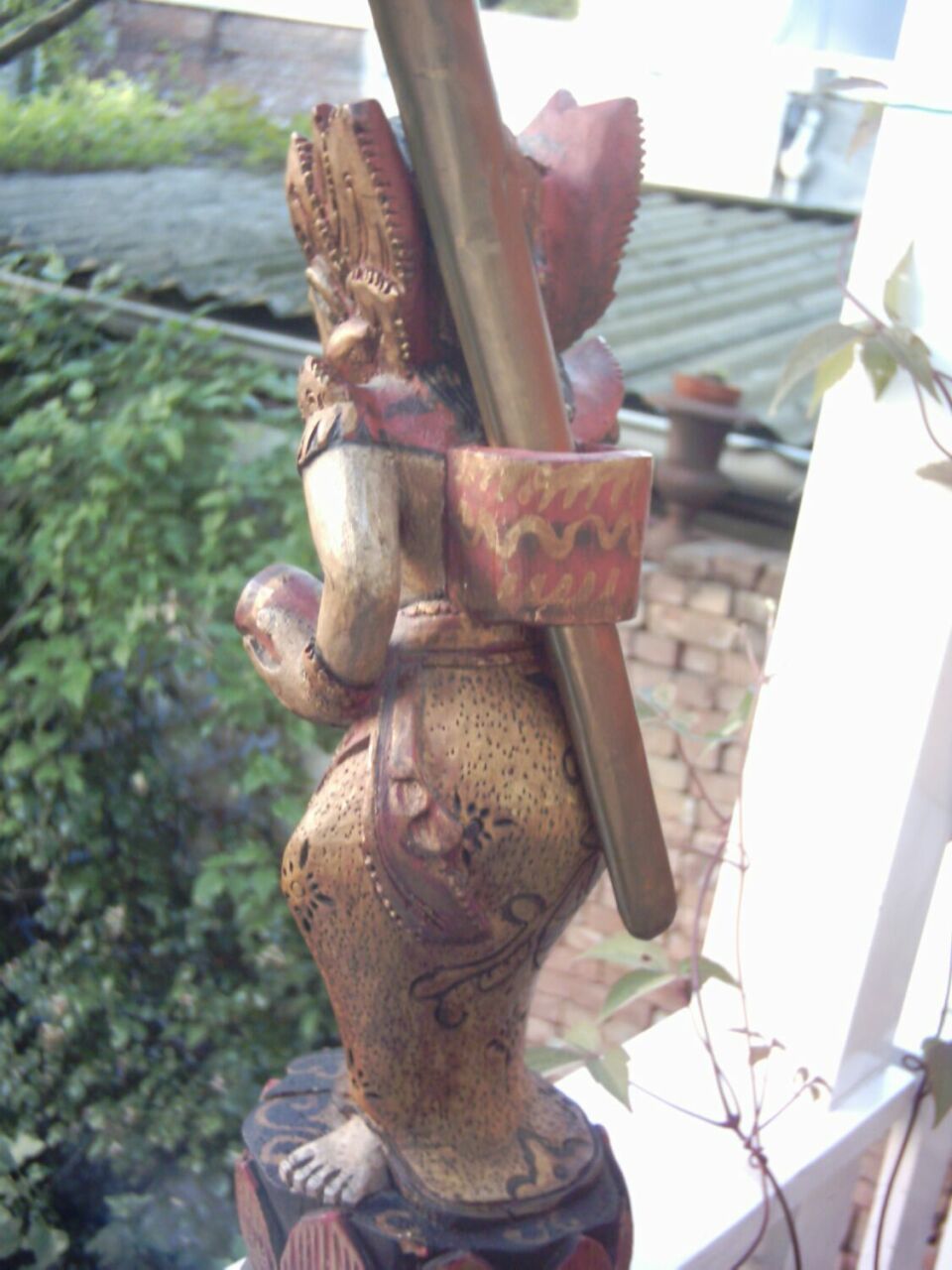

Old 26th June 2008, 12:47 PM   #23
asomotif
asomotif's Avatar
Join Date: Nov 2006
Posts: 2,238

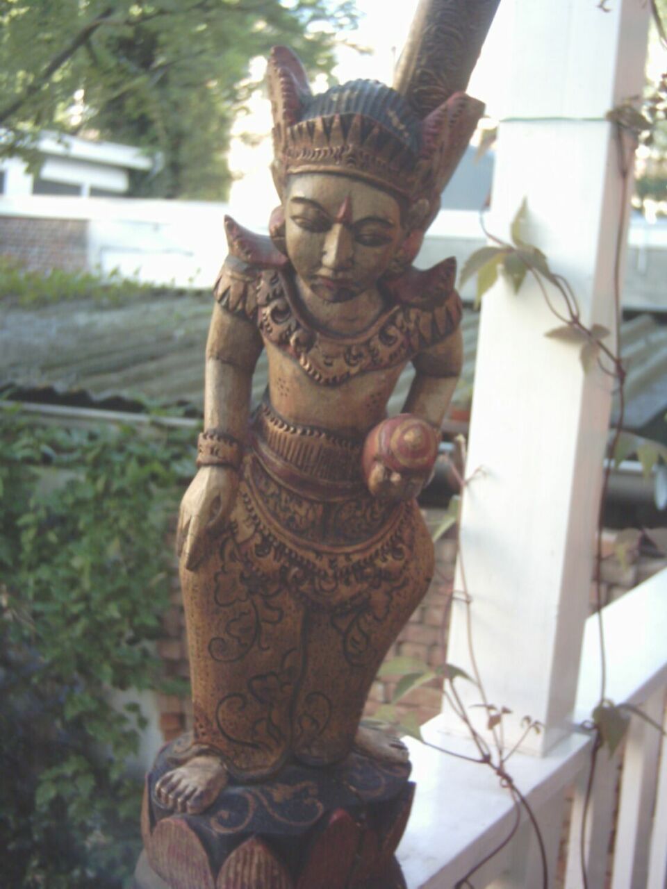

Default lady / danser / who is she ?
I found this little lady.
approx 35 cms high but capable of carrying a big balinese if needed.
Any suggestions on who she is ?

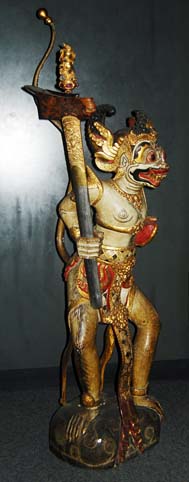

Posts: 7,297

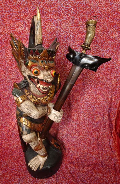

A well placed, if questionably spelled, bump Jussi.

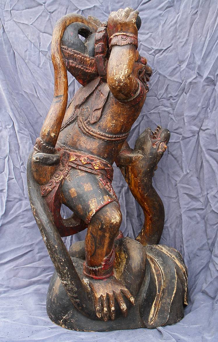

Here's my Hanuman which i never got around to posting when this thread was fresh.

Old 15th July 2009, 05:44 PM   #30
Posts: 7,297
Willem, i'm not convinced this is a lady at all. "She" is pretty flat-chested for a woman.
