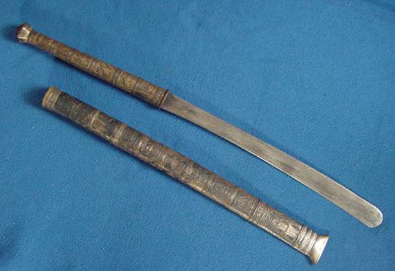

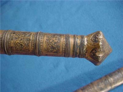

Have just won this one off Ebay. Any thoughts as to origins? Was listed as Thai Executioners Sword---don't think so!!..........but could be wrong. Pics are from listing.
Regards Stuart
Old 6th May 2008, 06:48 PM   #2
Mark
Mark's Avatar
Posts: 987
Odd pommel, but I would say Shan States (Burma) or northern Thailand. I've never seen one quite like it. I suppose that it could be an executioner's sword, though I do not think that any particular features make one such, just how it was actually used. In other words, while dha/daab were certainly used by executioners, as far as I know there is no such thing as an "executioner" style dha, as you have with keris for instance. They just used any ol' dha they had.

Hi Mark,
Thanks for your comments. I have another (which I think you have seen before on this Forum) which has a very similar pommel. This one is a dagger/knife. I seem to remember you identified this one as of Shan origin also.

Those two make a nice pair, Stuart. The pommel and decoration have a Lanna/Laotian flavor to them - smaller pommel, chased/repouseed metalwork, somewhat bolder patterns. Perhaps they are from further east than what I typically refer to as "Shan" territory. If so, they make a nice stylistic transition from the western Tai (Shan) styles to the more eastern Tai Yuan styles. Perhaps PUFF can offer more insight on this.

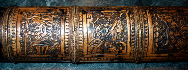

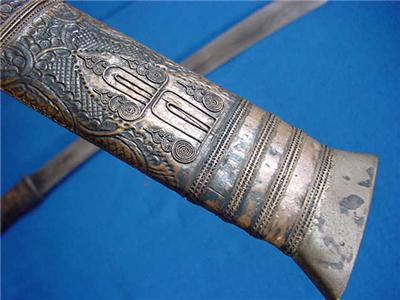

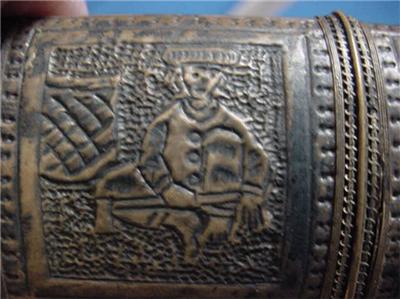

Hi Mark, Thanks for your comments. There were a couple of pics which I did not originally attach as they appeared "out of character" with the rest of the sword. The quality of this work appears to me to be of far less quality to the rest. Will have to wait until it arrives to see what the rest is like. Attached here now for comment.
Regards Stuart
Old 9th May 2008, 04:03 PM   #8
Mark
Mark's Avatar
Posts: 987
Interesting. The one of the right is, I think, a European in a tri-corner hat, frock coat & boots.
Are these panels on the scabbard or elsewere, then? Maybe a section was replaced.

Hi Mark, I assume they are on the scabbard, but as I have not received the Dha I don't know if the rest of the sections are like this. Certainly the part by the drag is typical SEA, but these to me look european and of below average quality for the rest of the item. Will know more when it gets here and I will post further pics then.

Further to previous discussion, the Dha has now arrived and I can provide a little more info.

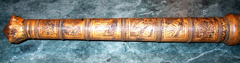

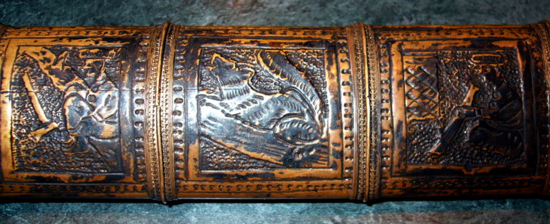

Firstly the balance of the blade appears no different from other Dha I have--the weight is approx central. The 17 7/8" blade is very sharp but is only 1/4" thick at the hilt. The handle is 11 3/4" long so probably designed for 2 handed use. Metal appears to be copper overall, but it has been silvered, and a small amount still remains at the scabbard drag. The decorative panels cover all the scabbard except for a plain 4 1/2" section which shows clear marks of having had a baldric at some stage. The handle also is totally covered with decorative panels.
The quality of this piece appears to me to be well above average, and definately shows some age. I would be interested to hear what others think.
Re the figures shown in the panels---I have taken the liberty to copy a couple of pics from Mark's Dha Research Archive (Hope that's OK Mark!). Are those "hats" familiar!!??
Regards Stuart

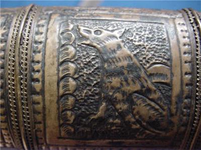

What a beauty. What animal do you suppose that is on the panels? It looks to be a squirrel. I am curious as to the significance.
Old 23rd May 2008, 09:09 AM   #12
Posts: 2,831
Smile ME TOO!
There is also what looks like a wolf (dog?) on one of the panels. I do know that there are squirrels in S.E.A as I have seen them wild in Singapore. As to significance I can't help. This is the only Dha I have seen with animals as decoration. Plenty with scrolls etc.
Help please Mark, and anyone else with knowledge of this type of decoration!!!

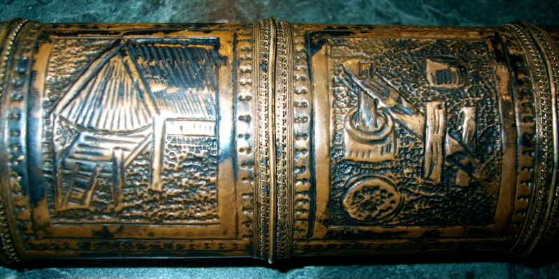

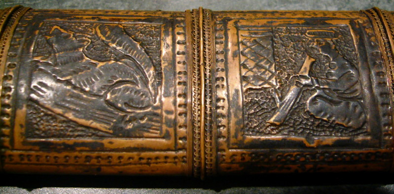

Thanks for the extra pictures Stuart. What I saw as a tricorner hat could well be a turban. It also makes more sense, and makes me wonder if this is a Kachin's dha. The Shan and Kachin live very inter-woven lives, even to the point of changing "race" depending on where they live. The style may be Shan, but the decoration Kachin, if that makes any sense.
The panels with people look to be illustrating aspects of every-day life. I see a house and a stamp mill in the second set of panels, and a porter and (maybe) a spear-fisher in the fourth set. Or maybe he is stirring something with a paddle? The presence of an axe in a couple of the panels strikes me as odd, though, because I would expect to see a dha mauk being used instead. I have no idea what the guy in the first set of panels is doing, holding what looks like a musical instrument or maybe a dha with the handle near his mouth. He seems to be blowing into or on it, or about to, but I don't see finger holds like on a flute. The basket on stilts behind him is sort of intriguing as well. I don't think he is blowing a bellows into a forge, because traditionally vertical pump bellows are used.
The squirrels and dogs look like squirrels and dogs to me, too.
He is smoking a bamboo pipe:
