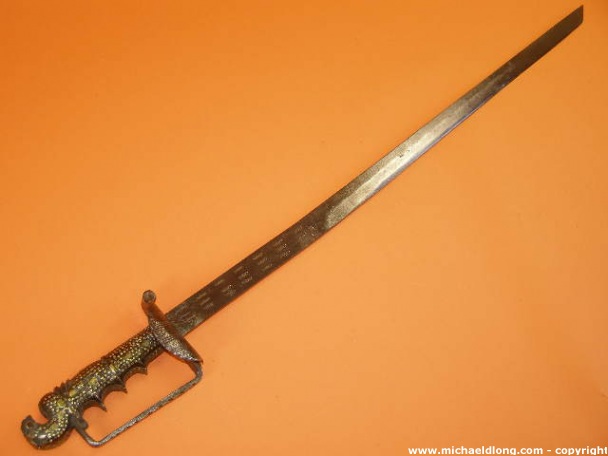

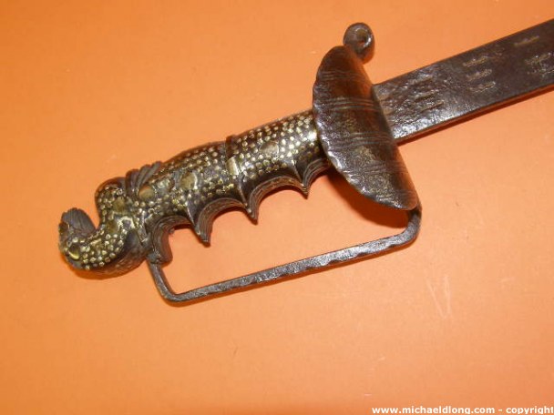

Old 28th April 2008, 09:59 PM   #2
Posts: 10,860

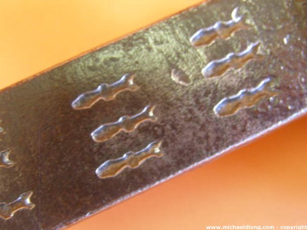

Hi Carlos,

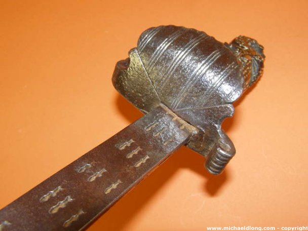

Thank you for posting this. These seem to be largely Spanish American War bringbacks, and about fifteen years ago, maybe longer, I found one exactly like this that was said provenanced from Monterrey, Mexico. Lots of research later, I was told by an authority on Spanish colonial weapons that these were from Cuba brought back by military during the Spanish American War.
According to authorities in Spain, these are typically considered from the Philippines, but given the Spanish trade routes this certainly seems possible as well. The blade on mine had the deep stamps in rows the full length of the blade, which was heavily patinated so seemed much earlier than the Spanish American War period.
The shellguard is interesting also with the multiple striated lines which correspond to shellguard espana anchas attributed now to Brazil c.1800 (see the pirate weapons thread, posted by Mark Eley).
I have no idea what those rows of deep marks might mean, but in the repitition seen appear to be simply motif.
Has anyone seen these show up in Philippine regions?
All best regards,

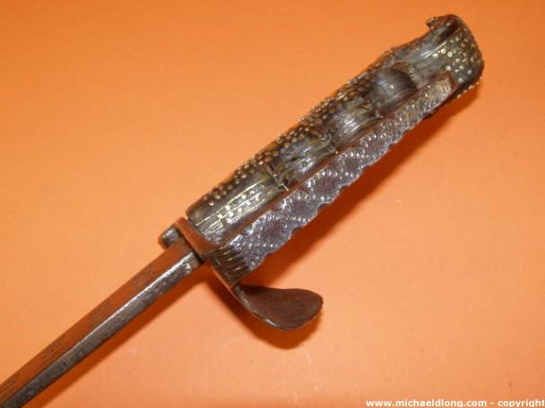

Old 29th April 2008, 02:10 AM   #4
Posts: 6,429
Yes, didn't we see this hilt form also referenced in a Berber Sabre thread ?
http://www.vikingsword.com/vb/showth...t=berber+sabre
Old 29th April 2008, 02:40 AM   #5
Posts: 10,860
Rick, how do you do it!!! Your memory and eye is amazing!!
That sure is it OK.

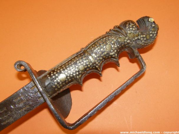

I cannot help but re-post my earlier ( somewhat embarrassing ) contribution:
http://www.vikingsword.com/vb/showthread.php?t=4874
I showed another sword with identical markings and a Nimcha marked " Nueva Granada" ( now Colombia).
I guess Spanish South American blades did end up in North Africa.

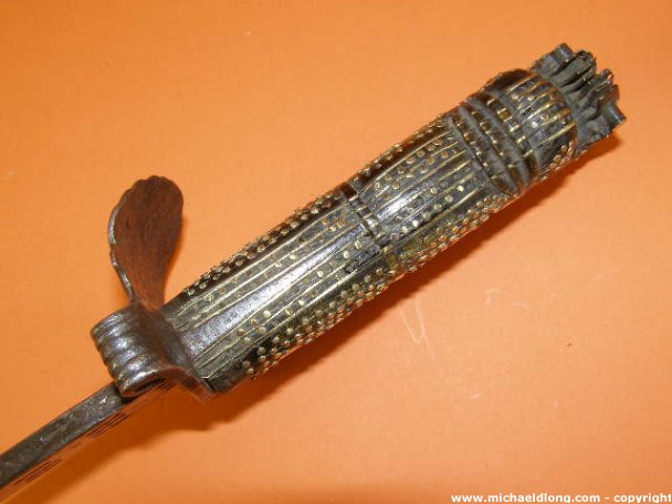

Default First Impression of a Novice

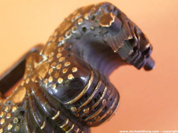

Hullo everybody,

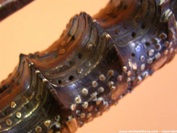

When I saw the hilt, my first impression was:
- European influence: 17thC Clamshell D guard
- Yemeni influence: Brass nails/studs
- Malay influence: Makara pommel(?)
Forgive my ignorance.
Best.

Amuk,
These were all outstanding deductions! and display reasoning as far from ignorance as can be!!! Every one of those observations has distinct merit.
As you can see, these unique weapons have been puzzling many if not most of us for years...I know that I can personally note the ten or more years that I have considered these swords identification inconclusive.
All best regards,

Gonzalo, that is a magnificent reference! Thank you for posting it as it clearly substantiates the Cuban attribution to these unusual fingerstalled weapons. I recall my first experience with one of these which I obtained about 13 years ago. It had provenance to Monterrey, Mexico and the blade was absolutely a blacksmith grade weapon with a heavy steel blade, unfullered, with these curvy motif stamps in repeated motif pattern most of its length.
With its provenance and heavy brass hilt with the same shape, fingerstalled and with crude shellguard and knucklebow added, much of the general thinking toward the piece was associated with the espada ancha of frontier regions in Mexico.
Some years later I was fortunate to have some good discussions with a former curator of an Arizona museum who indicated that one of these had once been among thier holdings, and the concensus was that it was from Cuba. In a catalog of a well known dealer whose name I will not note, there were two of these captioned as Algerian swords! Later, another of these turned up in an auction in London, listed as Mexican.
This reference seems excellent, and concurs with several other sources who claim these weapons, in some slight variations, were brought home by troops returning from the Spanish American war in both Cuba and the Philippines.

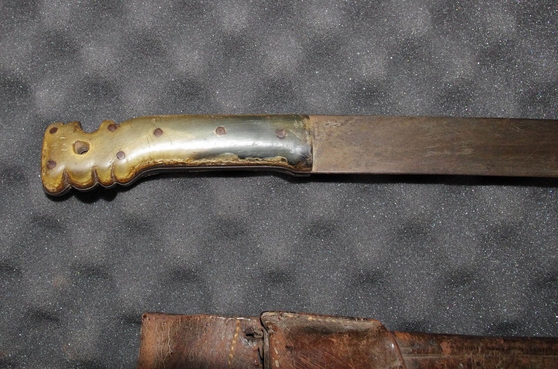

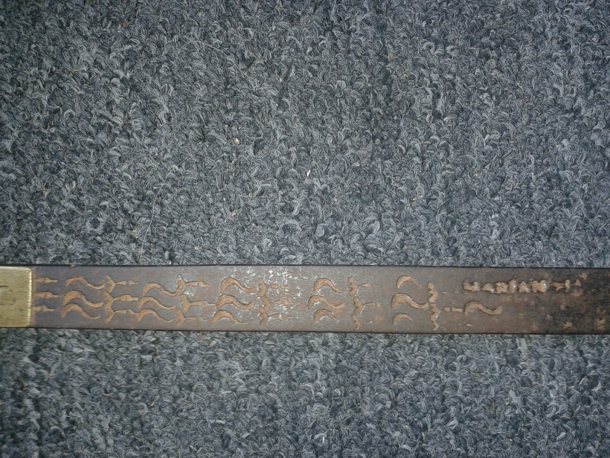

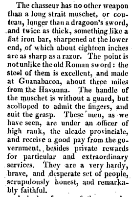

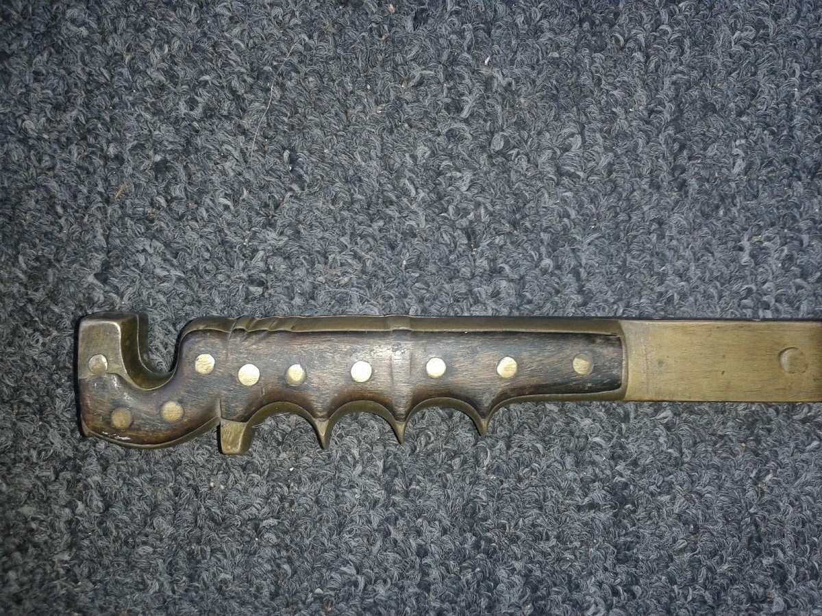

I have purchased one of these Guanabacoa swords and thought I would add the pics and a little info to this thread, There is a book accessible online called The Annual Register of World Events that was supposedly published in 1805 about events of importance or interest happening in1803https://books.google.com/books?id=9Z...0sword&f=false
The description of the swords seems spot-on and that gives us a verifiable date for these and an implication they must have been used earlier in the 1700s as well as a description of who carried them and a bit of info on their lives.
The blade is stamped MARIAN and I am curious about all the little stamps these swords seem to carry.

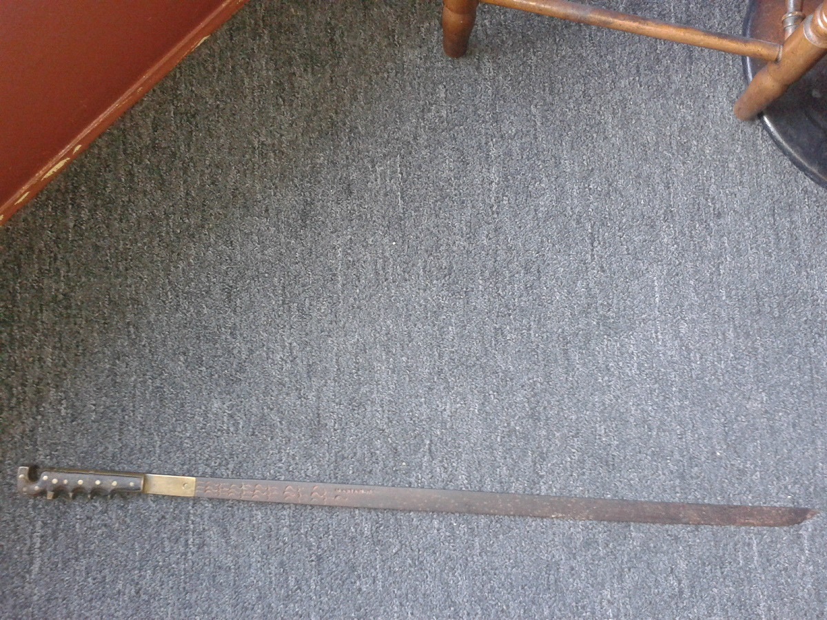

I think the attribution to the Philippines may be partially because it was such an unknown piece for many dealers and they had to come up with some provenance so why not the Philippines, and the attribution would carry on for years however some may have been carried far abroad as sailors and soldiers do travel.
I have seen several Chinese and south Asian spearheads offered as Spanish colonial And it is difficult to tell a sellers boosting of an object from an item that was brought here in olden days.
Here is another picture of a relatively more modern machete supposedly from Cuba patterned after the old style
machinist is offline   Reply With Quote
