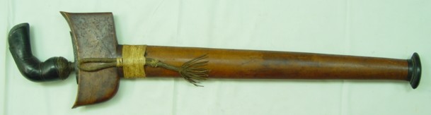

Smile A warrior's keris

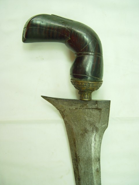

A true-blue Keris Sulawesi sepokal made for the purpose of combat, no doubt.

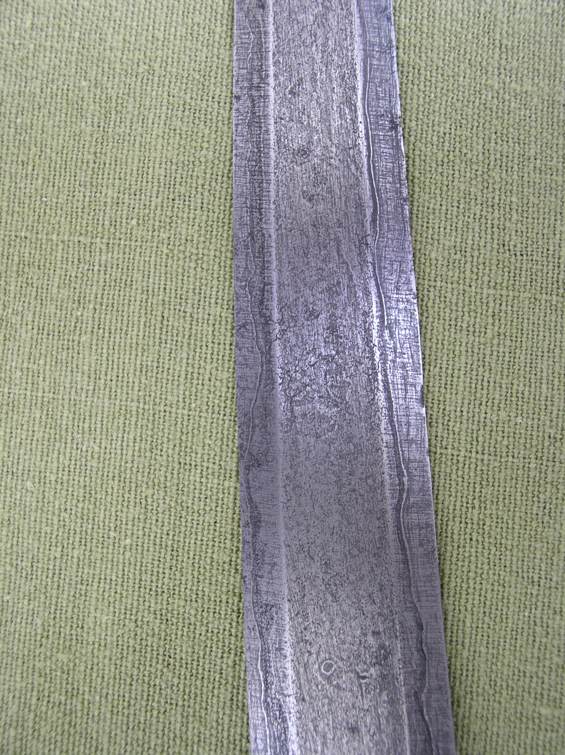

Massive 15inch blade forged from very good steel (maybe European?), with no apparent pamor except for the wengkon. Blade is very sharp, with not much perabots, but it cuts a nice enough profile. This keris cut me when I forgot myself and touched its edges carelessly. It has quite a number of nicks on the edges, especially towards the upper half. If you look at the last picture, you can see the temper mark goes 4/5 of the way down towards the base. Given these characteristics, I hazard that this keris was a warrior's keris, and one who had his fair share of combat.

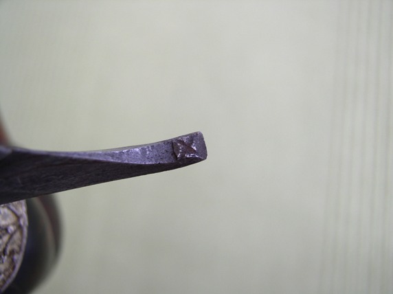

Notice that on the aring end of the ganja, there is an 'x' incised on top. I always associate such notches as being the 'anchor' for applying kinatah. Of course, I have no proof, and there are no gold residue left.

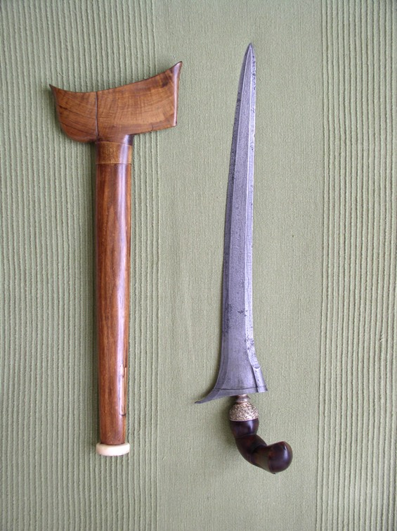

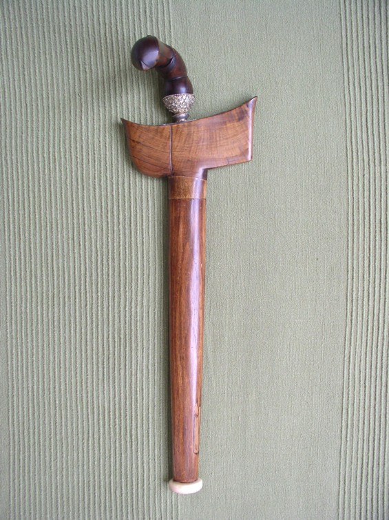

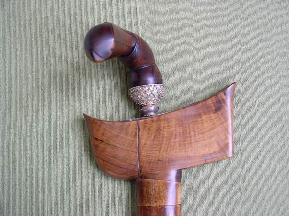

The profile of the sampir is typical 'awkward' Sulawesi style, but strangely, when it is put together with the equally 'awkward' batang, hulu and pendoko, it looks 'correct' and 'complements' each other. I'm not sure if you get what I mean -- there are times when you look at a keris and have the feeling that the parts do not fit properly together. Something is 'wrong'. Only when you replace the parts with those from the same region, then does the whole keris look 'correct'.
The sheath is made from yellowish-brown kemuning wood which I've grown to associate with Sulawesi. In fact, I'm pretty sure that by looking at the wood, one can tell which region it came from, even if its the same species, like in this case.

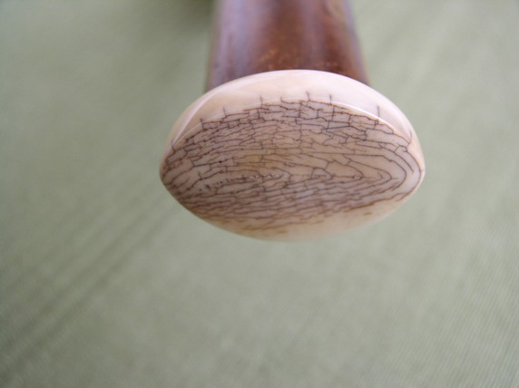

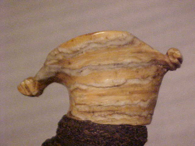

The buntut is a very 'crude' ivory plug, but with very nice webbed cracks at the bottom only.
The sheath is damaged in 3 places, but was repaired expertly a long time ago. I think most of you can only see 1, at most 2, of the spots where the repairs were made.
The interesting thing about this sheath is that it is very compact, and when the keris is sheathed in it, it makes one think that it must be an average sized blade in there. Only when the blade is unsheathed does one realize the monstrosity of the blade. 15inches may not sound very much for a keris, but when it is a Bugis sepokal blade, it is massive. There is no excess length or width in the sheath, evey last 1/8in is used to house the blade. So I give very high marks to the mranggi who created this 'optical illusion'.

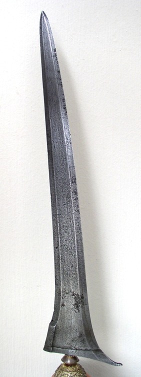

last 2 pics

No doubt a very function blade, yet elegant in it's simplicity. I would, of course, love to see it properly stained so that the wengkon line stands out against the blade. I think that would make it appear even more elegant and is, after all, the way the blade was meant to look. I think you may be right about the incised "X" on the aring end. It seems a very plausible explanation.
Beautiful keris! Thanks for showing. Any idea on the age?

The ivory is fossil pachiderm ...

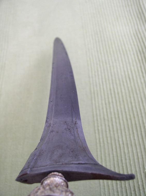

Hi Blu,
A very fine keris indeed. I really admire it. I think if the blade is stained properly, it will reveal the wengkon plus perhaps some pulo tirto. (just guessing) I have a keris that seems to be made with almost similar material. It was already stained when i got it from Adni. Due to some reasons, i cleaned the staining and the pamor that were used to be very revealing turned out to have almost no distinguishment with the steel. Attached are some photos prior to my cleaning.
Another thing, if u are ready to do some "experiment with the sheath" (which Raja Muda always tells me not to) i think the grain of the wood can be enhanced with a little application of wood dye. However, it the current finishing are original to the sheath, it is not advisable to do it. (which i know that u wont)
I'll send the pictures of the blade after cleaning on Monday.

Hi Radu,
The ivory seems to be normal old ivory, not fossilized. I've a couple of ivory handles with that kind of 'webbed' fine cracks. The ivory is still milky white and the grain 'moist' (if I may call it that) and visible. Not the dry stone-like grain of fossilized ivory.
Hi Rasdan,
Adni had tried to etch the keris twice. It turned jet black except for the wengkon. So we gathered that there's no visibile pamor except for the wengkon.

Hi Blu. Just curious, if Adni stained this blade for you, why did you remove it. Jet black with just the wengkon line sounds like a really cool look to me. And it would be, after all, the proper traditional look for the blade, wouldn't it?

Actually, I got it from Adni like this. When etched, the wengkon was somewhat less visible than when it was unetched, so the warangan was removed for the 3rd time and left like that. Its fine by me -- the grey steely look.

Hi Blu,
I think u r right. Initially i thought theres some pulo tirto on the blade. I think blades of this type are more difficult to etch due to the nature of the pamor. Sometimes to me its kinda sweet to leave the blade unetched. It facilitates the examination of the steel fibre and i enjoy that. However there are times that i got bored by the look of the blade and starting to etch it what so ever.
Heres some pictures as promised.

It seems interesting that the wengkon would be LESS visible after a staining. I wonder if it is not possible that what has been thought to be pamor wengkon is not really the weld joint between the blade's outer skin and the steel core. This has been suggested to me by a learned associate and it seems a strong possiblility.

i was wondering if it is truly ivory. it doesnt look to old to me and why does it have the "graining" when it is not to old. its also only at the bottom as far as i can see. perhaps something else?

Hi Ronpakis -- The buntut is definitely ivory. There's the unmistakable grain which I cannot capture on camera. But you do raise a very interesting point on the webbing appearing only at the bottom. I have no idea why it is like that.

Just an observation -- the ivory has parallel grain, which would suggest marine ivory. Maybe the 'webbing' is the 'marble-like' patterning of the interior of a walrus tusk.

well blu erf who knows, interesting to think what kind of ivory it could be. im always very sceptic when i hear the word ivory because it can be so many different types of material. once i have had an absolutely very nice maduran ukiran made from ivory. but when i tried to drill the hole deeper to fit my maduran keris it smelled like plastic. i have seen so many real and fakes but this one was a very nice but fake sucker a well it forces you to stay focused on whatever you buy

I believe Radu is of the opinion that it is fossilized mammoth tooth ivory rather than tusk ivory. The web pattern would thus be the layers of dentin & enamel, and you can see a little "flaw" nearer the left edge that would be the beginning of the nerve channel.
Old 16th December 2004, 09:59 PM   #24
Posts: 7,416
I would call this elephant ivory. Marine ivory is yellower and darker in nature. Fossil ivory has more bands of different colors due to different absorbtion rates of minerals in the different sections of the dentine and enamel. Here is a picture of what I mean. This is the fossil ivory pommel of a datu battle barong I have:

Here is a turkish jambiya I have that has a marine (walrus) ivory hilt. Notice the yellowish hue and yet the solid middle and fragmented sides (and back) that make up the inside of the tooth: (pic sent to Lee for resizing)

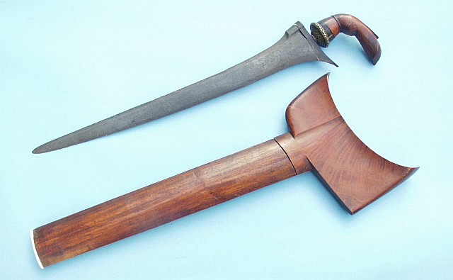

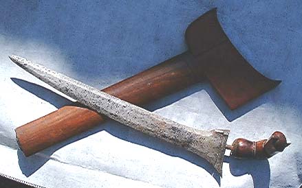

If such keris are common in Kelantan and Terengganu you could have fooled me. Fact is its even pretty unusual by Sulawesi standards - which is what makes the piece so special in the first place. Had I seen the blade bare I would have guessed Northeastern Sumatra. Here's a piece thats similar but dressed in the NE Sumatran style.

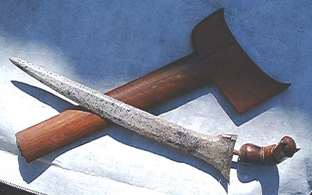

Photo stolen from Artzi.
And another from S. Sumatra with a similar blade form but somewhat different, lower quality besi.
That said, the dress on BluErf's keris is unmistakably Sulawesi.
And incidentally - the steel on this piece's blade is quite similar.
Straight keris blades are ubiquitous across the Malay world and are sometimes pretty hard to place. Complicating matters is the fact that many of the cheap Javanese trade blades sold across the archipelago for hundreds of years were straight blades. That said though this blade is clearly no trade blade. the hexagonal cross section is typically Bugis - whether Sulawesi or Straits - as is the besi. To top it all off - the quality of workmanship of Blu's example is certainly one of the best, if not the best of this sort that I've ever seen. None of the examples shown above even comes close. A very fine, certainly high status blade. To denigrate such a piece as "common" and "cheap" (I'm assuming that's what "not much priced" means) is flat ignorant!
And for the record, I've spent a hell of a lot of time trying to figure out the identifying characteristics of the keris of the Northeastern Peninsula but if there is anyone on this forum who can prove to me that such keris were common I'll be damned impressed
