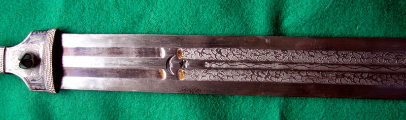

Old 11th December 2004, 05:21 PM   #6
Lee
Lee's Avatar
Posts: 1,005

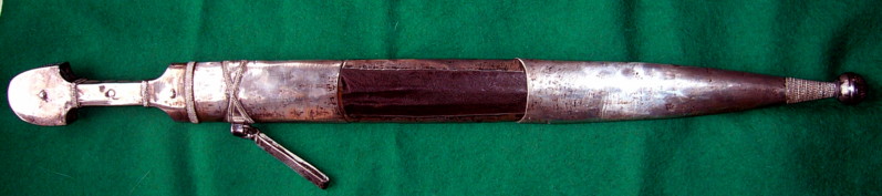

Question Pattern-Welded Qama or Kindjal?
Does anyone know where would this be from?
Old 11th December 2004, 05:45 PM   #7
Rivkin
Posts: 655
Damn it. Here we are posing as experience collectors, and Mr.Jones comes with his dagger that is surely a better one.
It's from Dagestan, made most likely by Lak master, can be that master worked outside of Dagestan, but it's unlikely. The date I would guess 1860 and may be a little bit up.
P.S. Sorry for the direct question, but where did you get it ? It seems to be a VERY good piece.

Old 12th December 2004, 05:28 PM   #14
Lee
Lee's Avatar
Posts: 1,005
Thumbs up Some follow-up details on my example pictured above
The blade on the one I posted above is just over 36 cm / 14 inches in length and just under 4.5 cm / 1.75 inches wide at the base. The fullers are so deep in this 4.5 mm thick blade that in just a few foci, light will pass through a few pinprick sized holes in the blade where fuller meets fuller. The smith obviously had to remove a lot of metal and did so with great precision. The hilt, though plain, may well be made of rhino horn and is very well shaped and fitted. The iron rivets are nicely faceted and over a cm high. I have never had a scabbard, so unfortunately, this exceedingly sharp dagger is sheathed in newspaper bound with masking tape. I found it at an arms fair several decades ago; I was told that it was part of a collection of pattern-welded items that was being dispersed.
Old 12th December 2004, 05:54 PM   #15
Rivkin
Posts: 655
Sorry, it's most likely not a rhino horn - I've never seen those used by caucasians. What really puzzles me is that this piece is unsigned - Dagestanians usually do sign their pieces.

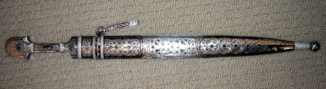

Default NEW ACQUISITION---WHAT DO YOU THINK?
Picked this up in a local auction last week.
Would appreciate comments. Overall length is 24 3/4". Blade 17 7/8".
