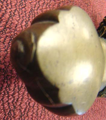

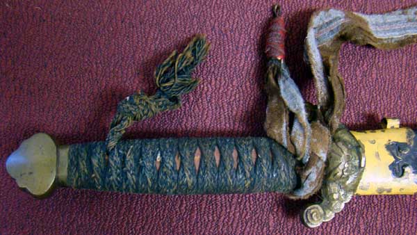

Hmmm, what did I just buy? I have been looking for years for a genuine Vintage or Antique Chinese Jian with little success, well success for one that appeals to my eyes, there have been plenty pass me by without that certain Mystic.
I found this piece at you know where and after having many extra images sent to me I was convinced of it's age and uniqueness.
There are very few good visual references that I can find on Chinese swords, from what I have seen and know, this sword appears to be from Around the late 1800's to about 1920, has military fittings on the scabbard and on the swords hilt too, but as far the cross guard is concerned, from the images, it varies greatly in detail from all that I have seen on military style swords and appears chiselled and non-military. There is what appears to be the remains of a tassel that was the same material as the hilt bindings and another cloth around the top of the hilt too(maybe to keep blood from the hand's grip?).
As I have not yet received this item and don't expect to for another week or two, I cannot comment on the blade. I have seen these blade before, some state that they are as old as Ming others have but them later, I do not know.
The entire sword patina is even and true, the brass seven star inlay is blackened with age. The sword in sheath is 40inches. The scabbard fittings have at some stage been painted yellow but the even honest patina can be seen in both the paint and the brass fittings exposed under the paint.
I do welcome comments and also answers to some of the questions that have arisen from my viewing of the sword.
My questions would be from what period is this sword actually from and is the blade possibly older as seen in many other swords?

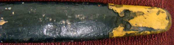

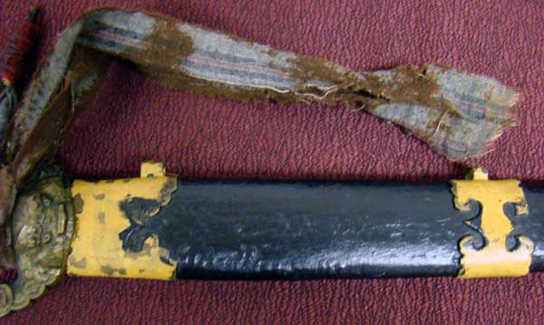

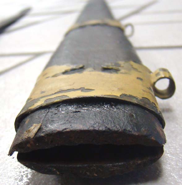

What is the significance of the yellow paint on the sheath fittings?

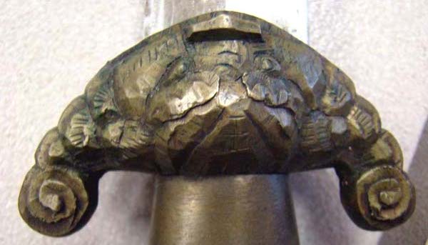

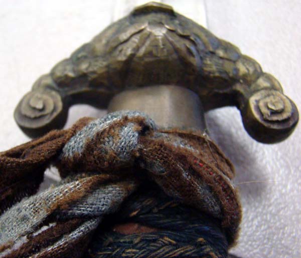

What is the significance of the unusual cross guard?
And please if anything does come to light from viewing this forum, please do share what you know and Bill or Josh, I welcome your views on this matter with great interest.
best regards
Gavin

I think you have a very nice find, but there are a few issues and questions that will have to wait until you have it in hand. The Yazi guard is typical in form, but usually associated with more decorated fittings. Considering the somewhat crude finish on it, it may be a later replacement. I can't tell if the blade is truly pattern welded. That is the big question. The lines I see, make me suspicious, but I just bought one with a very similar look to the pattern and it was genuine. The blade does not appear to have been used after being joined with the fittings. Points that sharp are rare on antiques, but may indicate a sword kept in exceptionally good condition, or that the blade was reshaped. If it was reshaped I would guess it was done at the same time as it was put together with the fittings.
The yellow paint on the fittings is typical of period restorations, or may even be original. I have a jian and a dao where the blades and steel fittings were painted silver. Some nice early 20th C. Chinese blades were nickle plated over good steel. I have the feeling that paint was used in the same spirit, to make something nice and shiny and "modern" looking.
I recently bought a blade where I thought the stars were darkened like the ones shown, and they turned out to be missing. Brass does not usually get that dark especially when the steel is bright.
The fittings in general look very good with the rounded puffy look of originals. They seem like they would match an "ace of spades" guard better.
My guess is that this jian has been restored at least once in the very late Qing or early Republican period. The guard may be newer than that. If the blade is pattern welded, my guess is you have something very nice, and assuming the price was risk adjusted, I think you did very well. There is a chance that a non-pattern welded blade was used in the period restoration. That would be unfortunate.
Josh

With regards to the crude guard, I have seen this image on a good many smaller straight swords and on those paired swords that sit back to back in a single sheath, are these that I refer too of the same period or are they fantasy swords for want of a better word?

The Yazi guard commonly seen on Chinese antiques has a multi-dynastic history, and may be related to the Makara. Both are water beasts with upturned noses. The style of the guard on your jian, is typical of Qing style guards, but looks like it may be a cast copy of an origenal. Generaly the fittings on your jian seem more likely to be matched with an ace of spades guard. Also, generaly the Yazi guard is an earlier type than the ace of spades, so seeing the Yazi guard makes me think it was a later replacement. Alternatively, the overall "village" look of your jian may expain the crude re-cast look of the guard. Mixed fittings are not uncommon on village things that are often refit with whatever is handy.
Josh

I've seen this specific Yazi guard quite often in late era, early 20th century jian. Most often they were on decorative chang jian that had the characters for Lung Chuan and a dragon carved into the forte, but I've seen them on "user" pieces as well. The rest of the fittings on those pieces are variations of the ones seen in this jian. Based on those examples, I think that everything is ensuite on this jian in terms of fittings and that the Yazi guard is contemporary to the rest of the fittings.

I certainly think the Yazi guard is original to the piece, only in that the patina displayed is consistant throughout the brass fittings, not through absolute knowledge of these swords history.

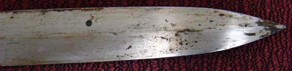

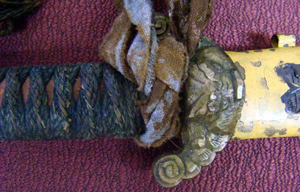

Well the good news is that the sword arrived today, they bad news is the macro function has gone kaput on my ole Sony F505V, time to explore new options.
From good examination of the sword I can state the following.

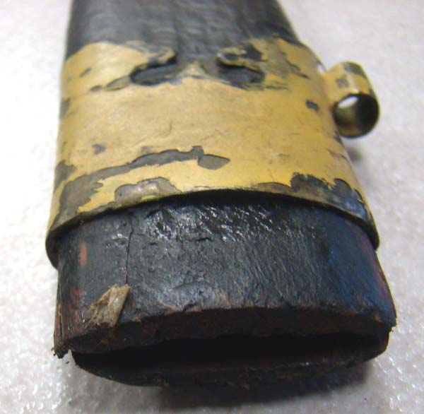

The scabbard is in considerably good condition, upon first glance it just looked like a black lacquer over wood but when looking closer it is black lacquer over ray or shark skin. Although the lacquer hides the grain in places, it looks to be completely intact bar the odd dint, scratch, cut in the hide or small fracture in the wood. It also sports a fine copper type wire at the ends of the scabbard under the fitting, I am guessing being wrapped to hold the skin in place and then lacquered over before having the fittings placed on.

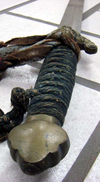

What at first I thought from the images was just a cloth below the guard is in fact what I would consider a tassel, there is a rawhide loop bound with red woollen type fibre that has had glue or a lacquer placed on it to stop it unravelling itself, from there it has three fabric strips bound under the red material. The tassel colour scheme is red blue red, a wider light blue strip then blue again. Images will explain it better when I get the photos up.
The hilt and guard are lovely and look better than the images posted, maybe a better light can reveal this. All fitting are very tight with no movement.

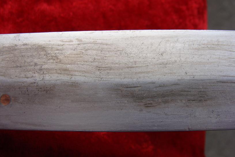

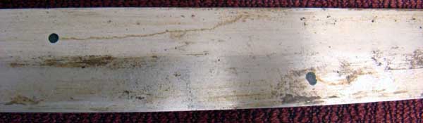

The blade.. I would like some advise before I tackle cleaning the blade. I have rubbed all the inlay and all is present. The blade has a good amount of flex and when pushed against the floor, my grip breaks before I push the blade any further. The first six inches of the 29 inch blade is thicker in the spine then the rest of the blade and when I rub my fingers the full length it too can be felt, to my eyes it also thickens slightly at the tip, remains unsharpened and would be a thrusting weapon rather than a slashing weapon but would leave a nasty gash I am sure if slashed. Between the 13th and 17th inch of the blade there are about 4-5 nicks in the edges.
All for now, time to shop for a new camera.

I am glad to hear that the stars were all there. I think you have a very nice piece. What can you tell about the pattern welding?
Josh

Hi Josh, at this stage I cannot tell you much, I cannot see any distinct patterns or a "harmon" (the edge is not live). I can however see something in the steel, but what exactly I have no idea as yet. I will be bidding on a new camera tonight and I hope to have it within the week to take images. In the mean time I will clean clean clean the blade for a better look.
I have done the file test as suggested and it does grip somewhat and does not skate across like a file does on my Tibetan Knives. I then took my Sabre off the wall that shows a distinct wave pattern and the file grips exactly the same as the Jian. I am guessing it is just a matter of the steel used in the period? I also noted that the cloth binding on the hilts is exactly the same on both Jian and Sabre as is the red material under the binding.

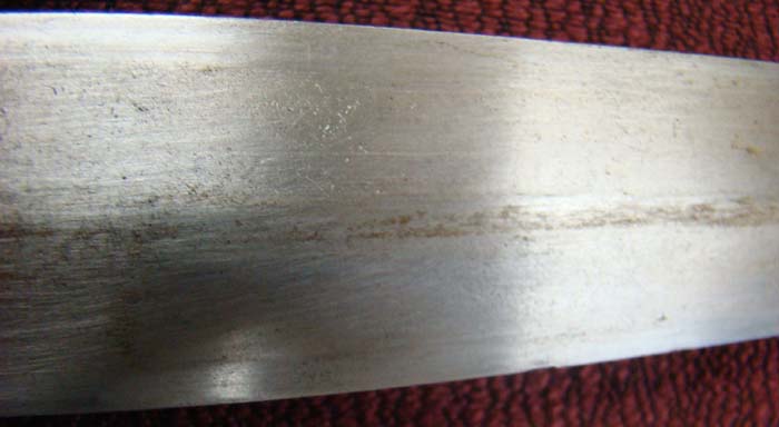

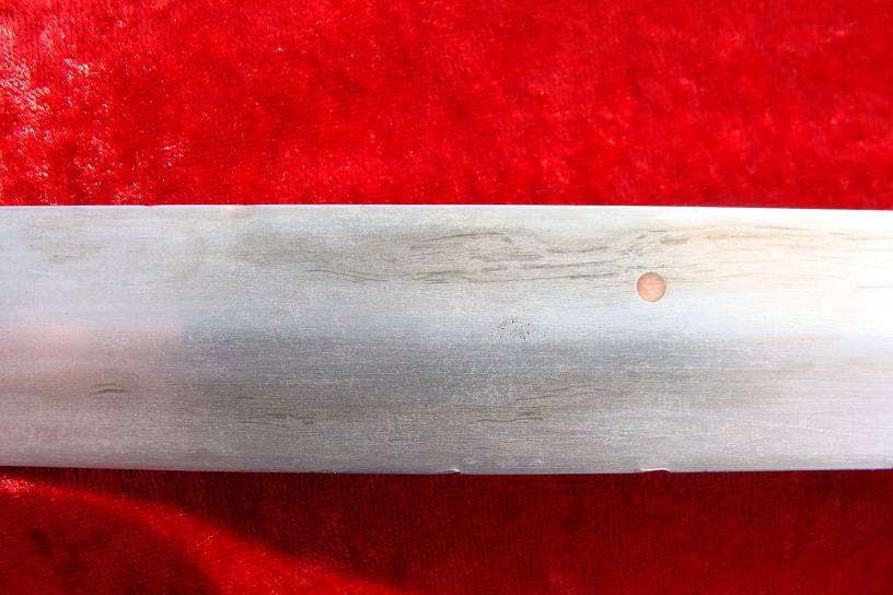

I finally cleaned all the grease and muck off the blade and thought to myself Blah, just a very boring bright shine blade and I could see no forging marks to the naked eye. I then looked at past forums on etching and cleaning and ran a few question by fellow collectors who provided good sound advise.
I followed instruction from Rick,(Thanks Rick) and proceeded to clean further and remove this shine to see if any pattern laid beneath.
I have only etched the blade once and quickly, the photos reveal what lay beneath the bright shine finish.
I do not wish to take this any further until I hear some more sound advise from readers and collectors.
From this discovery I have pondered a few questions.
Why is it that when I now apply polish, these lamenations disapear to the naked eye again?
Should I continue with etching, or polish, oil and preserve it as it is?
Should I return the blade to it's former high shine, grease it as it has been all these years and leave it?
What date would one assume this sword was produced?
I am guessing that this is one of those rare lucky finds as stated by others, being a long blade in full profile, inlay complete and well preserved since it's departure from it's original owner.

Very nice looking blade. We can stay with the Early Republican/late Qing dating, but as you know the blade could be older. As for etching, there are many opinions. Here is what I would do: Scrub the blade with soap and water, be very careful not to get any on the fittings. Remove any residual oils with Windex and perhaps finally acetone. Then when it is perfectly dry, put clear nail polish over the stars. They could fall out with etching otherwise. I etch mine with vinegar in a PVC tube as this gives an even result. I leave the tube next to the furnace so the temperature is about 35 C.. Then I leave it there for 18-24 hours. I take it out, neutralise it with baking soda, then scrub it again. This makes a clean shiny blade where once again the laminations are difficult to see. (they would be dark before the final scrubbing.) Now what you have done is create a bit of contour with the etching. I take 4000 grit paper and go over the blade. This highlights the lamination, and turns the high carbon steel bright and the low carbon dark. Without this if you just left the blade dark from etching, the high carbon is dark, and the low carbon bright. I prefer bright edges on a Chinese blade. I have not seen this particular approach described before, so I would be interested in others comments. I showed a blade I had treated this way to Scott Rodell, and he liked the way it looked very much.
Josh
