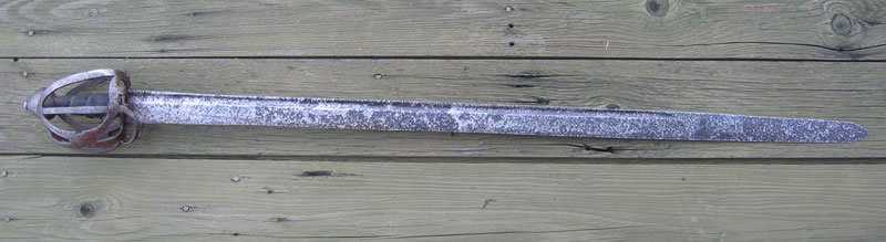

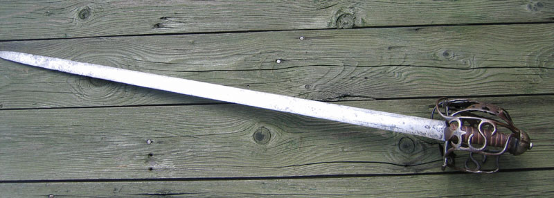

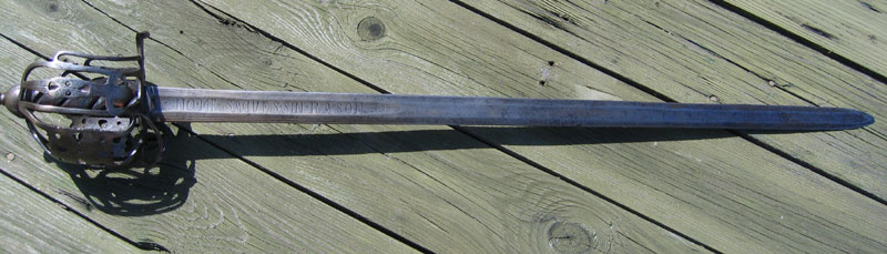

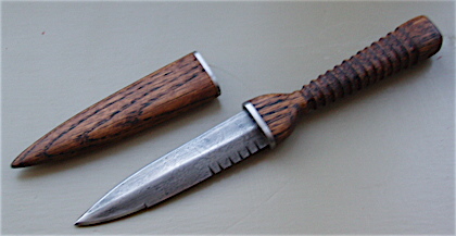

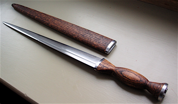

From my name you've probably realised that if not from Scotland I'm certainly of Scots/Irish descent. I actually live in the West End of Glasgow not far, luckily for me, from Kelvingrove Art Gallery and Museum the place which as a child first gave me an interest in Arms and Armour. You will all also know that genuine Scottish antique arms are on the somewhat pricey side and as as result, unfortunately, I've not been able to bag a sword, dirk etc., yet !!! A number of months ago my son asked me if I had a sgian dubh he could borrow, I didn't, I had lost the last one years ago and hadn't bothered to replace it. I decided to do something I had been thinking about and make one. Whether a son was being nice to a dad or not after I gave him the sgian he asked me to make him a dirk as well. True to my roots, some would say, for both pieces I rummaged about in the garage for bits and pieces, wood from an old Victorian wardrobe, various bits of metal including a shovel handle and an angle bracket and luckily a bit from the middle of a badly damaged sword blade. The results, see photos, are not the the most decorative of pieces being plain and to the point, no pun intended, but are strong, sharp and pointy in all the right places. I don't know if this is the right place for modern pieces but I think, and hope, they conform to the spirit of Ethnographic weaponry.
Norman.

Hello Norman,
Thank you very much for posting, and especially for showing us these very beautifully done examples with indeed do reflect, in the beautifully written words of Paul MacDonald, the 'heart' put into these weapons. As you have noted, the true early examples of Scottish weapons are indeed hard to find, and typically quite high priced. While the objective here is to identify the forms and identifying characteristics of these early forms, your outstanding work certainly reflects the spirit imbued in these most important weapons.
Thank you again for sharing these!

Norman, a lovely sgian dubh and dirk. Thank you for sharing.

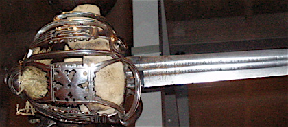

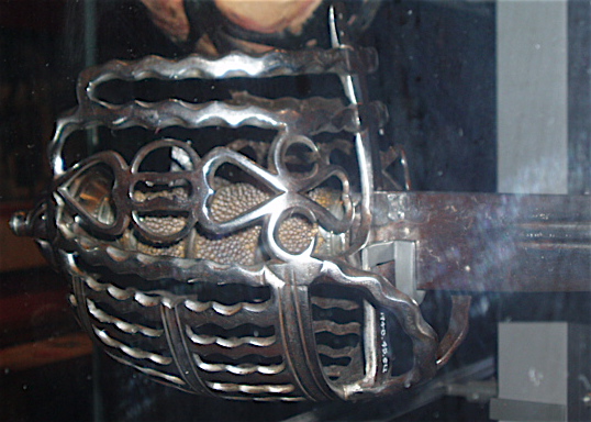

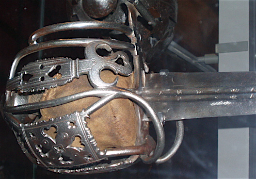

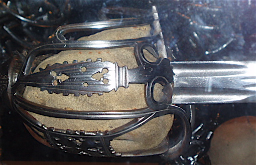

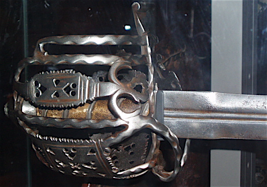

Some baskets.

WOW! Norman, now thats what I'm talkin' about! Very nice photos that show detail beautifully. Very well thought out observations on the origins and development of these swords, and it really would be difficult to draw a direct line of progression. All we can do is look at the provenanced and dated forms from the various regions. I have been trying to recall where it was that it was noted that the 'schiavona' connection was discounted and it was shown which early writer had begun that theory, I think it was the article in Caldwell by Blair on the baskethilts that referred to the misperception, and if not mistaken, it may have been Guy Laking that suggested the schiavona origin. According to what I have read, it seems that Drummond in "Ancient Scottish Weapons" (1881) illustrates several schiavona in his book, and possibly that may have insinuated a connection.
It seems that the developing basket type hilts for the schiavona, the Germanic forms including that of the Landsknechts, so called Sinclair sabres, and English forms were all contemporary in the mid to latter 16th c.

Norman, are any of these captioned or noted on identification? Are they from the museum you mentioned?
Thanks very much again, these really are amazing!

Hi Jim,
These are some from the collection at Kelvingrove, I will go back with my notebook and do things a little more properly. The Arms and Armour Curator has left recently and a new one appointed but he has not yet taken up his post. When he does I'll see if I can get better access and photos, I can't promise anything but I'll try. In the meantime give me a few days and I will get info to go with the baskets.
Norman.

Aye, a good thread that`s nice and close to home, folks
From the photos posted, the one second from top appears to be a Walter Allan hilt from Stirling. The top one appears to be a Glasgow hilt in the style of Walter Allan, but I`m not sure if it is made by himself.

Hi Pukka,
I`m happy to answer your questions.
Regarding the discovery of the sword, this came about after I received a commission to restore the original basket hilted backsword of Charles Stuart of Ardshiel, the Jacobite commander of the Stuarts of Appin at Sherrifmuir and Culloden.
This sword has been passed down in the same family for generations, and it`s continued provenance was that this was the sword used by Ardshiel to face and defeat Rob Roy MacGregor in single combat.
It was on the back of receiving this sword that I chased a local legend from my original Highland homeland of Moidart. I was years before told of the story that a local family possessed the (or an) original sword of Rob Roy MacGregor. The provenace is like most Highland traditions and oral in nature, handed down from generation to generation. That is, MacGregor in his last days gave the sword to one of the MacLarens, from whom MacGregor rented his croft.
It was then passed from that family to the MacRaes of Moidart a couple of generations ago.
I have found but one contemporary description of MacGregors sword, which was described as a `broad and stout blade`. That which I received from the MacRaes is certainly that. It is noticeably broad, and overall on the heftier end, but well balanced all the same.
The sword has been in the hands of a private family and was treasured by the father, who passed away around 10 years ago. Since that time, many of his possessions, including the sword, were put into a byre beside the crofthouse, and no doubt much of the corrosive damage has been caused during this time. As far as the mother was concerned, it was just an old sword.
Unfortunately, the elements corroded away the original leather scabbard and basket lining, and likely also some of the grip material, as well as causing surface rust over the entire blade and hilt.
I visited Abbotsford house to see the Rob Roy sword there and other weapons that were purchased by Sir Walter Scott in the C19th. To be sure, the blade on Scott`s MacGregor sword does not match the contemporary description, and his `Rob Roy sgian dubh` is clearly early - mid C19th.
Check out the following threads for further pics and info. regarding the swords of Ardshiel and MacGregor -
http://forums.swordforum.com/showthread.php?t=80549
http://forums.swordforum.com/showthread.php?t=82635
Regarding basket linings, there is plenty of evidence of original Jacobite baskets being either fully or partly (base of hilt only) lined in leather. This provides a rudimentary protection for the knuckles and thumb against the hilt. This is not so much because the hilts are restrictive. If the hilt does not allow full and free movement to hand and wrist, then it is best melted down to make something that is serviceable!
The basket hilted sword is primarily a cutting weapon, and cuts require sufficient blade movement to be effective. Full and free hand and wrist movement is essential for this and any good basket is of size and form enough to allow it.
Both grips were used on the Highland hilts, either with the fingers and thumb curled around the entire grip, or with the thumb running along the back of the grip, fingers slightly back to allow a fingers and thumb only grip. This may not sound as stong, but in the hands of a trained swordsman is just as strong and more accurate and responsive than a wrap-around grip.
Hilts allowing the thumb-back grip tend to be slightly longer in the hilt and grip and sometimes with a flat back to the grip.
The leather lining protection is more to protect the hand if any bars break or bend in towards the hand during use.
This was fairly common with Highland baskets, as the individual bars and plates have to be quite thin, otherwise, the whole hilt would simply weigh too much. This is easily evident with many mass produced basket hilts today, that may look the part but are far from serviceable, with too-thick baskets and muckle thick blades.
I have also handled and seen many original early - mid C18th military basket hilts with full leather lining, usually white on the inside and red on the outside. This is as much for show and matching the weapon with the redcoat uniform as it is for practical use.
The red lining became almost a standard feature of regimental basket hilt swords since that time, and is seen on most C19th Scottish military baskets, which are still made and used as the current pattern.
I hope that the above details are helpful for now
All the best,
Macdonald

Thanks Jim for starting this thread, and what a treat to have the expertise of Paul Macdonald here!
Here a a few examples of Baskethilts in my collection.
This is a Stirling hilt that I have posted here before.
Jeff D is offline   Reply With Quote

Jeff D
Jeff D's Avatar
Location: B.C. Canada
Posts: 473
This is a S-hilt. I would love to here what the most current theory on the significance of the S. (Stirling?, Stuart? simple protection?).

Jeff D
Jeff D's Avatar
Posts: 473
Here is a English basket. Also called "Irish hilt" or "Twysden style". Although classically these are English I believe they were also made above the border.
