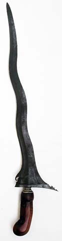

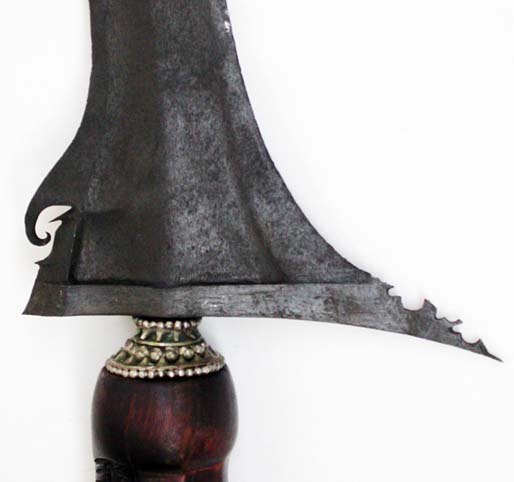

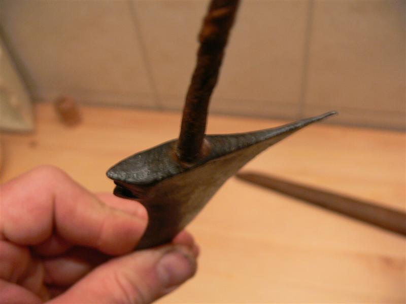

Hi,

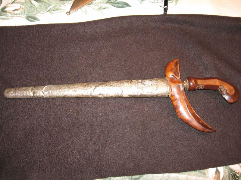

I just bought this one because I like the strange style.
totally gambling ,never seen it,but it look funny with that wavy ganja ( actually there's no ganja at all but don't know how to all it else ), very small wranka and ? mendak with stones.It looks pamorless.
pics are bad but will list better ones when it has arrived.
Arjan

Yap, its a "ganja hilang". Lost its ganja. Sheath's not original too and probably lost one of its dauns.
Old 9th December 2007, 08:54 AM   #3
Henk
Henk's Avatar
Posts: 1,209
Just like BluErf said. Gonjo is lost. Such a wavy gonjo is not uncommon, but I agree with you most gonjo's are straight.
Pamorless? I think the blade needs a cleaning and staining.

Agree too. The gonja's lost. It seems a good blade, probably with 5 luks of dhapur "pandawa lare" (five luks, with sekar kacang). It missed the "gonja wilut" (type of gonja with luks). If it is "pendawa lare", then it should have "greneng" in the end of the gonja...
I hope you won't throw the good blade away...

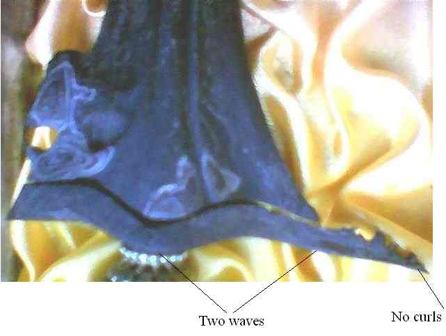

It looks's like ganja iras to me too... There seems to be a pejetan, (the depression on the blade where the blade is held between the thumb and the fore-finger), which suggest that there is a (sort of) demarkation of the blade and from the ganja iras...
... more like 'ganja siluman' (term... does not exist)... you can see the ganja from the gandik side after that it fade into the blade, looking at the ganja profile and the pesi as Alan suggest to make it more definite.
(1) The form of wadidang (the tail) is too short to be an iras type. Please compare to these pictures of five luks with sekar kacang, though not iras type, nor wilut type of ganja. And also the wilut type of 7 luks keris. Pls regard the proportion of the tail and also the gandhik. (2) The form of the wadidang's curve, seems like the end of a tail. (3) Five luks, iras tipe with no greneng? What should you call the dapur then? (4) The dubious one is the "blumbangan" or "pejetan". Is it original? One of the clue answer is here, I think...
Ganjawulung

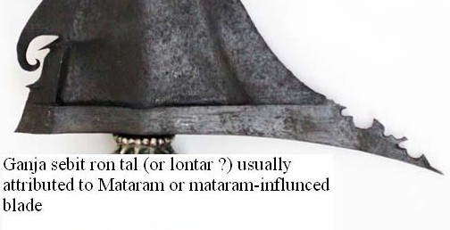

Dear Mas Boedhi,

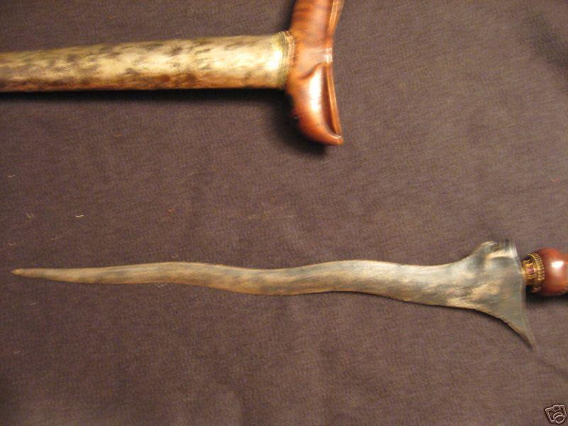

Ganja "kelap lintah", or "wilut"? Or both are the same? These pictures are from Mr Bambang Harsri...
Ganjawulung

In respect of proportion, we need to understand the various proportions that can be correct for a blade. I agree with you totally, using the blade patterns that you have provided for comparison, the wadidang is far too short in the blade under discussion, however, your examples are one type of blade, the one we are discussing is a different type of blade.
Yes Alan, they are not the right comparison. I just want to show the "sor'soran" part of a five luks keris with sekar kacang, and also the other example on keris with ganja "kelap lintah" (not wilut as I just said, I think). Of course, not ganja iras type as we are discussing... Keris with ganja "with luks" is not uncommon...

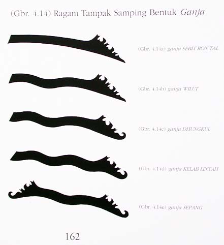

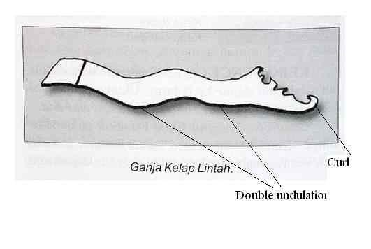

Dear Mas Boedhi,
The distinction is probably based on the undulation of ganja's side view. Mr Moebirman in his book "Keris Senjata Pusaka" (Keris, Heirloom Weapon, 1970) only differed in two forms: (1) dungkul or dhungkul -- curved ganja, (2) ganja leser -- flat ganja. Mr Moebirman also mentioned -- ganja sebit lontar (not ron tal -- or tal leaf as Mr Haryono Guritno)
But Mr Haryono Guritno in "Keris Jawa Antara Mistik dan Nalar" (2005) gave more details than Moebirman and also Bambang Harsrinuksmo, differing into 5 forms: (1) ganja sebit ron tal -- curved like tal or fan palm's leaf, (2) ganja wilut -- I supposed means "welut" or eel in English, (3) ganja dhungkul -- I don't know the litterally meaning of dhungkul, (4) ganja kelab -- not kelap -- lintah, the moving of leech.., (5) ganja sepang -- I don't have the litterally word for sepang.
Haryono Guritno also differentiate the forms from upper or bottom view of ganjas (please look at second picture): (1) nguceng mati -- dead little fish, (2) nyebit ron tal -- or like torn fan-palm leaf, (3) nyirah cecak -- like small house lizard's head, (4) nyangkem kodok -- like frog's mouth, (5) nyirah tekek -- like big house lizard's head.
It ought to be a visual discussion...

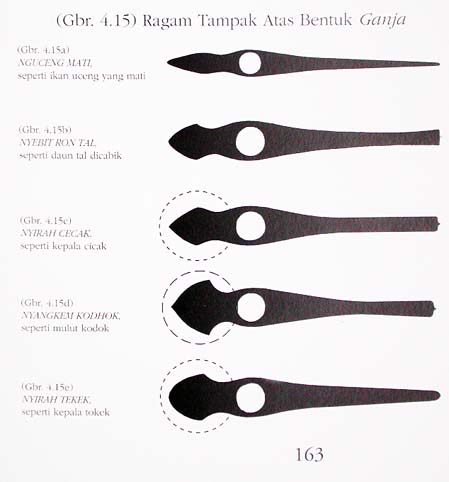

It seems that while we wait for another pictures from Mandaukudi, we shall discuss some ganja's forms. I apologize to Pak Mandaukudi for 'hi-jacking' the thread, temporarily. Is it O.K. ?
Dear Mas Ganja,
First of all, thank you for attaching pages from the famous Mr. Haryono's book, which unfortunately, not translated to English until now.
Dhungkul, I read somewhere, means 'water buffalo's horn', but better to check it in Zoetmulder Dictionary.
According to Mr Guritno's illustrations, Wilud and Dhungkul differ only in the curl. Kelab lintah, on the other hand, has two waves and a curl. If we follow the pattern, then there should be another ganja, with two waves, but without the curl. Should we call it in another name ? As Dhungkul and Wilud differ only in curl, why not?
If we put some more critics on Guritno's book, based on two pages you had posted then here are some :
1. Where is 'ganja wuwung' ? It is a common shape of ganja from side view, which has a straightline silhouette/contour, likes the top of the roof.
2. I'd rather to put Ganja Sepang (I recall Guritno translated Sepang as 'sak pang' (java) means 'in/on the same branch/bough. see dhapur's meaning section) in "Ragam Tampak Atas Bentuk Ganja" (Ganja's shapes from top view), simply define it as 'Ganja sepang= ganja which has no head', that is, both end are tails, whether it has curl or not, waved or not.
3. I'd add another shape in Ganja's shape from top view, namely Ganja Regol=Ganja with two heads, simply the opposite of Ganja Sepang. It belongs to dhapur regol (and yuyurumpung ? if I'm not mistaken) which has two gandiks. Quite rare, but it do exist.
4. Ganja Nguceng Mati (4.15a) : which ones define the Nguceng Mati, the head, the tail or both ? I recall Harsrinuksmo define Nguceng Mati simply as ganja which have pointed end/tail, as the opposite of Ganja Mbuntut Urang=having 'shrimp tail', that is, square or slightly rounded tail.
5. The head of Ganja Nyangkem Kodhok (4.15d) and Nyirah Tekek (4.15e) on the illustrations are too big/exaggerated. Ganja's head directly connected to the size of gandhik, and ganja's belly (gendhok) directly connected to the thickness of the blade on bawang sebungkul part. As gandhik should never thicker than bawang sebungkul, so the head of ganja should never bigger/wider than the belly. Simply an anatomical things. While the ideas regarding the Nyangkem Kodhok and Nyirah Tekek are correct, ones should notice that he/she would be very unlikely to find the proportion of the heads as illustrated in reality.
Please don't take it in the wrong way. Guritno's book is a good book. But we discuss something which naturally 'in dispute' amongs some expert. Guritno had to pick one opinion, or making a synthesis from some opinions. It's hard to satisfy evereyone. And frankly, I don't pay much attention on this disagreement.

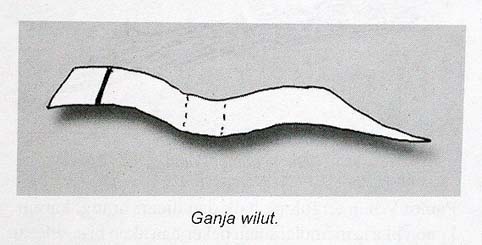

Yes Mas Boedhi,
I have the same question about "ganja wuwung" (I hope my first picture below is one example of that straight, no curved "ganja wuwung"). Why, not included. If I'm not mistaken, some (or many) keris with tangguh "old tuban" have such "ganja wuwung"... And another example (picture) on ganja sepang...
Ganjawulung

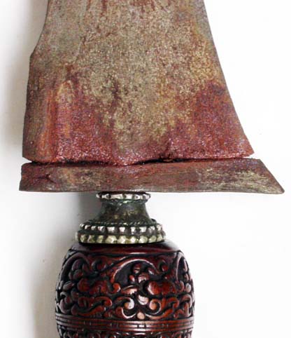

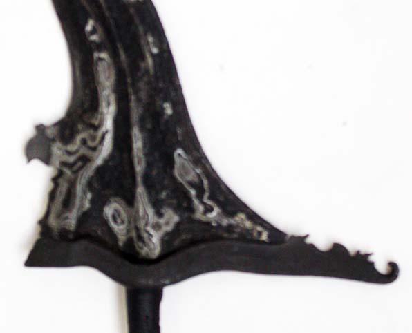

... or this rusty one, is more "wuwung type" of ganja, Mas Boedhi? What is the specific form of "ganja wuwung"?
Ganjawulung

I think there is no curved 'ganja wuwung' You have post some good examples on it. The most peculiar character of ganja wuwung is it's plain, straight edge, wheter it is parallel to the blade or slightly 'slanted' ( when the thickness of ganja on the front part/head is thinner than the back/tungkak. Usually no tungkakan). The slightly curved one is ganja sebit ron tal, also known as 'cecak nyander'=a slightly arched cecak lizard when it catches it's prey.

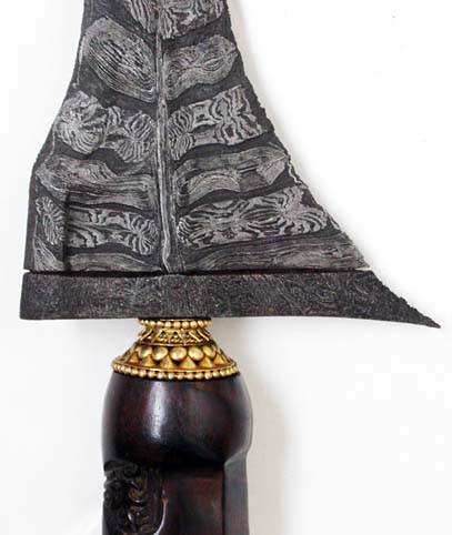

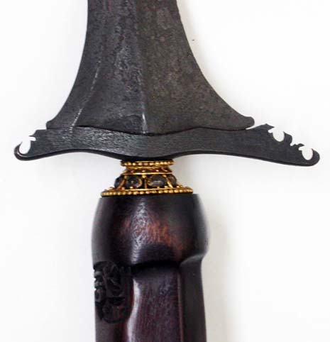

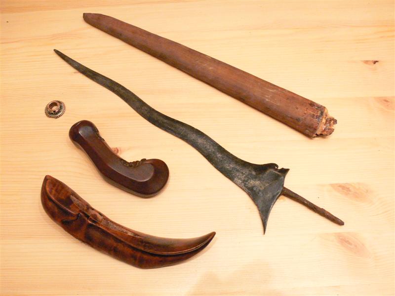

Angry Well finally it has arrived.......
Originally Posted by Boedhi Adhitya
Well, I must agree with Pak Alan and Alam Shah, since the proportion of the sor-soran seems O.K. While it is not usual to have a ganja iras in kelap lintah, it is certainly possible. Not so 'unusual', I believe.
If the ganja was missing, then the pejetan/blumbangan will go acros the bottom end of the blade, making the neck of the ganja ('gulu meled') very thin if we see it from the cross-section view. If the pejetan deep enough then nothing we can do but to put a new ganja. 'Deep enough' in this case is simply an ordinary, well-defined pejetan. The part of pesi/tang which immediately connected to the base of the blade (where the ganja once resided) would be swollen/larger a bit, as it must have a snug-fitting to the ganja's hole. It was also protected by the ganja, so it might have the least worn-out compared to the rest of the pesi, and even more, to the rest of the blade.
Your blade, Mandaukudi, seems to have an appropriate size of gulu meled (neck). I bet for it, but would be better to see it from the top (or bottom?)/ cross-section view.

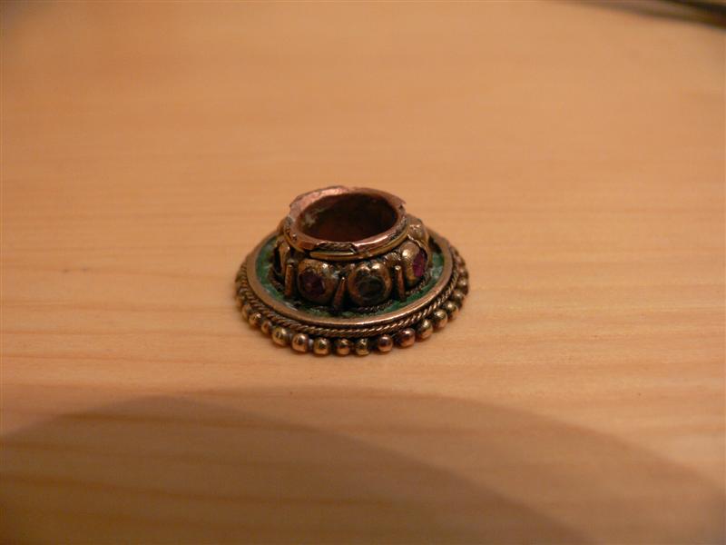

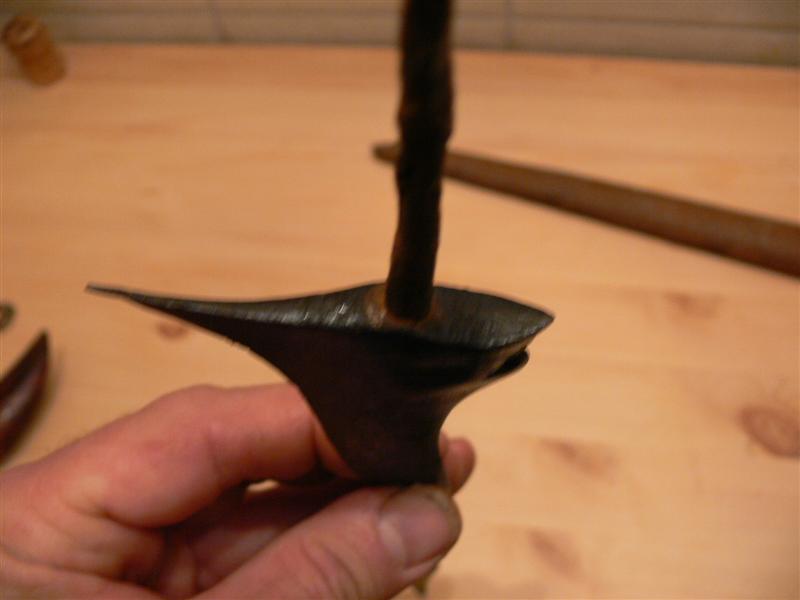

After some trouble with our local customs ( that should be a thread worth on his own) the keris has arrived.
Strange object and the worse nightmare too see how "someone" has tried to glue the wranka , one thick bunch of hardened glue in there.
the wranka is not the original, or maybe worse, It seems that someone tried to file out the hole because with a those glue it didn't fit quite well!!!!
Silverwork sarong totallt destroyed by the "restore-expert:
The blade seems to me , but I'm no expert, no "missing ganja" type.
there's no thick lower part of the peksi and the patina shows good on the end of the blade.
It good be a compilated piece but why did they leave the pure gold mendak with semi-precious stones on it?
sorry for the bad pics I will try to make better ones.
Mytribalworld is offline   Reply With Quote
Old 11th January 2008, 08:29 PM   #21
Posts: 7,232
Not a bad keris. It is 100% restorable, and none of the restoration is difficult. If the pendok is too far gone to do anything with you might need a new one, but that's no big deal.
Gold mendak?
Tested?
Depending on what you paid, you might have had a win here.
Yeah---not a bad keris.
Incidentally, this is definitely gonjo iras. No doubt at all.
Old 13th January 2008, 07:11 PM   #22
Boedhi Adhitya
Posts: 103
Thank you, Mandaukudi, for posting additional pictures. Definitely, the mistery solved. You're very lucky getting those gold mendak! Test it thoroughly, though, as the balls might be made of gold, but the middle part might be not. I hope you really have a gold mendak.
Good luck!
Boedhi Adhitya
