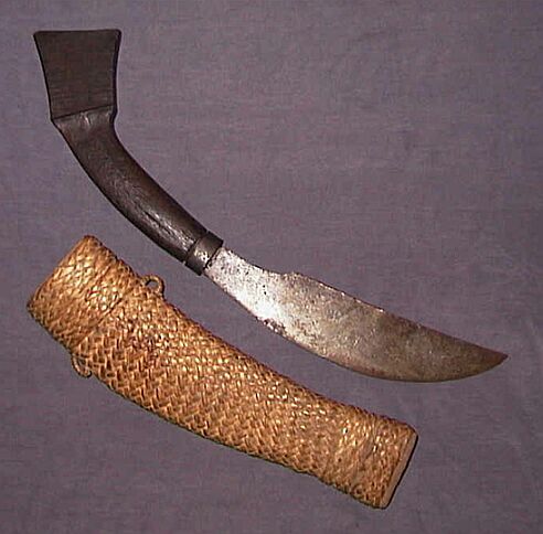

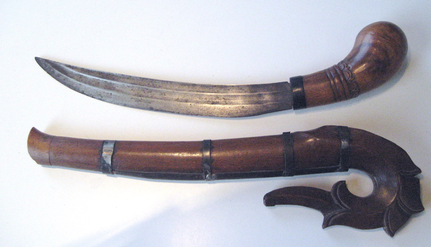

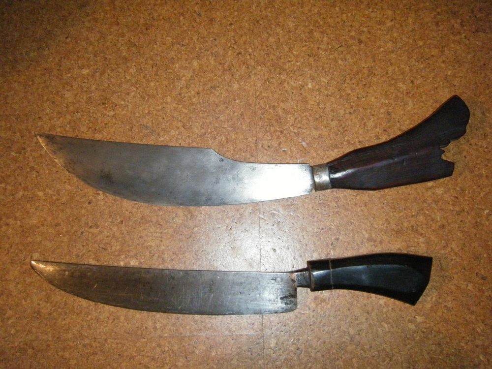

Hi All
Here are two siraui for comment. My main question is how were they used in combat? They seem to be more a thrusting type weapon similar to the Moro gunong. Any thoughts on this?
Lew
Old 27th October 2007, 11:33 PM   #2
Hello Lew,
The smaller one is sweet! The larger blade looks like it could have been refitted on Java? (I recently saw one offered from Java which had similar non-original fittings in Javanese style.)
Perhaps try to etch the blades?
Sorrily, I haven't come across any knowledge from inside the culture. I think the closest match judging from the blade/hilt configuration is the Rencong (especially with hulu puntung). Barring any other relevations, I'd extrapolate from there...

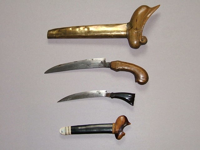

Not the best quality photo but all is to seen what we need.
Old 28th December 2011, 04:29 PM   #19
And here the two examples Charles showed us in a other thread.
Old 28th December 2011, 04:45 PM   #20

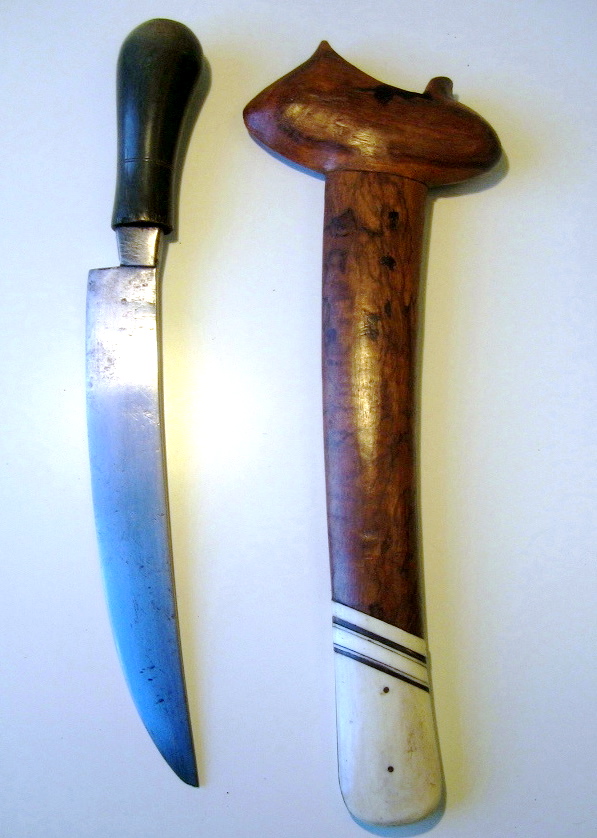

And here a picture from my maybe wrong attributed Siraui with a Bagobo Sangi. Like Rick pointed out the shape is similar and let me think that both are utility knifes.

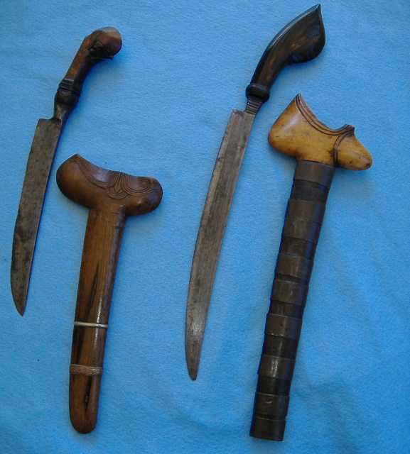

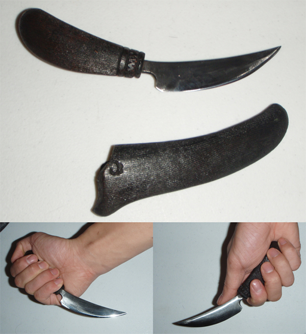

Well, while waiting for an update on this matter, I went ahead and got myself a modern made pisau that appears to be the same blade-style as one of the two types of siraui.
What do you guys think?
Old 21st January 2012, 01:28 AM   #27
Posts: 6,436
The form looks the same, just smaller; more like the size I would expect to see in a korambit .
Would size be a factor with this weapon ?

I agree it does seem pretty small (but very handy). I think maybe blade length would matter since it feels like a slicer... and if one is to slice with a knife, a longer blade edge would definitely help. Whether or not it is a utility knife that can be easily used to fight with, or a fighting knife of a less-than-conventional style, or even two distinct types of knives, one for martial use and the other for mundane tasks... it seems like this is definitely a slicer if held conventionally...
However in pistol grip-like hold (like a badik) it punctures quite well without slipping (at least vs cardboard). Edge-up pistol grip feels odd to me... but maybe that is how it's meant to be used? Or maybe as a precision slicer.... I don't know.
I eagerly await a larger example to play with.

The (Javanese) knife you tried is similar, but as Rick pointed out much smaller, which limits the comparison for the different grips.
I am back home again and I just played with my full size knife, the version not pictured in van Z, trying out:
1) Hammer edge down.
2) Hammer edge up.
3) Icepick edge out.
4) Icepick edge in.
5) Pommel in palm push dagger style.
6) Pencil grip edge out.
7) Pencil grip edge in.
The most comfortable grip (for me with the design of my knife's blade) is 1) followed by 3), which is the same grips that are shown with the small (Javanese) knife in the post above. The least comfortable grips are 4) followed by 7) and 2). The reason for this is that the underside of the blade, closest to the handle, cuts in to my palm when I am holding it in those grips. For 2) I can adapt it by holding it lower on the handle and sliding in my thumb at the uncomfortable 90 degree blade point. For 4) I cannot do this.
My conclusion is that utility wise it is most comfortable in 1), with the thumb resting on the back of the blade.
