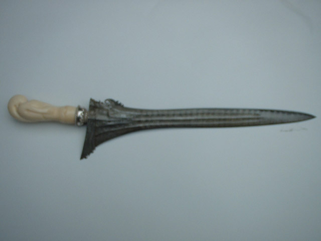

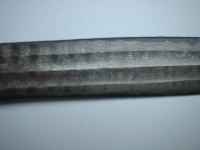

Hello to everyone!! Here's a little patrem that I've forged from Campo Del Cielo meteorite and old wrought iron with a steel core. The wrongko is thuya burl and the gandar is ebony. Ivory ukiran in the Durga/Dewa Sri/Wadon form. Mendak in sterling silver.
I used 325g of iron salvaged from Windsor Castle after the fire, 190g of Campo meteorite and 90g of Kango (jackhammer chisel) for the steel core. Pamor of 170 or so layers in a "ladder" pattern which has turned out quite reflective, got a little carried away with a complex ricikan which looking back (hindsight is always 20/20!) was a little ambitious, still, I had a lot of fun building it and learned a lot too!! I think I'll steer clear of complex dapor for a while and concentrate on getting the overall shape right!! There wasn't an overall plan for this keris what you see sort of just "happened" with the constituent parts coming together because I liked the style or shape of them, hence the "hybrid" form!!

Quite nice for a Brit Keris.
And finally a keris that we can say for sure is made with meteoric pamor.
Did you also make the dress?

Hi David, aye, it's all my work... though I may be buying mendak instead of making them-too many blades to try to take time off to fiddle with silver!!

A superb work ! Congratulation. Wrought iron + meteorite + steel, that must have been a nice exercise to heat weld.
I am curious to know what is the weight of the keris blade . You had 615 g of metal originally, how much has been lost in the forging process ( and stock removal !)
I am very impressed because I am in a similar process but I am sure no way close to your result.

Hi Michel, first, the final weight of the patrem blade is about 87 grammes.. Second, judging welding heat without the sparks can be done by looking at the surface of the iron whilst it's in the fire-the surface will look like butter on a hot day, slightly molten. (the surface looks wet) Never used a gas forge so I can't comment-I've always used coke or charcoal.

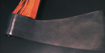

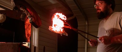

I just finished this axe and sword for an exhibit. The blade is a yataghan varient with three bar composite (300 layer top and bottom with 150 layer center twist). The Axe is a five bar composite with three twisted layers and two straight..20 layer bar each.
Ric

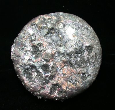

Here are the shots that could not be viewed on the other forum.
If this and the previous message are too far outside this discussion please delete.

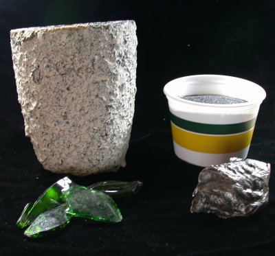

Raw materials (crucible,steel powder,meteorite,green glass)
Ingot cooking (note full safety gear..or lack ther of)

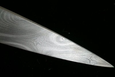

Ingot of smelted meteorite steel which was fored out and welded to modern 1084 steel for contrast
blade made from that billet..1600 layer twist with ivory and ebony
blade detail

Michel,
In your photos your show glass and crucible as raw materials.
What exactly is "crucible" ?
-------a crucible is a ceramic container which holds the molten metal in the furnace.
Why do you put green glass in your forging process ?
---------the glass is a flux which bonds with the oxides and removes them from the metal so it can melt and be free of contamination...borax is too aggressive and will eat the crucible.
You utilize steel powder. Don't you loose a lot of this material before it is molten by oxidizing it and really burning it ?
------the crucible is covered (cosed system) and the glass is the flux so there is very little loss
What is the advantage of utilizing steel powder versus a piece of steel ?
---the steel is a modern metal powder of known chemistry so I can get a certain type of steel when I cam finished.
Ric

Hi Ric, what kind of meteorite is that? Is it the Nantan? Has it turned to a kind of haematite? I've seen those on E-Bay, if it was one of those just wondering if you broke it up did it have any cracks or fissures inside? Might be an interesting ukiran material. Probably a wee bit heavy though!
That particular piece in the photo was supplier by a client..it was a Russian fall, but I do not remember the name.
The "normal" type I use is Nantan and Campo. The nantan has almost pure nickel srips inside and is rusted in many places...it is good for melting, but I think simply folding it in would be problematic for the first five wleds or so.
