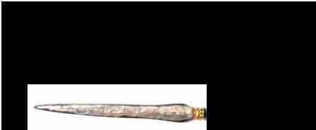

dear Rick, Alan and Kerislovers,
One type of creations by Empu that receiving less enthusiasm is TOMBAK (spearhead/lancepoint [?]).
I would like to invite all of you to discuss about and to share images of Tombak you have.
Who knows, even you just love Keris, the discussion of Tombak could broder us the understanding of our interest.
Lets begin...
warm salam,
Usmen

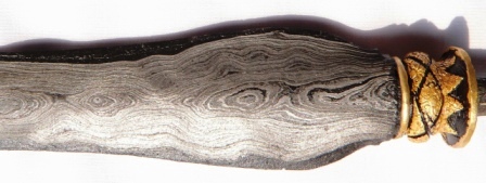

Old 20th September 2007, 03:22 PM   #2
Raden Usman Djogja
Raden Usman Djogja's Avatar
Join Date: May 2007
Posts: 199
Default .
Raden Usman Djogja is offline   Reply With Quote

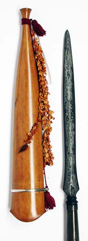

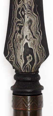

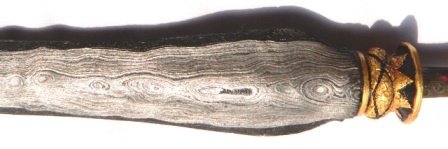

Old 20th September 2007, 05:47 PM   #3

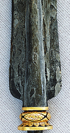

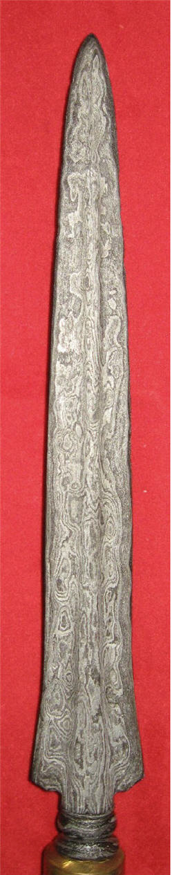

mine:
Old 20th September 2007, 05:59 PM   #4
simatua
simatua's Avatar
Join Date: Sep 2005
Posts: 69
Default Question for Usman

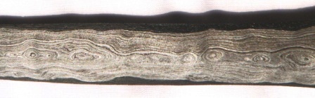

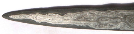

The Tombak you presented has a nice shiny pamor.
Can you (or anybody else) tell more about this pamor (material)
Is this one made with nikkel?
and the estimated age of this tombak?
It seems to have reflection pamor as well if i am not wrong.

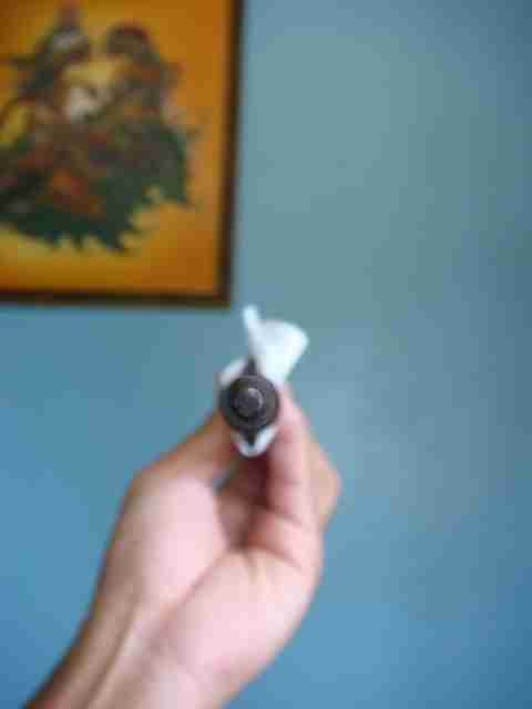

Old 20th September 2007, 11:53 PM   #5
Posts: 7,255

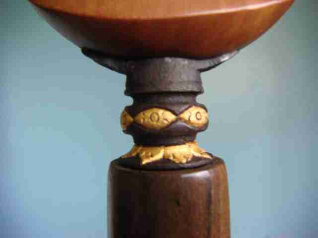

Pak Usmen, is it possible for you to provide a photo of the metuk at 90 degrees?
This is pretty important, because with tombak the metuk is one of the prime indicators.
Is this pamor nginden?
If so, could you provide a photo looking down the length of the blade towards the point, so that we can see the nginden pattern?
Thanks.
Old 21st September 2007, 12:23 PM   #6
Raden Usman Djogja
Join Date: May 2007
Posts: 199
Pak Alan and kerislovers,
I am afraid that I cannot provide images of methuk at 90 degrees and the length of the blade toward the point at this moment. I dont bring that tombak here. It is on the top of 3.25m landeyan walikukun (spear made from walikukun wood/tree) in my home in Jogja now. I will check whether there is other tombaks which are now here in Africa having the same type of methuk as I uploaded above.
Why do you think methuk is important for tombak, Pak Alan? as I saw, there were 2 types of methuk: iras ( unseparately with blade?/english please ) and ordinary (separately with blade). Sometimes the ordinary methuk was changed. So the kind of steel of blade was different from the kind of steel of methuk. Please try to watch carefuly the tiny image of tombak Kanjeng Kiai Ageng Plered in Yogyakarta Heritage book (page so and so, when it was cleaned personally by the Sultan HBX). I just had a curiosity that its methuk steel was different from its blade steel. So, please give enlightment of the importance of methuk based on your views. I got the story of the important of methuk/gonjo but from the spirit point of view. not quite important to be shared in this thread.
I feel there is chatoyant "gedhagan" in that pamor. Pak Alan, what kind of pamor motive do you think?

Old 22nd September 2007, 10:57 AM   #7
ganjawulung
ganjawulung's Avatar
Join Date: May 2007
Location: J a k a r t a
Posts: 991
Dear Raden,
I like the pamor of your tombak. Yes, it is the genre of "beras wutah" or "wos wutah" (spilt rice?). But, more specific it is "ilining warih" (the flow of water). Our life is flowing everyday, like the flowing of water in the river...
Ganjawulung

i think i'm falling in love with your tombak Mr.Usmen..
i agree with Mr. Gonjo the pamor is "wos wutah",
Dear Mr.Gonjo that is HB or PB??
GR
cahaya

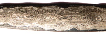

Old 22nd September 2007, 05:54 PM   #9
simatua
simatua's Avatar
Join Date: Sep 2005
Posts: 69
I think wos wutah should be more right.
With ililing warih pamor the inner part consist of wavy / flowing lines too, instead of circles.
Outside the middle you see indeed some wavy lines.
This is mostly inherent with the wos wutah, and can differ with the fact for example how many(and thick) pamor "sheets" are used combined with iron , and the thickness of the iron sheets.
simatua is offline   Reply With Quote
Old 23rd September 2007, 11:30 PM   #10
Posts: 7,255
Pak Usmen,
I was taught that one of, if not the, prime indicator for tombak is the metuk.
There is considerable variation between metuk of different tangguh. Tombak are much more difficult to classify according to tangguh than are keris. With a keris, especially if you have a rondha, classification of a quality blade is really pretty easy, yes, it can become something to dispute if the blade is less than very good quality, but tangguh was never intended to be applied to substandard blades in any case. However, with a tombak, what you have is pawakan, material, metuk.Time can alter pawakan, material is often difficult to read, most especially from a photo, when it becomes virtually unreadable, what you are left with is the metuk.So, just as when we look at a keris, we home in on one feature first, rondha if its there, or maybe the blumbangan, or maybe the material, and then we ask what classification it can be if it possesses this feature, for instance, if that blumbangan is boto adeg, we know immediately that we are not looking at Mataram, bold heavy blade?---we know its not Maja---so what are we left with?We then attempt to confirm this with the other features.
Same thing with a tombak, the first thing I was taught to look at was the metuk, then I look at other features to try to confirm what it should be, based on that metuk.If the other featrures fail to confirm, then I've got problems.
To adequately assess the metuk you need to see it at a dead straight 90 degree angle, if you don't see it like this the shape and proportion can be inaccurate and you can be misled.
If a metuk has been changed, it might be a case of a new metuk being made for the blade, in which case you can expect the metuk to reflect the style of the time and place where it was made, or it might be a metuk from another tombak put on the one you're looking at. In the case of a metuk from a different tombak, its not that difficult to pick, usually---you look at the fit and alignment, same as you would with a changed over gonjo, with a new one made for the blade you need to rely on an assessment of material, and if this was done a long time ago you're probably just going to be guessing. But in any case, as I have already said:- tangguh was never intended for substandard pusakas, so it doesn't matter too much anyway if you cannot give a supportable tangguh with something that is substandard.
In respect of the tombak under discussion. This is a very nice tombak by any measure. To my eye, from the photo, it looks like 19th century Surakarta work, but I would not be definite about this without handling it.In all honesty, I am hesitant to even give this tentative classification:- tangguh is just too, too, difficult, if not impossible, from photos. You need to handle the things. Tangguh is not just matching the way something looks to a mental template, you need to be able to feel it as well.
As far as pamor goes, I feel that the people with whom I associate would simply call this "wos wutah", and then comment upon and discuss the way in which it had been made, rather than try to give a sub-classification of wos wutah, which can become contentious.I don't think we can call it ilining warih. I understand ilining warih to be a sub-classification of adeg, and adeg is pamor miring, this is clearly pamor mlumah.It does look as if it is a pamor nginden, but unless it is possible to tilt the blade to read the nginden pattern, it is impossible to comment further.

Pak Alan,
Thank you for elaborating the importance of methuk. I would like to learn about it. Hope we, all kerislovers, can share the knowledge in this field area by contributing images and comments. I bring here (in Africa) some tombaks and I will take pictuces one of them, especially its methuk, from several angels as proposed by Pak Alan.
Hope other kerislovers can contribute if any.
warm salam,
Usmen
PS: I will upload in the earliest time possible after taking pictures

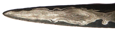

Old 26th September 2007, 02:14 PM   #12
Raden Usman Djogja
Join Date: May 2007
Posts: 199

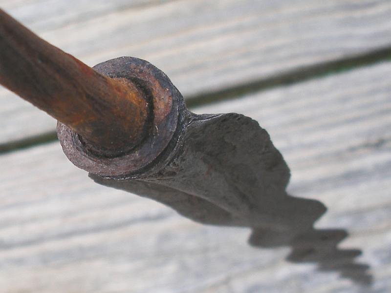

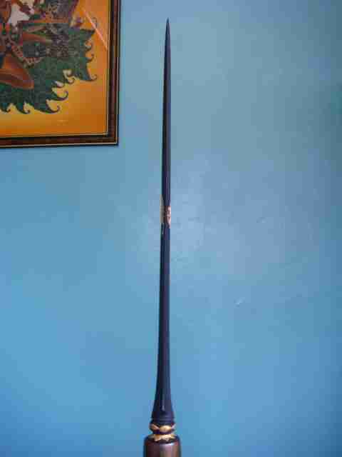

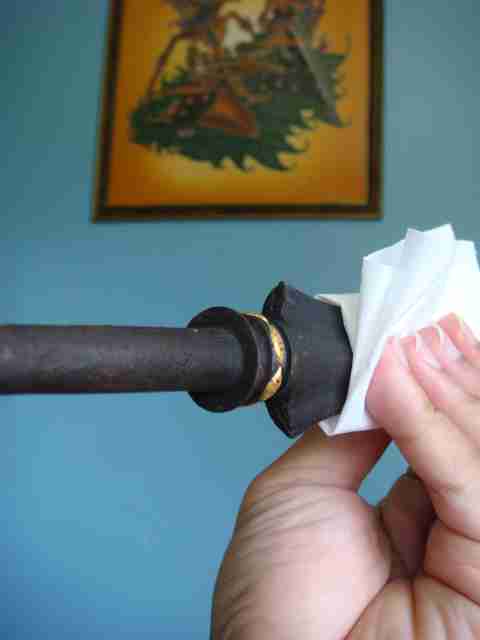

dear Pak Alan, Pak Ganja, Pak Cahaya, Pak Simatua, Pak Kronckew,
and Kerislovers,
Now I am uploading other images of tombak Kiai Kalacakra, especially its methuk. Hope these images can be source to discuss deeper about the importance of methuk of tombak. Now, may I give the floor to all of you.
warm regards,
Usman

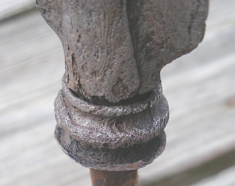

Old 27th September 2007, 09:55 PM   #14
Posts: 6,441

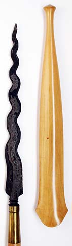

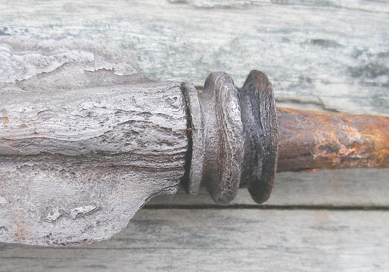

Arrow Tombak
An old one ?
Thoughts, comments ?

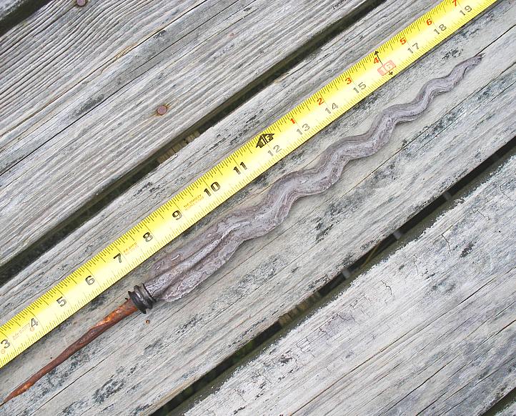

Old 27th September 2007, 10:21 PM   #15
Posts: 7,255
Pak Usmen, I have not encountered any esoteric beliefs attached to dhapur laler mengeng.
I've just had a look at several books where I would expect to find mention of this if there was some belief attached to laler mengeng, and there is no mention of such a belief. Apart from this, there seems to be a little confusion about exactly what the characteristics of laler mengeng are.
I've always known it as a straight keris with an inwards turning kembang kacang, as shown in Ensiklopedi, but some people seem to believe it is a straight keris with the kembang kacang in correct orientation, but constrained within the bounds of the gandhik.
This is not at all unusual in discussion of dhapur; it can be a source for considerable disagreement between equally knowledgeable people.In fact, in my experience, almost everything to do with keris can generate unending discussion, especially if we have two---or more--- knowledgeable people, both of whom are convinced they are right--- when maybe there is no "right", and no "wrong", just different opinions.

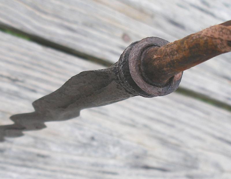

Rick, to me, this looks like a Mataram tombak where the metuk has lost form; the base of a Mataram metuk spreads more widely than the metuk in this tombak. This metuk is more like Tuban, but the blade body is totally unlike Tuban. To give a reasonably supportable opinion it would really be necessary to handle this tombak.

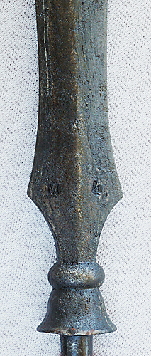

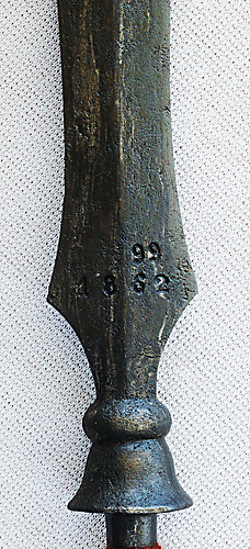

Two tombak.
The black one is a Mangkunegaraan Palace tombak, stamped on one face "99" & "1862", stamped on the other face "M" & "4".
The brass brongsong on the landean is stamped "86" & "1862"
A Surakarta classification tombak with metuk kinatah.

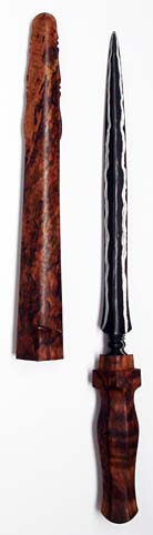

Old 1st October 2007, 07:42 PM   #19
Nagawarrior
Nagawarrior's Avatar
Location: Inland Empire, Southern California USA
Posts: 160

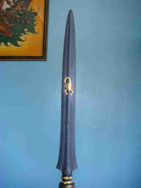

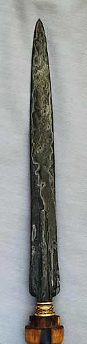

My Tombaks. I tryed to show the dress of the small one that exhibits chatoyantcy; possessing a changeable luster, like that of a cat's eye, Enjoy.
Stephen
Nagawarrior is offline   Reply With Quote

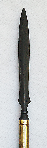

Old 2nd October 2007, 11:47 PM   #20
AyAtOyOlLa
AyAtOyOlLa's Avatar
Join Date: Jul 2007
Posts: 7

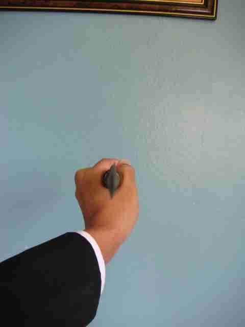

Morning everyone !!!!!!
Does this consider a tombak or an arrow head ??? Cause it's only 9cm not including the pesi.
AyAtOyOlLa is offline   Reply With Quote
Old 3rd October 2007, 02:08 AM   #21
Posts: 7,255
Not one nor the other, I think, but in length, closer to bedor than tombak.
Would not surprise me if this is CE Madura work.

Originally Posted by Rick
An old one ?

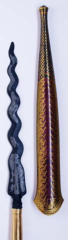

Dear Rick,
I have similar tombaks as yours, although they maybe come from different tangguh. I hope, they are from Mataram era...
With thirteen luks, so we call them (yours too) as tombak with dapur korowelang...
Ganjawulung

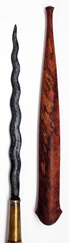

Default Another Korowelang
This is another type of korowelang tombak, slimmer with 13 luks too. Hopefully from Mataram era...
Ganjawulung

ganjawulung
Join Date: May 2007
Posts: 991
Stephen
Dear Stephen,

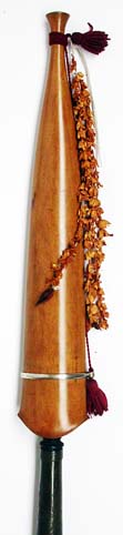

Your tombak in the center, is really a nice looking tombak. We call it, tombak with dapur "baru kuping", with kind of two holes near the base of the tombak. Like holes for earrings. "Kuping" in javanese language means "ear". And "baru" could mean "new", but for the tombak term, it is a name of straight tombak dapur...
The "sarung" (tombak sheath) with such model, Madurese people call it as "seken". Madurese people use to bring the seken with tombak behind their clothes. Hidden...
(This picture below, I show you the "seken" model, with tombak made in 20th century, with "silver-nickel" pamor of "teja kinurung" (surrounded light?). It has "methuk susun" or piled methuk...)
Ganjawulung

Posts: 6,441
Smile Many Thanks
Thank you very much for sharing your knowledge Ganjawulung .
It is also nice to see tombaks of similar form .
Do you have any comments on the metuk; it appears to be a seperate piece but it's hard to tell because the whole tombak is so eroded .
Dear Rick,
It seems that your methuk is from the type of "methuk sekar", or methuk with pamor. Other types of methuk based on this categorization are: "methuk tretes" (methuk ornamented with kinds of precious stones, combined with silver of gold), "methuk kinatah" (methuk with gold ornaments like Mr Usmen's tombak of Kalacakra), "methuk serasah" (ornamented with thin layers of gold or silver), and "methuk wulung" or of flat black iron...
But from the formation of the methuk, you may call it as "methuk rabi" (separated methuk), rather than "methuk iras" or one piece of methuk with the tombak blade.
On methuk, I agree with Alan that methuk is one of the primary indicator if we want to determine the tangguh of the tombak. But it needs more studies on the tangguh of tombak...
For comparation of the form of methuk, here I will show you the picture of my tombak from the Paku Buwono era (Solo after "palihan nagari" or the division of Mataram, after 1755)...
Ganjawulung

Just want to share a Javanese tombak, dapur Biring Drajit..any opinions and comments are welcome.
