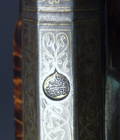

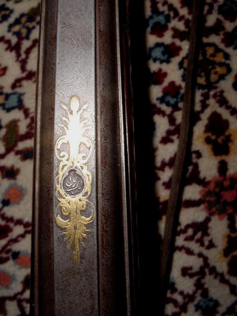

Can anyone read this Turkish or Arabic stamping? Thank you, for looking.

Good Day
the alphabet is arabic
but apparently, according with my favorite translator
my spouse no meaning in arabic language
may be, should be in turkish
rgds
à +
Dom

Hey Archer,
Nice looking firearm you have, pattern welded barrel, gold inlaid designs and a makers stamp on the barrel.
Not sure what technique of inlay was used for applying the goldwork. In general the Turkish technique was a triangular punch done in series creating a line that was inlaid with gold.
The Persian tended to use either a dot punch not overlaying the punch marks but also making a line where gold was inlaid. They also used a channel cut and inlay.
Both used a series of groove grooves cut where the body of a larger design was with a line defining the border.
Turkish designs tend to be more symetrical all the time.
My guess from looking at this photo is that your firearm has a Persian made barrel and I suspect the armours mark to be Farsi.

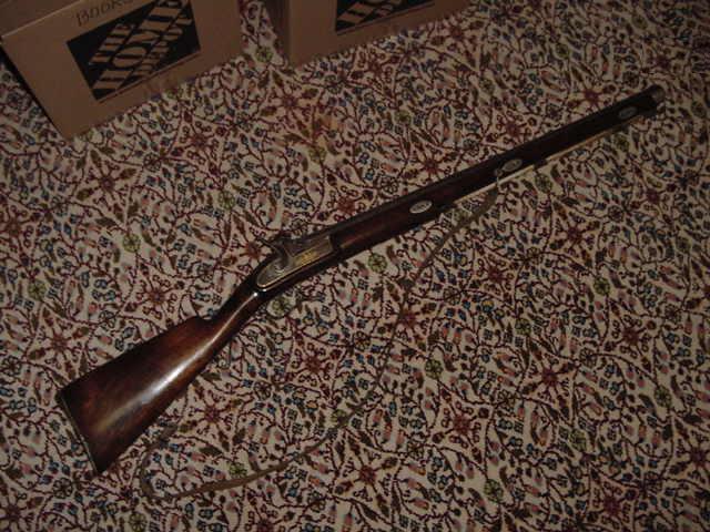

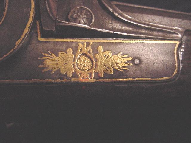

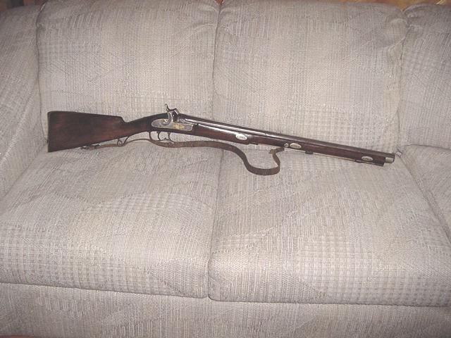

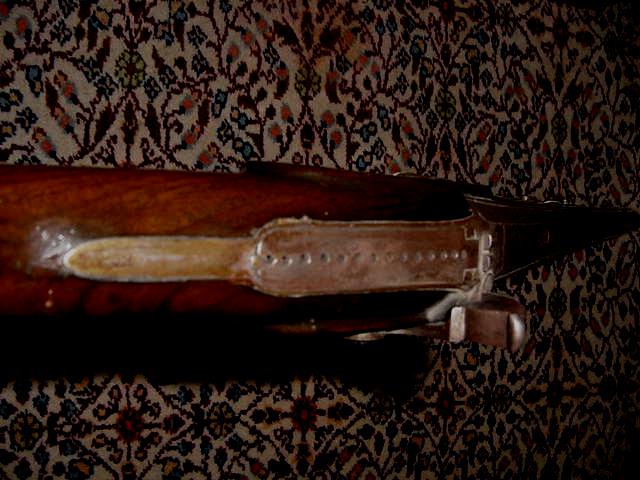

I bought it in 1968 in Istanbul in the covered bazar thinking it was a jaejar from Germany; but, have now come to understand it could well be Turkish. The inset of gold was done in an undercut channel, and looks like connected dots.

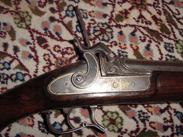

The most unique feature is its hidden peep sight in the tang. Theres another and different cartouche on the lock plate It's hard to photograph and I even tried a rubbing couldn't get it clear enough. Thank you for your help.

Interesting firearm you have. Would keep an open mind to this firearm being either Turkish of Persian. Have had a late 18th C. Turkish miquelet with a very similar rear sight, the one on my gun certainly could have been added during the 19th century.
It interesting that the lock has the makers stamp also. Is it the same mark as on the barrel? You rifle shows strong European influemce with the type of stock it has. A study of the lock may give you valuable clues as to when this gun was made. Looks to be a well made firearm, a three pin percussion lock, the shape of the stock may help date this weapon also. My gut feeling is between 1840-1880 time period, would certainly be possible to be a little earlier of later. Sort of based my assumption by the shape of the hammer, the hammer arm being squarish on its backside and the European style stock.

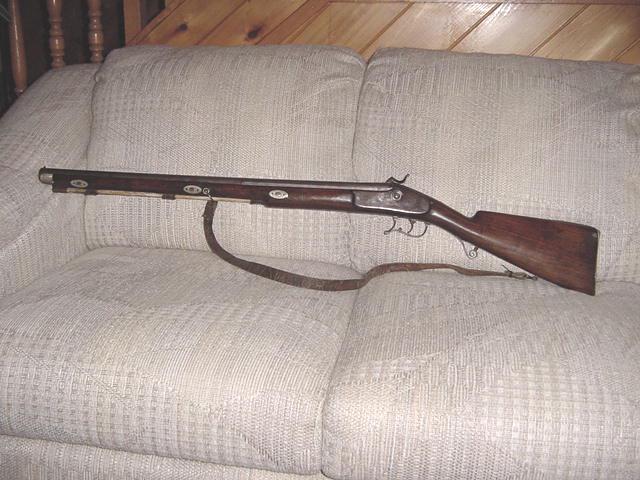

Rand, this doesn't hold a candle to your museum piece, obliviously made for royalty.

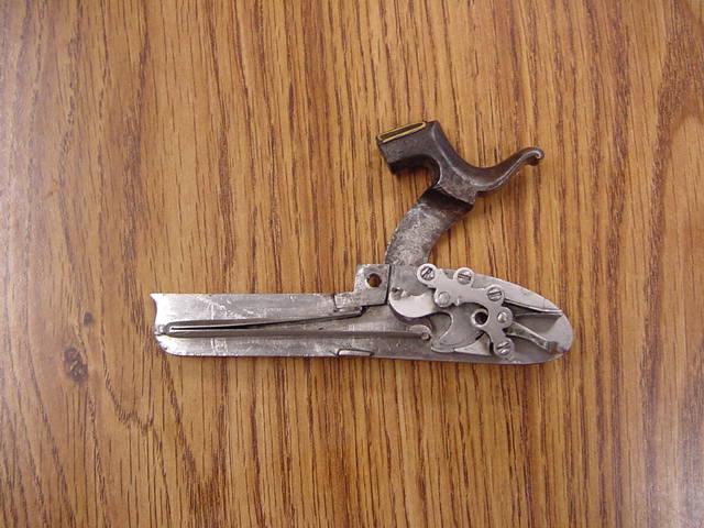

This lock is typical of the era, it shows abuse and an excellent sear repair. unlike most most exposed metalwork of the era the thimble and trigger guard are not embellished the screws are all cut square opposed to V cuts of English guns.

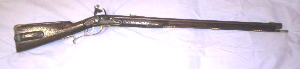

I've included a shot of a German jaeger comparison. This gun is stout and shoulders very steady, it's almost as though the inlays covering up it's origin.

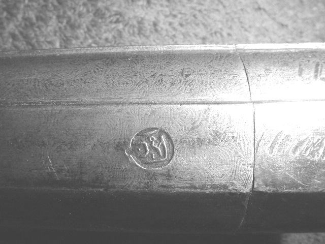

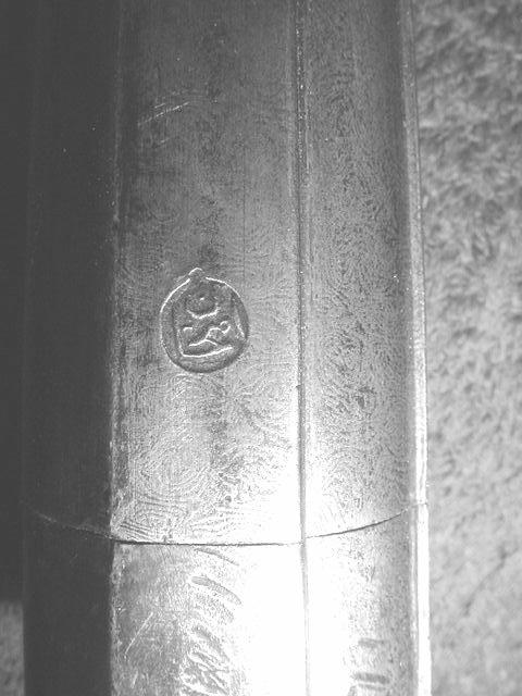

Thanks Rand, I was pondering your question, when I spotted a proof mark peeping out almost hidden by the stock. I would say age mid 1800s. Then the lights came on briefly. All the British guns I've owned or handled are dripping with proof marks on all major parts. I have to assume German and other European guns would be the same. Thanks for the links, I'll look into them.

Archer,
The mark on your barrel reads, IMTIHAN.
It means TESTED or PROVED
Ham

Hey Ham,
Can you tell me if the proof mark is in Arabic, Turkish or Farsi?
