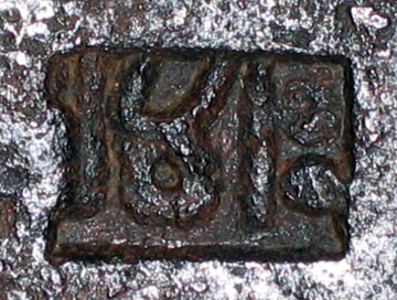

I've finally gotten around to addressing my loose hilt problem on a very sad old tulwar. I was told it was excavated and boy do I believe it! Unfortunately someone got hold of it and went to town with an angle grinder or something else equally destructive. Anyway, I did remove the hilt and (in the only place the grinder couldn't reach) under the hilt I found an interesting makers mark or armory mark. Can anyone help me identify it? I took the best pics I could - hope you can help.

Hi Timy,
Can't help with the mark, but it Is a very nice clear one.

Your absolutely right. As far as the mark is concerned I can't even identify what kind of characters they are. Since I'm quite ignorant about these marks in general I was hoping that someone here might have seen something vaguely similar.

Hi Timv,
While there is indeed considerable knowledge in the ranks here, it is often extremely specialized and sometimes those who are key in the study of Indian weapons are not at hand. While not specialized in the weapons of India, I will offer some observations that I hope will be of some help.
First of all, weapons in this condition are my favorite as they are true warriors usually that have not yet been worked over, and are often snubbed by dealers as well as many collectors. These old warriors often have thier own stories uncrusted in the dark patination, history itself! If I may suggest, please bring it to static condition, but dont overclean it.
This appears to be probably Rajput, or a talwar from Rajasthan regions and most likely early to mid 19th c. judging by its form, without consulting resources handy, this is my estimation. The deeply stamped cartouche is interesting, and since it is found under the hilt, is probably a makers stamp that may have numeric figures as these often had to do with contracts of blades produced I believe. It seems that armoury stamps typically were found on the blade visible in the fully mounted weapon.
I have seen similar deep cartouche stamps on early tulwar blades that were present in blade near the hilt, but clearly visible, and these seem to have held Urdu characters. I have not seen translations of the examples seen unfortunately. These blades often had the trisula at the center of the blade which was a traditional and iconographic symbol. One of the best resources available on such symbolism is Robert Elgood's "Hindu Arms and Ritual" which although obviously focused on these weapons, also elaborates on the symbolism found in Indian weapons of much wider scope.
While your tulwar may be 'excavated' in its condition, its presence is outstanding, and the marking intriguing, worthy of continued research.
Thank you for posting it!

Hi Timv,
You are right, Jim. The numeric in the cartouche reads 141

Hi timv, Olikara must have been standing on his head reading the number, as it should be read from the back of the blade and not from the edge. The number is, however, so clear that there can be no doubt ‘141’ it is, but which dialect, could it be Kutch? What do you think Olikara? The ‘1’ is from my ‘translation’ sheet from Kutch, which not necessarily means much.
If the number was hidden under the langet it can’t have been an armoury mark, like Jim says, as an armoury mark was supposed to have been seen easily, so it must have been something else – a sword smith’s mark perhaps, but is a number not a strange mark for a sword smith? So let me come with a wild guess, the numbers could either have meant something else, or the smith could have been working at a very big place with many smiths, and his number was 141.
Do you know where it was found?
Jens,
I can only say that the dialect is from a (North) Indian Hindu state. It could be Rajput, Kutchi, Marwari or any of the myriad of dialects in the Indian Northern and Central provinces. Perhaps, if we know where the sword was found, we can pin the location.
And as you suggested, the '1' is not written in the way that the Hindu '1' should be written. But I assume that it is only a case of artistic license on the part of the die (punch) maker.
Olikara

Does the dot after the "141" have any signifigance?
rand
Rand,
It is not a dot but if you look closely 2 dots. In Sanskrit, 2 dots after a vowel/consonant denote the 'ah' sound. So, if I wanted to write 'Mah', I would write it as M:
It does not apply to numerals though. So my guess here is that it may have been used to denote a specific armoury or work batch.
