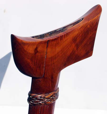

You never really appreciate how exciting it is until it's actually in your hands!
This is the first Keris in my collection (one kris though ). I may have paid a bit too much but I just really loved the aesthetics/form of the handle and blade and was very happy to find one like this. The keris is smaller than I expected (31cm ~ 12.5"overall), but that's ok. The piece needs a little TLC though (cleaning, scabbard restoration, and a mendak?). I don't know what the origin is (I'm still learning a lot); my best guess is that it's (mid?) 20th century Malaysian, but I would appreciate any input on region, age, etc.

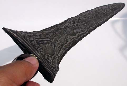

I have a couple of restoration questions too as I'm planning on cleaning the blade and restoring the scabbard.
First: How would the blade surface be traditionally finished based on it's origin: a simple etch with citrus or a full "stain" with an arsenic compound? How widespread was the practice of treating blades with arsenic? The photos don't pick it up really well, but the blade seems to be well laminated.

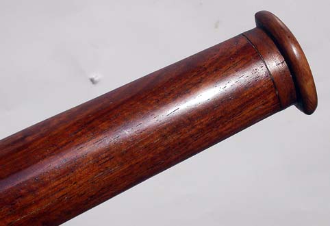

Second: I need to put an end cap on the scabbard, but traditionally would the end cap match the wood at the top or was it solely at the artist's discretion. I am thinking of using tagua nut (fake ivory) for the cap. I have seen this on some scabbards (not necessarily keris) using ivory and really like it.
Any thoughts or input greatly appreciated.
Thanks

Congratulation for your first keris. Yes !!! Beautiful indeed.
I think that is a Pattani keris typically originated from northern Malaysia (kelantan or Terengganu) or possibly southern Thailand. The dapur is Pandai Saras Luk 7.
Using some citrus acid from lime would do good to restore the blade (etch). Not much of rust observed there. No need for warangan (arsenic). I would not bother to make the end cap (or buntut) with fake ivory. If you can't find ivory, a good hardwood would also do good.
By the way the mendak is missing there. I leave the others to comment further. Overall, it is a nice piece.

Congrats on your 1st keris. A rather nice piece.
I tend to agree with Newsteel's opinion, the profile is Northern Peninsular Malaysia or Southern Thailand, but in this case, most likely Pattani.
The hilt is in the Northern Pekaka/Perkaka form, with a high balung (back of the hilt) and protuding beak-like feature.
The sheath is nice, I especially like the pattern at the centre of the cross-piece.
As mentioned, the pendokok/pendongkok (hilt cup) is missing. A silver pendokok would complement the piece. Here are some examples, click [here], and [here] for an openwork-style.
As for the blade treatment, I suggest adopting Newsteel's suggestion.
The lamination lines should appear more prominent afterwards.
As for the end-piece, I stand by Newsteel's opinion.

I agree with the others about the buntut; Tagua or Ivory might be a bit over the top; stick with wood.
I might have a piece of dark Apple wood (about the shade of the wrongko) you can have gratis; it carves beautifully.

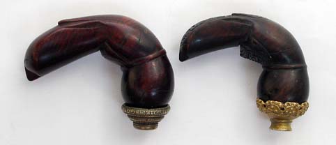

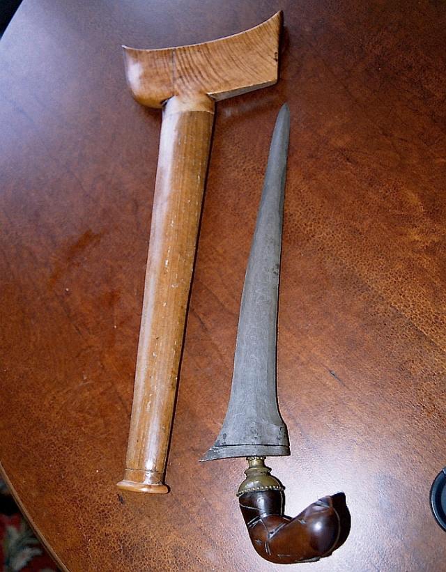

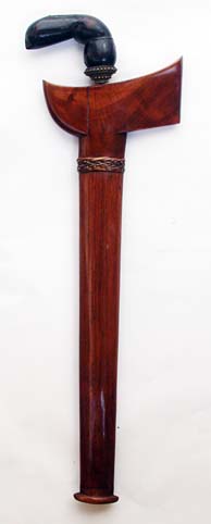

Dear Shahrial, Newsteel, and All,

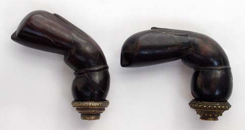

Yesterday, my friend from East Java sent me this sheath and two hilts. He had bought it for me somewhere around East Java, but unfortunately no keris inside. Just sheath and handles. Though, it is fascinating for me because this one is the first in my collection of such type of sheath. Is this Bugis, or Malay? And which type of handle is the better?
I am showing you too, four types of handles, two of them I got from my friend yesterday. Please name the style of the handles, if you don't mind...

I'd say that is a Bugis scabbard Ganja .
In my opinion the handle shown en suite with the scabbard is the correct, or should I say the more visually pleasing one.
Thanks Rick,
Actually I might be ashamed with myself. An Indonesian, asking about Bugis sheath to you. Really I must 'learn' to know more on each details of Bugis keris, sheath and all the assesories.. Idem dito with Sumatra's keris. I know only a little, although sometimes somebody offered me in the past Sumatra kerises. Even Cirebonese kerises -- though only less than 300 km from Surakarta and Yogyakarta -- I am still trying to learn to know more.
Thanks Rick for your advice...

A nice typical Bugis sheath.
The one you've mounted on the keris ensemble, looks aesthetically pleasing. The hilt is in the kerdas form.

After some more consideration, I think you guys are right, I'll stick with a dark wood for the end cap.
Rick,
Thanks for the offer, but I've been looking for a good excuse to make it down to the wood shop

I also like both hulu on the left, especially the upper one may also look good with your ensemble. But I agree that the lower right one is probably the nicest (and apparently quite old) example with interesting pendokok!
Short of an authentic Bugis blade like Rick's Sepokal, you could also try to find a fitting Javanese blade since trade blades of good quality are pretty frequently found with keris from Sulawesi...

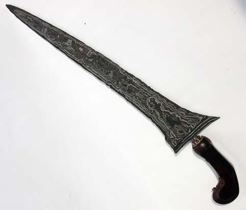

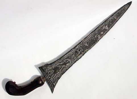

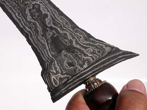

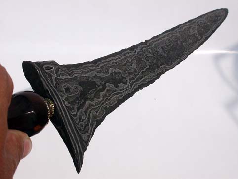

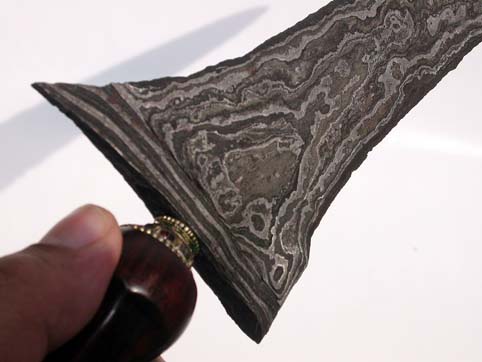

This Bugis blade was sent to me from East Java last Saturday. The "pasikutan" (appearance, sorry for using Javanese term on this Bugis), is quite robust. Good iron, but too much corrosion on the core side. The pesi was wax-sealed in a Javanese/Solonese hilt. (Pls see the pictures). Do I need to send it back? Please, your advise, Penangsang...
Ganjawulung

Made in the style of Bugis blades... but might not be... Just my 2 cents opinion.

Regarding the sepokal, like Alam Shah had said, I am not too sure whether that is a true blue Bugis or a keris from other regions, looks like a sepokal though.
I saw Raja Gunadala at the base of your keris (looks like a human figure?), I suggest that you keep it. Very nice old blade, and I would like to see it the bugis hulu and sarung before commenting any further.
Old 11th June 2007, 08:20 AM   #22
It is a Sepokal but I assume that he's referring to the pieces produced by Maduran bladesmiths these days - at least that's what came to my mind...
BTW, I don't like the Jawa-style etching&staining on a Sulawesi-style blade (nor Sumatran, Malayan, Bali, etc. for that matter ): The heavy warangan can be easily toned down by soaking in coco nut water but I'd also suggest some gentle polishing to get a smoother surface (assuming this is a recent piece and there is enough substance to the blade to work with). While old Bugis-influenced blades often have topographic relief from repeated cleaning/etching, they still tend to have a smooth surface rather than the "porous" finish in keris Jawa.
Much more important would be a decent fit to your scabbard though - any pics? (Kampung.net is still down, I guess? Searching this forum and Alam Shah's website will turn up quite a few pics though to get a better feeling how Bugis blades are supposed to fit.)
