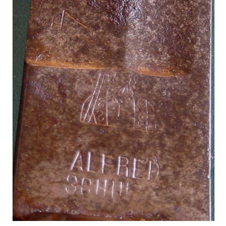

I am convinced this is the mark of a German maker, but i am not able to figure out the letters after Schu ...
The figure looks like that of a Knight, even a Monarch.
Is there any Gentleman in this Forum able to decipher this mark ?
Thanks in advance

Thanks for encouraging me, Jim. This isn't much of an ethno piece .
The seller said it could be a hunting knife ( sword ), but he wasn't so sure. The blade is 20 " long and 1 1/16" wide at the forte. To my eyes, it has the shape of a saber blade in short. The grip is dark horn, with a design often seen ... would you agree ?
You can see that this piece is numbered ( 194 ) but both number and maker's marks are not punctioned with accuracy, which doesn't favour quality.
If ever you feel like comenting on this piece, i would be so much obliged. Naturaly the same goes to any other member.
I still strugle to decipher the mark and therefore the maker.
BTW, the marks are found on the left side of the blade, if this means something.

Thank you very much indeed, Jim. Your'e a great helper.
Hi Jeff, thanks a lot for your sugestion. I will be searching on "A.W.Schulte".
I have also had a sugestion for "Alfred Schule", from another source.
But it somehow looks to me that the letters after Schu are an L and a Z, as the name being Schulze or the like ... but that is only my fantasy. However i am surprised that the human figure above the name, a King with a sword, is not known to people familiar with German swordsmiths marks.
I hope that something on that area will come out any time.
Thanks again

I am so much pleased with all this interest.
But i must say i am a bit puzzled now. I heard from another source that the typeface ( font ) used in this inscription is DIN Normschrift, meaning that this writing standard was implemented around 1950, and so this piece can't be older than that. I confess this was a "bucket of cold water" for me . But, as we say over here, against facts there are no arguments. What would you say about this new evidence, Jim ? Plausible ?
Still ignoring the real name and actual mark, any how ... besides the surprise for hunting swords being so contemporary. I thaught these things ceased existing more than sixty years ago.
Thanks for all your envolvement Jeff.

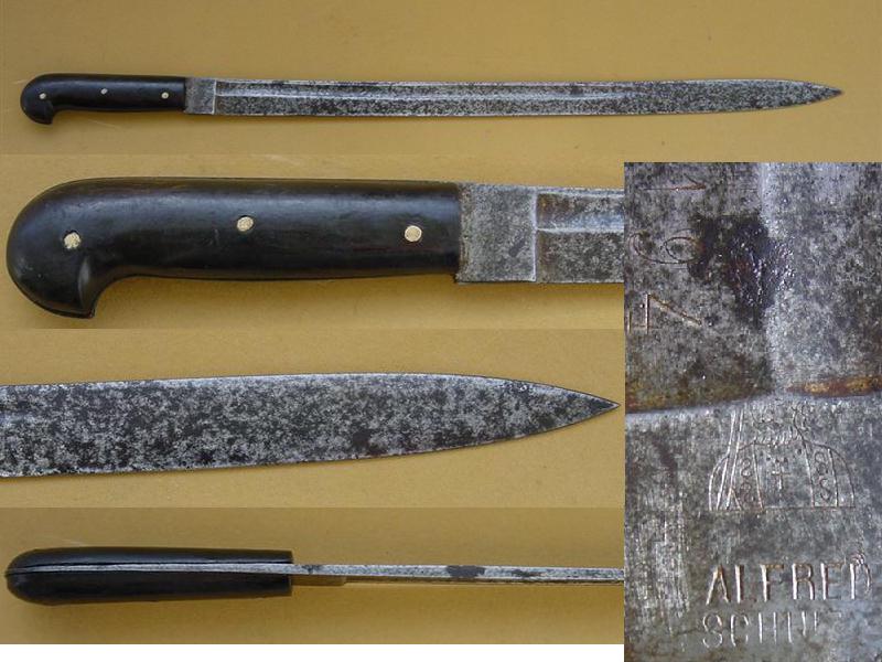

On the maker's mark, i still have nothing solid. As Jeff well sugested, it could not belong to the smith but to the trader, whom doesn't seem to be known enough to be regconized. There is also the problem of the faded name which, after several tests out there, is considered to be ALFRED SCHULTZ, but still not recorded anywhere so far. The human bust could be a Bishop and not a King, but also no evidence of its record.
As for type of this piece, let me tell you that, before it ended up identified, it was called respectively: hunting sword, infantry or police sidearm, Collins machete, russian shasqa, cutacha, rehilted WWI bayonet, Museum Replicas shasqua, and so on Quite an endurance
Then suddenly somebody comes up with a picture of a similar piece, posted in a thread four years ago, where the moderator asked an expert to identify.
The name of the piece is Machete do Monte.
The poster was not2sharp, the moderator was Bernard Levine ( bladeforums.com ) and the expert is Carter Rila.
As for the age, a different opinion dated that typeface around 1880, as also others sugested that the engraving could be a later work, so not necessarily representing the date of manufacturing of the piece.

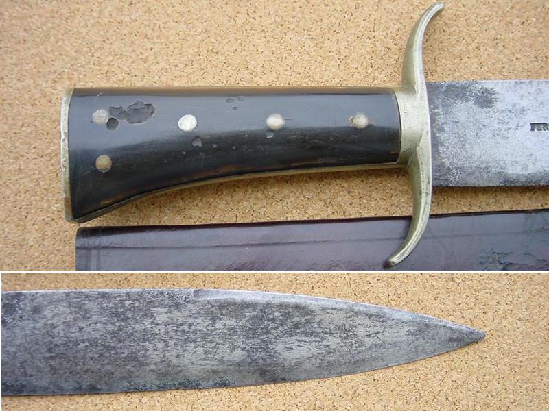

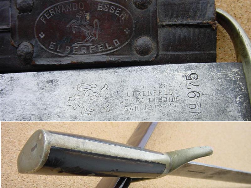

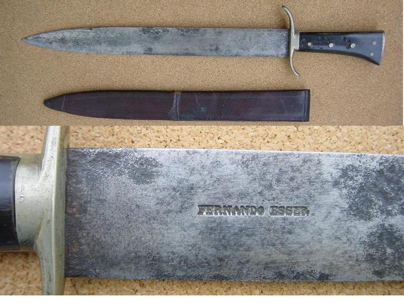

In view of all this, i decided to go back to the seller and buy him something more peacefull The attached pictures show a piece much easier to atribute a manufacturer I just have to find out whether this is a machete or some kind of variation. The age, i hope is XIX century, until i hear or read otherwise. The grips would be horn. The guard and fittings are german silver ( this the term? ). The blade on this one is much thinner and wider, and is 14" long. It's good it keeps its leather scabbard.

ALFRED SCHULTZ is a bladesmith and swordmaker, german, sec 19 mainly, he did some of the finest quality revivalist swords for palaces and castles. He also did edged weapons for real combat like knifes and military baynets. Their revivalist swords were done using the same procedures of the real ones, so they are all real weapons too, I have a medieval sword done by him I think you have saw it!
