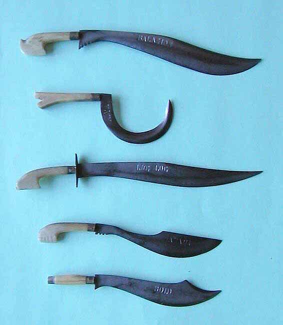

Dredging this up to add a photo.
From top to bottom :
Balacion
Kiya
Lug Log
Mabaui
Bolo

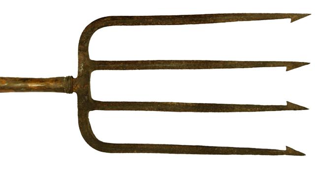

Here are two other undescribed types of spears from "moroland".
The bottom one looks like it catches fish. Unless someone knows better, the second example is a tool and maybe the first too.

My apologies for necro-ing this thread. Sir Rick, may I have your source on this? I am greatly interested, thanks.

Hi, if you'll note post #6 in this thread you will see the examples.
About all I can comment is that some Seller had either broken up the examples on a Moro weapons board, or bought a bunch of examples loose and auctioned them off in groups.
This was some years back; I put them in a shadow box on red cloth.
