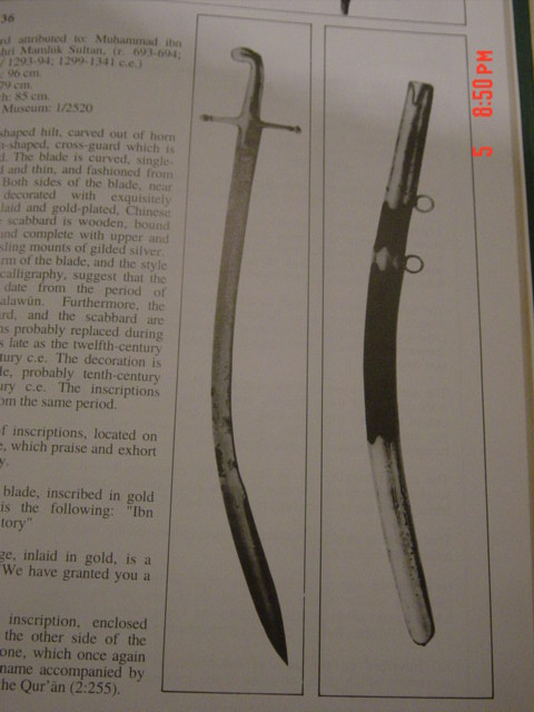

The pics are from Yucel's book.
The first one is attributed to Muhammad ibn Qalawun, Mameluke sultan between 1299-1341. The second one is dated 1484, made by Abd al-Rahman ibn Muhammad Ustadh al -Misri (" master from Egypt") and has Pala-like proportions.
Thus, the sword we know now as Ottoman Kilij came to Turkey proper only about 300-500 years of its use by the Mameluks.
Did the Mameluks, who were mostly Central Asians and Caucasians, bring their national weapon with them? Is Kilij an old Kipchak or Khazar sword? Chinese influence?

I disagree with this assessment of the history of the kilic. For starters, the kilic you scanned from Yucel's book isn't dated to the 13th or early 14th century. Those dates are the dates of the rule of Qalawun, the Mamluk Sultan, not of the sword. Of the sword, Yucel actually says the following:
Both the curved form of the blade, and the style of decoration and calligraphy, suggest that the sword does not date from the period of Muhammad ibn Qalawun. Furthermore, the hilt, the cross-guard, and the scabbard are clearly later additions probably replaced during repairs carried out as late as the 18th century CE. The decoration is late Ottoman in style, probably 16th century CE. The inscriptions also appear to date from the same period.
In addition, there is another curved sword attributed to Qalawun on the preceding page that Yucel also considers to be a 15th or 16th century piece falsely attributed to Qalawun.
The only 13th century curved sword Yucel considers to be authentic is one on the next page attributed to Husam al-Din Lajin. He says it is the earliest authentic example of an Islamic curved, single-edged sword. However, I am skeptical of this claim, as all other known curved swords of similar type date from no earlier than the 15th century. However, we have loads of examples of straight, double-edged swords dating from earlier periods. So I take this last attribution with a grain of salt.

I am intrigued: where did you see Ottoman kilijes dated first half of the 15th century? Even Yucel says that there are no surviving examples of Ottoman swords before Mehmet's reign.
Mameluke Kilijes? But of course! That was my point. The first sword was clearly defined as "attributed to". The second one, however, is dated.

It's really quite simple. The reign of Fatih Sultan Mehmet was 1444-1446, a takeover by his father, and then 1451-1481. 1444-1446 is the first half of the fifteenth century, is it not? There are two kilics with large yelmans attributed to Mehmet II, neither is explicitly dated. So, we can't know when in his reign they were made. It could have been as early as 1444 or as late as 1481. However, there are several nearly straight swords with large yelmans dated simply as 15th century in Yucel's book, as well as one kilic with a moderate sized yelman said to be characteristic of the early reign of Mehmet.
As to the issue of the sword I mentioned supposedly dating from the 13th century, it would certainly support your case, were it 13th century, but I don't think it is at all. I think that sword is most probably 15th century. Besides which, it has practically no yelman at all, merely a sharpened false edge. To say that the pala of the 18th century stemmed from the 13th century Mamluks is completely wrong.
Finally, your initial supposition was that the kilic with a yelman came to the Turks in the 17th century. That statement is fallacious. I don't think there's a kilic in Yucel's book from the 15th or 16th centuries that doesn't have a very pronounced Yelman. To back up my position, here are some kilics that date to the 15th and 16th centuries according to Yucel:
My personal favorite, the kilic of Bayezid-i-sani and so is late 15th or early 16th century:
Kilic of Fatih Sultan Mehmet, and therefore 15th century:
Kilic with no attribution, considered to be late 15th century:
Kilic from the 15th century, no indication as to early or late:
So, given that evidence, it would seem clear to me that the kilic with the yelman began springing up in the Mamluk Sultanate at the same time as the Ottoman Empire. With the exception of the lone curved sword Yucel dates to the 13th century, there is absolutely no evidence that the Mamluks developed the kilic, or that they were the first to come up with a yelman. Furthermore, such a theory wouldn't make much sense, as the Mamluks themselves came from many of the same Turkic regions where the Ottomans had lived before moving to Anatolia. Therefore, they would have access to the same weapons technology from that region.

Excuse me, but NONE of the swords I posted are Mamluk in origin. ZERO. They're all Ottoman. Secondly, I didn't show a picture of Persian warriors fighting Mongols. The second image is Persians fighting other Persians. Thirdly, there are no examples of similar Mamluk swords in the 13th century. I certainly didn't "notice" that and you have provided not a single piece of evidence for it. Furthermore, Yucel's book shows a dozen different examples of Ottoman kilics with Yelmans. In addition, your assumption that the yelman didn't pass through Persian controlled areas is absolute nonsense. The Ilkhanate and later the Timurids controlled vast swaths of what we would consider to be Persian lands for centuries. If you agree that the Mongols did possess a sword with a yelman, then you cannot argue that it wouldn't have entered Persia, as the Mongols were ruling Persia at the time. Please, look at what I've posted more carefully before replying.

The Ottoman swords you posted are all from 15th century. Mameluke Yelman-ed swords date to earlier times. As I said, since we have no evidence of Ottoman Yelman-ed swords before the 15th century, we have no way of knowing whether they had them simultaneously with Mamelukes.As to your denial that you provided any example of a Mameluke Yelman-ed sword of 13th century, please look back at your earlier post mentioning Yusel's sword #37, belonging to Husam al-Din Lajin (1297-1299) and made by al-Ustad al-Halabi ( "of Aleppo", which is in modern Syria).

Aside from #37, there is no evidence for an early Mamluk kilic. I find the attribution of Yucel's to be dubious, because the very nature of dating a sword is inexact. Just because a sword is attributed to someone, doesn't mean he carried it. In addition, unattributed swords are difficult to place because some designs persisted for a span of several hundred years, and some earlier designs resemble some later designs. For that reason, I don't find the dating of sword #37 to the 13th century to be very convincing. It is the only kilic-type sword I've ever seen dated that early - a full century and a half before they begin to show up commonly in either Mamluk Egypt or the Ottoman empire. I think it's healthy to view a sword that anomalous with a high degree of skepticism.

First, I am glad you agree that your earlier statement re. Sword #37 was in fact incorrect: otherwise, you would be arguing with yourself.
Second, your rather cavalier dismissal of Yusel's conclusions and dating is ... just cavalier. After all, he spent years studying these swords, whereas your only experience with them is limited to looking at the photographs in his book. This may be permissible if the error is blatant, but the intricacies of dating is not something that can be solved by a cursory glance.

First of all, I never once made an incorrect statement about sword #37. Secondly, my dismissal of the dating, isn't a dismissal, it's a complication. It's not cavalier, it's based on other evidence I've seen. I do have evidence. I've shown you evidence. Artistic sources, while not the best sort of evidence are a sort. You have shown no evidence of mamluk kilics predating ottoman ones. I really don't see the point in arguing with you any further, as you dismiss all of the evidence I have shown you - much of it from the same book you yourself quoted. Then, you choose to twist my words around, to mean something completely different from what I said. I said that the preponderance of the evidence shows that the kilic began showing up in both Mamluk Egypt and the Ottoman Empire during the 15th century. I made no statement about Persia one way or the other. Yet, somehow, you make it out that I said the evidence shows the kilic came from Persia. I said nothing of the sort. I merely pointed to an alternative theory that is worthy of exploration. This is absolutely maddening, and I'm going to refrain on posting from the subject again.
