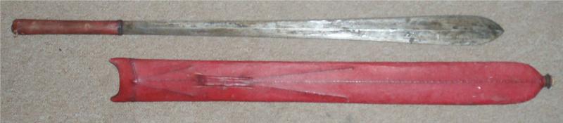

Hullo!
Here's my newest treasure...my last one (the afar jile) didn't turn out too well...so this lifted my spirits. A maasai seme, forged and 68 cm long, so a good sword size. As I undertand it from past discussions, this particular type is not all that old, but at least pre-1950s...is this correct?

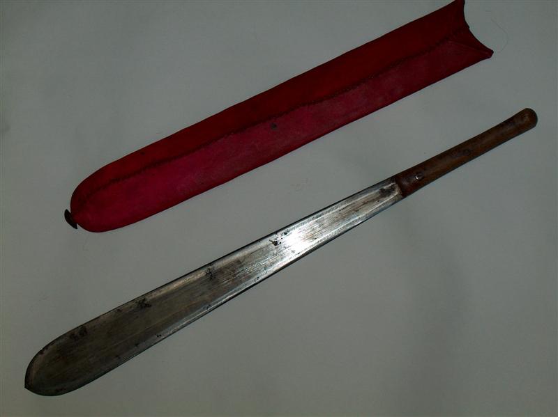

For comparison I post another seme cut from a Martindale machete (thanks Tim, I still really like it )
I'd very much appreciate comments.
Emanuel

Hi Emanuel,
I followed this and forgot to bid .....but I am glad you got it . I believe the diamond section blade would probably date this early to mid 20c. The hand forged blades with the median ridge AFAIK tend to be 19c to early 20c... and are increasingly harder to find. I think yours is a very nice Same....and at a very good price.....congrats

Thanks David,
I'm glad you didn't bid From the old threads I understand this may be a later type of the old forged seme, so early 20th sounds right. It's close to 27" long so quite large, can't wait to receive it and swing it around. What I like about these weapons, and other African ones as well, is that they show th gradual transition from speartip to sword...quite fascinating.
I'll port more pics when I get it.

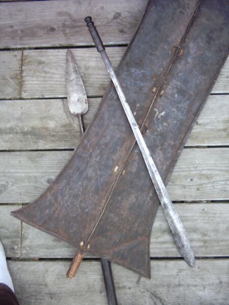

Dear all,
What do you think. Is this sword masai ?
I sold it some 2 years ago as masai although I was not sure at all as info was hard to find here.
Thanks and best regards,
Willem

Hello Willem,
Yours does look like a maasai seme...the handle is interesting though...have a look here : http://anthro.amnh.org/anthro.html in the Collections Database, then in the "African Ethnographic Collection" and search for maasai.

Originally Posted by asomotif
Dear all,
Willem
What the heck is that monster behind the Seme? It looks like something out of one of those absurd Japanese Anime cartoons, where the warrior is swinging a six-foot slab of steel with one hand!

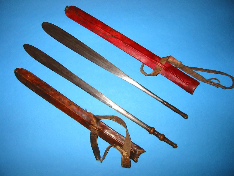

Hi Willem
That is an older Massai war sword they have longer blades. Here are two from my collection. Btw your shield looks be from the Turkana tribe.
Lew

Originally Posted by LOUIEBLADES
Hi Willem
Lew
Louie I believe one of your swords is actually Watuta. I have been involved in a serious study of this east African sword type for about two years now.
I uncovered several prints from the 1800's illustrating several seemingly similar sword types that most would identify as a "seme." But in fact range in a wide geo-cultural area.
The one on the lower left has rings built into which is a characteristic of the watuta tribe, a branch of the Nagoni. I would also need to see it sheathed to confirm this. Watuta swords frequently (not always) exhibit a neck protrusion of 1-2 inches that are not covered by the sheath. Furthermore, sheath color confirms this fact.
East african swords need to be analyzed in terms of forging techniques such as tip shape, cross section (a very complicated subject), hilt style, sheath style, sheath color, sheath and belt motif.
These swords were made and used among too many tribal groups to list.
some are:
Maasai- Each maasai group has a different style of sword. There are at least 15 Maasai groups. Some Maasai groups actually work in blacksmithing after they were forced to adopt agriculture after the 2nd and 3rd Iloikop wars and the rinderpest epidemic of the 1890's.
Kikuyu
Chagga
Luo
Watuta
Ngoni
Sambaru
