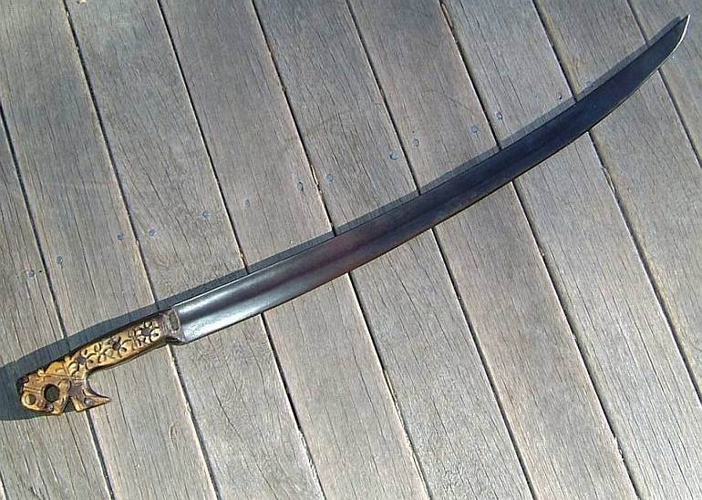

Just picked this up on ebay; listed as a Nimcha, I believe it's a Berber saber. It doesn't have the pierced pommel I've seen in some illustrations, but that could be a tribal difference. Is anyone familiar with this particular style of hilt? The blade is almost certainly European, though apparently has no markings (at least none were mentioned by the seller).
FenrisWolf is offline   Reply With Quote
Old 10th February 2007, 06:58 PM   #2
Posts: 6,026
This could be SEA? shame there is no scabbard.

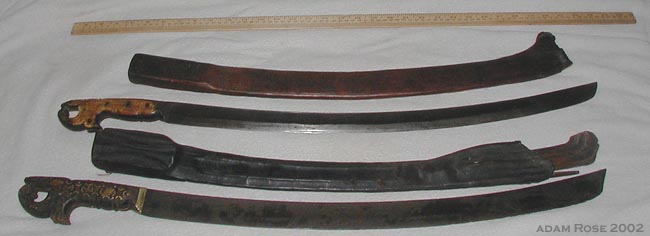

Btw, these two are owned by Adam Rose. One has a regular tip, and the other has a very slight concave tip.

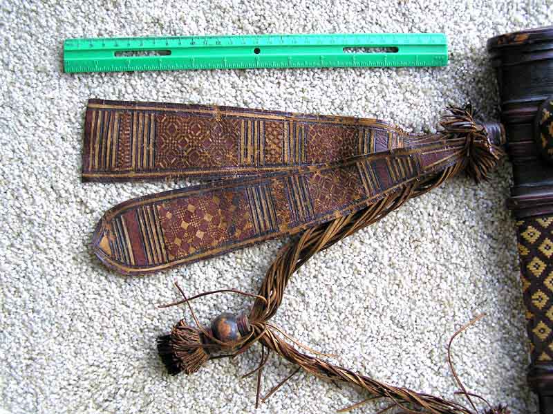

No luck on the hilt yet, but I did stumble across this version of a nimcha on the Therion Arms page. The blade is listed as 'napoleonic', and at 24 1/2" is identical in length to the one I just bought. Due to the poor angle in the pictures posted by the seller it's impossible to be sure, but it looks awfully close to me. Not also the slight humpback profile to the hilt, peraps due to the profile of the tang? Anyway, more food for thought.

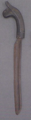

This hilt is from A. G.Van Zonnevelds, Traditional weapons of The Indonesian Archipelago. Okay it is not the same shape but does show the same decorative materials and technique. One could also argue that the shape is as similar as the Nimcha. In the aforementioned book swords from Timor like the hilt shown often had European blades. Also in this book pictures of other swords from Timor are all constructed in this more simple manner. I am sure I have some better pictures which I will add when I find then. I also want to add some pictures to the rust removal thread but can a find them Maybe if I stop look so hard i will find what I want right in front of my eyes.

Sword just arrived; even, dark grey patina over entire blade, no deep pitting. Rounded, blunt point, razor sharp edge. Definitely intended as a slashing weapon only, but the short length would preclude horse or camelback. Shipboard, corsair weapon perhaps? Hilt is slightly loose, as is the wire wrap. There are some faint letters by the hilt on the left side of the blade:
Too faint to read, perhaps someone recognizes them?
I'll post more pics in a while....

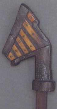

The overall patina is a dark grey, with a few worn patches. The way the inlaid squares are worn into the surrounding wood makes me feel that it's not a recent construction, sometime in the mid to late 1800s perhaps?

Are the red 'squares' inlay ? It seems that (if they are) they are secured by the nails ??
Very nice, interesting sword.....I especially like the blade
Old 15th February 2007, 11:46 PM   #27
spiral
Posts: 1,712
Ive seen such geometric nailed inlay work on butts of Algerian /Morrocan rifles.
Usualy done in ivory sometimes bone.
Looking at picture the inlay looks like dyed bone?
Spiral
