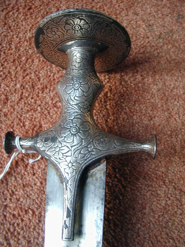

Been a while since I had anything new and then it all turns up. Traded for these three tulwars, all with silver decoration and would like to know any opinions on age and region by their style.
Cheers
Andy

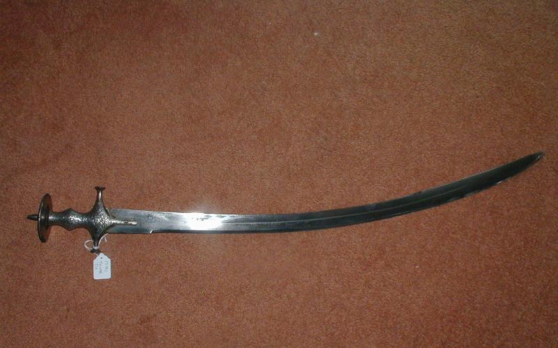

What do the blades look like?

I hadnt botherd with these, as the blades arent always a good guide to the hilt, what with re-mounting etc
But as you ask, in the same order as the hilts.

Very true, but I always figure the blade is the main & critical part , Its usualy the handles that come & go.
But others may see it differently.
I know nothing about them historicaly but I like blade one a lot. A great curve with well done fullers . very artistic.
