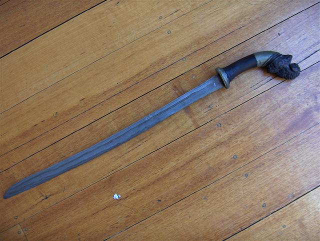

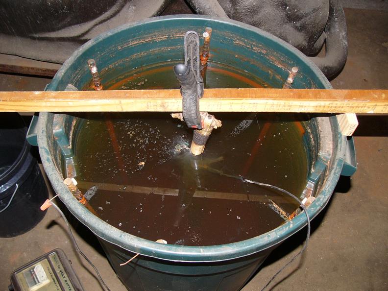

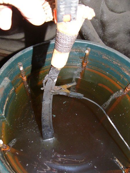

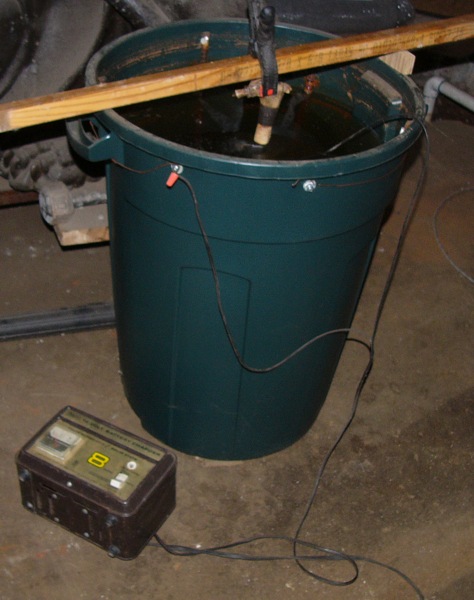

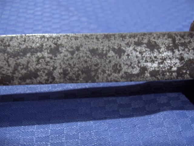

I put together this concept using a plastic garbage can with 6 steel rebars as electrodes. It works great! I am cleaning a mandau (private collection buy, the guy died and the wife put his stuff in the basement ARGH!.)
Should have taken a picture of the blade beforehand, but it was wall-to-wall red rust. After a two day soak, and one or two rubdowns with a plastic brush, most of the rust is gone.
Usiing an old battery charger for the power source.
Try this at your own risk. I am using it on a heavily rusted blade of no great value. There may some adverse effects I don't know about, but it sure looks like it is working well.
Obviously can't remove pitting where the metal has combined with oxygen, but sure seems easier and less invasive than steel wool or sandpaper. The pictures show only the process done to the blade. No steel wool, sandpaper or anything else hzs been used
The solution does not seem at all caustic, but remember it is water and you may not want to get your wood handles wet for a sustained several days. The bubbles do come up and the mandau handle is wet.

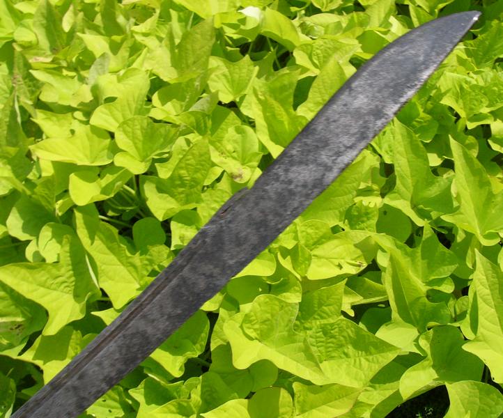

Is that chisel bevelled? It looks more like a jimpul? I'm currently all about the vinegar.
Old 11th September 2006, 05:55 PM   #15
Bill M
Bill M's Avatar
Location: USA Georgia
Posts: 1,599
Think it is a jimpul. What is the difference in a jimpul and a langgai?

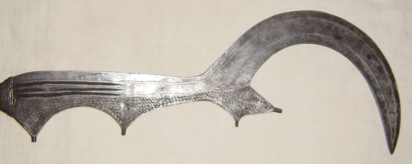

We are going to find out how good the pineapple method is this weekend.
I got this iklwa today and it has some serious rust issues.
So here are the before pictures.
I'll post the after later...

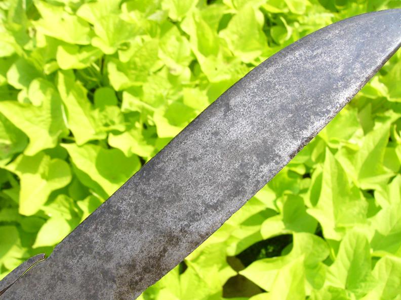

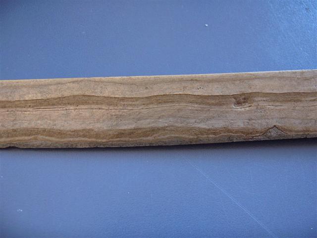

While watching the A&E DVD Shaka Zulu I came up with the solution to my problem, and another great way to derust. By the way if you are interested in Zulu ethnographic art, costumes and weapons this a great video.
In one of the scenes it shows the Zulu's getting ready to go to a battle and the are sharpening their spears on a stone.
So this morning I went out in the garden and found a nice flat quartz like garden stone and started honing.
For finish and detail I got a small stone.
The result was a blade didn't have that fake flat gray chemically cleaned look but a more authentic look with a lot of charactor.
Before and After:
The blade now looks like a typical Zulu blade
The Double D is offline   Reply With Quote
