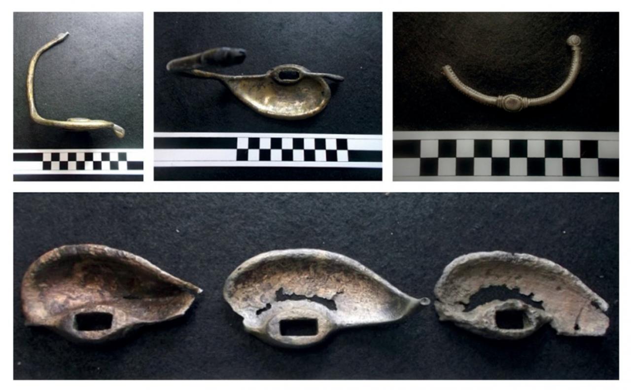

The picture show French naval sabres hilts found at the Nuestra señora de Guadalupe galleon, sunk in 1724.
This is the subject of a book I ordered recently.

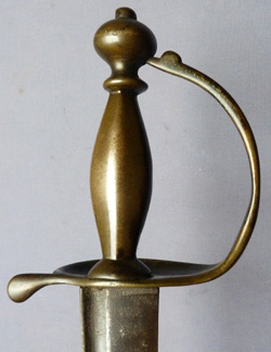

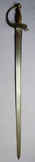

I am a bit puzzled about the 'Caribbean' rapier reference, are you referring to the cup hilt forms which often seem mounted with heavier 'arming' type blades? In the brief glimpse of the wreck site from 1708 in the linked Utube entry, there seemed an intact cup type hilt with the quillon across.
I could not make out the shell type versions. Are they in accord with these images attached? you indicate these are from the book shown by Mr.Wells, but going through that I could not find the images.
Please forgive my confusion, just wanted to be sure I am following.

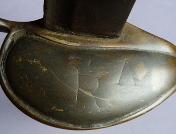

I have always understood these much simpler versions of the often smartly embellished Spanish cup hilt rapiers, especially in the 'arming sword' character were indeed from makers in the colonies, hence being labeled 'Caribbean' in most references. I had always thought of the very crude example shown in "Arms and Armor in Colonial America" (Peterson) which I cannot seem to find an image of, were the typical examples of these forms.

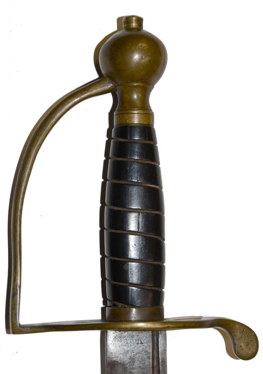

However, I later found that better quality examples but still relatively austere were also deemed 'colonial'.
Attached are images of one with what appears cross hatched ebony grip, and my humble example which as had a crude bone grip refurbished.
Regarding use of these kinds of swords aboard Spanish vessels, I had understood there were small contingents of soldiers aboard vessels, especially those with valuable cargo, including precious metals.
Not surprising that Spanish authors do not refer to the sources of these arms whether France or Solingen. As noted, these munitions grade arms were seldom preserved and ended up as scrap or repurposed.......the exception as always, the in situ wreckage of these vessels.

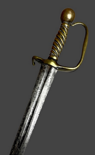

They are almost peas in a pod. The Rose hangers, from a century later are very similar

The pictures of the relic hilts from the 1724 galleon came from this Spanish 2019 pH D thesis (UNA INVESTIGACIÓN HISTÓRICO-ARQUEOLÓGICA. EL NAUFRAGIO DEL NAVÍO NUESTRA SEÑORA DE GUADALUPE Y SAN ANTONIO. FLOTA DE AZOGUES DE 1724, BAHÍA DE SAMANÁ, REPÚBLICA DOMINICANA).
https://repositorio.uam.es/bitstream...d565d/download
page 360.

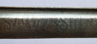

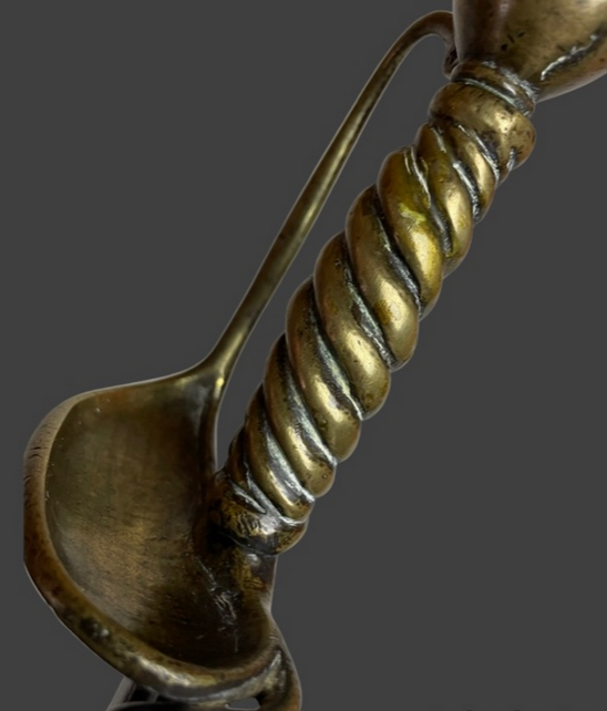

I have found what appears a survivor from those French hilts. It has a Spanish blade with the no me saques motto, possibly from Barcelona, and the markings of the Spanish Royal Navy (RA).

It is important to note that brass foundry was uncommon in Spain. In XVIth century most brass domestic items were brought from Germany. Bronze was often used instead.
So the weapons given by the French in the Sucession war were probably the first brass hilted weapons since the Granada moors were expelled (their ginetas had brass hilts).

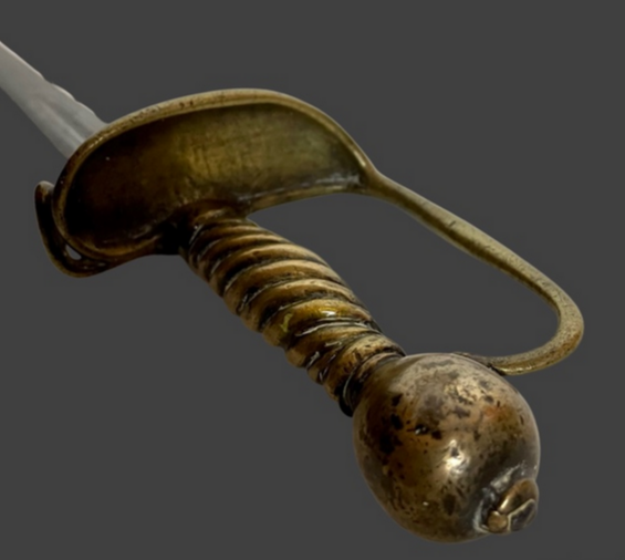

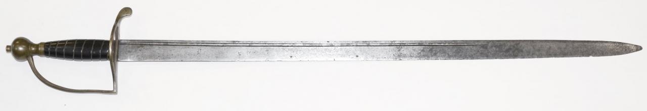

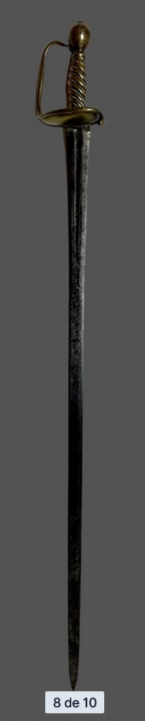

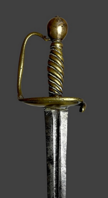

Some years ago I bought at the city of Lerida the sword below. The hilt is that of the French dragoon 1695 model. From the blade (80cm) I have had some indications that it could be a much earlier Spanish blade (motto is INRI MARIA).
Lerida was often at the frontline in 1700-1714. Whole Spanish cavalry and dragoon regiments were equiped by the French, and with their own sword models, including the 1695. Also many French regiments were busy in the peninsula. I have seen the notice that volume number 26 (1980) of Armes Blanches Françaises by Aries, has an article on those units, but although I have Hoste and Petard books, I do not have that one. Maybe somebody can confirm this point. Petard, first volume, page 30, indicates cavalry had blades of 95-98cm and dragoons, with the same single "pontat" hilt, 80cm.

The foundry information makes sense that the blade fitments often seem a second thought. Almost as if they were rebladed. A barrel of guards would ship well. Cast by the bushel.

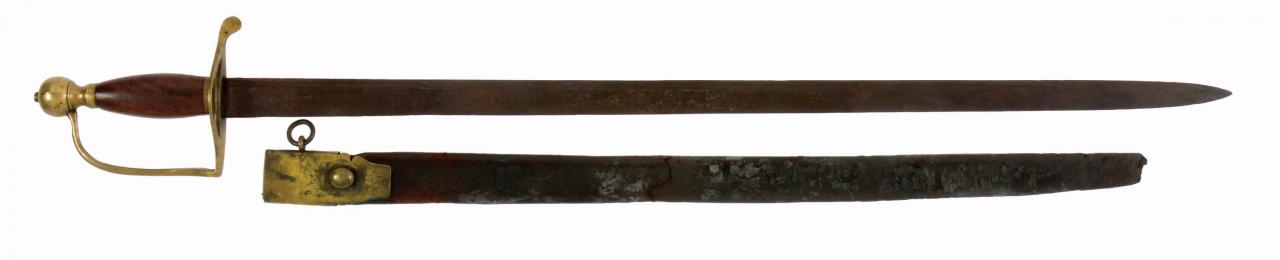

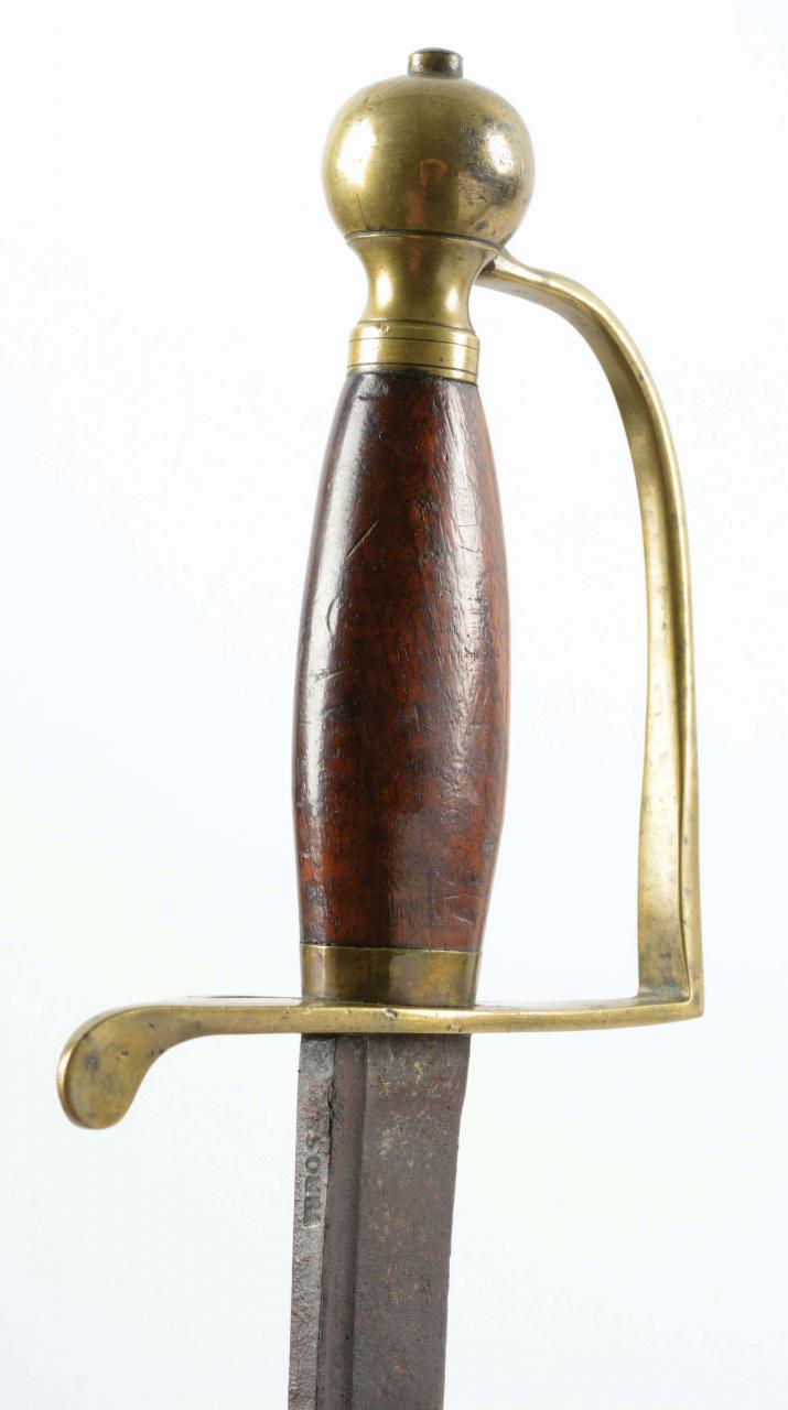

This really is an interesting topic, and in support of what Midelburgo suggests, toward the case of Spanish naval fleets, from William Gilkerson (1991, "Boarders Away" p.19) ,
"...fleets were commanded largely by soldiers, and its ships were equipped largely with land service small arms right into the 19th c. Hence, while the Spanish navy was hugely important to the geopolitics of the period and to the maintenance of the Spanish colonial empire, its weaponry was as obsolete as its organization. Indeed in all the vast chambers of Madrid's Museo Navale, it is difficult to find a small arm of specifically naval origin from the period of our study".

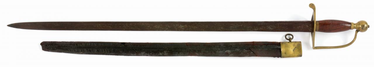

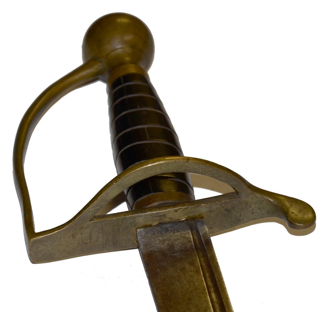

An example of the form of French hanger is found in "Swords and Blades of the American Revolution", George Neumann, 1973, p.79, 54.S.
It is captioned as c. 1725-50 brass hilt, blade 27 3/4" single or double edge straight, and for French grenadiers.
As noted, with lack of foundries for brass work and of course munitions grade arms, during the War of Spanish Succession with France allied with Castilian Spain it seems reasonable that St.Etienne weapons would be supplied.
While Nuemann suggests the 1725 as the terminus post quem for the 'pattern' it is likely these were around notably prior.
With Spanish soldiers aboard vessels, these munitions grade weapons as seen were certainly not unusual though not specifically 'naval'. The examples of rapiers typically deemed 'Caribbean; versions of the more refined Spanish cuphilts, were probably used by officers in command of these military units which were aboard these vessels. They may have been produced in the colonial ports or by armorers in the ports in the Peninsula.

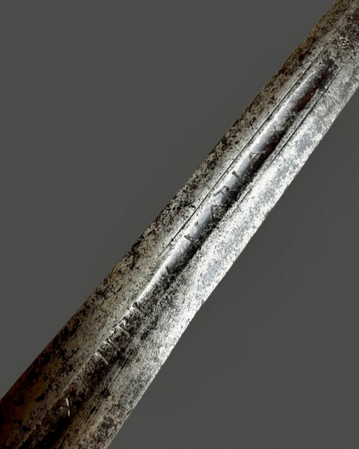

Until this year I thought mottoes were a thing from Solingen all the way. I am still trying to understand the order of appearition in straight blades, but for sabers, Barcelona started and Solingen copied. I have a couple of swords, I have not shown yet, that are a good proof.
At Tolosa, as they were also making armors, they had both engravers and gilders. I suspect I have identified a group of 4 blades, all with the same motto that could come from there, late XVIIth century.
I wrote previous post thinking in "POR MY LEY Y POR MY REY". It appears in several blades in Brinckerhof, which I believe are prior 1767 and marked as from Barcelona.
But this motto has been described as a liberal (against Carlist faction) because it puts law first and the king in second position. Sometime around 1820-1850.
The oldest blades with "NO ME SAQUES" I have seen are Italian and XVIth century. The first Solingen versions I believe are XVIIIth century and by the same people who where making fake markings of ENRIQUE COEL and GIO KNEGT. Because there are blades marked ENRIQUE COEL and GIO KNEGT in XVIIth century, but there were several batches/rounds of faking them later. This is when you find the same blade (lenticular, broad channel, 1/3 of length) being inscribed ENRIQUE COEL or GIO KNEGT or NO ME SAQUES, depending of the fancy that day in the Solingen workshop.
