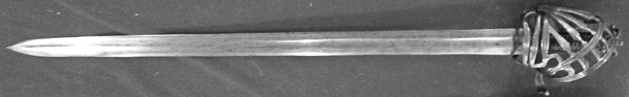

I came across this image and thought I would post it in relation to the eternal question: "is the hole in the pommel meant to attach to the hook on the guard" despite many examples having no hole. Well, this should put a full-stop to that exercise. Of course we now need to know what it was for: a sword knot perhaps?
Also, note the leather wrap around the upper ricasso.
Attachment 245457
This is a great question!! and always exciting to see there are still those of us who ask these things! It seems too many collectors dont think these things worth noticing
The schiavona history is far much more complex and evolutionary than typically realized, and that it was not just used in Venice. This type of hilt with variation of complexity in the trellis style basket guard evolved in the early 17th century.
The example shown from the Ferguson clan of Scotland has a blade dated 1611, clearly a heirloom blade outside the typical period of the hilt. Note the ring, which is to attach the trellis guard to the pommel. The curl at the terminal of the basket near the pommel is a design feature primarily and havent seen one used to hold a ring, interesting idea though.
The connecting ring was not a consistent feature as far as I know, but the idea that it may have become a vestigial thing is interesting.

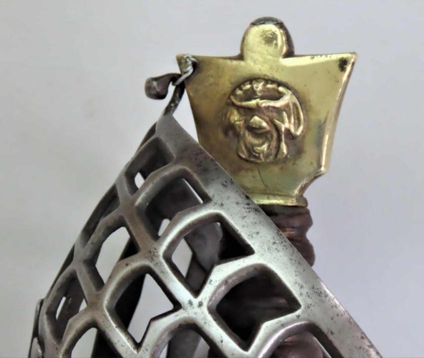

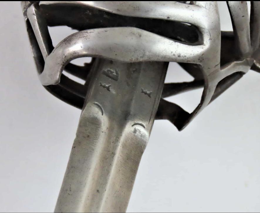

As it happens, I have a schiavona with a broad rapier blade and, although this hilt does have a thumb ring, it also feels quite comfortable wrapping a finger over the cross-guard. It would be more comfortable again if it was leather wrapped.
And even more again if it had a wasted ricasso.
Rain-guards are not uncommon though; quite right..

That is the signature of the hilt smith: Grgr
Attachment 245465
Attachment 245466 Attachment 245467
ps
that is because that schiavona has a typical rapier blade wich is about more 2 cm narow than most schiavona blades. The more schiavonas you have held in your hand the better you can judge them.
I think i need to comment as it is, the schiavona you have with the rapier blade is not the norm, in fact the chances that its composite are high , not absolute but highly probable. Most schiavonas have broader blades almost twice as broad as yours , now if you are making asumptions from an item that is not the norm that is going to lead to conclusions that are not the norm. Exeptions have there place but need to be recognised for what they are and examined from that point of view.

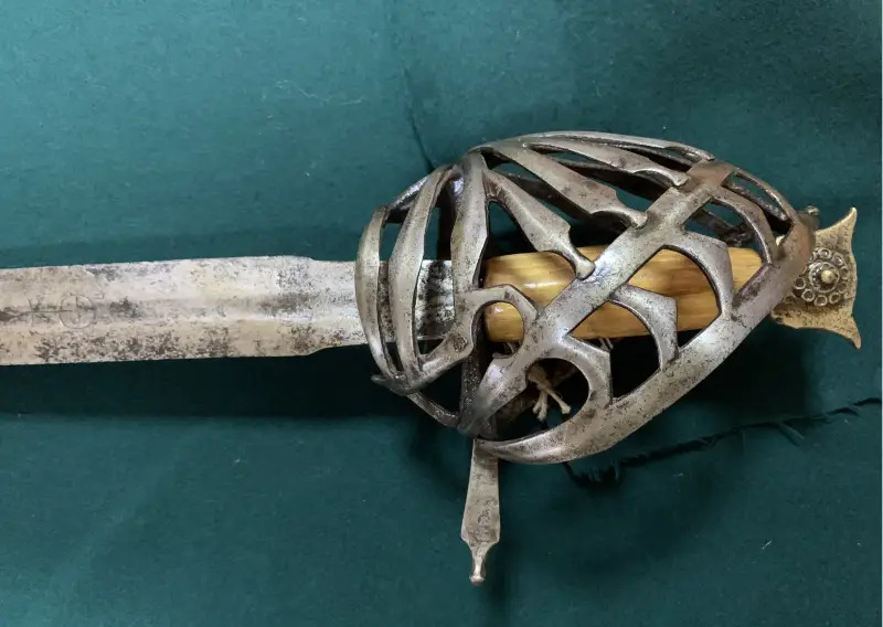

I absolutely agree it is a composite.
In truth, the schiavona I always wanted featured a very broad double edged blade with a broad fuller or multiple fullers.
Somebody out there may recognize one of these.
Name:  1st choice.jpg
Name:  First choice 2.jpg
The attraction of my sword blade was that hilt made me suspect that GRGUR was specifically commissioned to hilt that rapier blade and not that it was all simply put together by any random smith with any available suitable parts.
The quality of the blade and the significance of the markings at the ricasso were what made me think that. It has been suggested that those markings refer to the Circle of Twelve, but I haven't been able to figure out what that means. Were they the bodyguard of the Doge (No, not Elon!)
I'd still rather have my initial specification, but acquiring one in this fine condition did not prove possible at the time when this appeared.

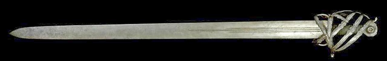

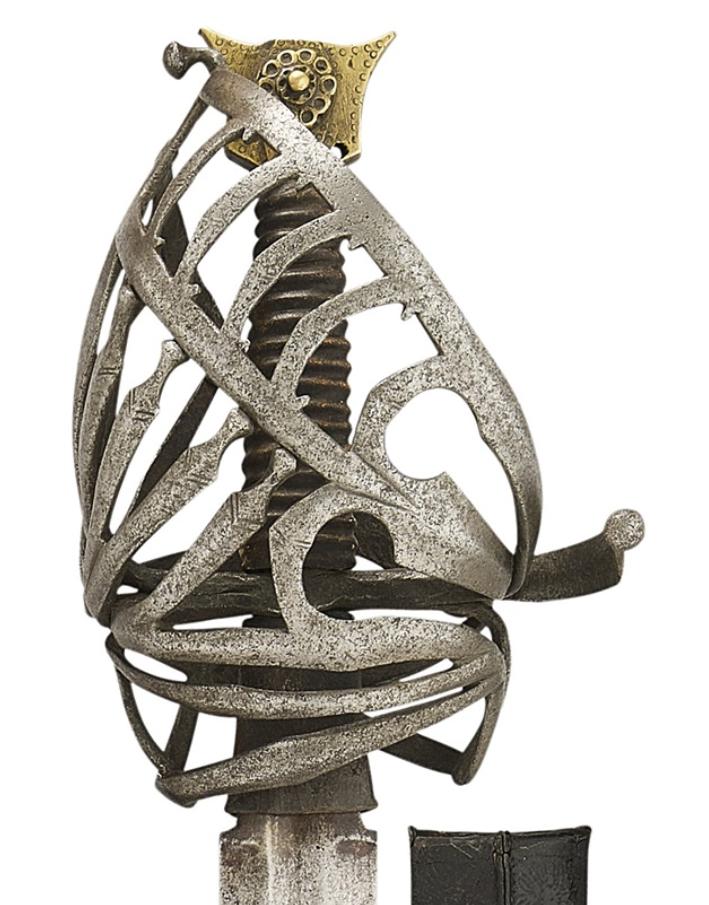

I've been searching for my perfect schiavona and while this ticks all the boxes, except for museum quality, it has another feature that marks it as exceptional:
Name:  Schiavona low hole 2.jpg
It would appear that there is absolutely no fixed rule regarding the hole, its position and/or its use.
Name:  Schiavona low hole 1.jpg

the use of the hole is to attach the guard , i would not buy a shiavona with an exact blade as in your picture because that is a 19th c blade.

These two schiavona are IMO with 19th c. German blades which are similar to those used in Sudan on the kaskara broadswords in latter 19th c. It seems these central tri fuller blades were produced in various shops in Solingen, it seems in notable volume, and were unmarked 'blanks', seemingly intended for colonial markets.
One of the things that seem regularly noted in many studies on swords, is that the blades are regarded as 'secondary' elements of identification. That is, as noted in Norman (1980), his focus was on hilt forms, providing scheduled classifications by period and numbered. ...no attention was given to blades as these were often interchanged as required or favored.
There are so many variables in the presence of atypical blades mounted in familiar hilt forms that outside of distinct provenance, speculations abound.
With rapier blades for example, by analogy, in India in cases of familiar sword forms such as the gauntlet sword (pata) and khanda (Hindu basket hilt) there are examples on occasion with rapier blades. These are total anomalies as in Indian swordsmanship there is no use for the thrust, so clearly the use of such blades was purely in accord with European presence.
In the case of schiavona, they were of course used widely outside the sphere of Venice, and traditionally in place over many years. It would stand to reason that various blades might be used unconditionally mounted in old hilts which were valued in heirloom or traditional sense. In Mann(1962, Wallace Coll.) there are many sword forms shown with blades much more recent than the old hilts on which they were mounted.
With the pommels, it seems to me that the holes were as seen, typically for the placement of a ring to hold the guard. While it is tempting to think of them being vestigally in some sort of symbolic sense, it is more likely it is simply the reuse of an old pommel in typical refurbishing circumstances.

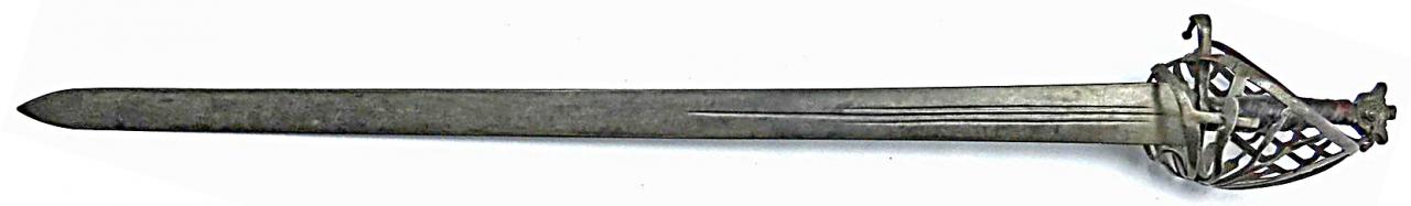

Hi Ulfberth. You sent me this photo of 3 swords from your collection.
The center one really took my fancy.
I mistook the kaskara blade for a similar type, but looking closely at your sword, with its full length broad fuller, appears an altogether different beast... and still my favourite.
Name:  3 schiavona Ulfberth.jpg
Old 17th June 2025, 06:24 PM   #28
ulfberth
Join Date: Jul 2014
Posts: 444
Thank you , that was one of the widest blades ive ever had in a schiavona and still the ballence was great , obviously more suited for cutting and slashing.
The ones fitted with kaskara blades tend to feel to heay and have no ballance that feels like leading to a function, if you could hold them in your hands one after the other the difference in feel of ballance is huge.
