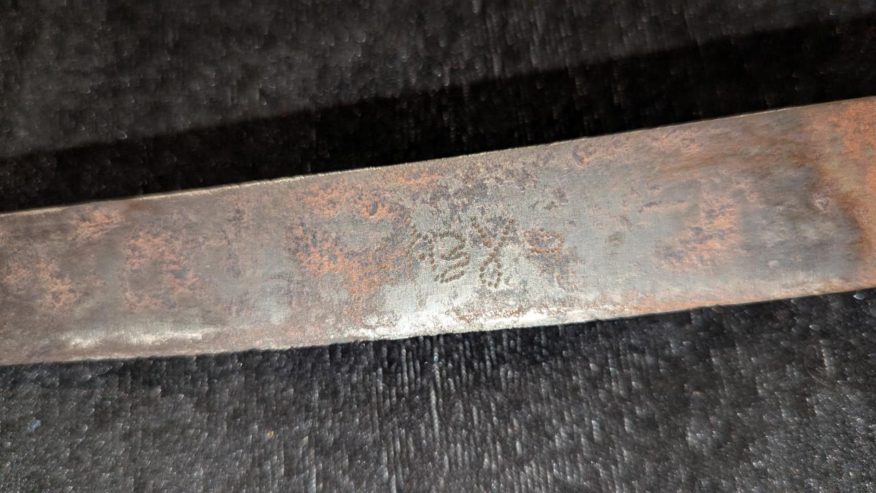

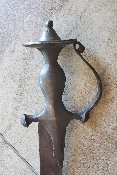

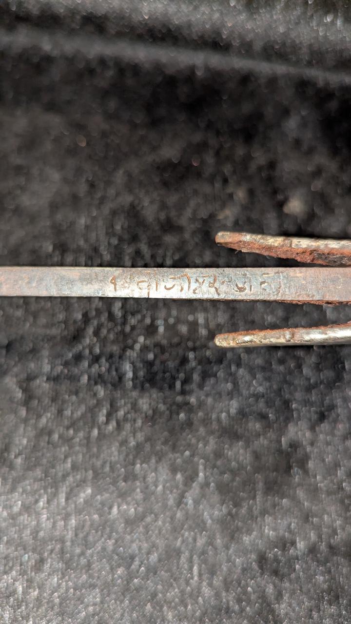

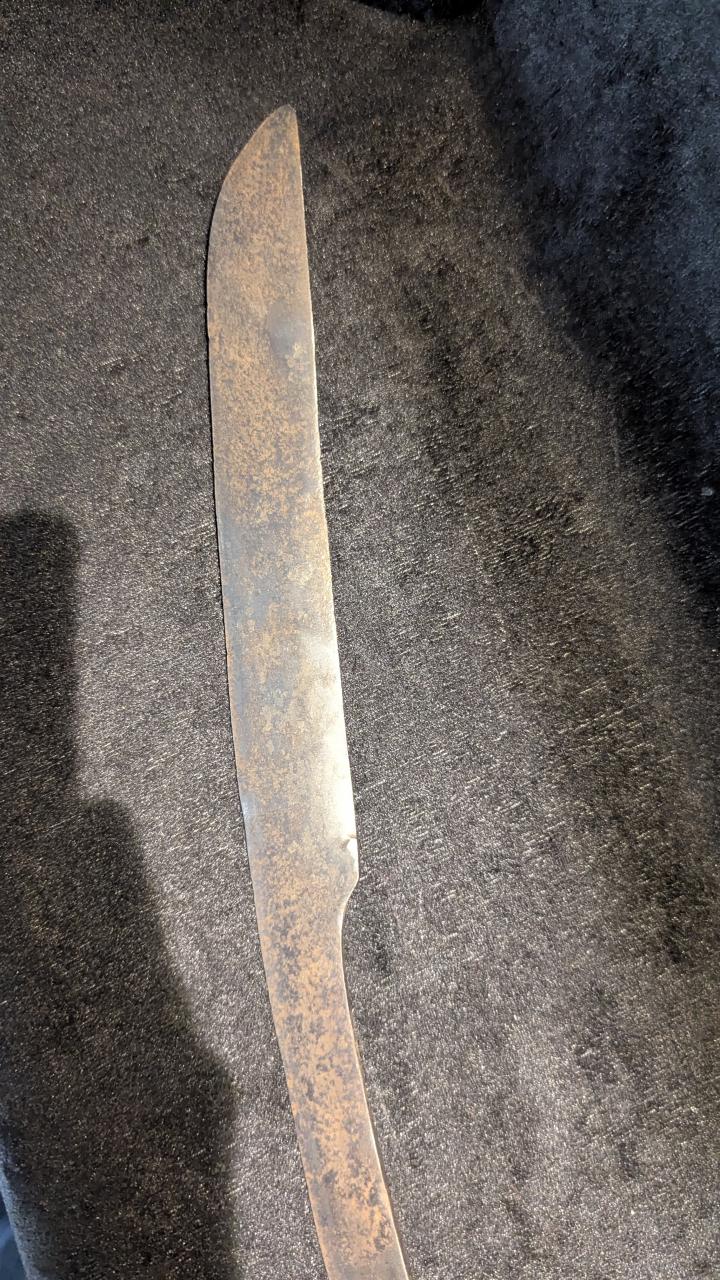

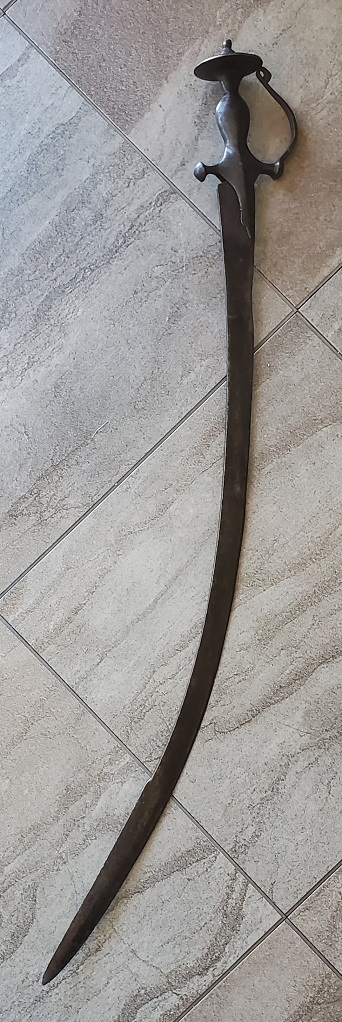

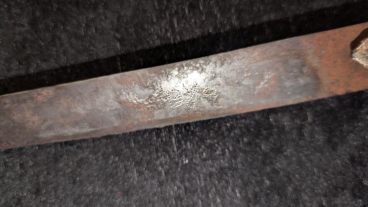

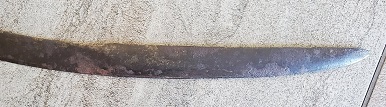

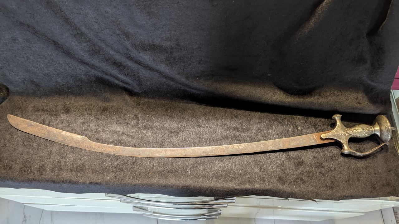

I recently came across an old sword and would really appreciate your expertise in helping me identify it. The sword has some inscriptions or markings on the blade, but due to age and rust, they’re quite difficult to read. I’ve attached clear photos showing the full sword and close-ups of the text area.
Here’s what I know so far:
The sword appears to be quite old, possibly antique.
There are inscriptions or etchings on the blade, though they are partially obscured due to corrosion.
The blade shape, guard, and pommel design suggest it might be from a specific period or region, but I’m not certain.
I’d be grateful if anyone could:
Help identify the type or origin of this sword.
Provide insights into what the text or symbols might say or mean.
Suggest any resources or methods for cleaning the blade safely (without damaging potential historical details).
Thanks in advance for any help or direction. Looking forward to your insights!

Hi Richard,
Thanks for posting pictures of this sword. This is an Indian sword, one of a group of swords that are generally referred to as tulwar. The style of your blade derives from the Ottoman kilij, a curved saber with a swollen end called a yelman. Usually the yelman is sharpened on the back edge.
You will find many swords on this site if you search for "tulwar." Age is hard to say from the pictures, and perhaps the inscriptions will help pin it down. Many of these swords date from the 19th C, but 18th C might also be possible. The punched marks are fairly common on these swords and may indicate the particular armory where it was made.
Hopefully, our Indian arms experts can give you a better reading of this one and a translation of the markings.
Regards, Ian.

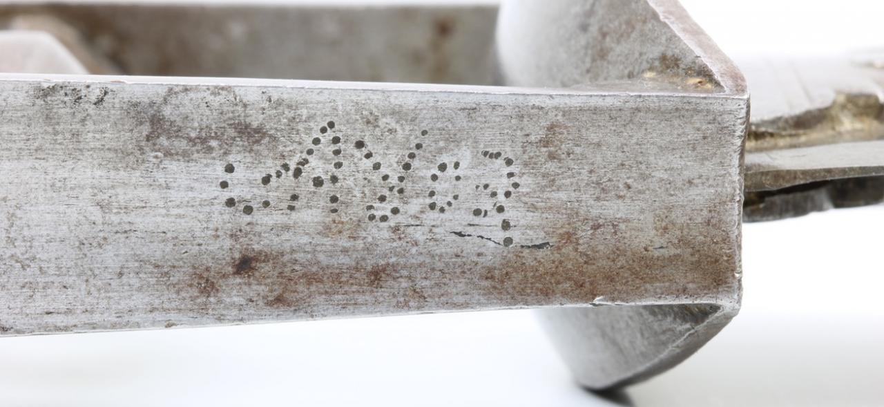

Posts: 10,867
Richard,
You seem to have acquired a tulwar with significant inherent history!
This is likely a Rajput tulwar from NW India, Rajasthan, and these punch dot markings are from the BIKANER arsenal in that state. This is a kind of shorthand for the DEVANAGARI script which evolved in Gujerat in the 16th c.
The expanded distal end of the blade is called the 'yelman' and this feature was used on Turkic blades in the early evolution of the saber, and prevailed on the swords which became familiar as the Ottoman kilij/pala.
In India, the Turkic traditions kept this feature on blades through the 18th century.
The script on the spine of the blade would be I presume devanagari, though it is always tempting to think it might be gurmukhi, the script used by Sikhs, more research needed.
In cleaning...RESTRAINT!! plzzzzz!
use light oil WD40 with the finest steel wool only. This is a historic item, and need conservation rather than restoration. Patina is incarnate history and ots character is important.
Old 30th May 2025, 06:54 PM   #5
Posts: 10,867
Wanted to add an example of another Rajput tulwar of 18th c, more munitions grade and virtually munitions grade. However note the yelman.

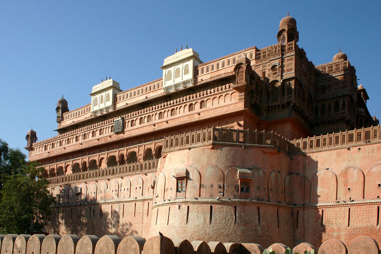

The Rajputs often were allied with Mughals, and Anup Singh was ruler of the state of Bikaner from 1669 appointed by Mughal ruler Aurengzeb. Bikaner is located in the Thar desert and the armory situated in Junagarh fort.
As noted the punch dot characters used at Bikaner are a kind of shorthand version of Gujerati script.
The Rajputs were notably the most powerful warriors in India, and the dynamics of their history is extensive.
It seems that weapons held in Bikaner are typically clean, well preserved. However in the 19th century many entered circulation with collectors, and of these likely many ended up in less than optimum conditions which might account for the active rust etc. on this example. Many of the armories of the princely states were broken up during the 1860s onward, and many of the weapons became souvenirs or the better ones into collections, while tons were scrapped. It seems Bikaner remained largely intact . As far as found, and Jens Nordlund studied this extensively, the Bikaner marks are the only definitive armory markings identified.

Hi Richard,
Based on my observations, I believe this could be a Bikaner, India armory stamp. I’m not 100% sure, but the marking style appears to be the same. I can assist with translating as well; on the spine, it reads "karigar," which means "maker," though I couldn’t make out the rest due to rust. The numbering on the blade is "x34" (the "x" is unknown). It seems to resemble a Kilji-style tulwar.

Originally Posted by nihung11 View Post
Hi Richard,
Thanks for coming in and agreeing with my suggestion (post #4) that the markings appear Bikaner. It is most helpful that you can translate...I can only recognize the style of the markings. As you suggest, as I earlier mentioned, the blade with pronounced yelman is a Turkic form from much earlier sabers which prevailed in the Ottoman kilij/pala and which continued in degree in favor in India on tulwar blades until the beginning of 19th c.
