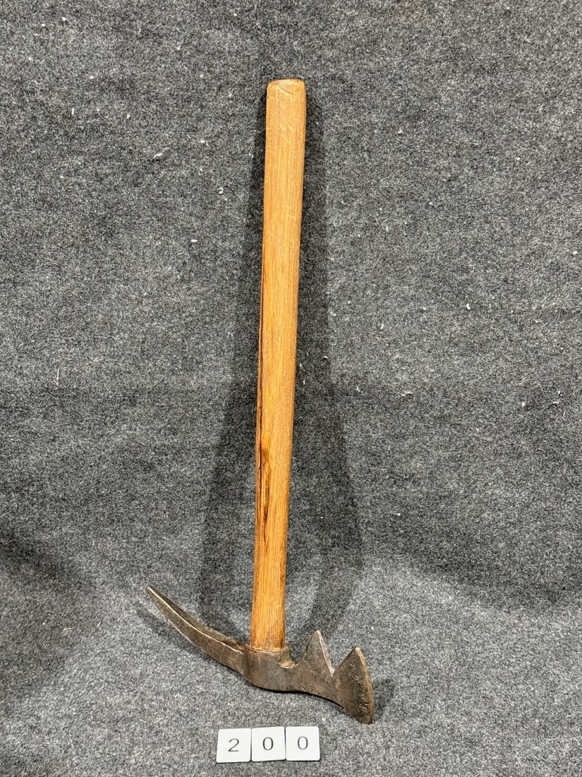

Well, I saw this in an online auction and had to pause. Listed as a 'Rare Ice Axe', I couldn't help but wonder if this could be a precursor to the American Type I boarding axe or even a 'private purchase' type one-off copy of said naval tool. The auction house ignored my request for dimensions, which would have helped greatly in ruling such a theory out!
After intensely searching the web for a month, I wasn't able to prove or disprove my theory. It is NOT an ice cutting axe, nor lathing axe, shingling axe, Masonic/fraternal, shingling/wood-chopping, etc! I guess it could be a mountaineering/climbing axe, but could find no comparisons with the 'teeth'. Maybe a type of fire axe, but agin, I could find no comparisons. I ended up passing on it in my uncertainty and hoped it would go for a big sum so I wouldn't kick myself, but it went for very minimal. Figures...
So, opinions? CC, are ya out there, buddy? Broadaxe? Jim McD? My curiosity is killing me!

Having trouble posting pics. Let me try again. Couldn't download the pics, so here's the auction-
https://www.liveauctioneers.com/item...1_rare-ice-axe

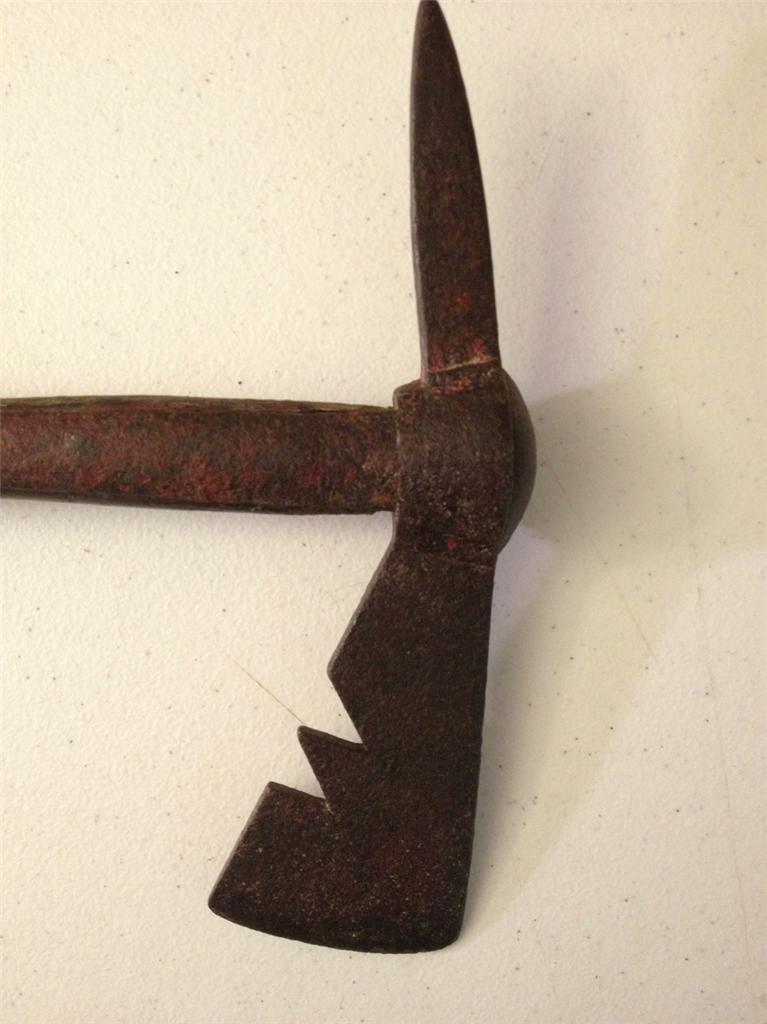

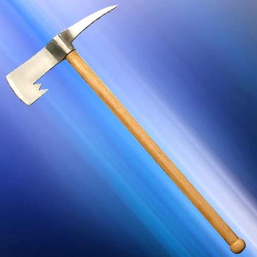

Here's a Type I and Type III, showing the spiked edge (Type III image from The Pirate's Lair website for comparison only)

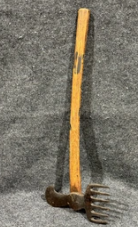

Is this the one? My gut says tool and that the spikes are a comb, but for what? I think the handle is a recent replacement. Too bad they didn't post a pic of the eye.
Old 8th January 2025, 01:46 PM   #5
Posts: 10,862
Capn, this one is a conundrum! While having the character of hafted axes for various uses by virtue of the shaft itself, there is nothing about the head which resembles an 'ice axe' nor any sort of boarding axe.
Personally I think it was wise to pass without having any sort of comparison to align this with.
I have no idea what was in the sellers 'detail' nor how they arrived at or supported the classification of this as an ice axe, presuming they mean the type used by mountaineers.
The 'pick' is anything but a spike and its rounded character seems to suggest it has become the 'adze' (=blade) ? while the part of the head supposed to be the actual adze is something akin to the head of a rake.
Clearly some sort of hafted tool or implement, not sure what maritime application would be at hand, but as we know, over the years we have seen bizarre items that had some arcane use in period, now long forgotten.
Hopefully somebody out there might recognize this curious item for future reference.

Hello Interested Party and thanks for responding. No, this was another axe from the same grouping, but the one I was trying to post was auction #0200. For some reason, couldn't get the pics to post.
This one you posted was also losted as an ice axe. it's a weird one as well and have no clue what it was used for!

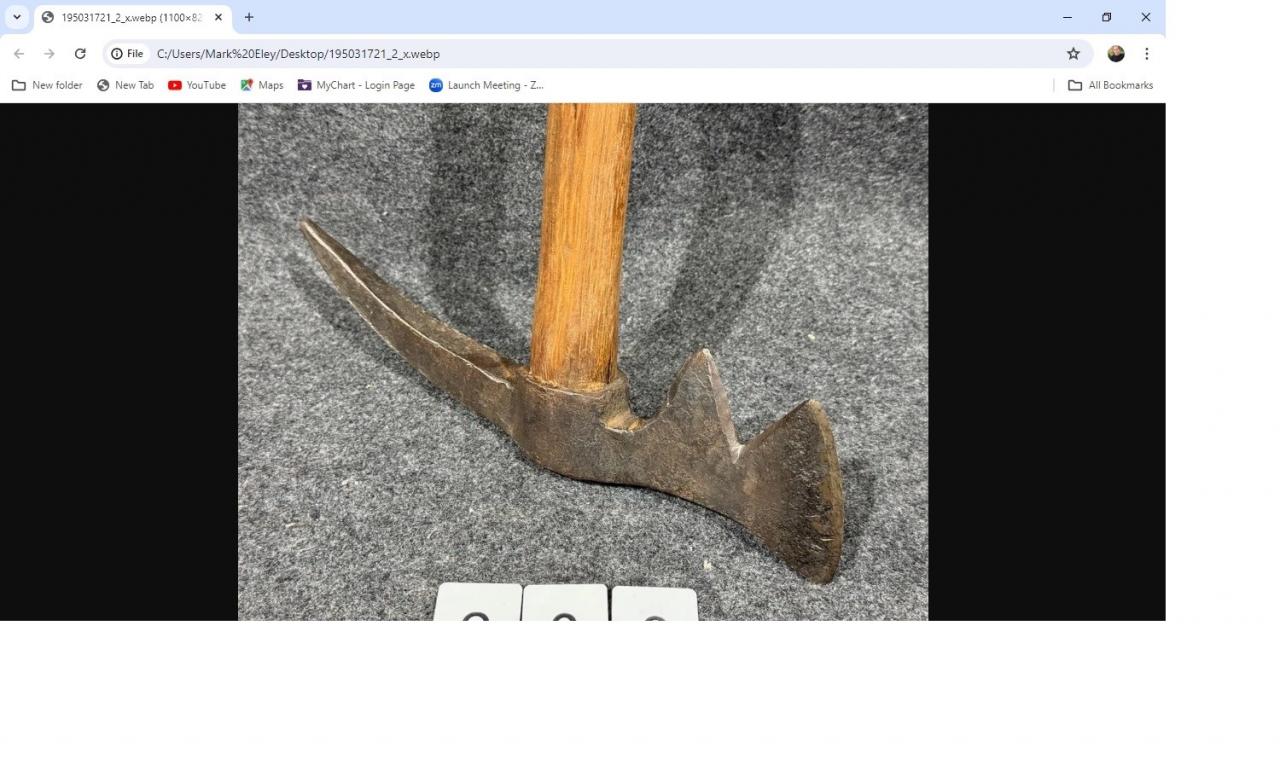

I think this might work here-

Default Another full view
The whole item with haft-

Hi Mark,
I can see what you mean it does have a similarity to American boarding axes. Possibly it was an early version or a private purchase copying the government models. It certainly looks as though it was designed for dragging and it has an axe blade (I think) and a good spike.
On the downside it looks on the heavy side, looking at the thickness of the metal of the teeth. It certainly is a strange one and I cannot think of another use for those teeth. I would have given it a miss as well.
But not as weird as the 'rake' axe. And Jim is surely right - no way is that an ice axe!
I have checked my axe and tool books and although there are hundreds of axe types, there are no examples that help with either of these ones.
Have we considered that ice ax is not a piolet but is an ice ax. The teeth could be for chipping large amounts of ice.

Hello Interested Party,
This odd 'rake axe' also caught my eye when this auction started (they had a big 'lot' of some great original spike tomahawk axes and pole axes. This one is just so weird, I don't even know about the design and I can't even venture a guess. As far as the original one I posted, if it is a heavy axe with thick proportions (which we don't know the specs!), I guess it could be an ice axe for splitting and dragging ice blocks. However, for such laborous work, I'd expect a thicker, heavier haft. This one has a smaller handle. Maybe it was for separating flax! Yep, I'm kidding!
Haha the flax thing crossed my mind for a second as well. My only guess is chipping ice. It would not drag well. Sorry I thought that this was the one you were writing about originally as it came up in the link.

Yeah, they are both very odd axes and being that they are in the same auction, perhaps they were collected from the same place? Although the flax was a semi-joke, I see the 'rake-type' as maybe something for lashing through grain or some such. Ice axe is still in the running, I guess...
