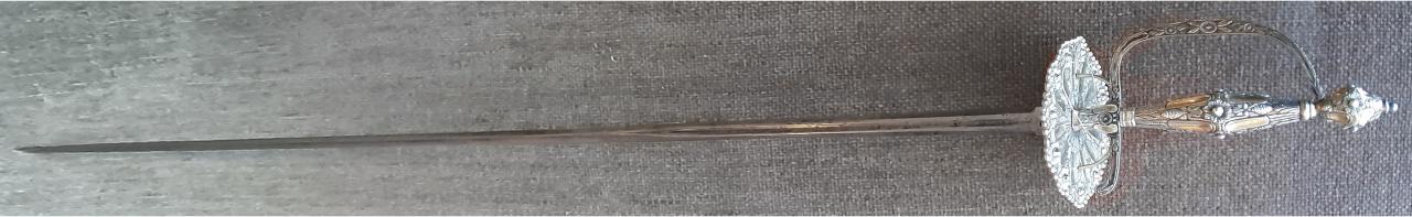

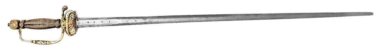

Default repurposed rapier blades

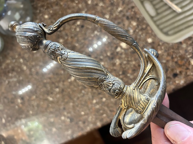

Hello Folks; wishing you all the best for '25.
Hi Jim. You will recall that just last week I suggested that the Portuguese and Spanish appeared to prefer their slim rapier blades on small-sword hilts, rather than the rapidly becoming ubiquitous 'hollowed' blades. I wondered if there was many examples of Iberian smallswords with hollow blades.
I have two swords: one is a Portuguese smallsword/court-sword with a re-purposed slim rapier blade, and the other a Spanish court-sword hilt, again on a slim rapier blade (see below).
Until the arrival of Klingenthal manufacturing, hollow blades only came from Solingen and Shotley Bridge; I don't know what political circumstances existed between these countries which may have made it necessary – or opportune – to re-use what would obviously have been a profusion of rapier blades in Portugal and Spain.
I have never seen a hollow-bladed smallsword distinctly attributed to Portugal or Spain and I am beginning to suspect they did not predominate; however, my experience is limited and – consequently – I call on the forum to disabuse me of my suspicions if necessary… Fernando would know for sure.
It seems absolutely possible that the blades they had carried and fought-with so effectively, and for so long, would not be abandoned causally, and certainly not to oblige fashions.

Keith, thank you for posting this interesting conundrum!

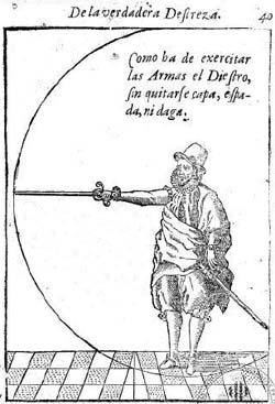

As we have discussed, it seems that the Spanish rapier blades of the 16th century remained in favor for virtually generations after the demise of Toledo in the mid 17th century. By about the 1630s, the innovative machine of Solingen was producing blades spuriously marked with markings and names of famed earlier makers of Toledo. These were mostly broadsword blades and others, but included the thin thrusting blades common to the Spanish rapier.
The Spanish swordsman was known for the mysterious, geometrical and occult oriented system of fence known as DESTREZA, commonly referred to in fencing references as 'the Spanish fight'. By the end of the 17th century, the beloved cup hilt rapiers of Spain were giving way to a smaller, lighter and faster sword for fencing regarded primarily as a French innovation though it as well known across Europe.
The 'French' style of fencing primarily based on the 'smallsword' became dominant through the 18th century. The Spaniards, in the Peninsula largely adopted the French manner and of course the swords, nominally.
However, in the colonies in the Americas outside the direct influence of the Spanish courts in the Peninsula, the traditional elements of destreza remained very much in practice.
The strong hold to Castilian tradition remained in place in the Americas well through the 18th century into the 19th,
In the latter 17th century, the Solingen made blades for various types of swords were shipped in volume to the Americas and certainly well into the 18th, the double edged rapier blades were profoundly in these numbers.
In recent years, the wreck of a Spanish nao was found off Panama with many crates of these raoier blades, and had gone down in 1681. These raoier blades had continually been exported into the Americas literally for generations, and were regarded as 'TOLEDO' blades (for the familiar markings) despite typically being of Solingen production. Attached photo of one of these blades.
In the Americas, well into the 1800s, officers and those of high station used the now familiar small sword, however rather than the typical trefoil blade used in most European versions, Spaniards preferred the traditional TOLEDO blade. This is well noted in "Spanish Military Weapons in Colonial America 1700-1821 (Brinckerhoff & Chamberlain , 1972). where three of these swords, stated origin MEXICO clearly with small sword hilts and TOLEDO blades. These date end of 18th century.
While these examples are from the colonies (i.e. Mexico) and likely mounted with blades long already in these regions, possibly either stored or long in circulation, they do in degree reflect the propensity for Spaniards preferring their traditional rapier blades.
In my own experience, I must agree to not having seen examples of any Iberian smallswords or court swords which were mounted with the type blades (trefoil or colichemarde) characteristically on the European (or American ) versions. Obviously there will likely be exceptions, however I agree that 'typically' the earlier form of Spanish rapier blade prevailed on Spanish swords, as well it seems even on some English swords.

One thing is for certain, and that is the balance/weight of the rapier blade in a smallsword hilt: it is much further forward compared to a trefoil blade. This will certainly influence the style of fighting; the rapier blade will demand a great degree of destreza compared to the modern smallsword techniques. I would imagine this alone would influence to repurposing of the rapier blade.

Well observed Keith! The destreza is much different in that there is much less contact, more traversing (circling) one guard (right angle, point and shoulder in line). There is less blade to blade contact.
With the small sword, more dynamic, faster and more blade to blade, parrys etc.

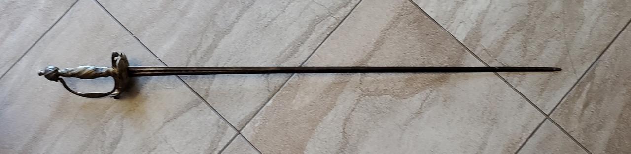

Well… so much for my theory!

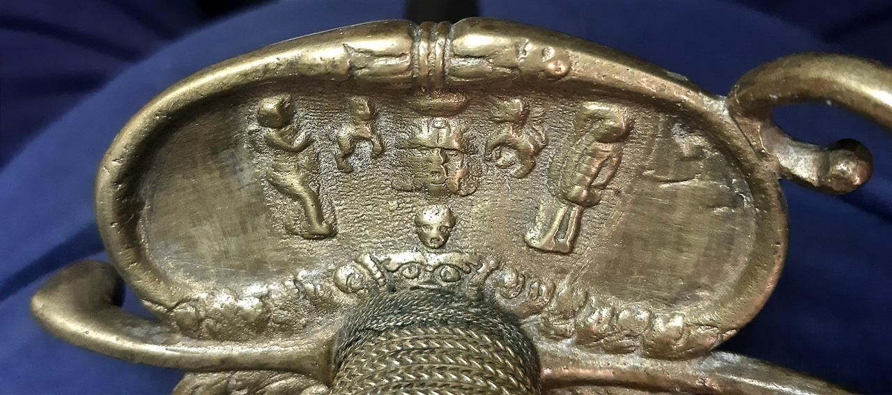

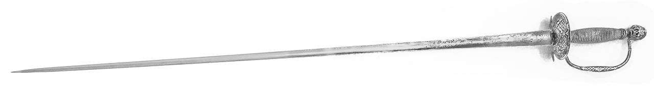

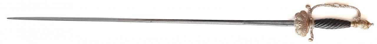

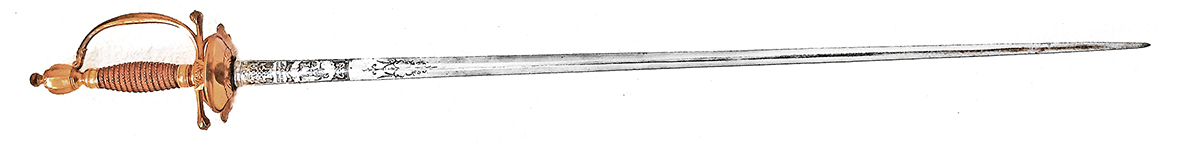

I compared the Portuguese, rapier bladed, smallsword with a typical silver-hilted French hollow blade smallsword and surprise, surprise: both have 32" blades and both have a balance point at 4" from the shell; identical!
Admittedly, 32" is generally the maximum length for a small-sword, although colichemardes tend to be at least that, and often a little longer.

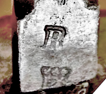

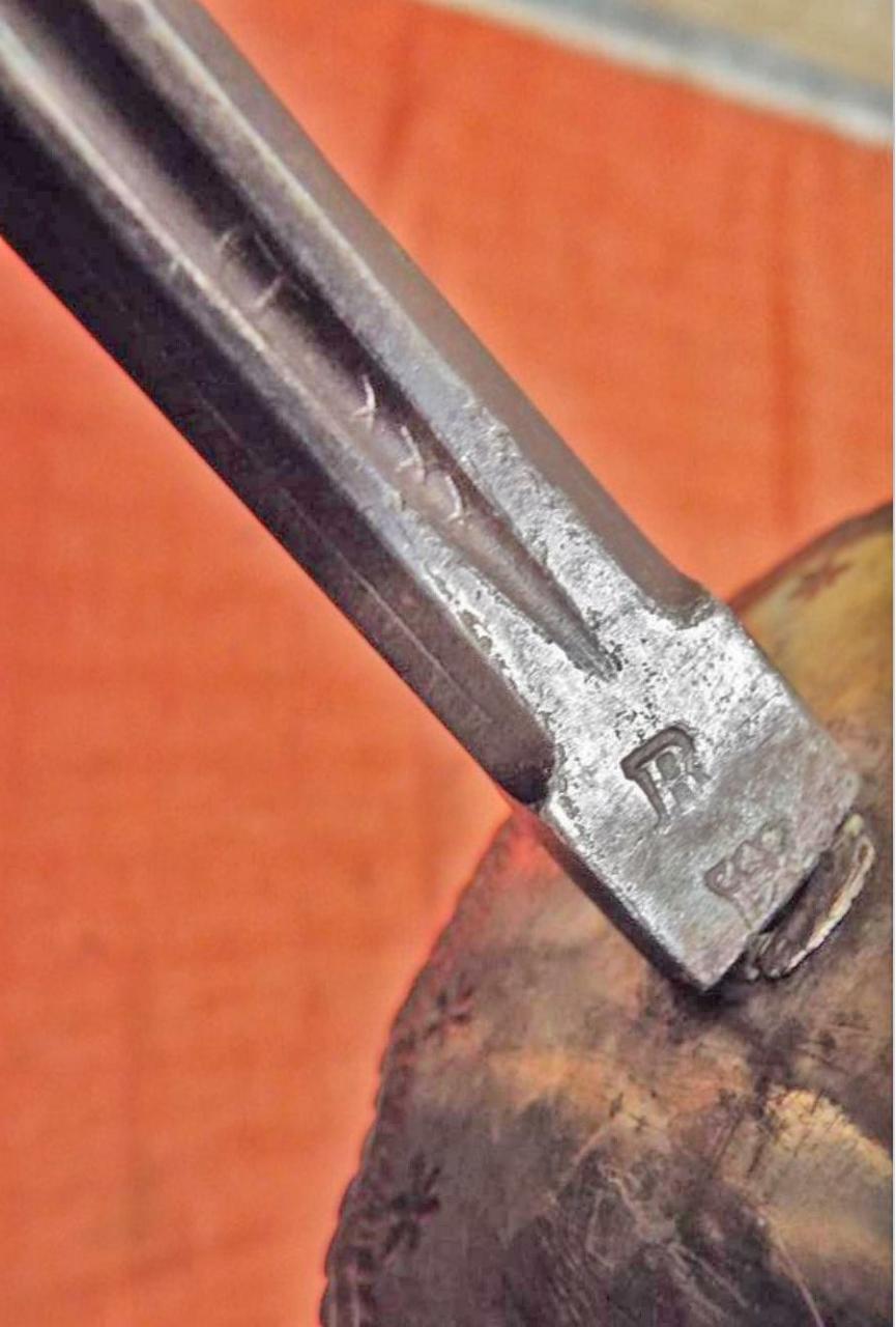

If you look carefully, you will see that the tang of the rapier blade has been reduced at the ricasso as well as being shortened at the foible, producing this balanced weight.
All together, I would imagine there is little to choose between the two as far as technique is concerned which would have been very satisfactory back then with all those rapier blades to choose from.
ps
Note the King's Head punzone on the ricasso.

One thing I didn't indicate was the weight of the two swords:
the hollow blade French smallsword is c.35g
the rapier blade Portuguese smallsword is c.40g
So, a little heavier, which is apparent when holding them.

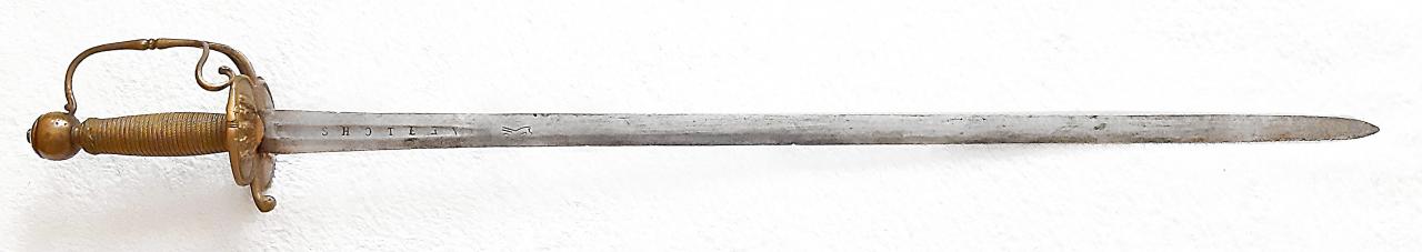

Up here in the North of England, and over into Scotland, there existed (I know this because many still do) a lot of smallswords with narrow double edged blades.
It seems that, at first, the hollow blades were not popular up North.

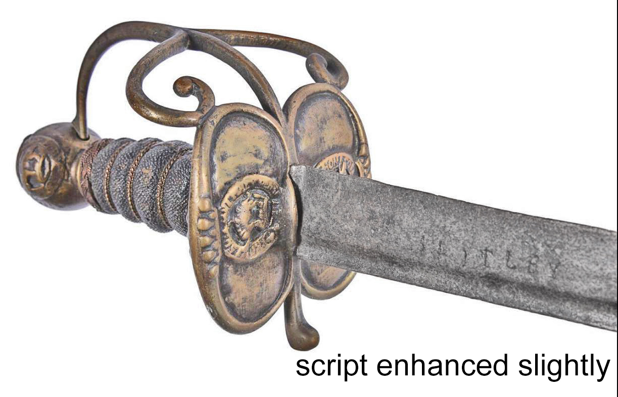

I have two Shotley Bridge smallswords from 1688, with 28 and 29 inch double-edged, 1 inch wide (at the shell) blades. Both have very sharp edges but are not especially pointed.
One is 60g, the other 65g, with mainly the hilts contributing to the difference. Balance points: 4 and 4.5 inches.
I believe we are seeing a lack of accessible instruction for the new smallsword techniques, but predominantly a 'dyed-in-the-wool' confidence in weightier, sharp-edged swords.
The hollow blade smallsword was not everyone's cup of tea.

Those are exactly the kind of early smallswords we find predominating up in the North of the British Isles. They were made in Shotley Bridge between 1688 and 1691 but almost certainly nearer to '88. I have seen several more of almost identical design.
They would have been in the hands of local Jacobites and were definitely dress swords. The military versions were horseman's swords with broader blades of the same length (30") but those blades were smuggled in from Solingen and feature the Passau Wolf, whereas the smallswords have the Oley bushy tailed fox.

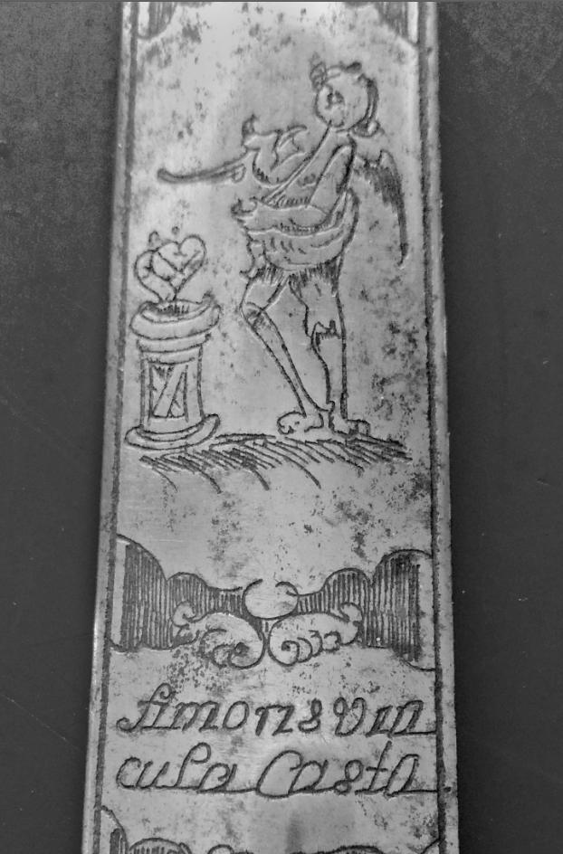

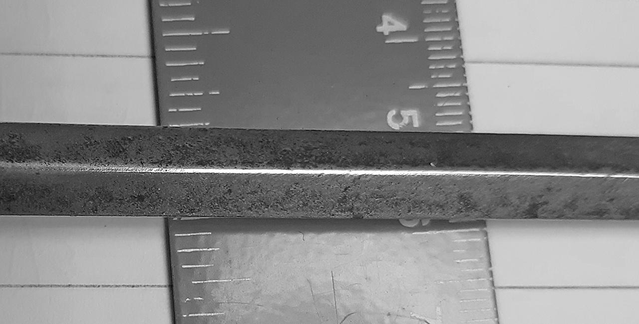

You make a very valid point re. refashioning rapier blades: the Portuguese one above has a flattened diamond profile which is maintained down to the foible; it is perfect throughout its length. It makes me consider if it was not always that length and if so, for what? Were they buying stock, ready to mount in smallswords? Every question has three following up.
The blade is dedicated to the queen of Portugal which is obviously Maria 1st (1777 - 1816) which helps put it in chronological perspective.
You raise a good point regarding the annuletts but that Portuguese sword has typical short 'branches'; that, of course, is the hilt design which looks much later than Queen Maria 1st so it was a re-purposed blade combination.

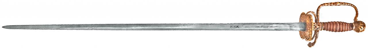

Purely for your interest, I am including my 1767 French officer's sword, of which I am particularly fond. It bears a strong resemblance, in some fashion, to my Shotley Bridge smallswords. A longer blade, but a similar balance in the hand... and very sharp. Let me have an active link so I can see yours; does it feature a cartouche at the ricasso?

Those two smallswords were forged by Adam Oley in Shotley Bridge in c.1688.
They were hilted by a cutler in (The Side) Newcastle, name of Thomas Carnforth.
It is suspected, but as yet unconfirmed, that the larger of the two was presented to the Duke of Northumberland, George Fitzroy, illegitimate son of Charles II, Commander of the 2nd Troop of Horse, along with a Horseman's sword with a smuggled Solingen blade (see pics) and the motifs of the 2nd troop on the shell.
As I said in my opening assertion: we in the North of Britain were slow to adopt the hollow blade smallsword, and were keen to still have some weight and two cutting edges, even when 'off-duty'.
Soon after, John Holles, Duke of Newcastle, commissioned backswords for his militia: they also were forged by Adam Oley in Shotley Bridge (see pic). They were marked SHOTLEY and BRIDGE on either side of the blade.
Holles was a firm royalist, but James II's insistence on a Catholic country (Holles was a staunch protestant) led Holles to support Danby against the King's supporters at York.

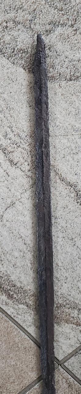

Sorry, that was the wrong shell image; here is the correct one.
